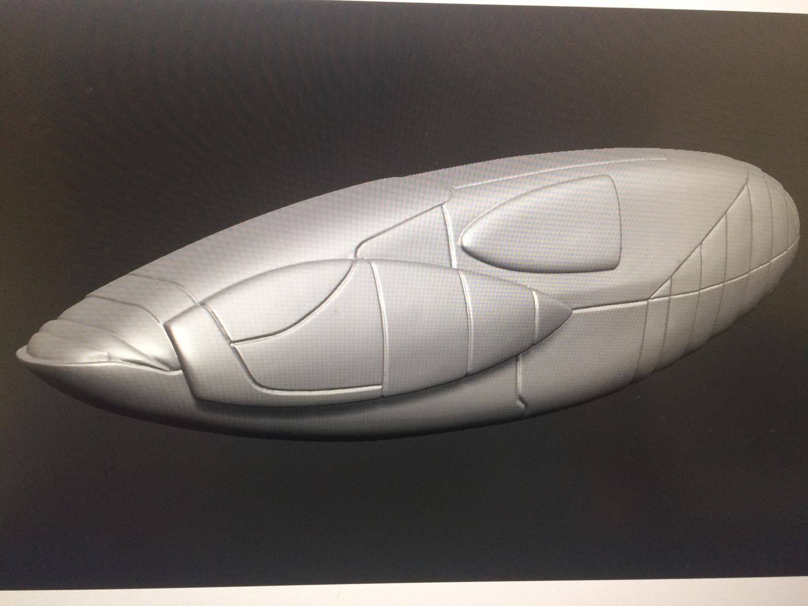

A friend of mine had his original shell casting laser scanned and I’ve been cleaning up the model in Zbrush, using the scanned mesh as a highly accurate guide. This is the result so far.
I’ll be chopping the model up and making it fit my hybrid ZF1’s. This will effectively make it 100% accurate for size and shape, and a fraction of the cost of fibreglassing into a mould.
So will you be able to offer shells?
As a proud owner of one of your ZF-1s I want a shell to sit next to it.
The only shell I have found was out of my price range.

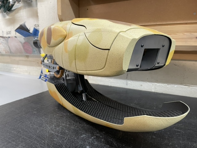

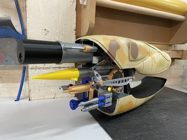

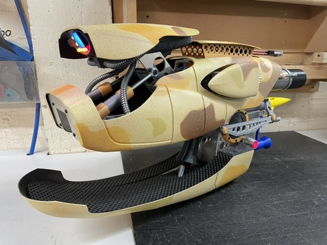

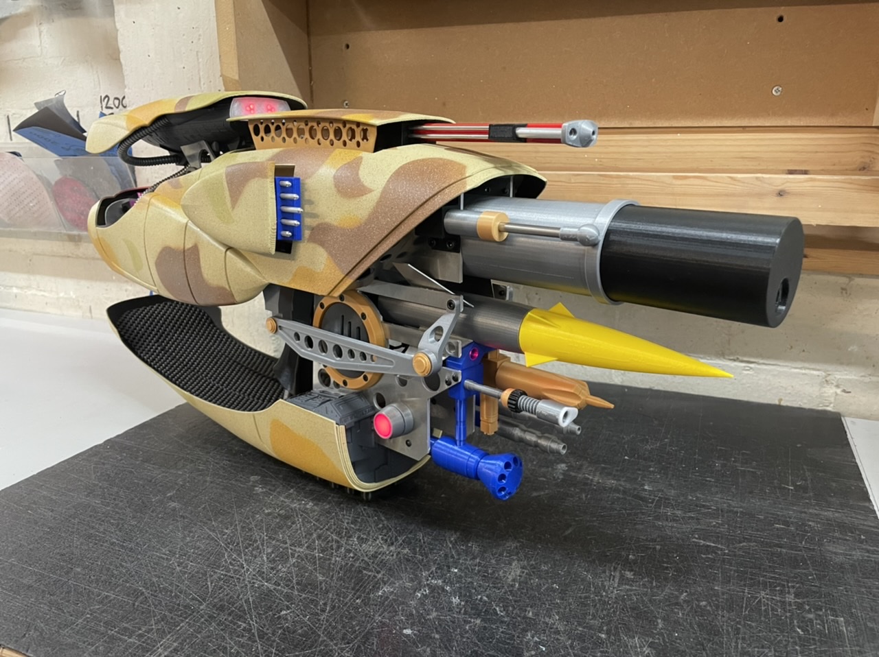

My latest ZF1 now has an aluminium ‘horizontal frame’, as opposed to a printed one.
I realised I could design and print accurate bending jigs to allow me to bend the 1.2mm aluminium to exactly the correct angles, which not only saves me hours of printing time but also creates a better looking replica.
I think they’re looking pretty smart!
