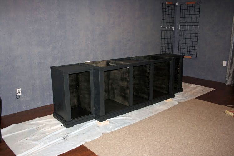

There are a lot of and cabinets and furniture that I have to build and I started with the entertainment center and 2 end tables.
This is one big honkin cabinet.
Here it is with a base coat of black, eventually it will burgundy crackle finish with a granite top. As I paint this I will finish the end tables.
The granite guy will be here Thursday so I have to have all 3 assembled by then.

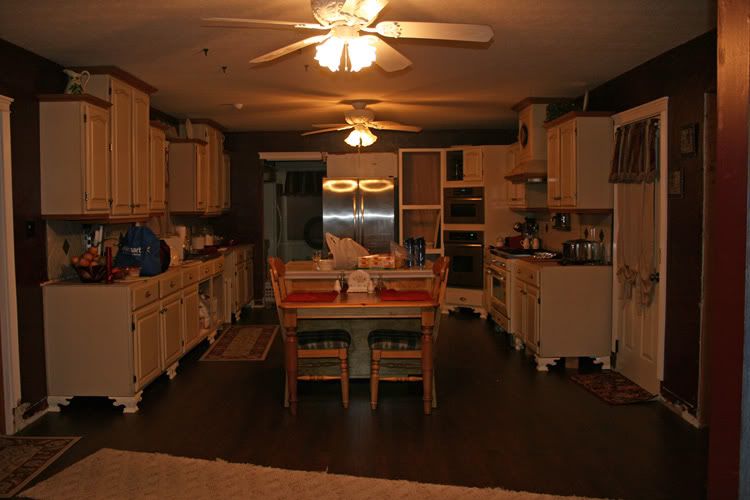

Kitchen Re-Renovation
It's only been a few years since we renovated the kitchen but part of the new living room renovation was the replacement of the tile floor on the entire first floor.
Since everything had to come out I decided to make a few changes to the kitchen and bathroom
In this post, I'll just discuss the changes we made to the kitchen.

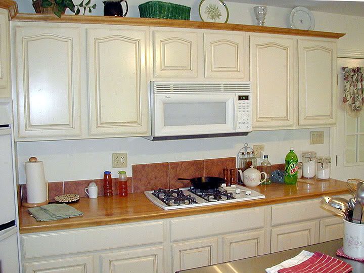

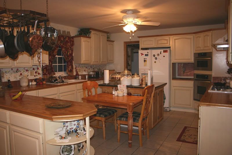

Kitt has been wanting to get rid of the peninsula and I wanted to add some high end details like ogee feet and real granite counter tops.
Here are some pictures from our last reno

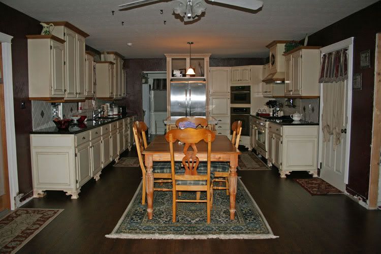

Here is what we have done so far
  • The tile floor has been replaced with hand scraped laminate
  • The peninsula is gone and I used parts from those cabinets to make the pantry cabinet between the refrigerator and the double oven cabinet.
  • All of the cabinets have been reinforce to handle the new 3cm thick granite which should be here next Saturday.
  • I removed the toe kick on all of the cabinets and replaced them with ogee feet
I still have a lot of work to do before the kitchen is done but it's ready for the granite.

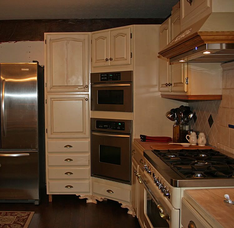

REPURPOSED CABINETS

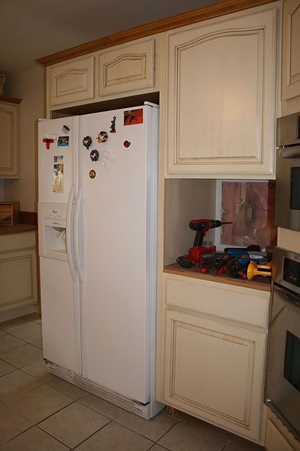

I was able to use parts from the peninsula cabinets I removed to make a new panty cabinet. It replaced the full depth wall cabinet and base cabinet that was between the refrigerator and the double wall oven cabinet
Here is the original set up
The original set up was ok but it had a small 2' wide counter that was always covered with stuff and had a generally messy appearance.
The new cabinet looks like this:
This took care of several issues.
The open area is now enclosed and I didn’t have to get a new counter for it which would have cost about $250. That is a lot of money for a counter that is more of a shelf.
It was pretty simple to build. I built the box and the face frame from scratch and then I used all 4 drawers from the peninsula so Kitt didn’t lose any drawer space. I modified the top door by reducing it's width (I still need to re-finish this door) and added the second middle door from a base cabinet.
It looks great and Kitt loves it.

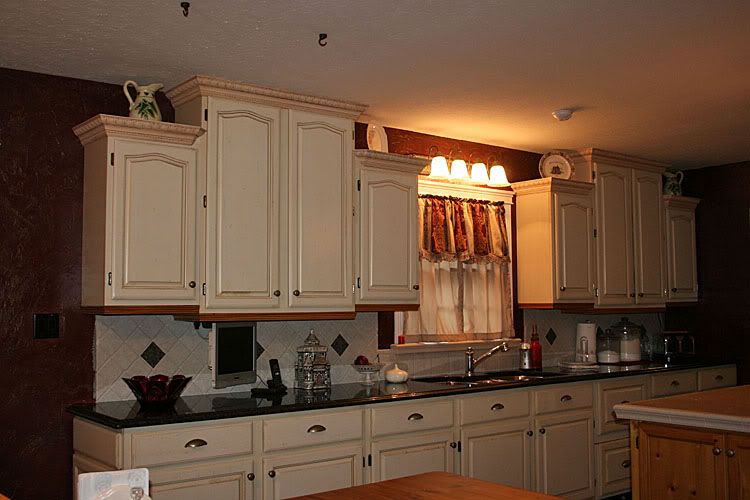

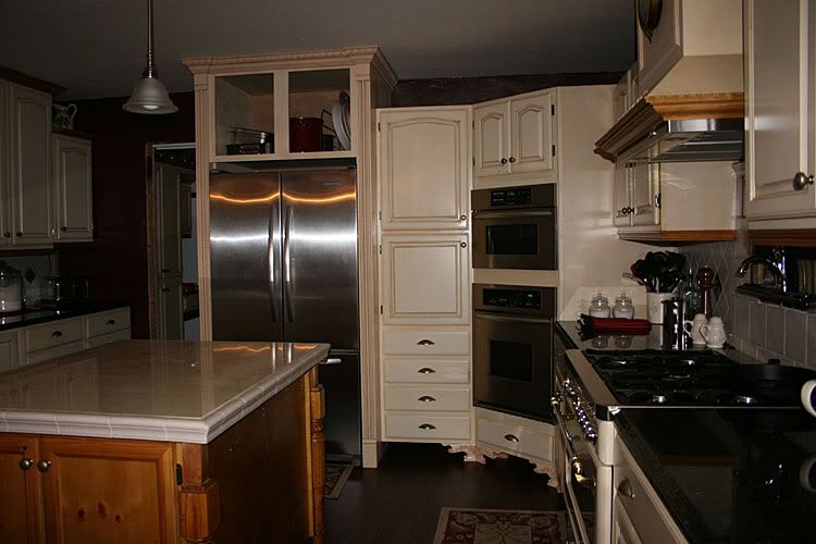

I finally had time to do a quick update on the progress of the kitchen
The granite is in, the feet are matched to the cabinets and the refrigerator cabinet is almost done but I still have to make the doors for it.

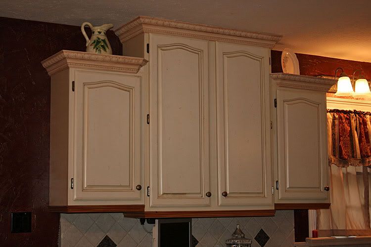

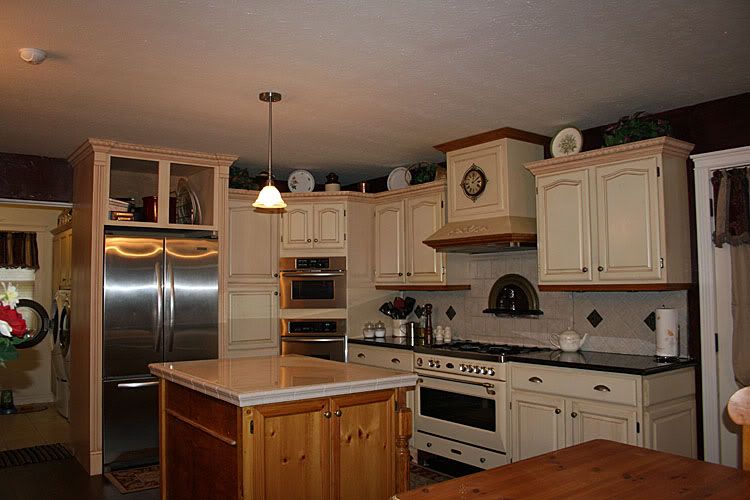

I finished the crown molding on all of the Kitchen cabinets.
A neighbor asked why I changed it. Originally the kitchen had pine counters and the pine crown and valance molding that matched them so it looked good.
However, with black granite counters there wasn't any reason to leave the pine moldings.
I still have to do the exhaust fan cabinet and the valance molding around the bottom of the cabinets but this is a big improvement over the way it was

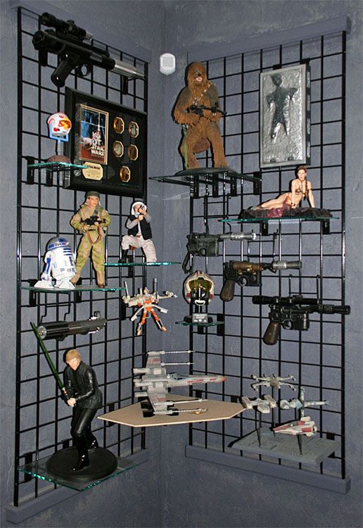

Since the initial set up of the grid wall prop displays, I have been looking for ways to update and improve them.
I started with the Star Wars Rebel side. I replaced a few of the items and added some new pieces.
The Gentle Giant Slave Leia is a 1000% improvement over the "Lukeia" statue that it replaced and the Sideshow Rebel Fleet Trooper is just awesome
I think the 12" C-3P0 looks a lot better the the pile of 3P0s and R2s that I originally had in that area of the display. Now I just need to find a 12" scale R2. I might eventually replace the duo with the Medicom statues, but I don't mind going cheap for now. I really need a Chewie but I have not found one that I like yet.
I like the less cluttered look you get by using a single larger items so I'm looking forward to updating the rest of the collection.
