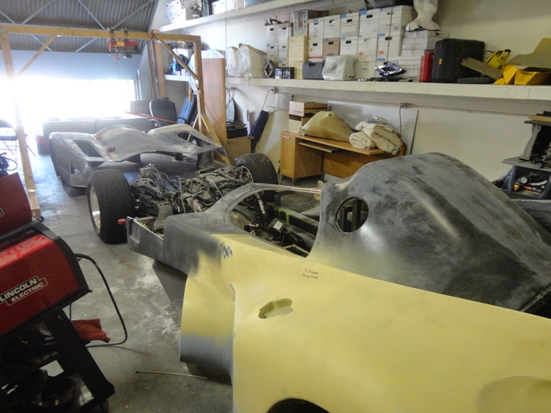

Got a lot of work done last night. Did some more metal fabrication for the inner guts, and also started to cut off the front hood. big business!

Nice job, Matt. Are you doing all your own welding now? Is that a skill you've picked up along the way on this project?

I have indeed taken over the welding tasks. I am going to have a pro double check my work, and add any additional welds where necessary, but in order to keep things moving forward, and to eliminate another bottleneck in the pipeline, I've picked it up. It's actually not that hard! There's a few things that are pure technique and knowledge (like the proper settings on the torch, pushing/leading the puddle, etc) but for the most part it's just a matter of practice and learning as you go. And so far so good.
I'm hoping to get down to the shop a couple more times this coming week to get more fabrication work done. Hopefully some good pics to follow.
