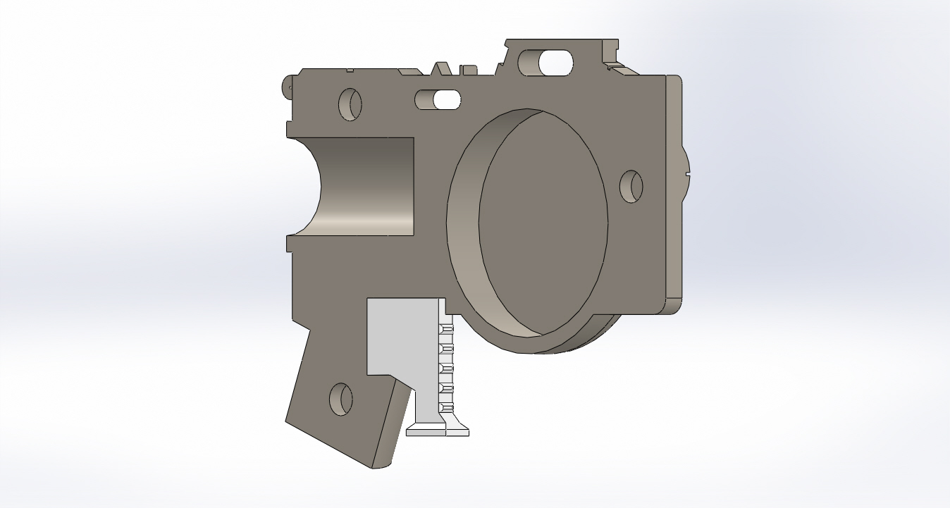

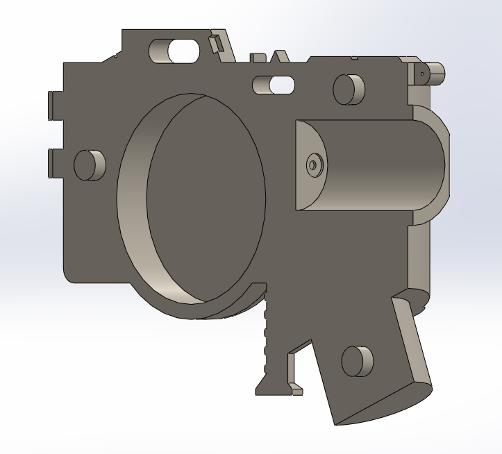

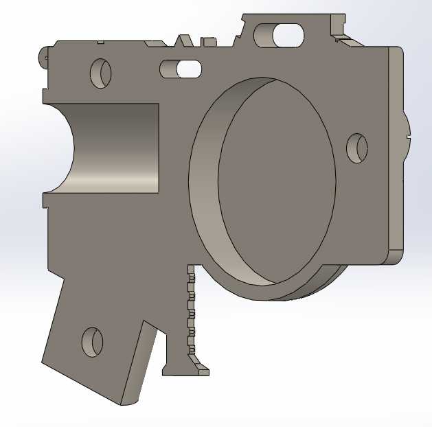

Onto an update. Got easily enough interest to do a run of these so am converting the solid model into kit form. Started on the main body, added a hollow below the vents big enough to house electronics and lights. The wall thickness blocking the vents is a millimeter so should be easy to drill/file out if you want to add lights. Added some indents in the battery cylinder to glue in the magnets that'll keep the battery in place, and a smaller hole behind it so you can solder to magnets and use them to hook the actual CR123 housed in the battery to the electronics. Finally, the holes and extrusions on the side should make it easy to line up and glue the two halves of the body together.
View attachment 369241View attachment 369242
If anyone has any idea/requests for this piece, just ask ;)
Would It be possible to separate the trigger? and make It one single part?

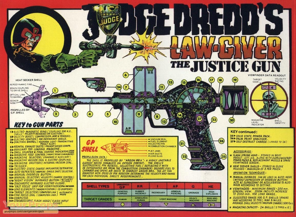

Would that be the lawgiver from the last movie? excuse my Ignorance on lawgivers..
The Mk1 was the original gun from the comics.Should look something like this, but without the second magazine on top of the gun.

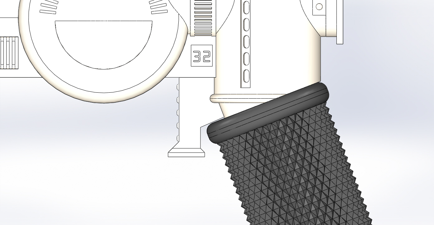

The trigger would be sandwiched between the two halves of the body, so it should work as a functional trigger. I might have to tweak the trigger a bit as there's not much space between the trigger and the grip, so the throw of the trigger wouldn't be much. I'll get that done tonight for you.trigger issue.JPG
I wouldn't want you to change anything that went against the concept drawing. and as there are others Involved In this. I would want there Input also as to there thought's on changes.
If that makes sense.. I don't want something changed that no one else would want changed..
You could always cut a notch in the grip to allow the trigger to move further back.
Sweet. looks to me the trigger would not have to travel far for that switch. then there would be no need to cut into the grip.
