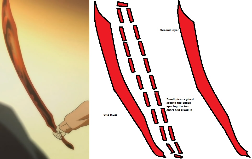

I appreciate the responses. The issue I might find with solvent is that the pieces she uses between the layers aren't solid, they're small pieces placed around the edges, so there are gaps. I think she thought the glue she used to hold them in would also hold the gaps together.
Ideally to so this properly, you would want 3 parts cut to the shape of the blade with the centre part hollowed out. Then bond the 3 parts with the Weldon #3 and fill from the end of the handle. That is how I would tackle a project like this anyway.

I can post one later, but you won't see much; it is assembled and colored. It looks like this and is assembled like this:
Basically, two of these glued together with small pieces between them making edges. The suggested method would be a third layer that was hallow in the middle, only an outline, but she has already done the two layers and put a bunch of effort it it.
