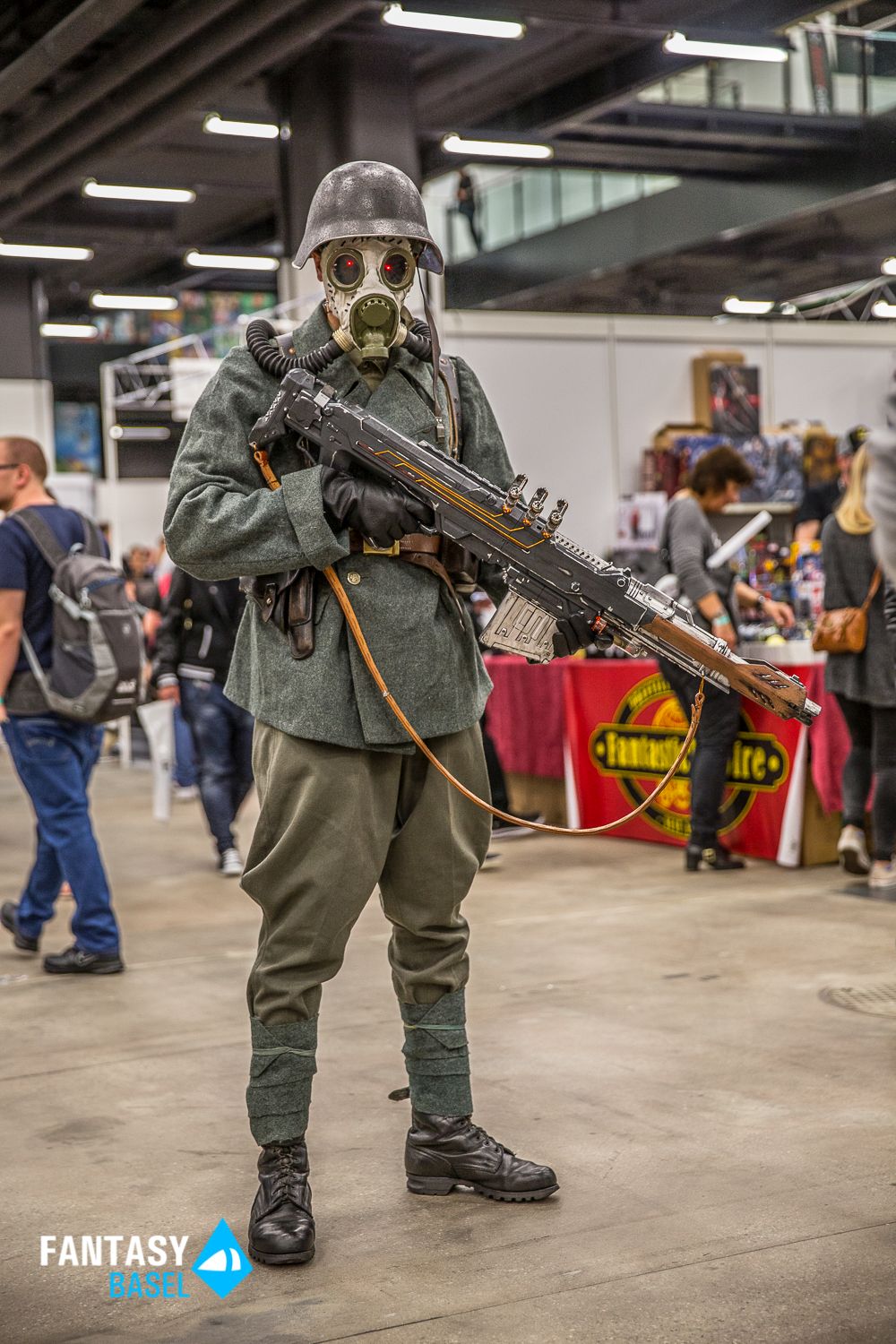

Hi everybody,
here is my cosplay build of the sucker punch zombie soldier. It was my first cosplay ever and most of the work went into the gas mask and the gun.
Everything is built from old swiss army material (yes, I do live in Switzerland:)).
Since we were not allowed to take any gun-replicas I built my own gun out of a nerf-gun and made it somewhat steam-punky with a bit of copper wire and tubes.
I know that the original standard soldiers did not have the red eyes, however I added them since it looks quite cool!
I will add some more pictures later.
I even found a Babydoll cosplayer!
Unfortunately I could only wear the mask for about 10 minutes before my face started melting.
So my next improvements are getting the canadian gas mask and adding a fan into the gas tank on the back and taking the glass-windows out of the gas mask.
Cheers
Alex
