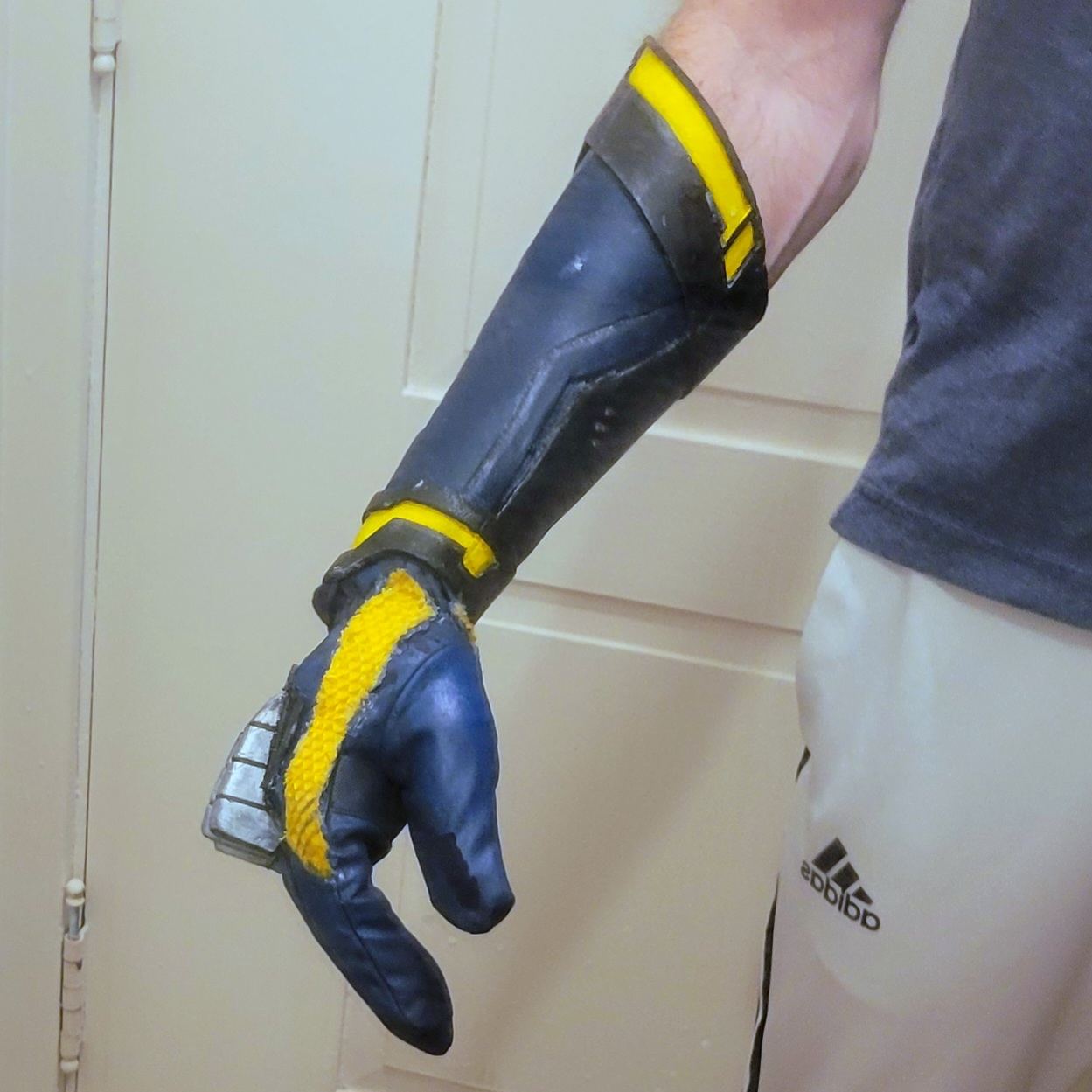

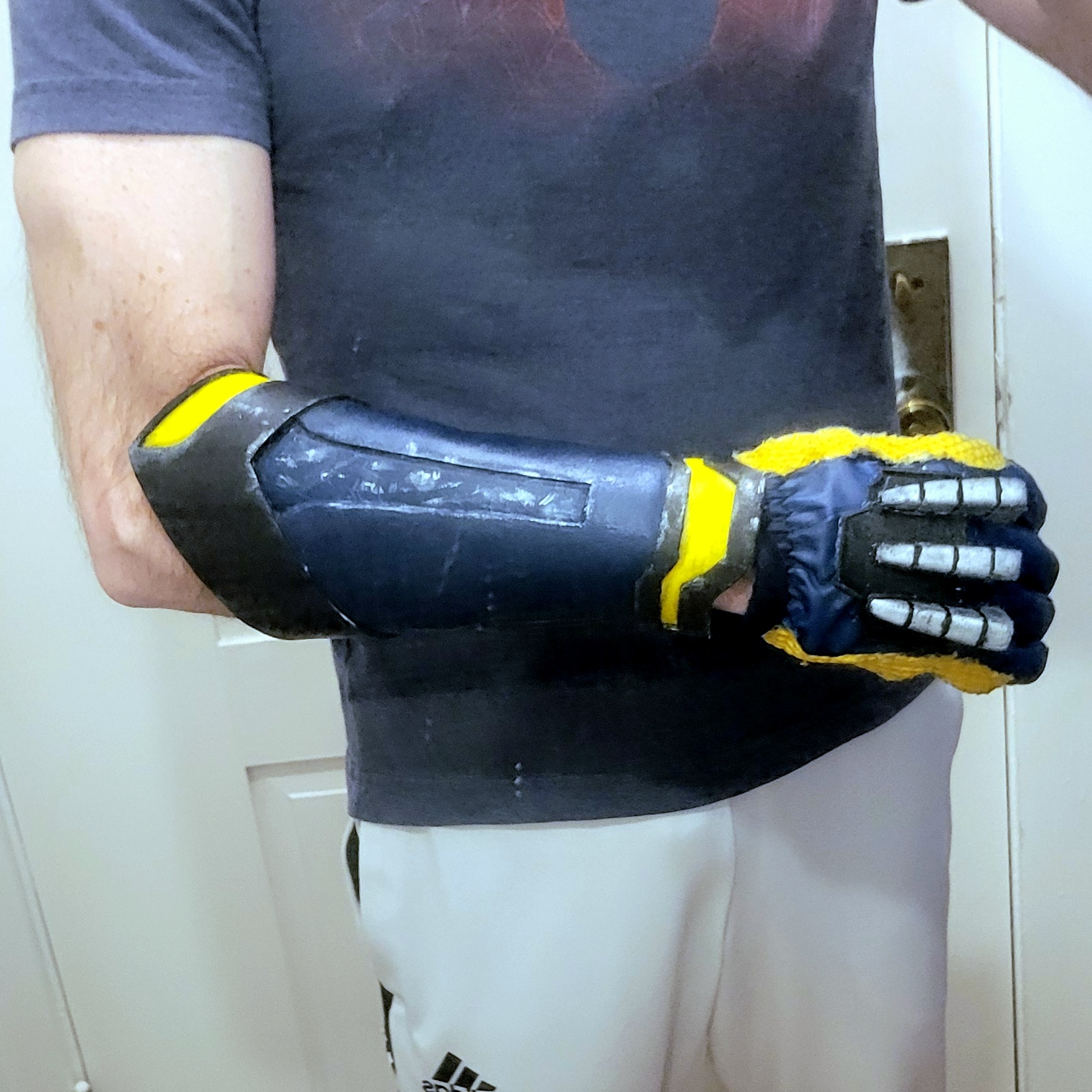

Once again, I ran out of time before I could get everything I wanted done. But I expected as much. I did remake the gauntlets and 3D print the sheathes in flexible TPU. But I didn't have time to remake the gloves or get the sheathe parts to line up with the claws properly.

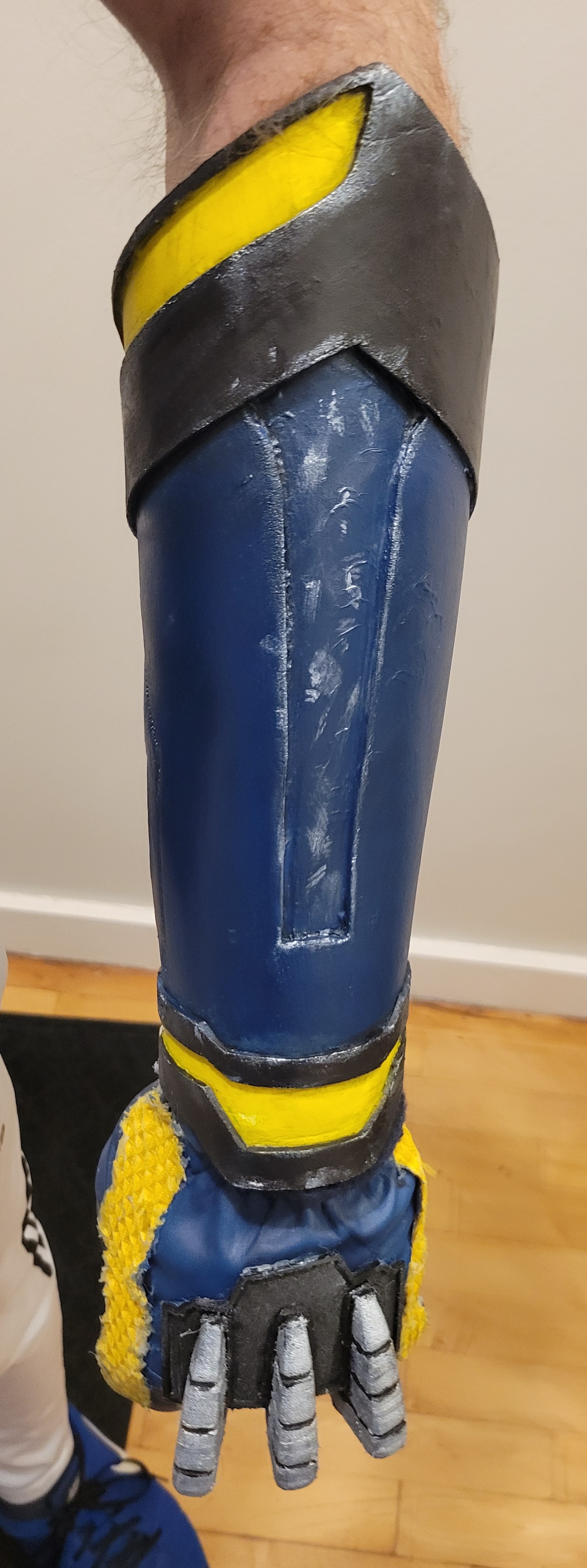

I think the gauntlets are of better quality now, but they still aren't quite right. I might have gone too thin with the foam, which was 2mm thick, vs the old gauntlets being 6mm foam. Probably need to split the difference. Also, they could use some more shape - they're a little too straught & tube-like.

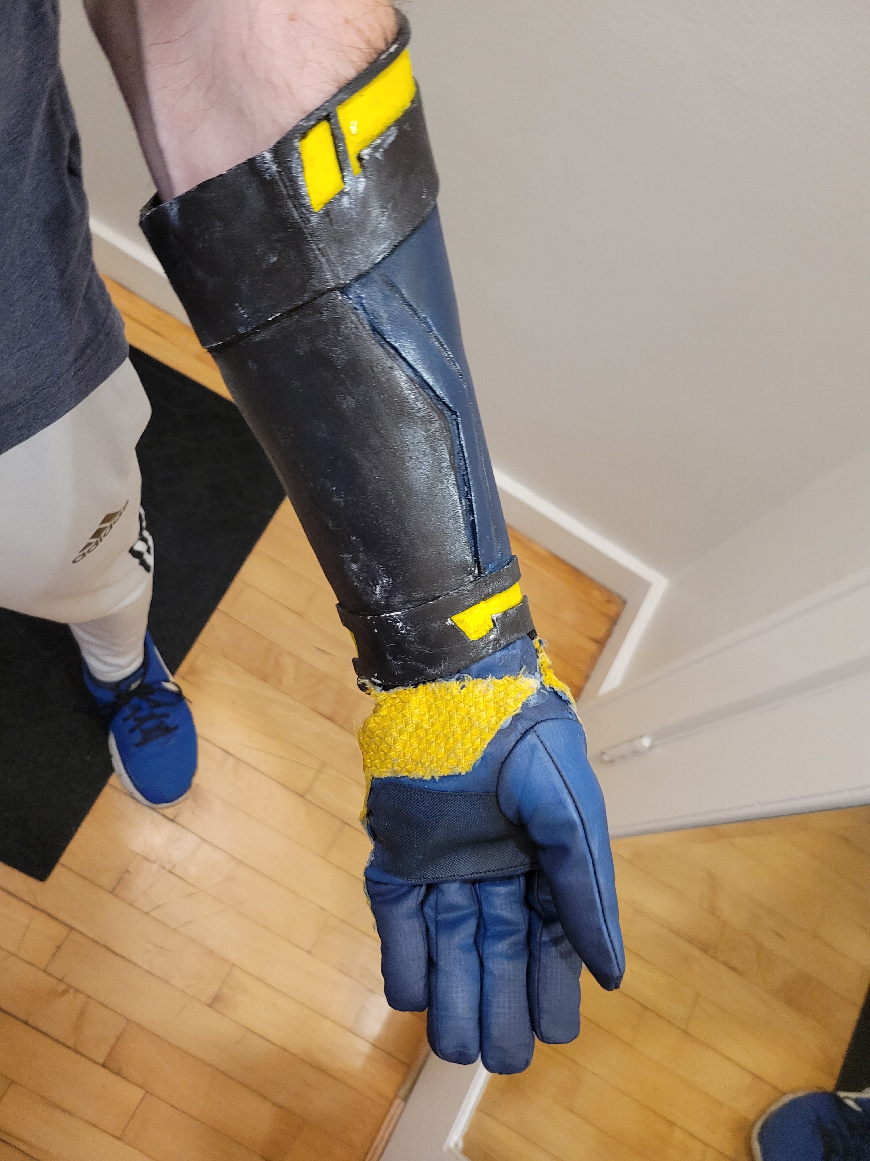

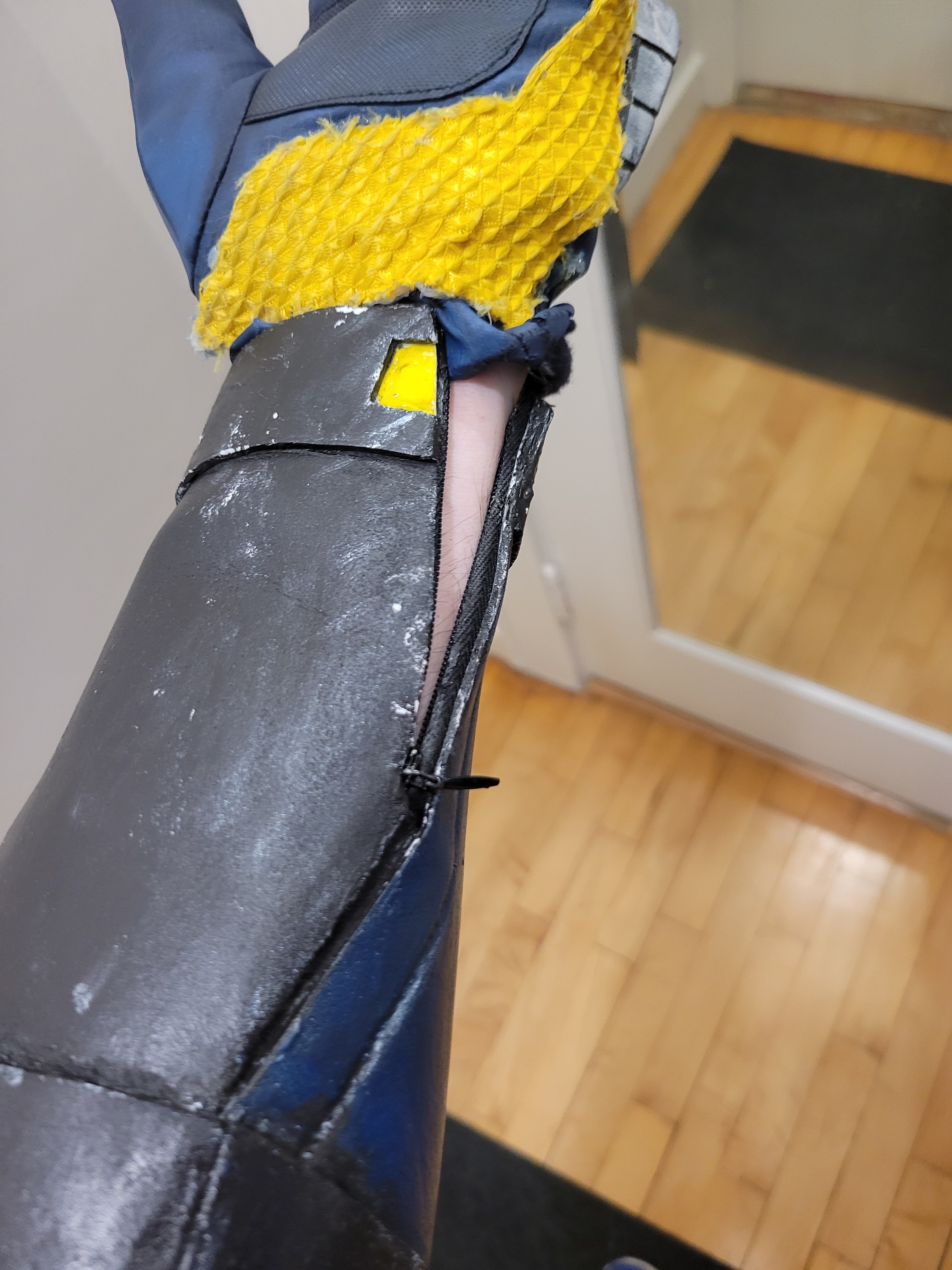

I did get the invisible zippers in these, which were an improvement over the velcro I resorted to on the first pair:

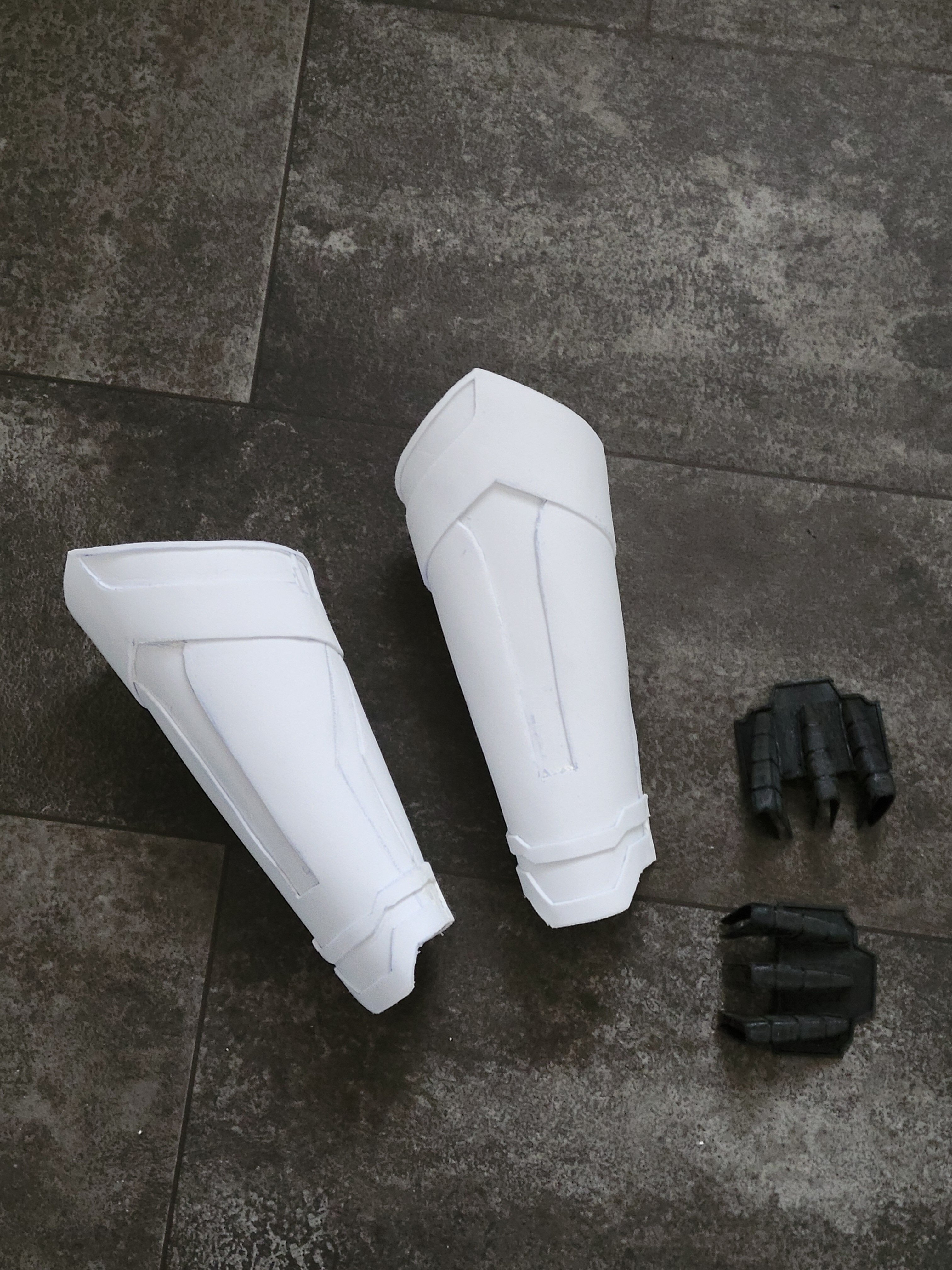

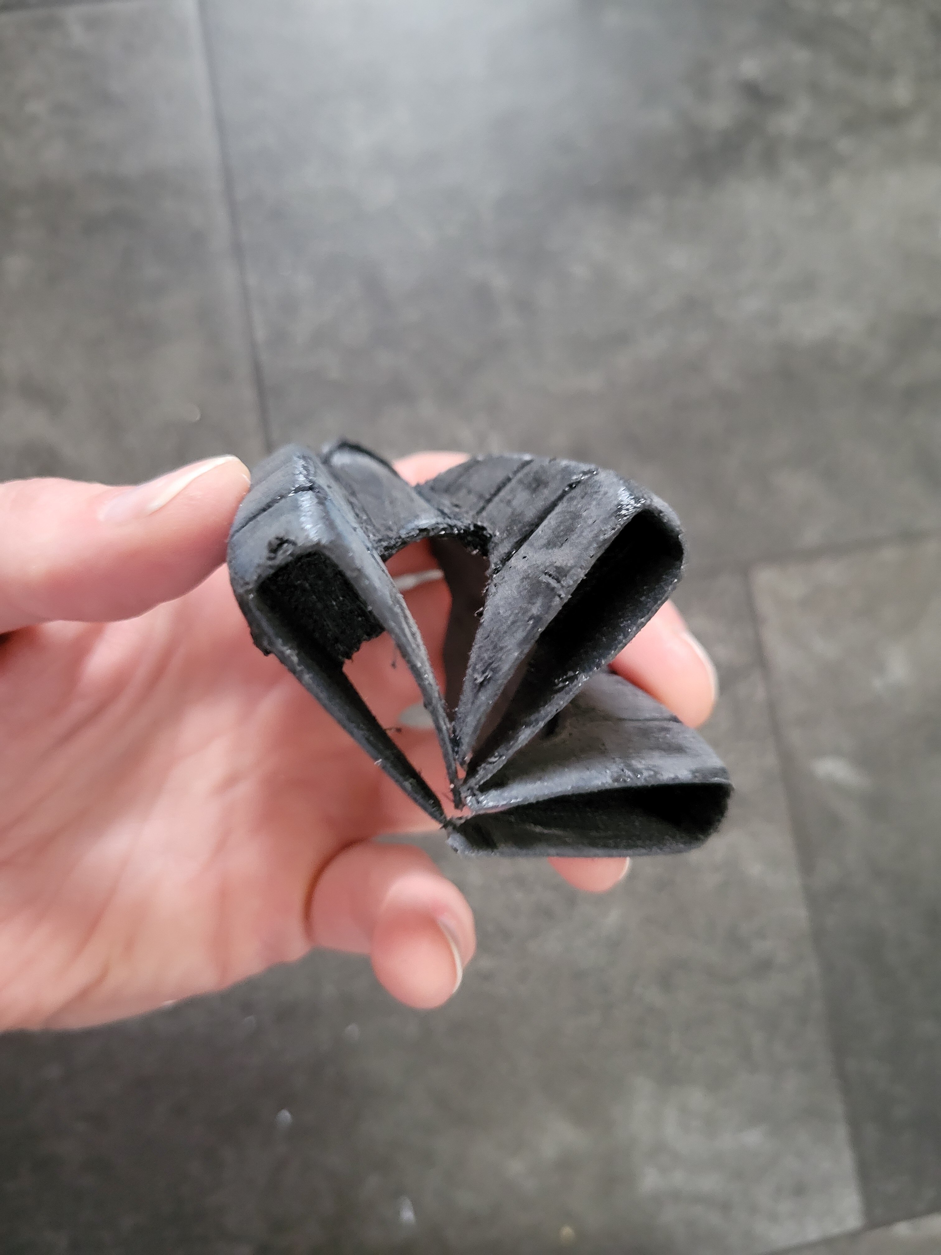

Here's the new sheathes. Even though they still weren't the right shape, I was pleased with the TPU and how flexible it is:
It was kind of a pain to clean up and remove the supports, though (compared to PLA filament). I had a lot of stringing problems, so I had to use a dremel to get rid of them all. I'll have to play around with the print settings later to see if I can fix it.
Wearing my costume a second time lead to some issues, like a few seams split (not too bad at least) due to the fabric not being very flexible, as well as its tendency to fray. I should've added pockets because I put more stress on the seams whenever I tried to get my wallet out of my shorts pocket. So now I need to make some repairs. The fabric of the collar loosened up, so that needs some fixing too, to add some rigidity.
