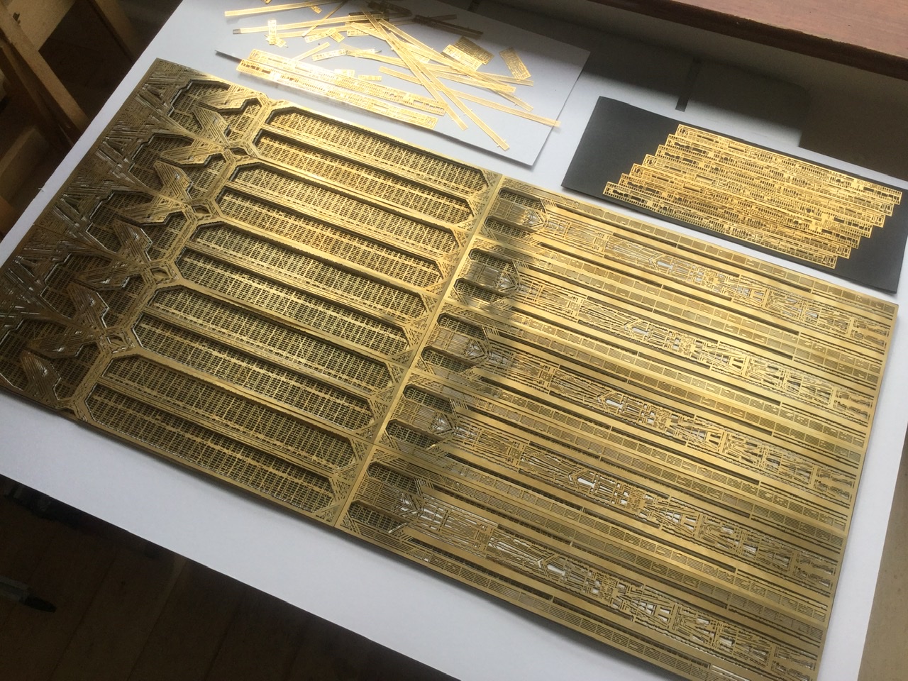

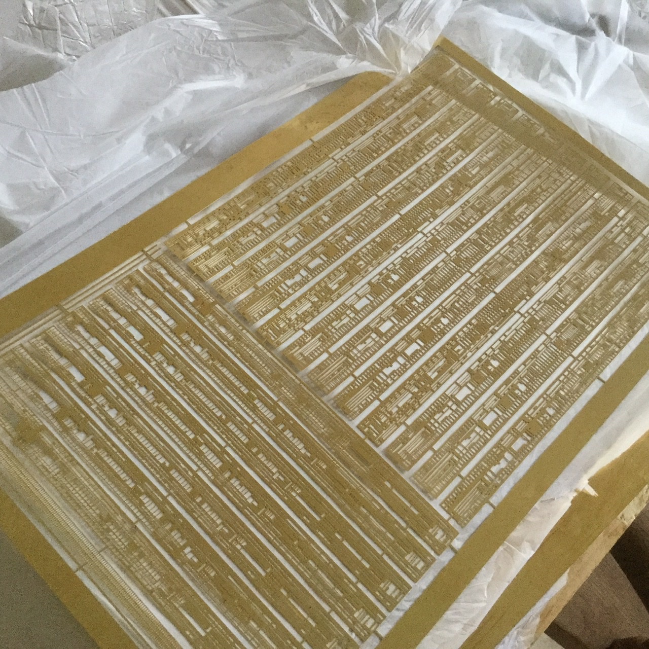

I’ve been waiting for more of the brass etching to arrive, which thankfully it has ( Covid has delayed everything). So now I can make some progress with the buttresses. The first image shows a new sheet which I had made for the bottom half underlay grid which is slightly shorter than the top section. I didn’t want to cut down (as was originally done) the piece on the master sheet so I had one made to the exact dimensions to fit the outer layer. The second sheet is for the build up of the sides of the buttresses. I did a new drawing from the original master with all 6 of the design pieces that make up the sides. Because the etching costs are pretty expensive (in the thousands because of the quantity needed),this way I get more “bang for my buck”( value ).

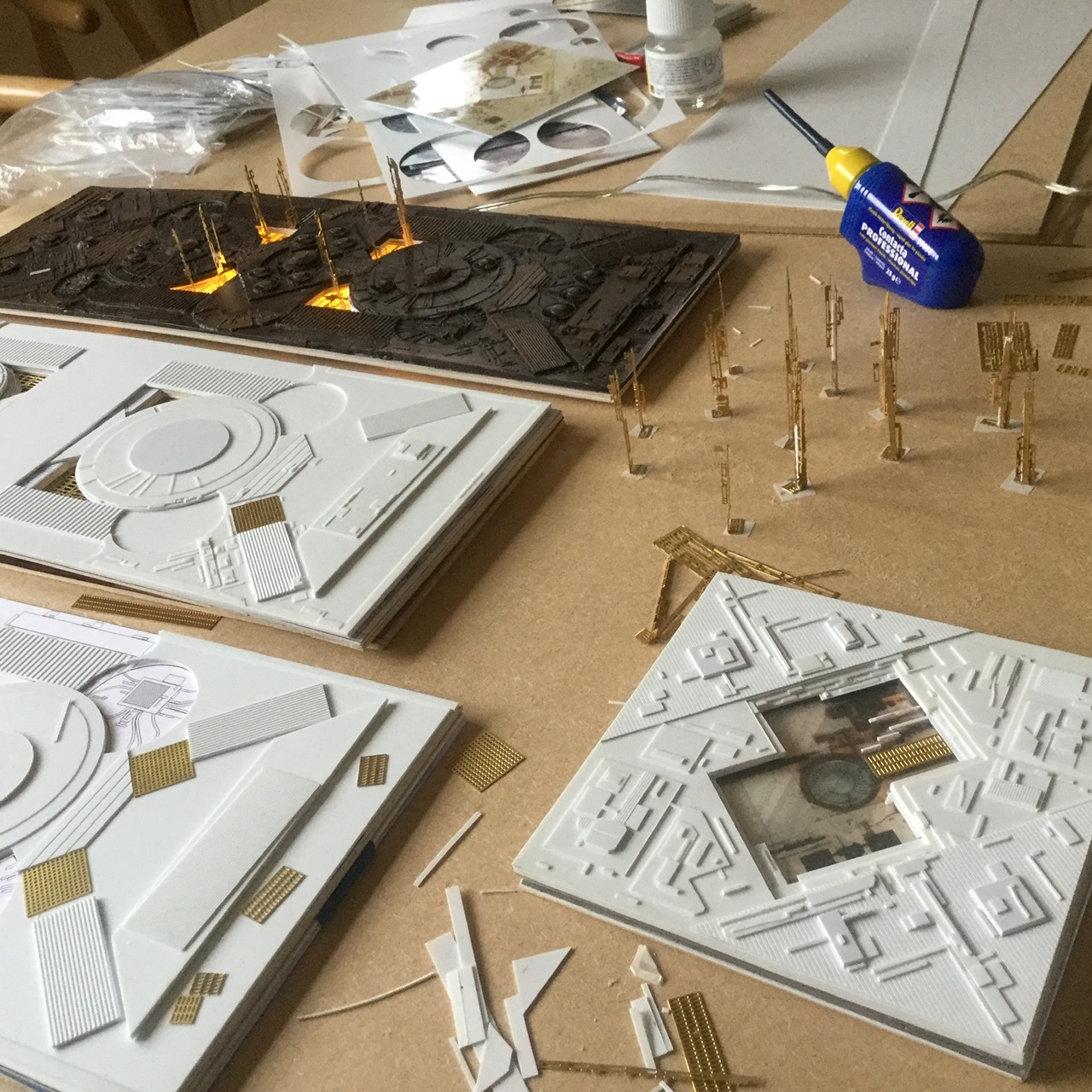

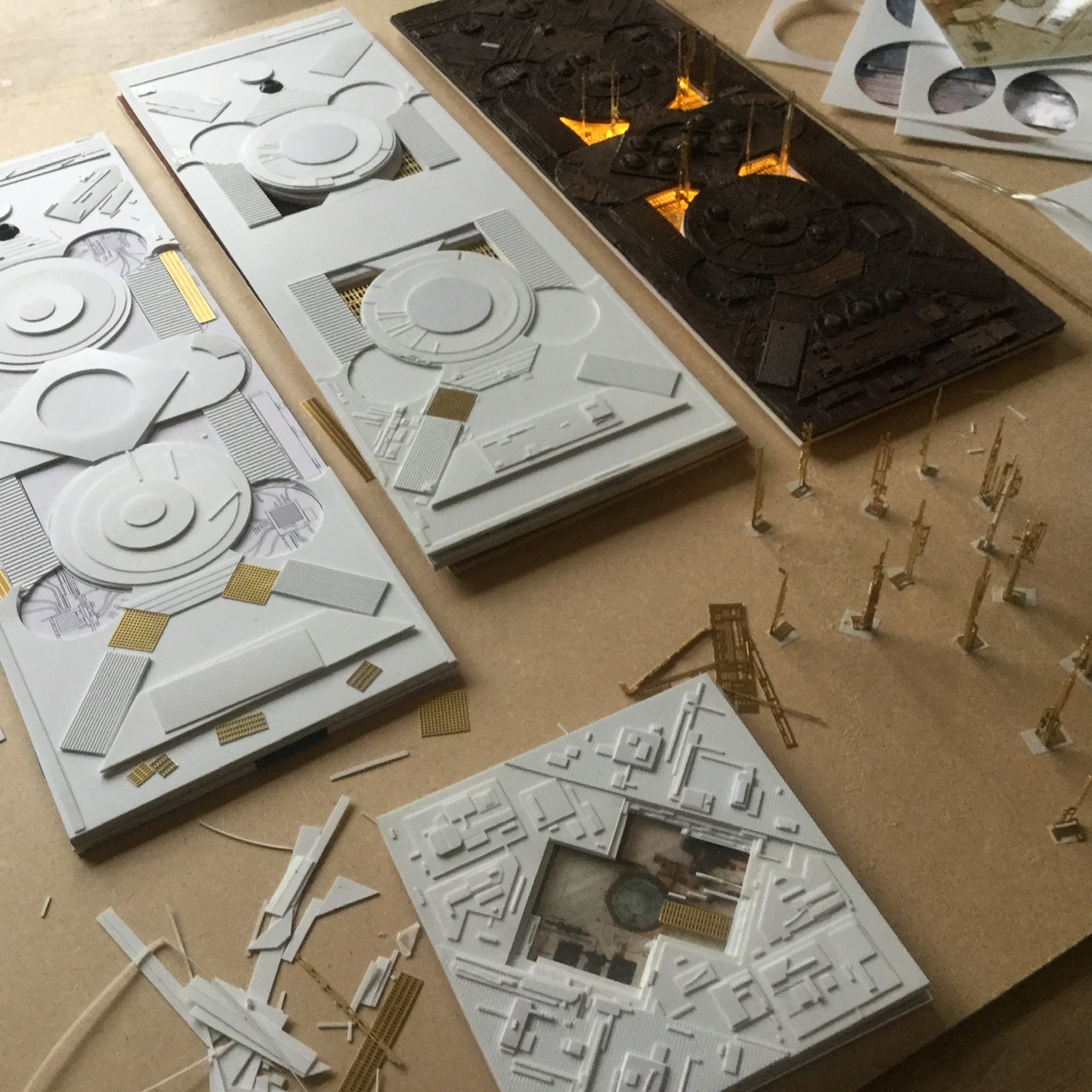

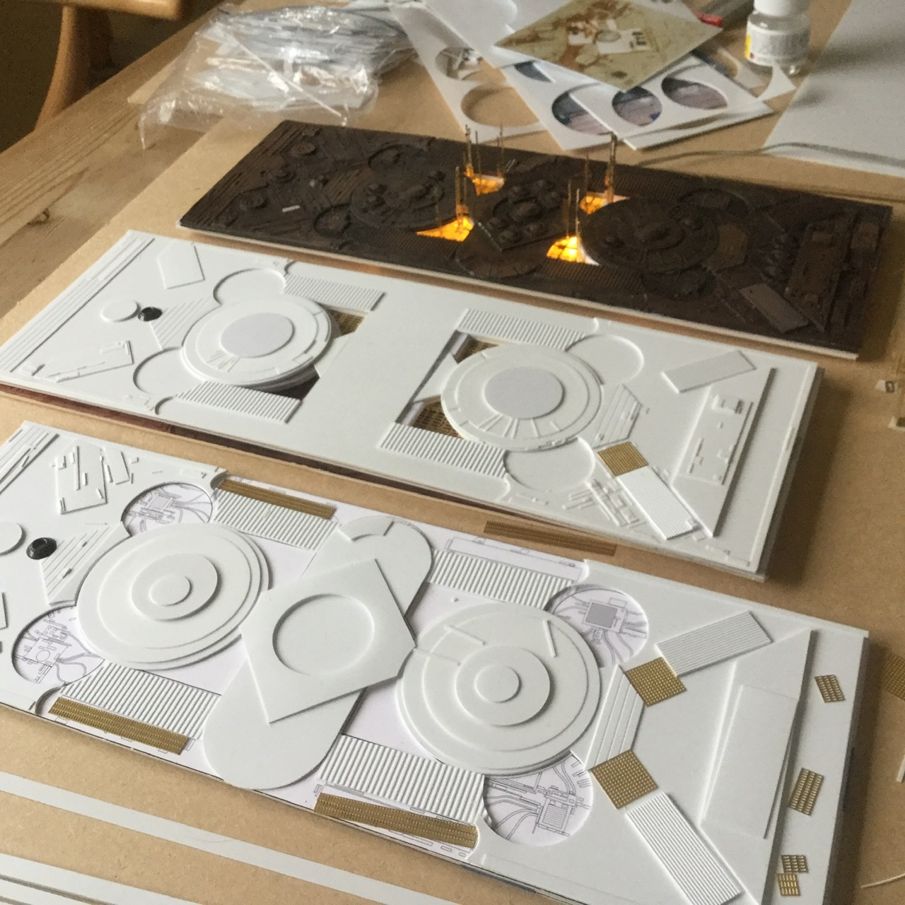

I’ve recently made a few discoveries , identified some model parts that I‘ve searched for for many years and frankly I can’t quite believe I found them. They’re on their way from the UK and the US. The parts will allow me to rebuild / build new masters without the need to 3d print the parts. So my list of unidentified parts is now down to 1 or 2 kits on the main facade.
This is what I am working on at the moment. I had made enquiries about trying to obtain a slightly cleaner casting ( and I know they’re around ) and using that on this project. Now I’ve found the model parts, I’m rebuilding. The practice of detailing with such tiny parts will help with the whole project.
