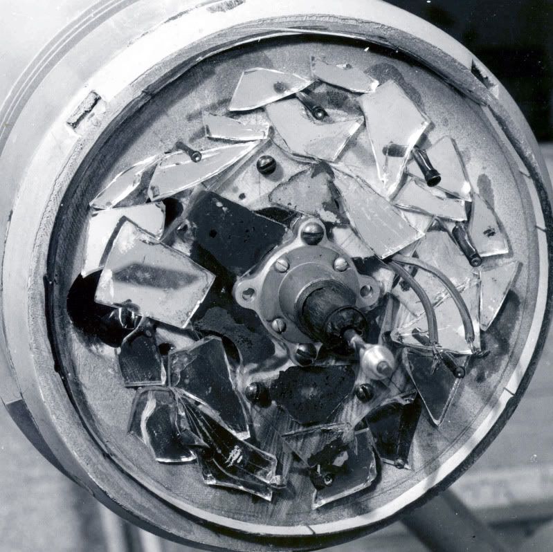

Here is the way I understand it based on the photo from when it was donated to the Smithsonian:
And in hi-res without the graphic:
You can check it out also at the Star Trek history site on one of the bottom slides here (click through the slides until you get to the nacelle part):
http://startrekhistory.com/models.html
Interesting. I just watched the start of The Tholian Web and they spin the opposite way rotating to inwards. Did a double check viewing the start of Let That Be Your Last Battlefield and they spin outwards like you show it. Then about 19 minutes in there's a shot of the port bussard rotating inwards!
So it appears the techs reversed the spin not only from one episode to the next, but even within the same epsiode.
They may have ran the film backwards.
Thanks guys. Well sometimes when we shoot things for effects we reverse print the footage. Play it backward for effect. I also noticed that sometimes the beacon over the shuttle bay blinks too. The rate of the blinking on the NAV lights changes. This can all be attributed to camera speed, direction, and lastly exposure and lighting. This is changed so often during shooting.
Steve, your explanation makes the most sense. They were getting a job done, who cares what a bunch of people think 40+ years in the future.
Here is what I came up with using the very image Feek is referring to.
I didn't put in the bulbs orientation, I was focused on the main source of light. I don't think the mirrors would have been an issue. Since you would have had several lights blinking at the same time(due to reflection).
Most of this stuff is guess work, since we have no idea of what might have been done to the model, between the time of the last shooting and the pics Feek is showing. All we can do is attempt to recreate the effect, and if it meets one's perception, then it's done.
I was thinking of matching this on the 11 footer, but I'm opting for something much more uniform and efficient(leds). As well as not dealing with the heat issue.

Looking at the photos of the seeming chaos inside that nacelle from the photo of tv model it looks more like the aftermath of someone taking a sledge hammer to the lights than something that was done on purpose to create the effect we came to love! I always thought the lights were moving inside and not the 'cage'. It's great to learn something new.
