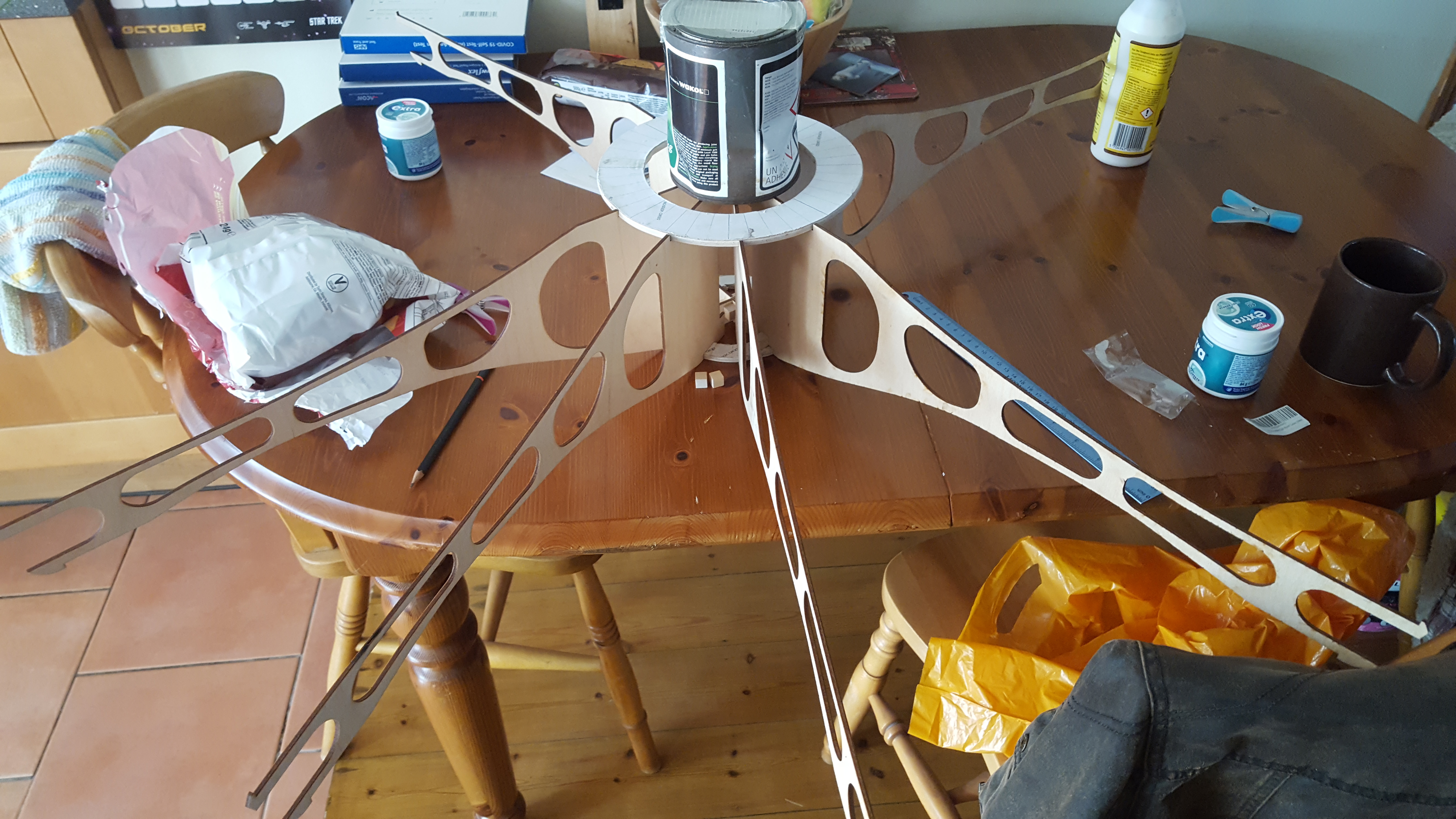

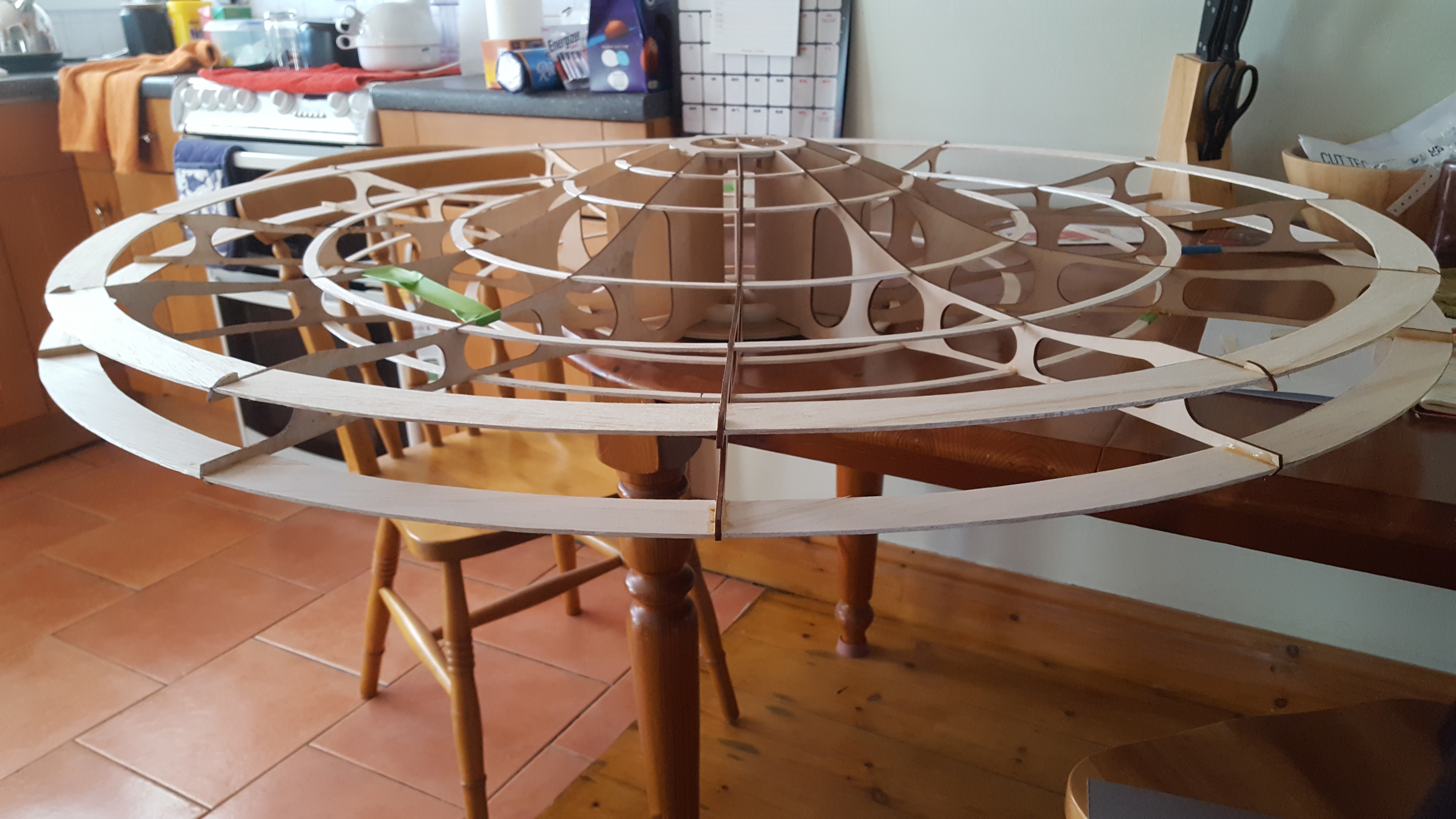

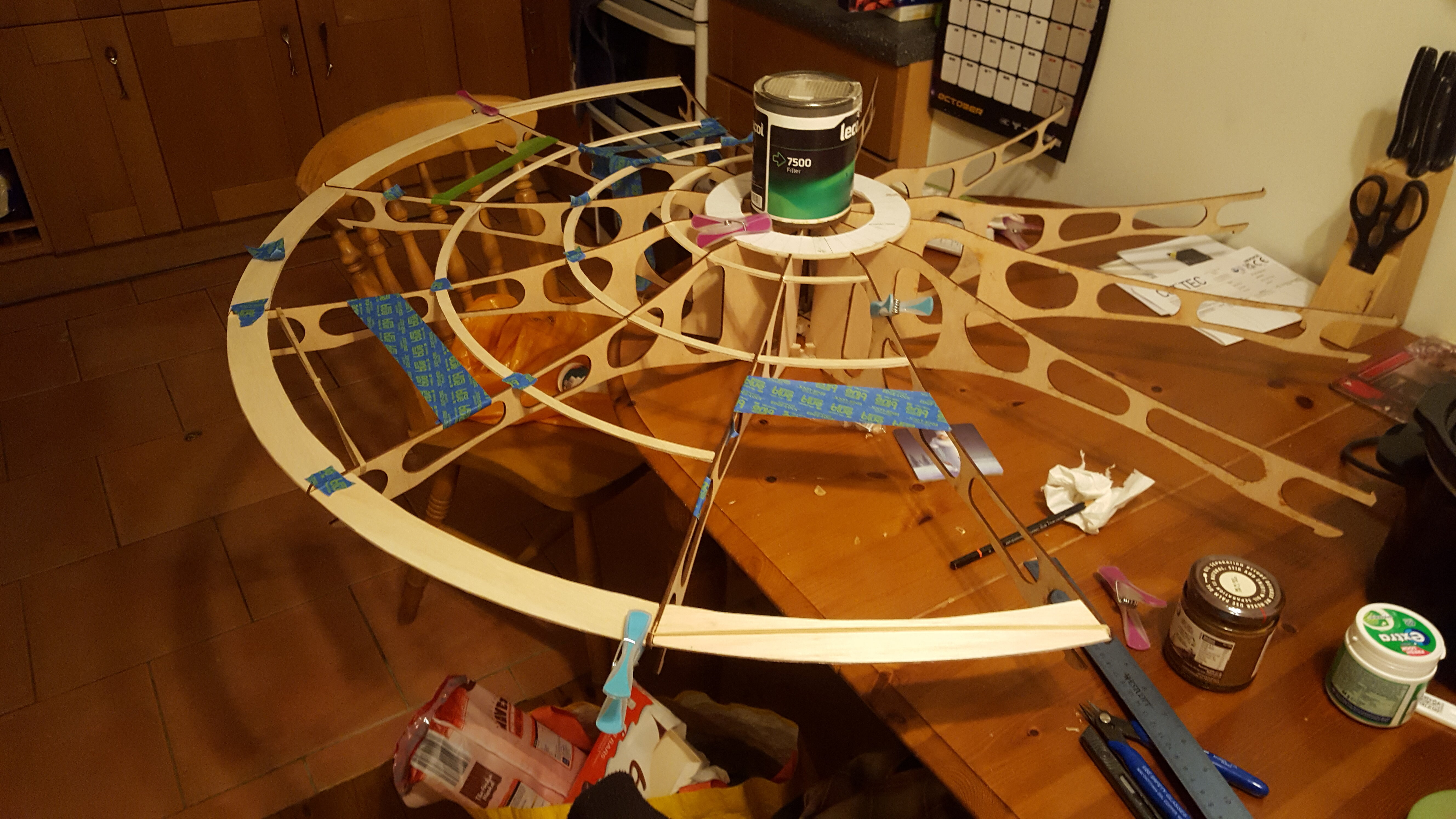

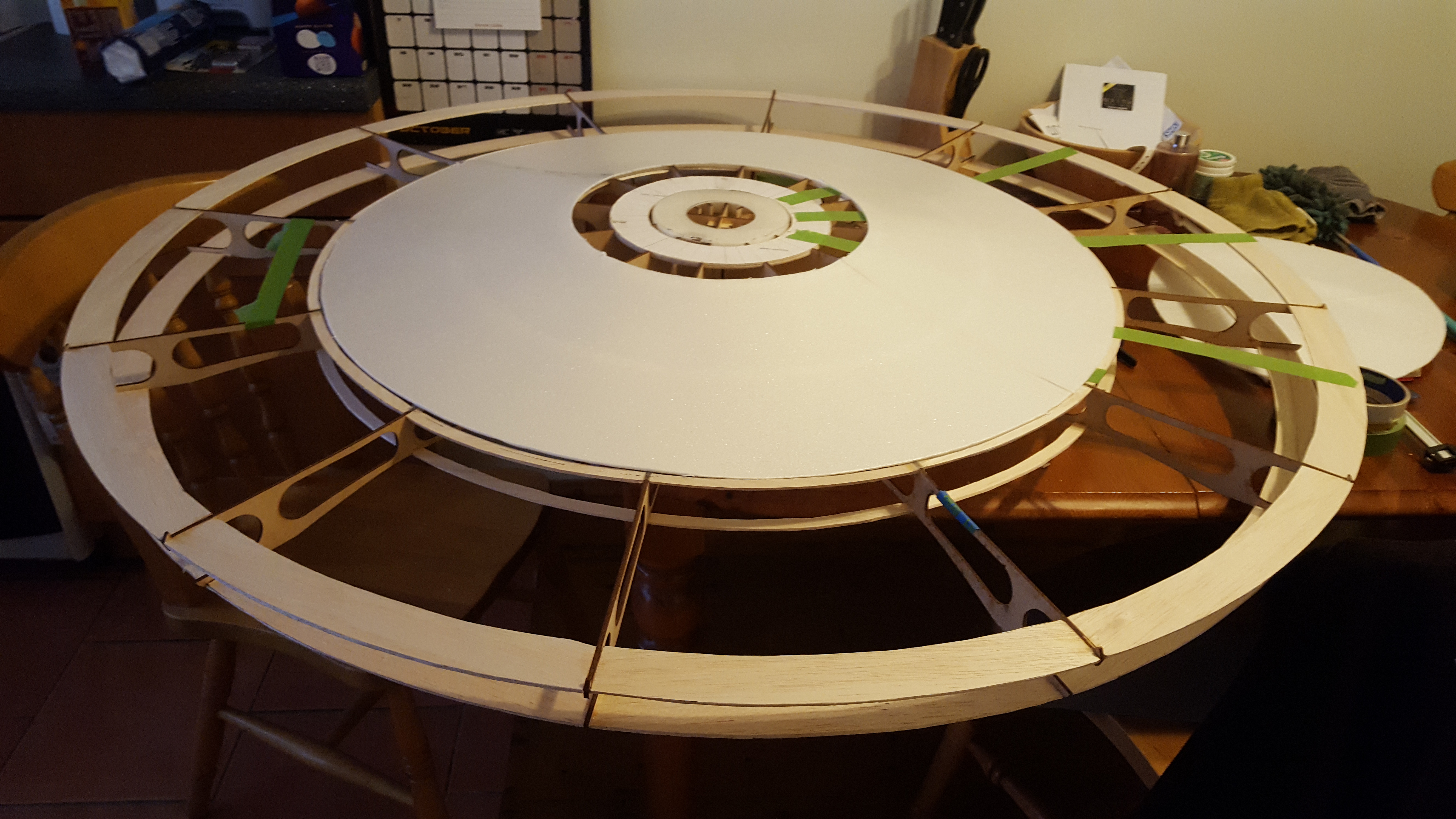

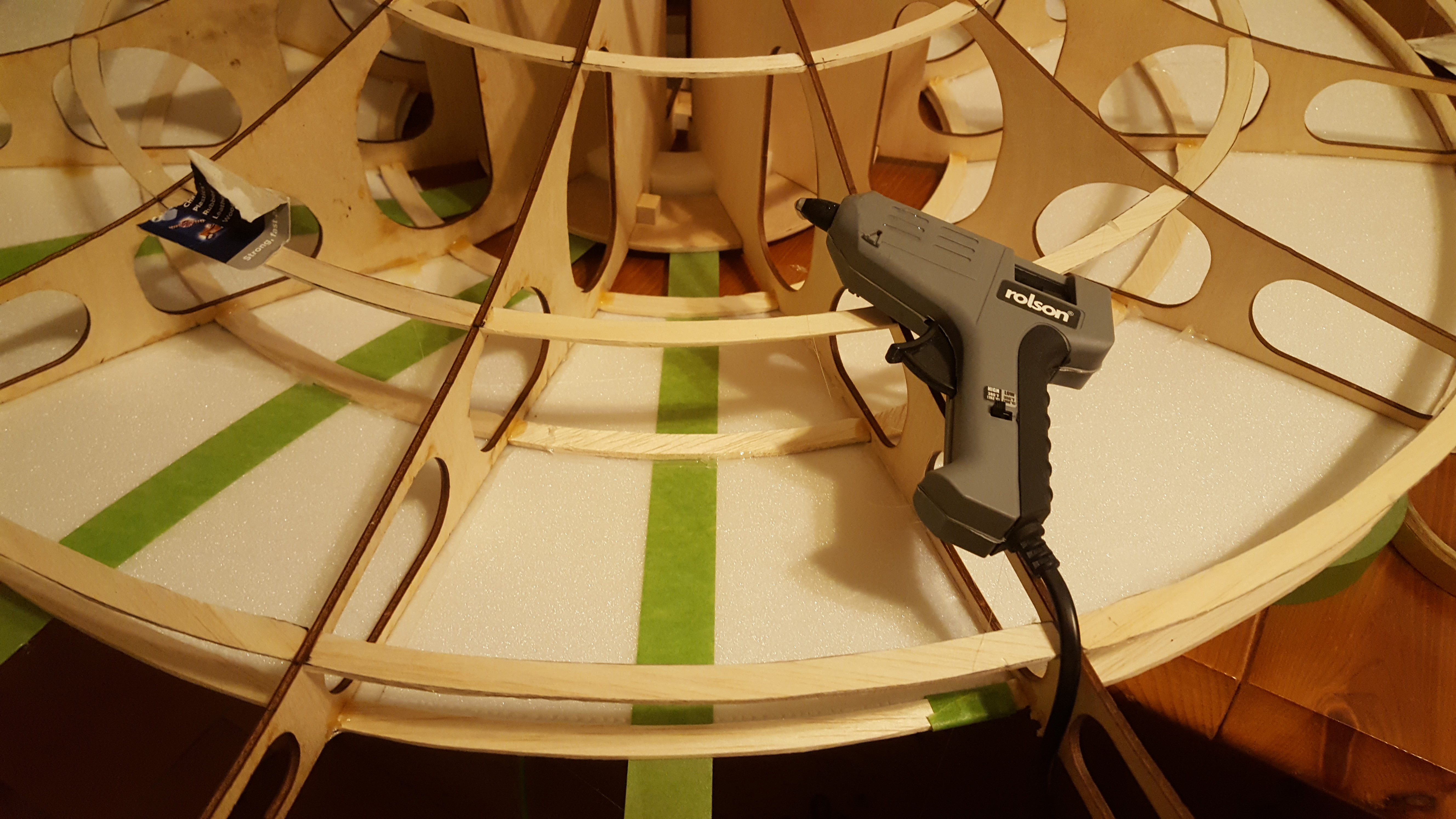

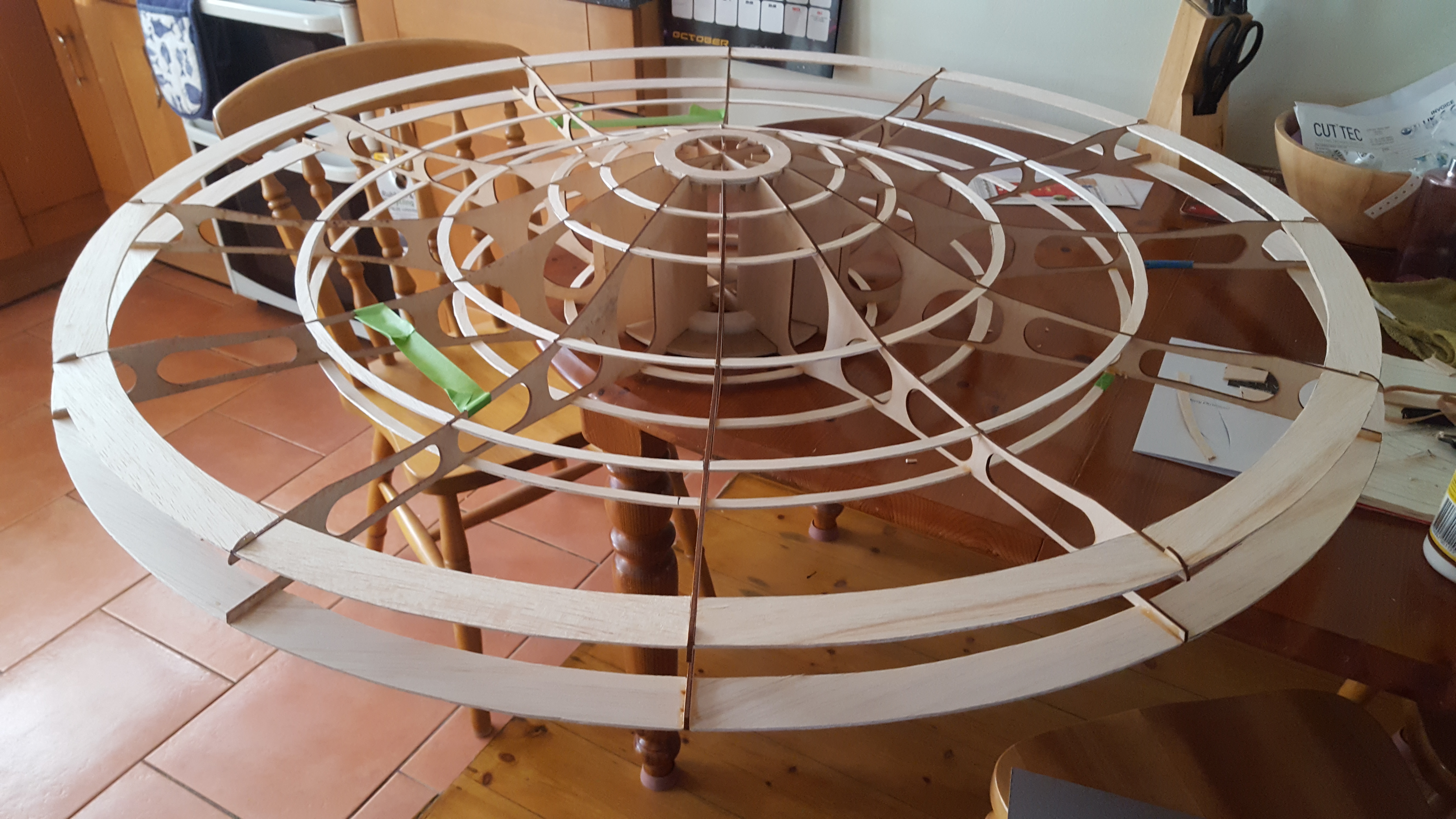

1. I made a cad file of the saucer, so I could get a main wooden frame made up. other parts were cut out from balsa wood sheets.
all looking good so far. theres a little twisting on some of the wood fame i had made up but it didnt effect the overall shape.

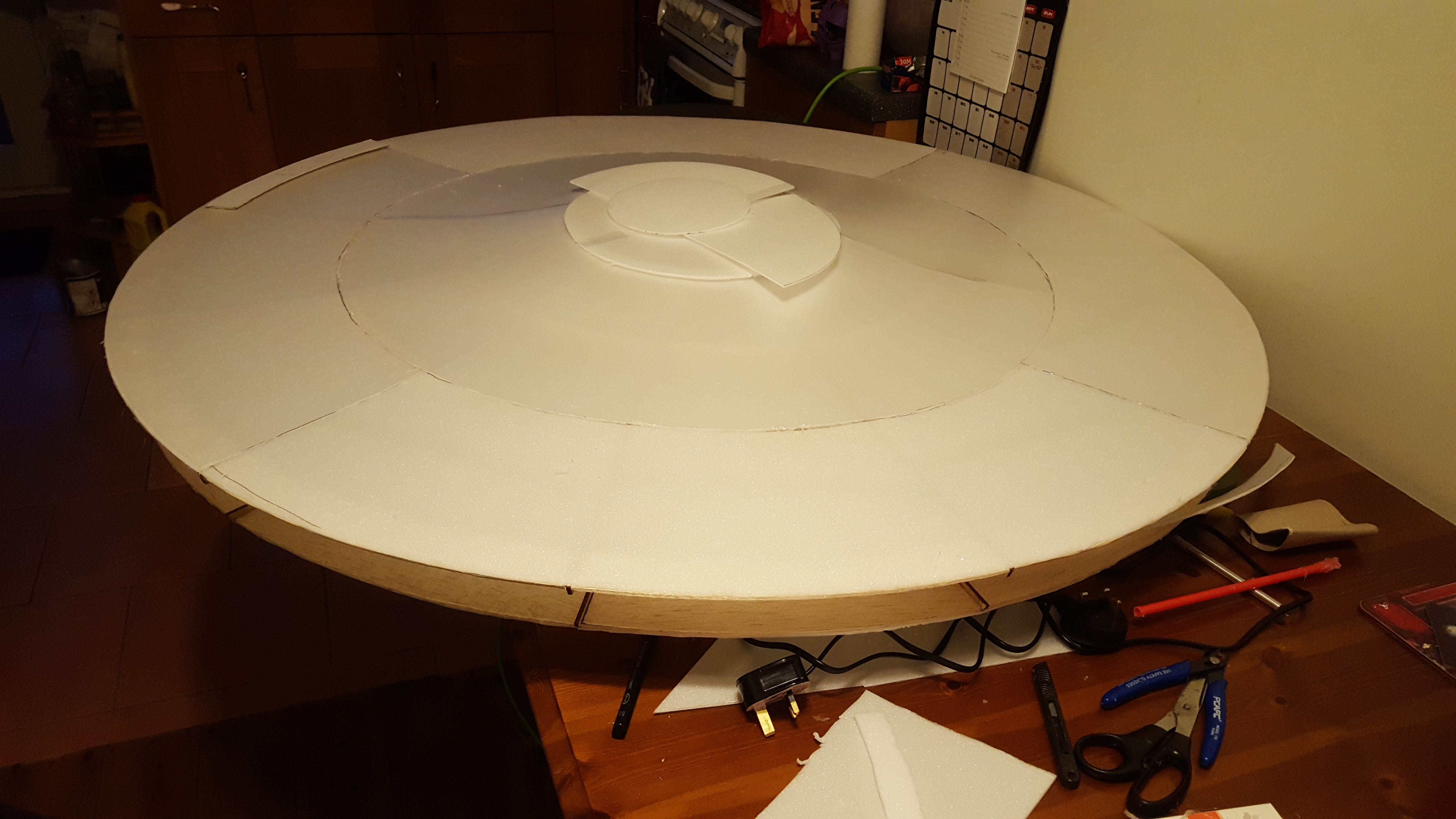

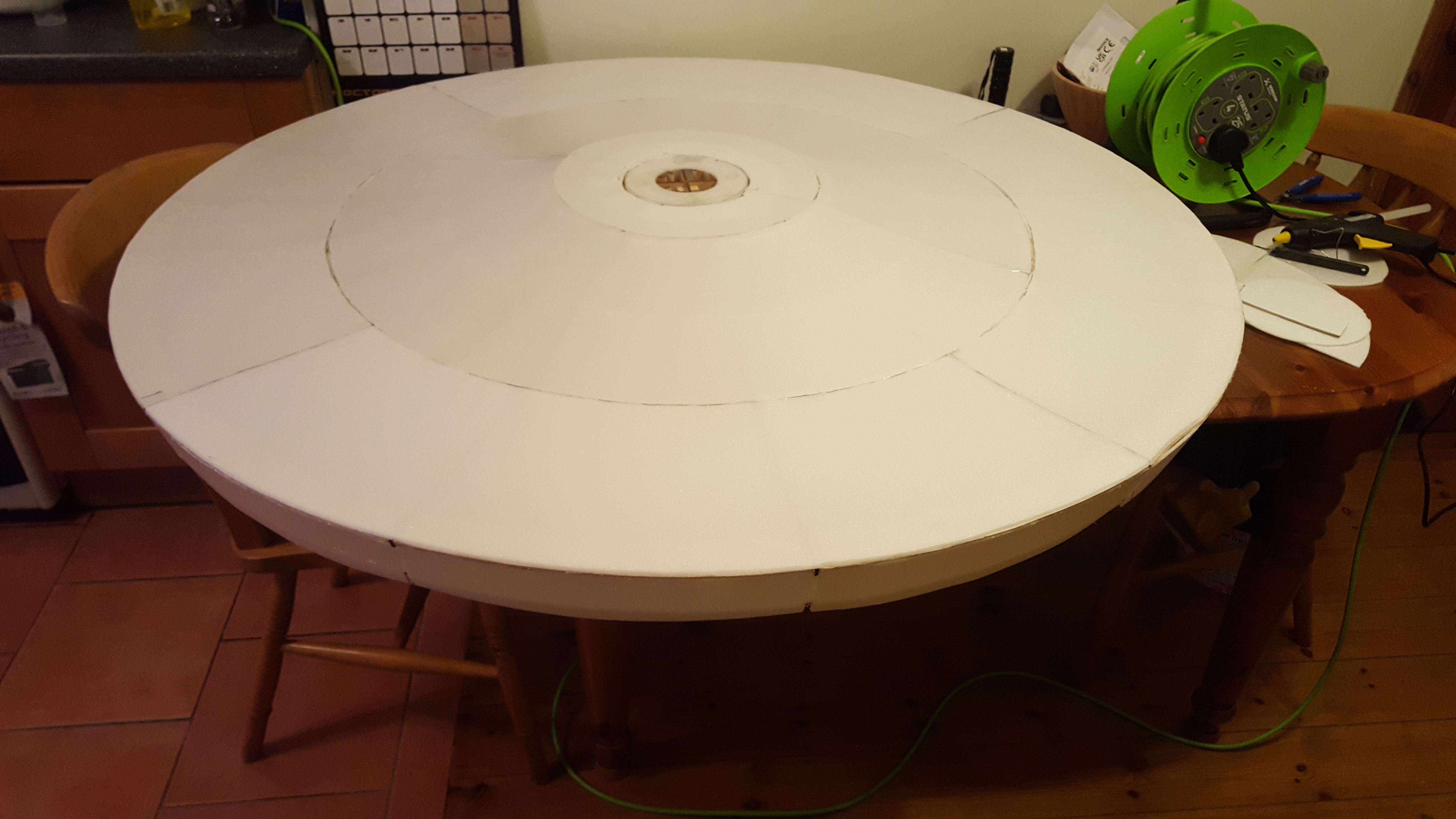

got some 1mm polystyrene sheets from B&Q to cover the saucer with using hot glue to hold them to the frame.
bit of sanding to get the edges ok

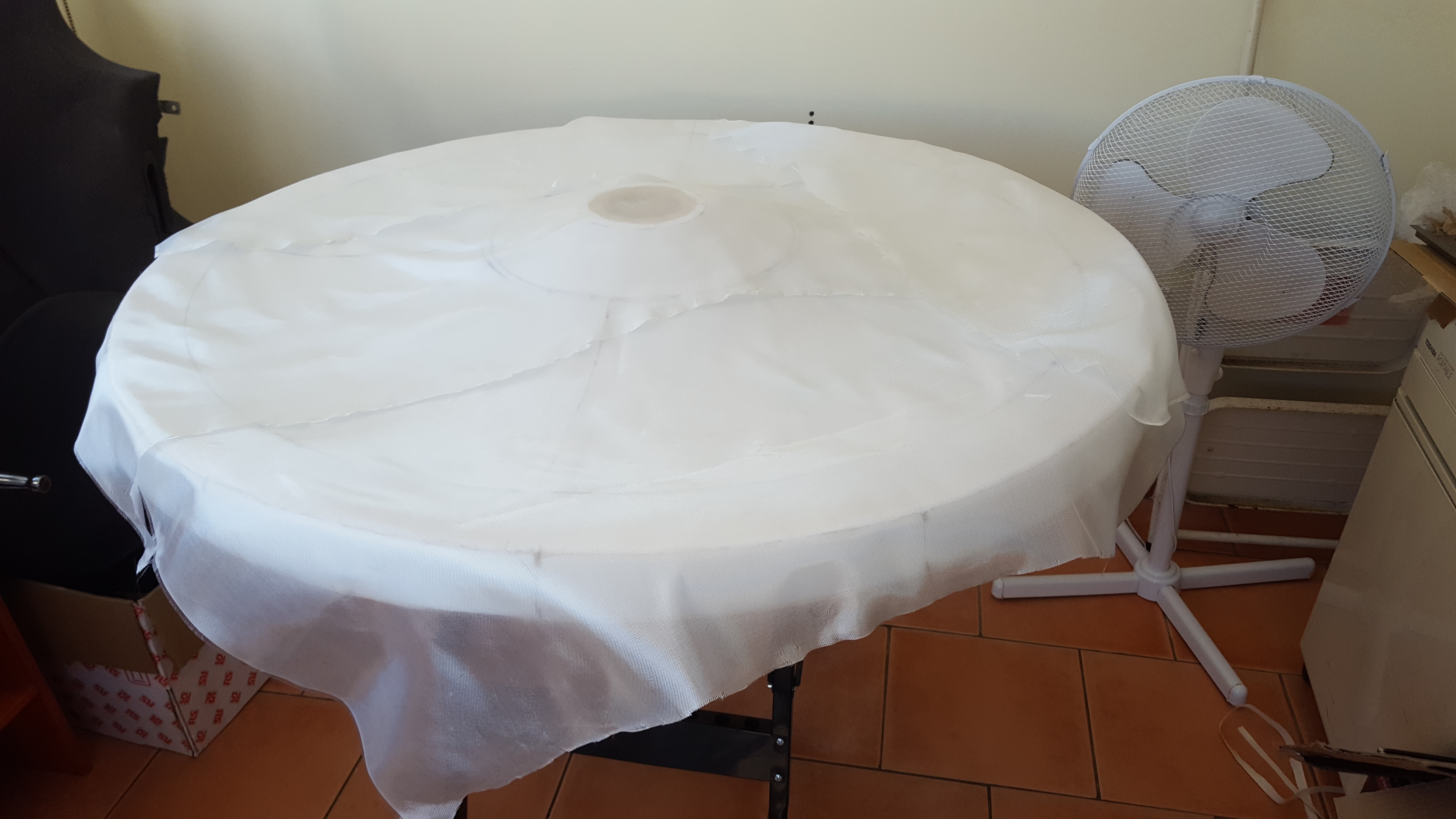

So far so good, its taken shape. got some west resin 105 epoxy to glass the thing to add more strength using Plain Weave Fibreglass Cloth.
The resin dry's alot faster than expected and the cloth moves around some if you cut it into sections for glassing (this is my first attempt at this BTW)

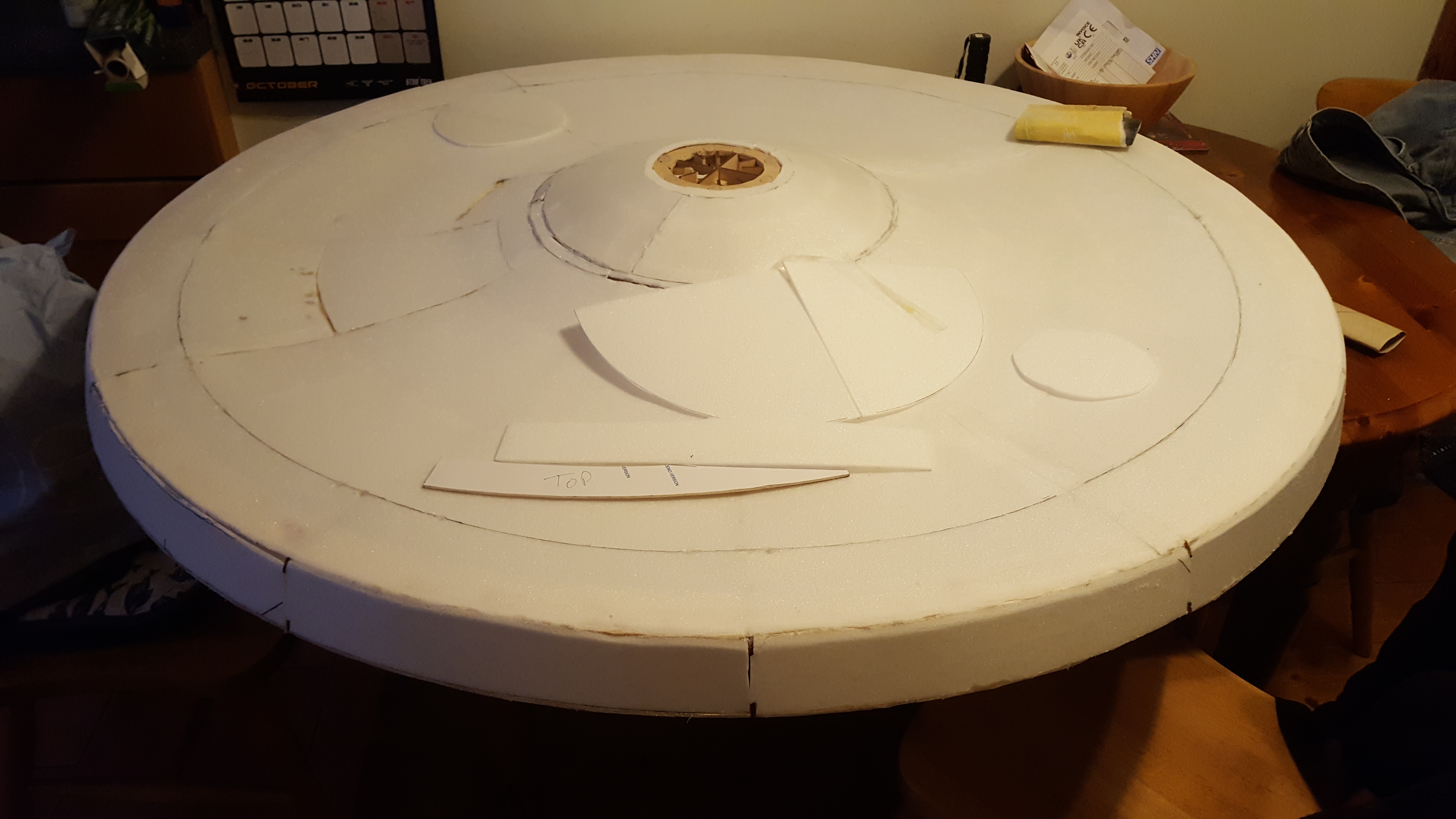

After two layers of glassing there were still sections on the saucer which would flex when pressed. I decided expanding foam would be good to add strength and keep the weight down. Drilled holes around the saucer to insert the foam and sprayed away

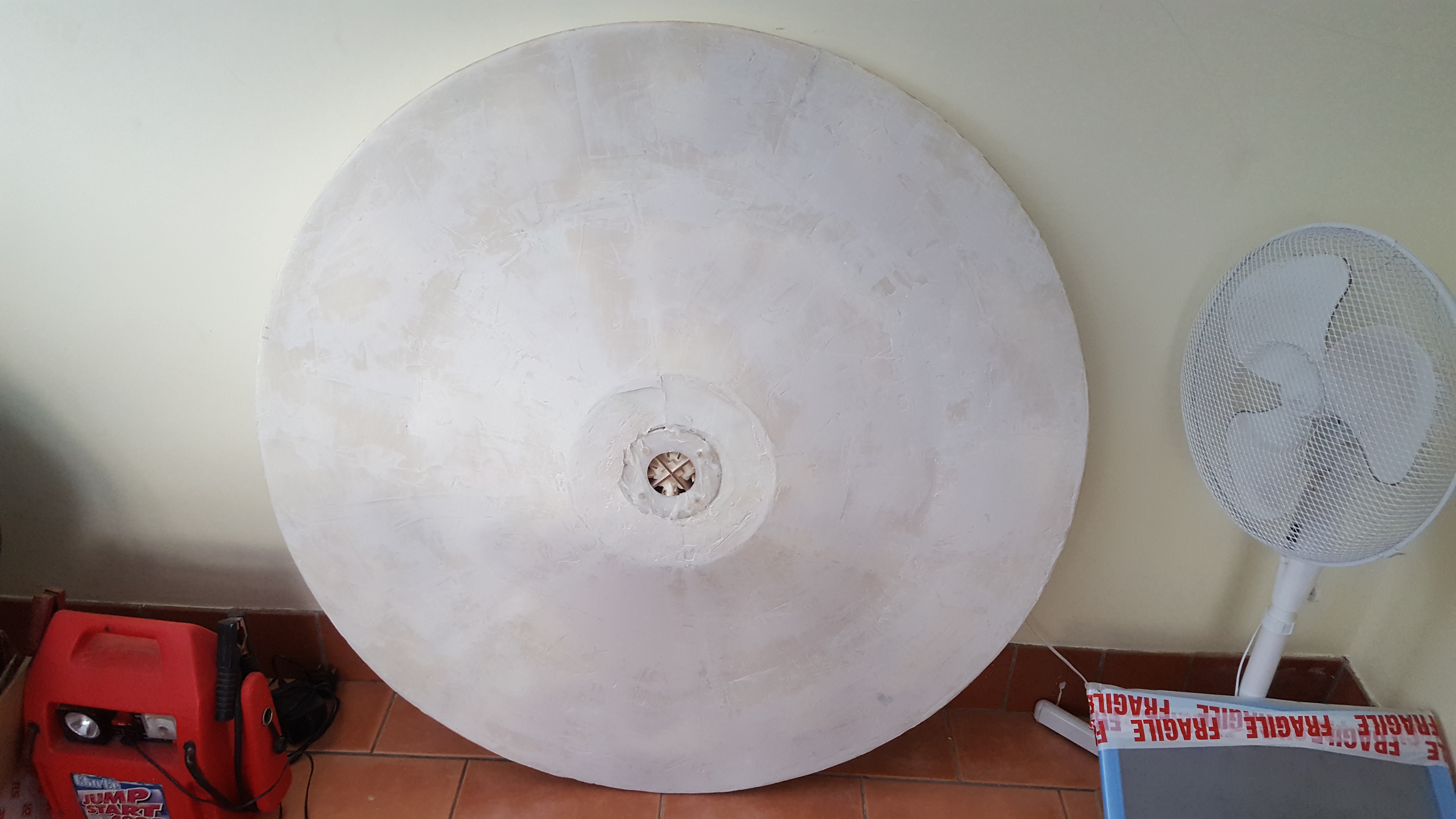

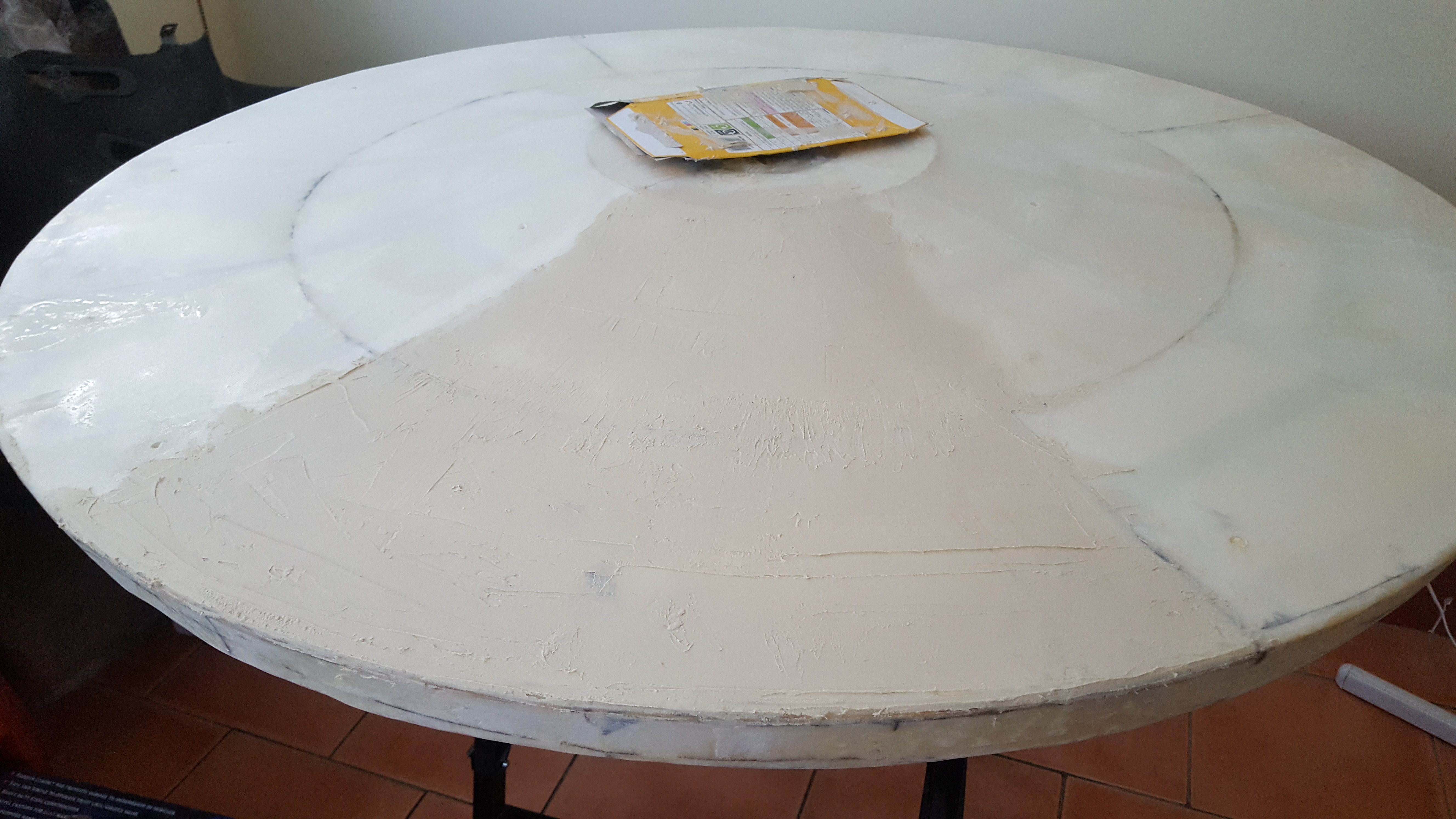

to get a nice smooth finish i used car body filler (light weight filler). plan is to layer the thing smooth for painting.
just about there
this is where things went wrong on the build! Checking the width along the saucer edge, I found it had become thicker in some places than others, due to the expanding foam, pushing the polystyrene up to the point where it would not be practical to continue.
Maybe one day I could cut it to make a uss reliant, as i can cover the out of spec parts of the saucer. In any case i did learn quite a few skills along the way.

How far out is it? Are you able to construct some sort of level turntable/lathe assembly and rig a sanding element to shave this down and save it? Even if you take it to the foam, you could always re-skin the saucer, saving all the work you’ve put in so far. :unsure:
Imagine a large turntable. Shape one side then flip over for the other. You’d need to install a temporary and secure, central ‘hub’ in the saucer.
I’ve seen foam M. Falcon dome bucks shaped this way. Works pretty well
Maybe this one, ; )
Maybe this one, ; )
Yup, yours! Totally forgot who pulled that off - seriously cool process!
its about a centimetre thicker in places. with the expanding foam i think it would be a real headache to rip parts of it.
I do have enough spare frame parts to try again though so i would prefer to start again
