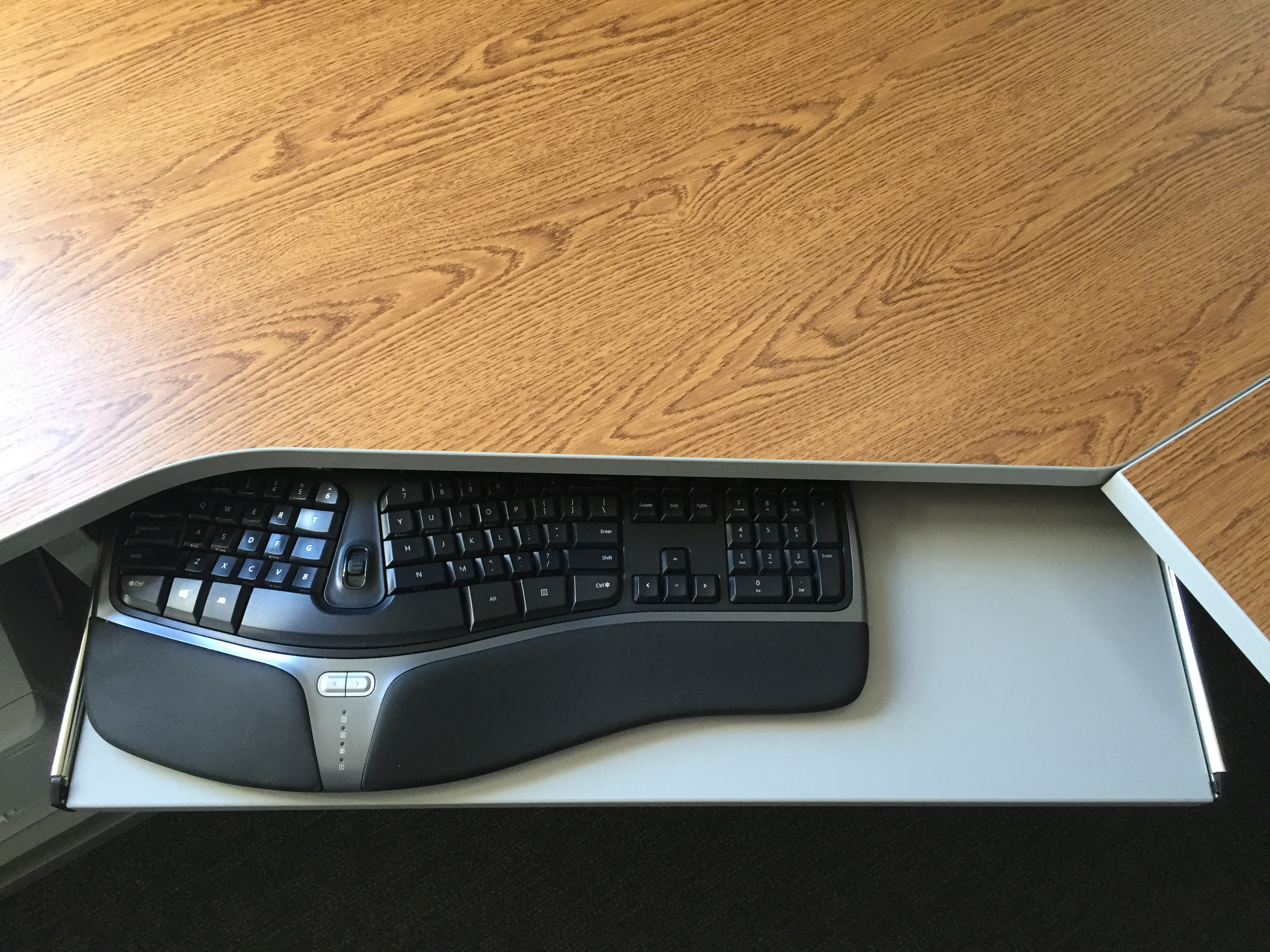

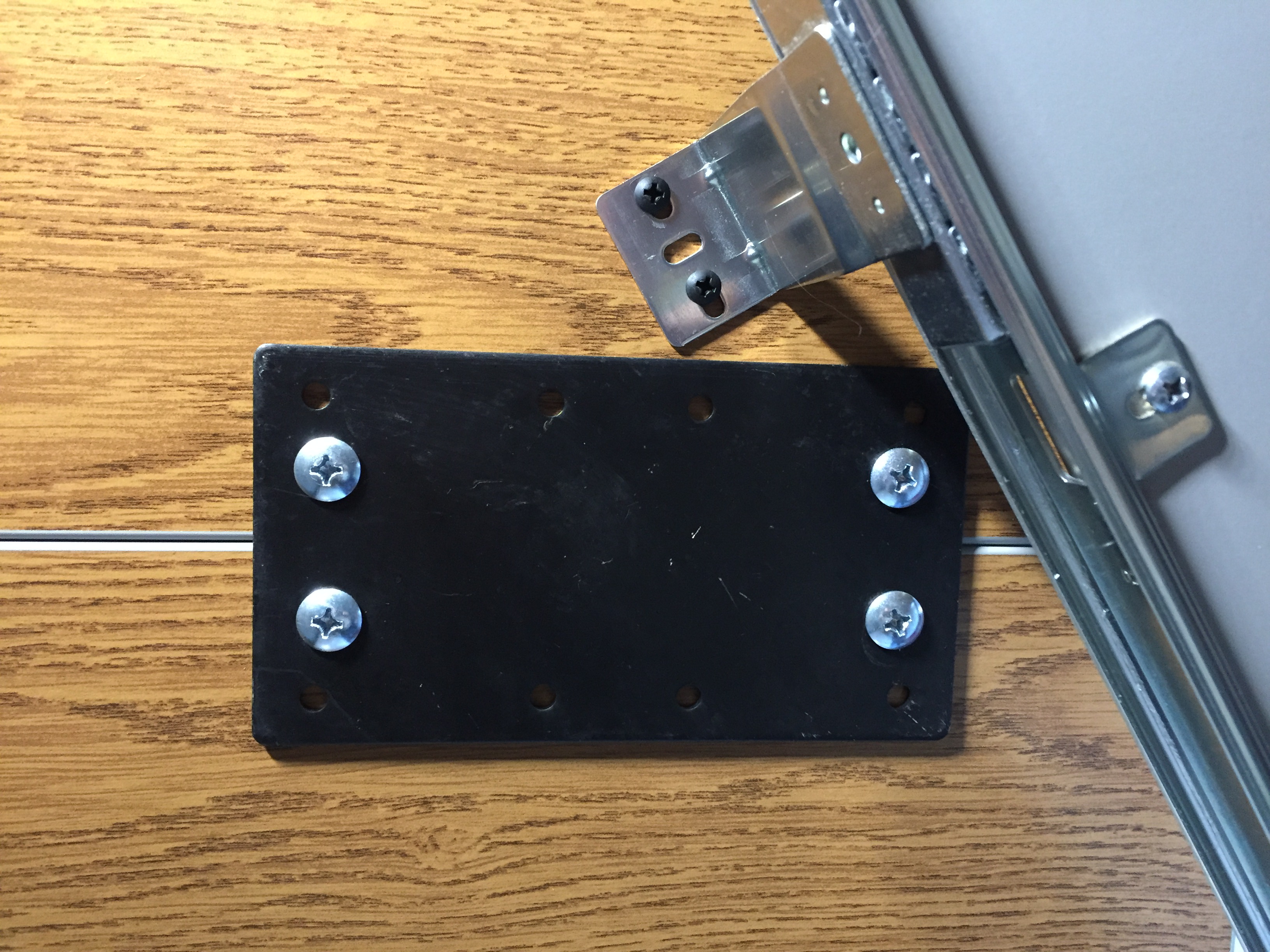

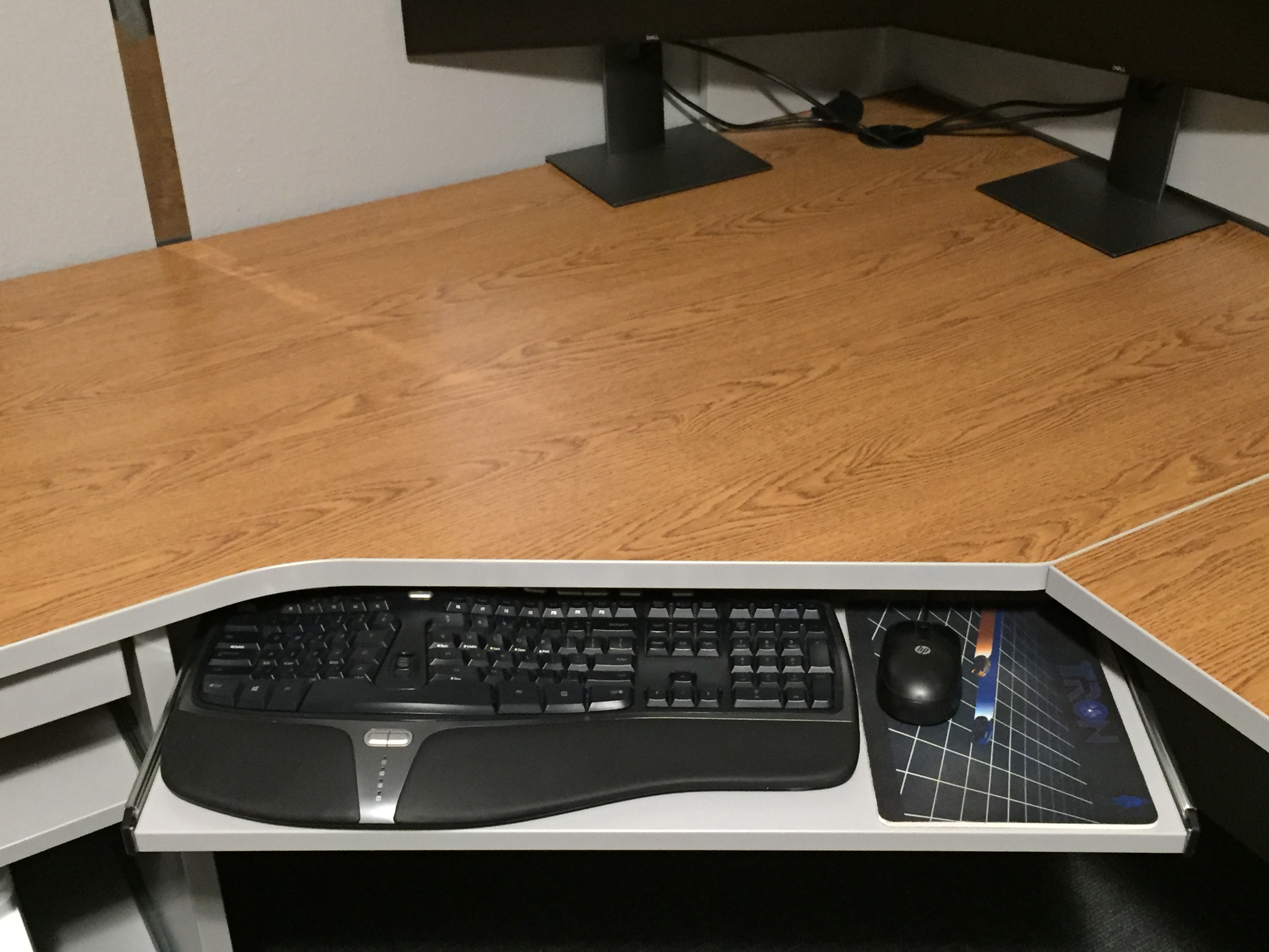

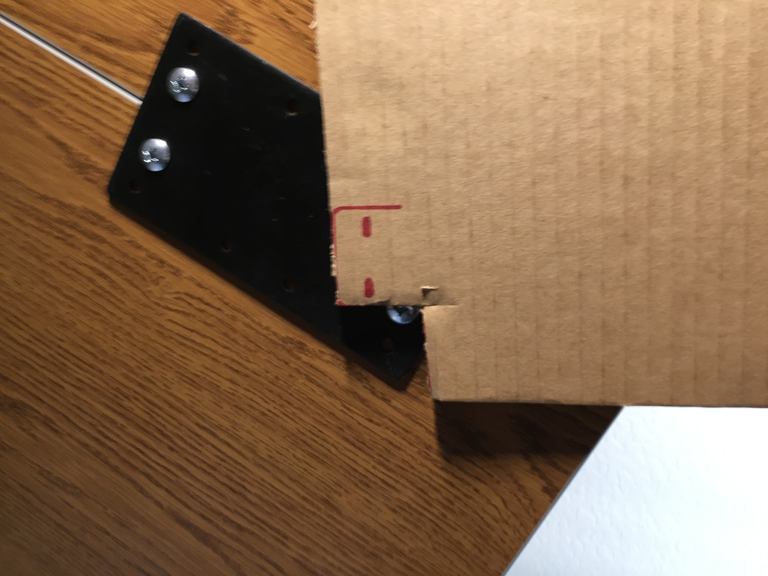

Alright, some significant progress made today. First on the agenda was installing the oversized keyboard tray. You'd think Maverick would have had this all worked out, since I bought the desk and keyboard tray at the same time - obviously I intended to use the larger tray in place of the standard one. But my cardboard template for the bracket locations revealed a big problem:
In the tray's optimal location one of the desk's metal brackets for connecting the right side interferes with one of the tray's brackets. Dang it. Since there was no way I was drilling two holes through 1/8" hardened steel the only workable solution was push the tray back:
The bad news about this is now the tray doesn't extend as far as it's meant to:
For what this desk cost, the expectations were a lot higher than the shoddy manufacturing I'm seeing. Luckily my ergo-keyboard is large enough that I can just pull it back while working, but really - at $3,500 I shouldn't have to be doing that.

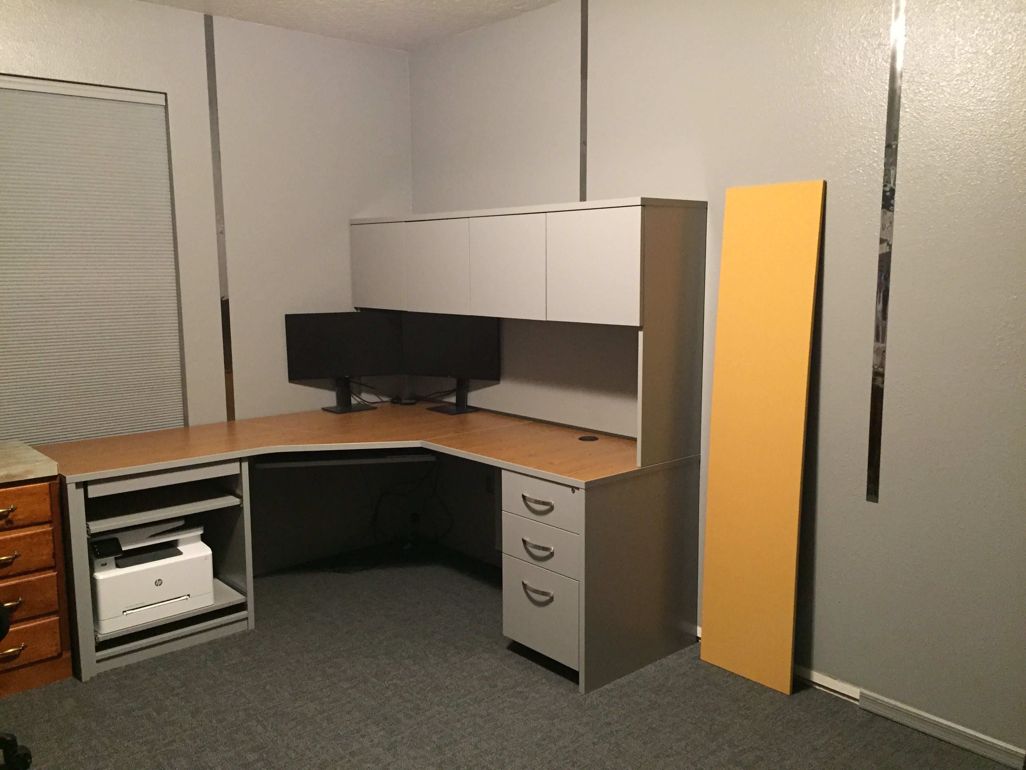

After another seemingly daily trip to a home-improvement store getting replacement drawer sliders for another customization, I finally got all the pieces assembled from the initial furniture delivery and after 3 months of working from the kitchen table I get to start working from my new desk tomorrow:

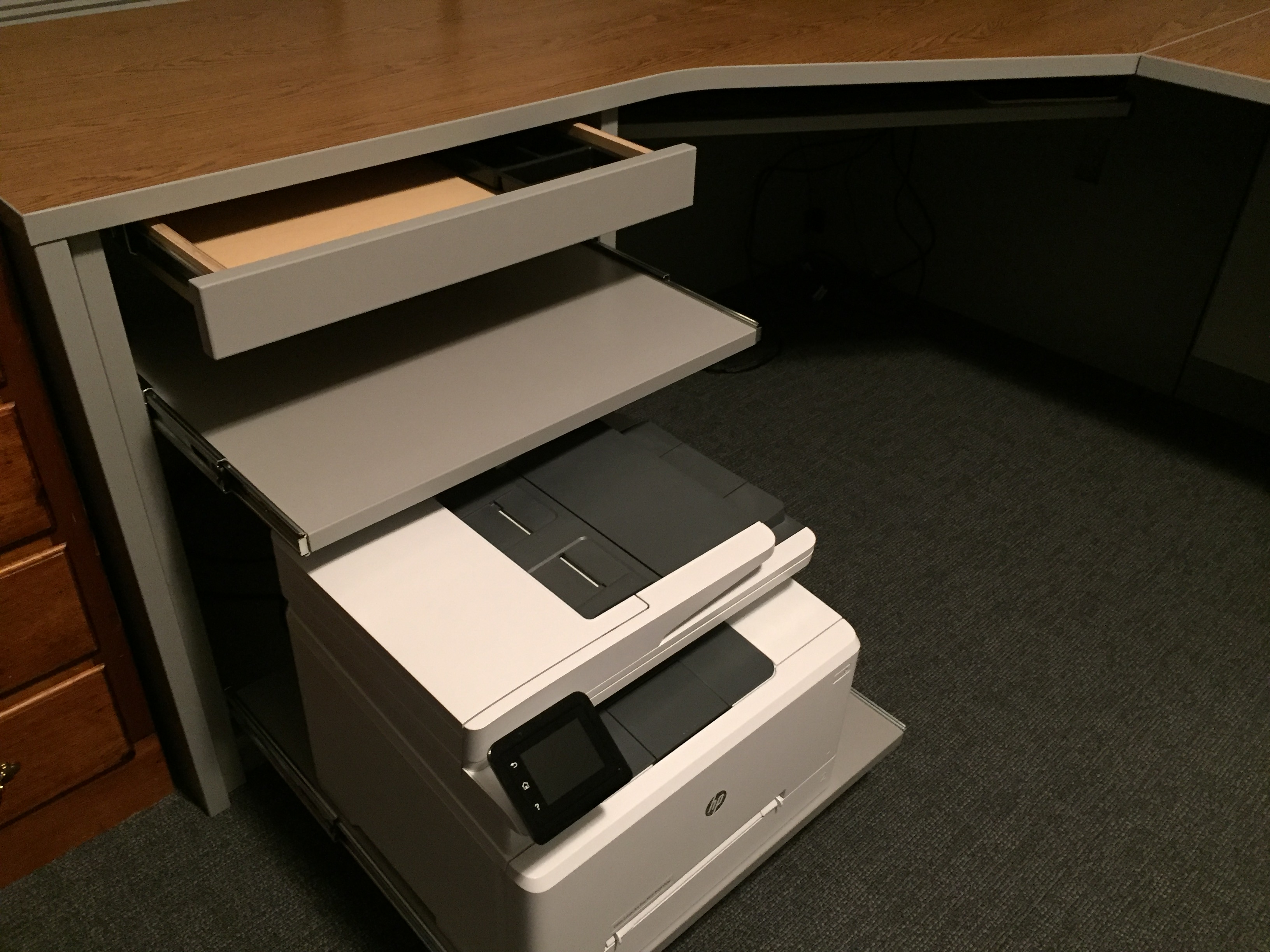

And now a brief up-close "tour" beginning with how most of today was spent, left-side customizations:
Up top is an office drawer so I don't need to keep all my pens, stapler, USB drives, etc on the desk anymore. Under that is a roll-out paper shelf for utilizing the space between the top drawer and laser printer, which was a good use of the standard keyboard tray that came with the desk (but needed its width trimmed 1/8" to fit the opening). At the bottom is a roll-out printer shelf, handy for accessing a flatbed scanner on top of the machine. And yes, all the work was done with my typical attention to detail:

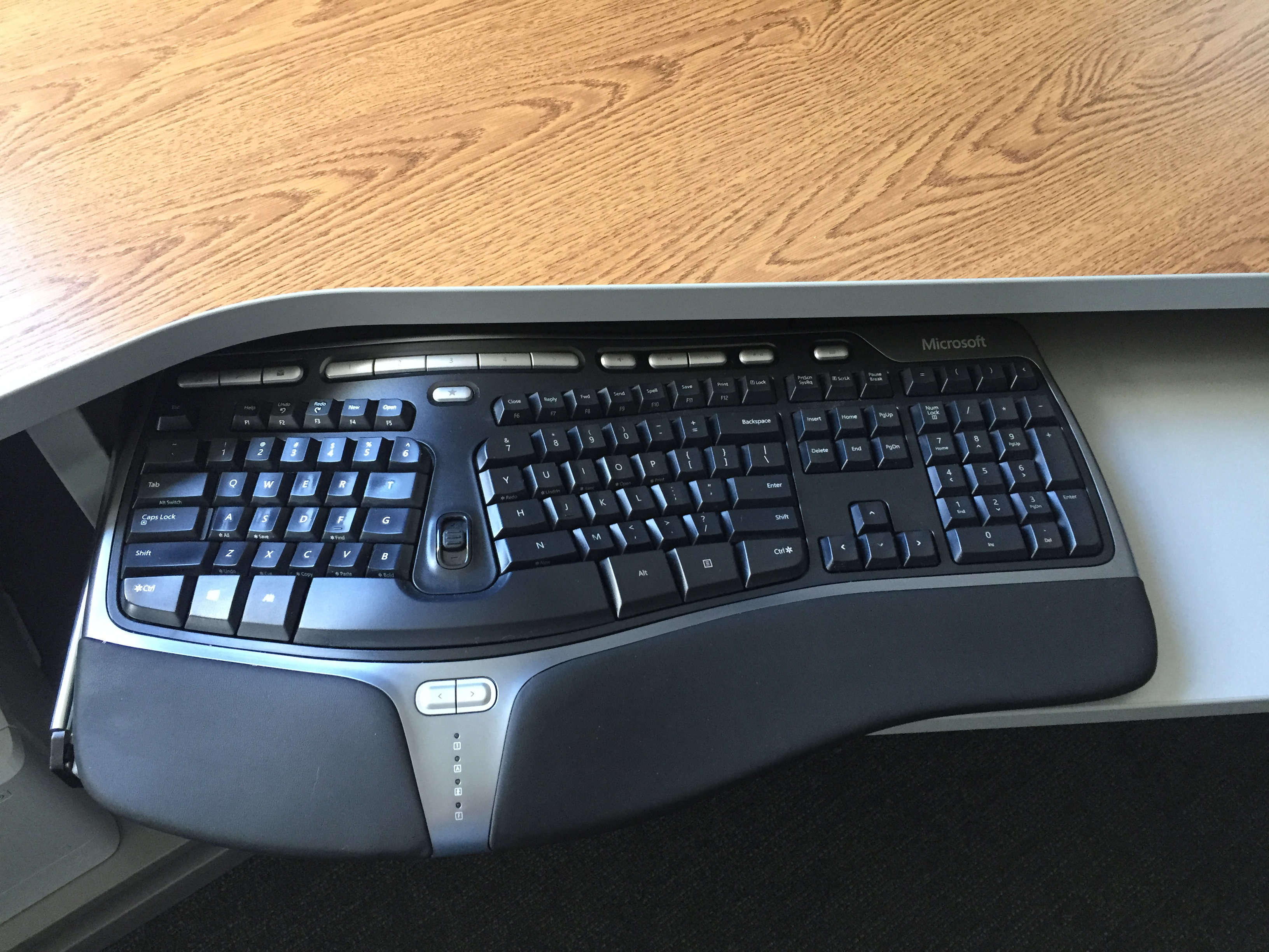

Here's why I wanted an oversized keyboard tray (the TRON mousepad probably isn't Starfleet regulation):

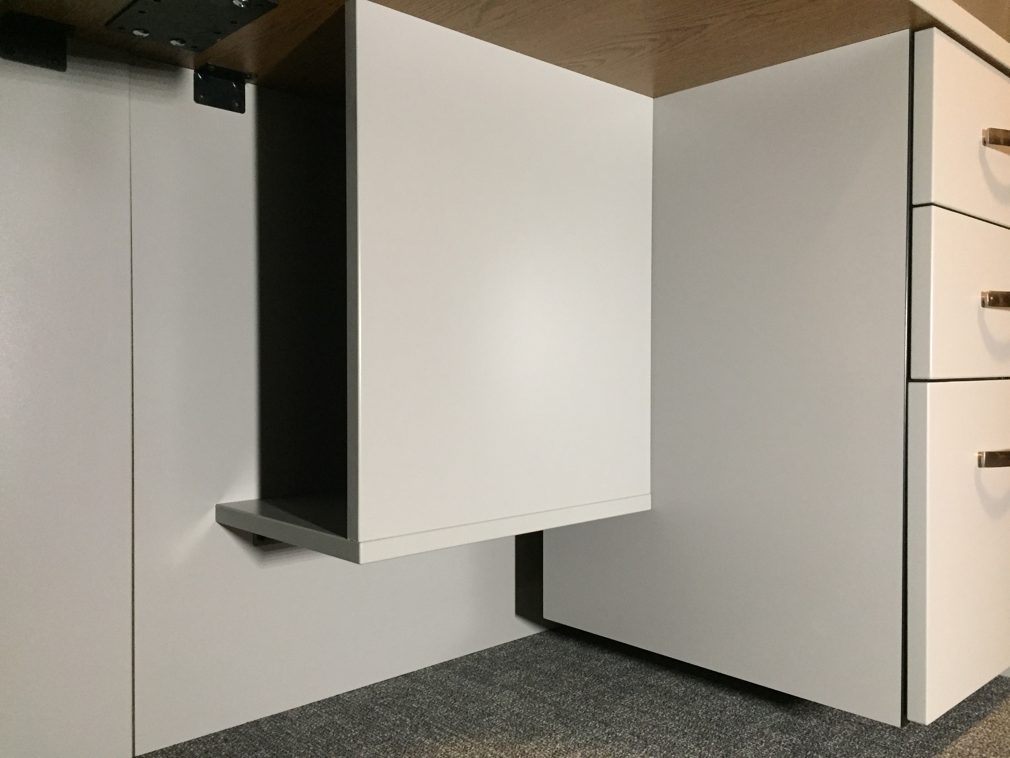

Lastly, hidden under the desk beside the right-side drawers is a PC shelf:
Although my job remote-work system uses an HP notebook and I use a MacBook Pro for anything "serious", an ancient 32-bit Windoze PC is needed for interfacing with my Alps printer, so this shelf provides a nice out-of-the-way place for that computer.
The next few days will be mostly just "moving in" work (populating the cabinets and drawers) and finishing the gray transformation of the long shelf going above the closet doors. I'm also ready to start working out the desk intercom location and assigning functions to the 8 rocker switches. Each switch will be functional, such as activating the monitors (I mean, viewscreens...), the old PC (so I don't need to reach under the desk), a KVM switch (for the two PC's to share the same keyboard, mouse, and monitors), hutch lighting, colored accent lighting in the room, etc.

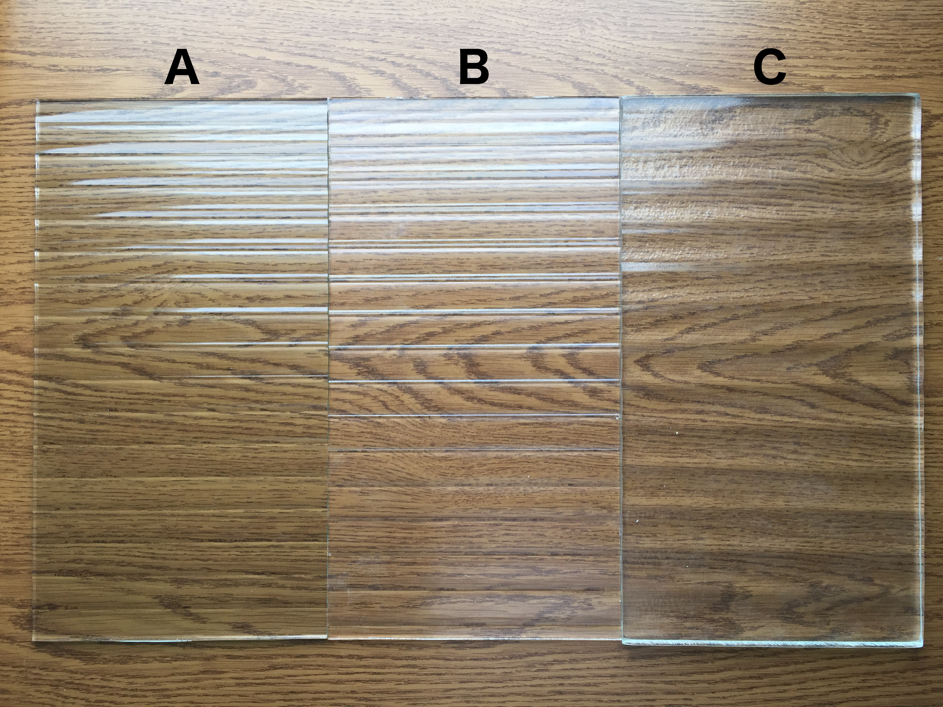

Well, much seems to be on hold at the moment. Don't have the painted closet doors back yet, don't have the next furniture delivery, and don't have any volunteers to help with the wall electronics, but I do finally have all 3 pieces of glass (been waiting since November) so it's now time for an analysis and hopefully some feedback.

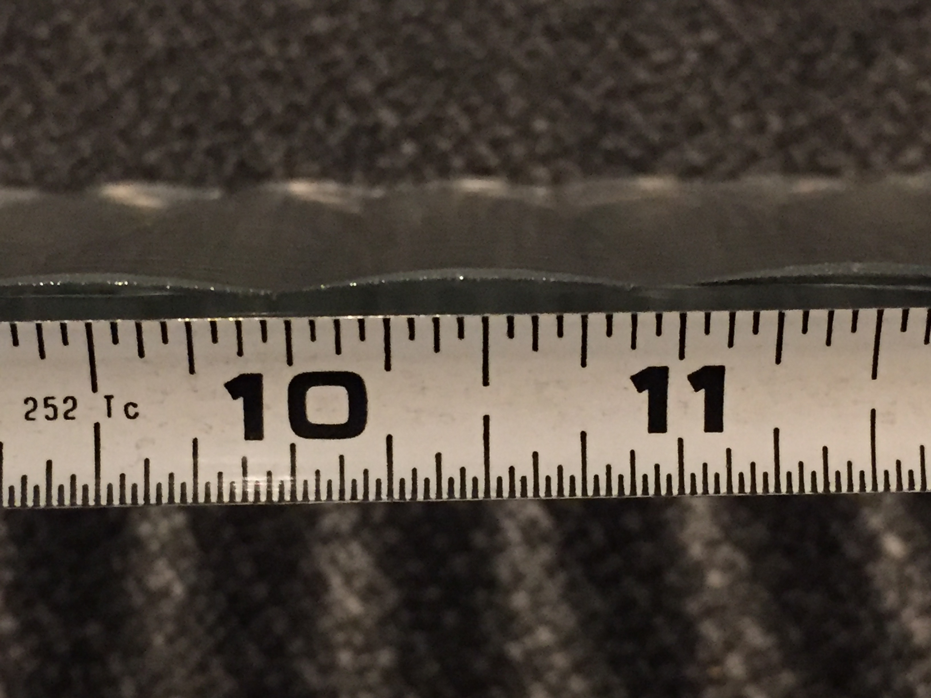

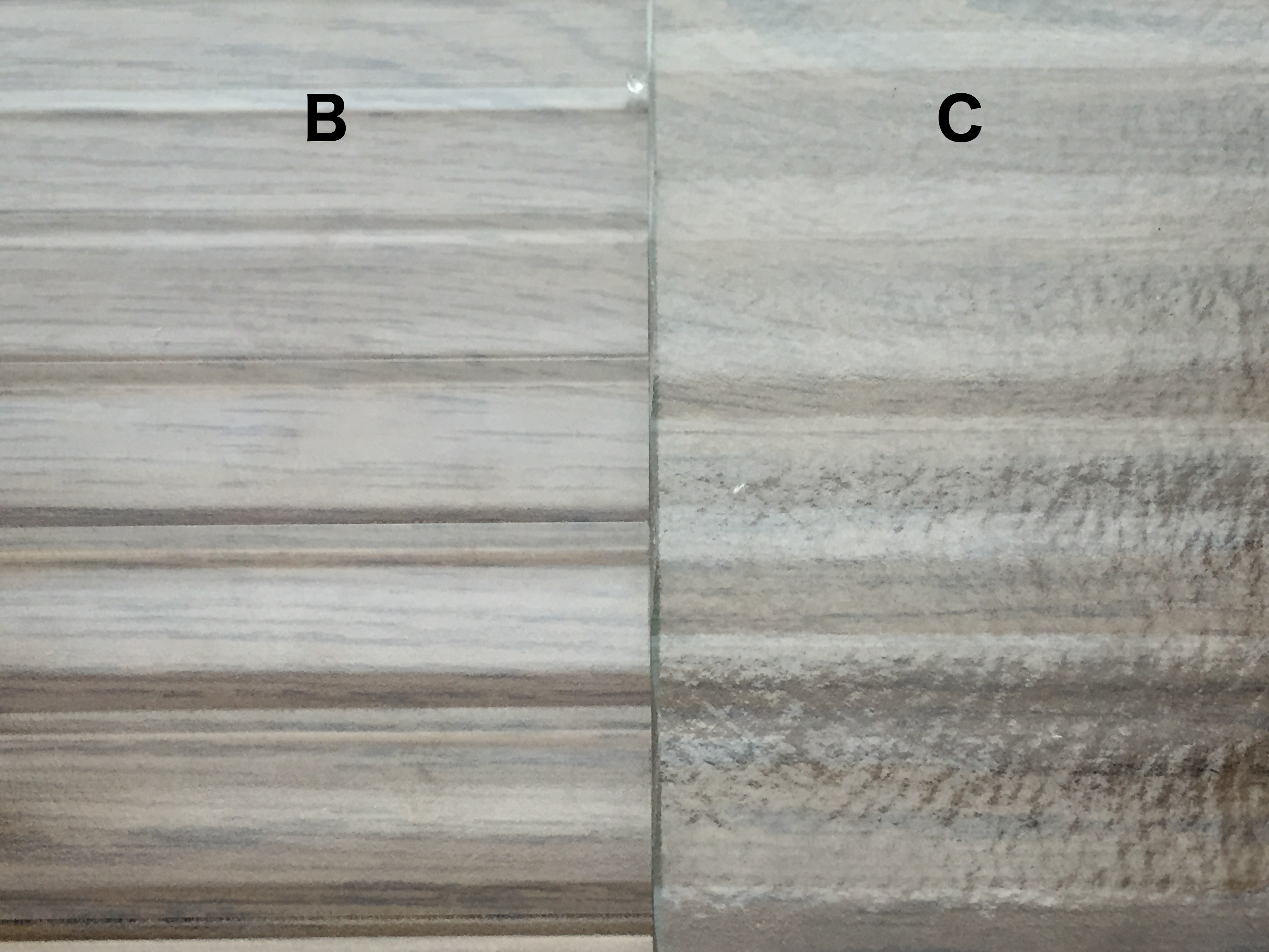

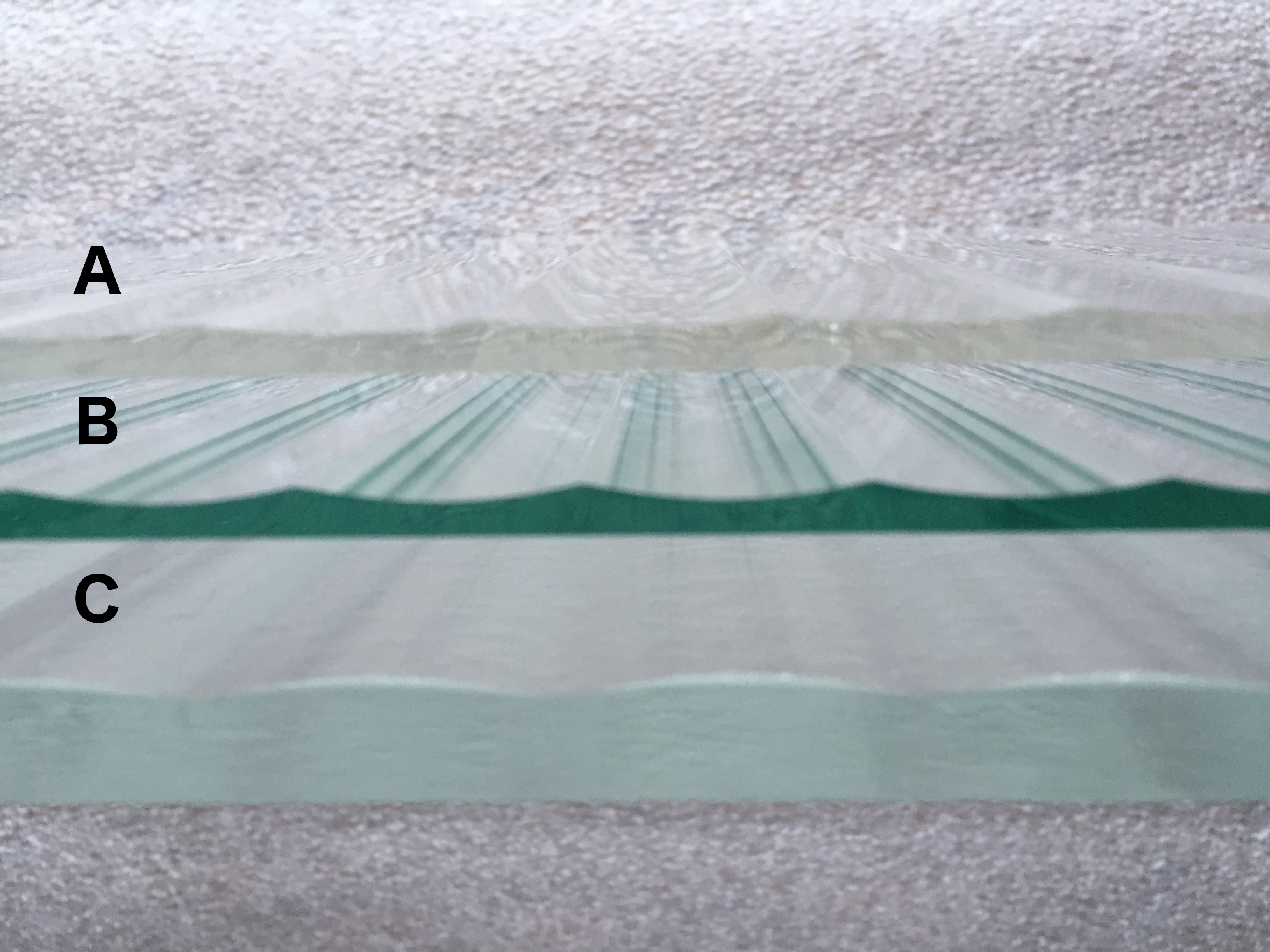

I've got 3 different glass types:
A = Concave 7/8" Clear Reed (which is what's professed to be the "correct" reed spacing by Trek "experts")
B = Concave 1" Clear Reed (which in reality is not quite 1")
C = Convex 1" Krystal Textured Flutex (which is the only reeded glass having a texture)
Each piece is oversized by 1" (in hindsight it should have been only 1/2"), and I think the 7/8" reed can be eliminated because it simply has too many "bars" on the glass (space between the reeds). There are 17 bars on the glass (resulting in 16 inside the frame), but screenshots clearly show 12~14 bars with 12 being the most prevalent:
Having selected 6"x12" for my panel's inside dimensions and being there are 12 visible bars on the glass, it makes sense that this would be 1" reeded glass. I've searched and searched, and the largest reed pattern available is 1" but not many places stock it, and even fewer offer shipping or retail sales. Glass B is 1" reed but the spacing is not 1", more like 13/16" resulting in 15 bars (which would yield 14 inside the frame):

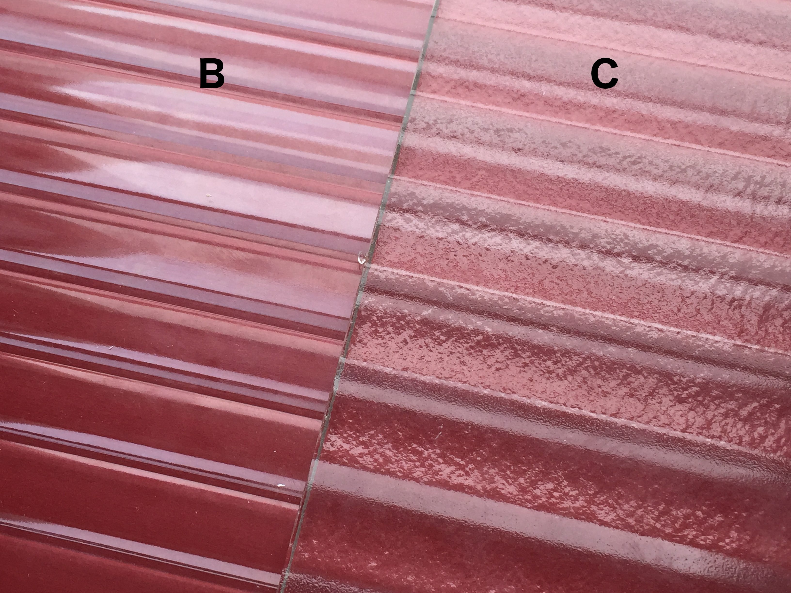

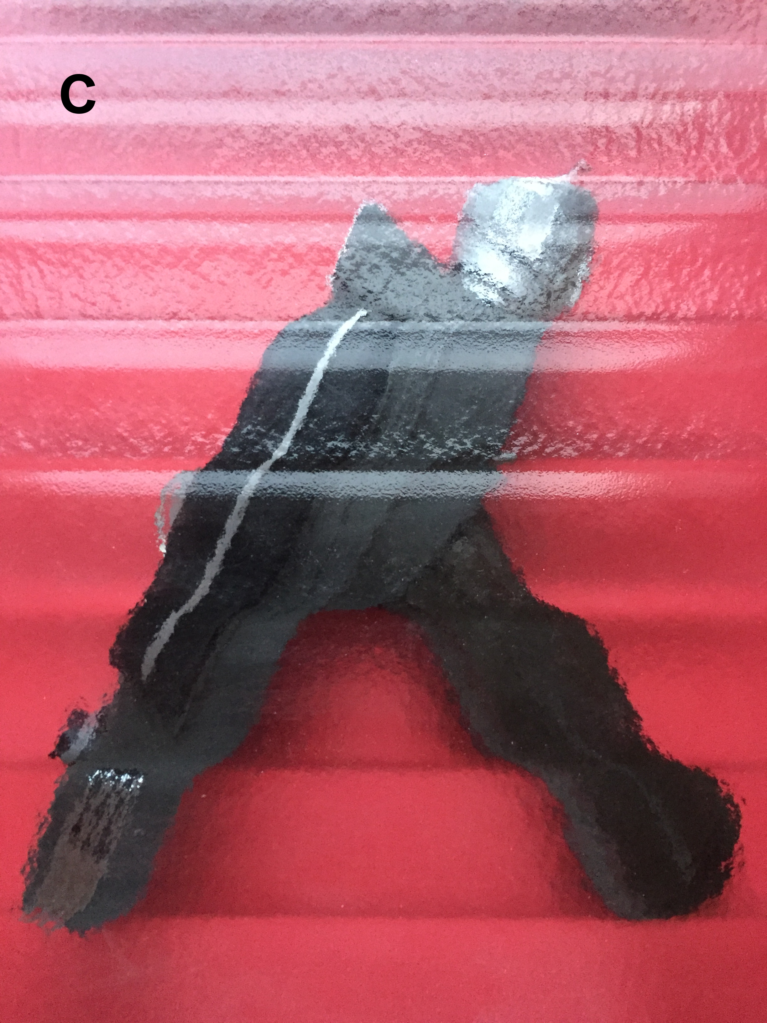

Glass C has 13 bars, being the closest to the target 1" spacing since there would be 12 bars inside the frame:
With A eliminated, comparing B and C they each have pros and cons. B is a thinner glass (5/16") and thus weighs significantly less than the much thicker C (3/8" and heavy!), but visually C looks more like what I'm seeing in many screenshots like the ones above.

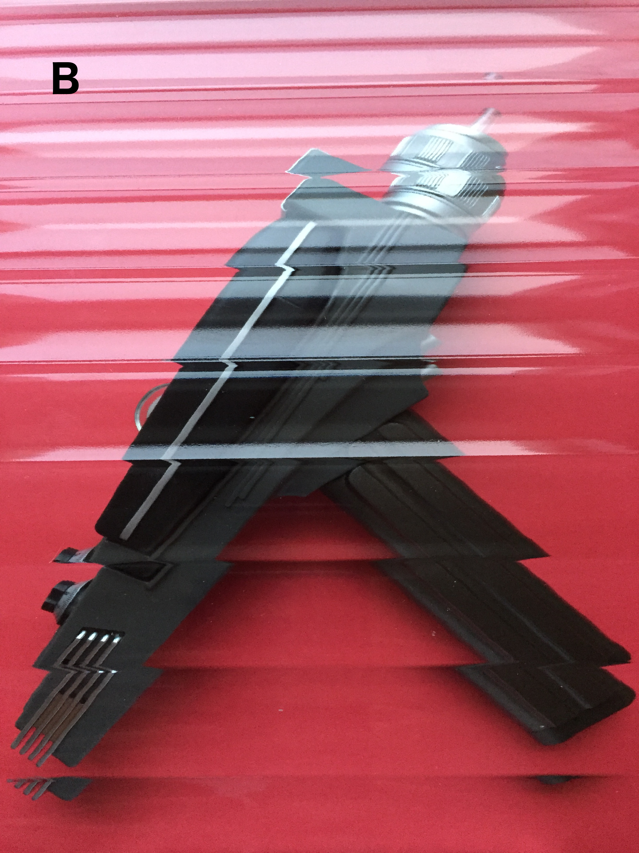

Next I did a "phaser test" to see which of the two glasses looks more like "The Conscience of the King" scene:View attachment 1415751
In this experiment B clearly (no pun) wins, confirming the reeds should be concave and not convex. Keep in mind, a red gel filter isn't behind the glass yet which will diffuse it.
Thus, comparing the overall look (and weight, which is important considering how it's to be hung on the wall) B has characteristics in its favor, and in some regards C looks better (despite it weighing like a brick). I'm favoring glass B. Opinions?
B hands down.
