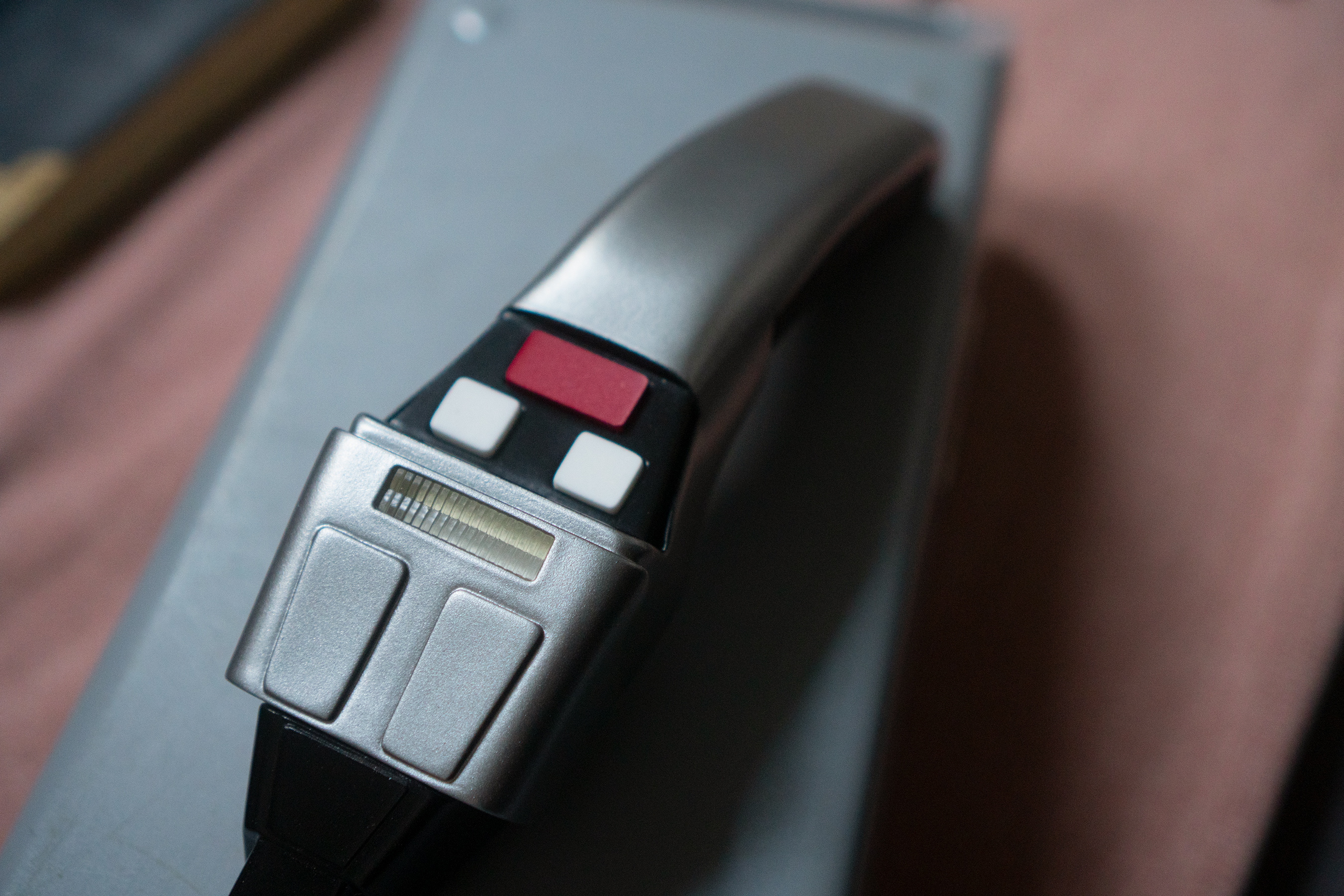

I've also been building a Boomerang phaser recently (Stapleton kit) and ended up using #140 Vauxhall/Opel Smoke Gray Metallic by Dupli-Color.
It might run slightly cooler in tone, but it still has an nice amount of 'gold' to balance it out. Can recommend it.
(shot indoors with natural light, no clear coat)

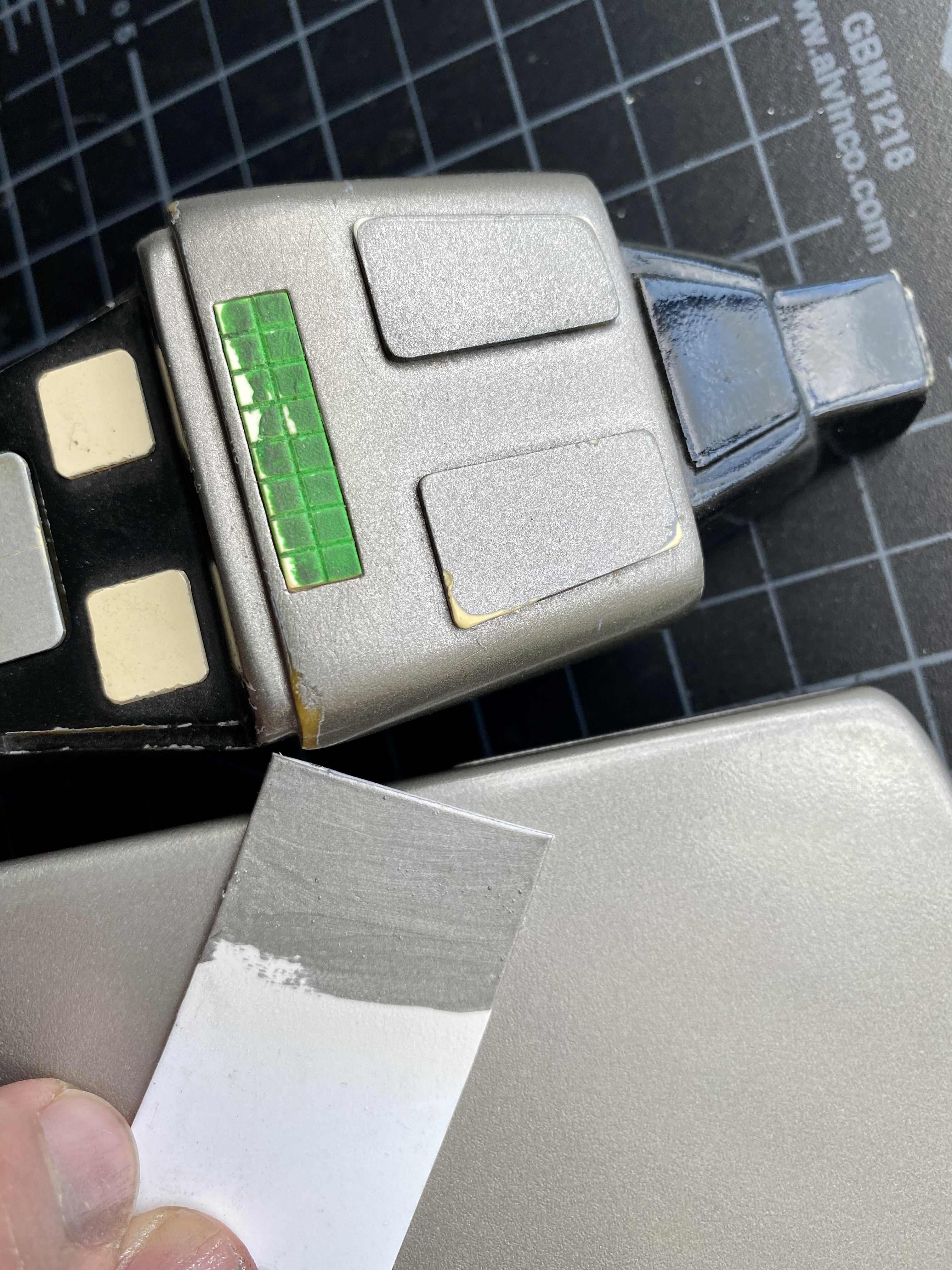

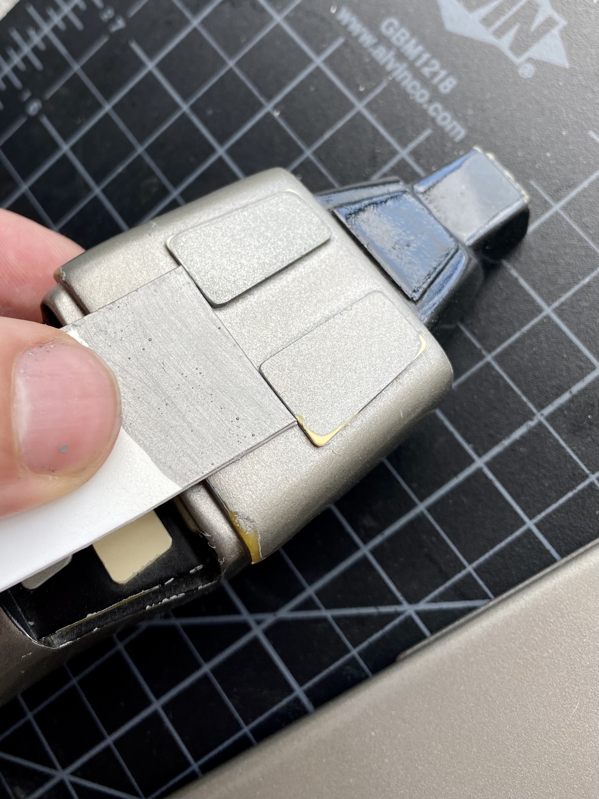

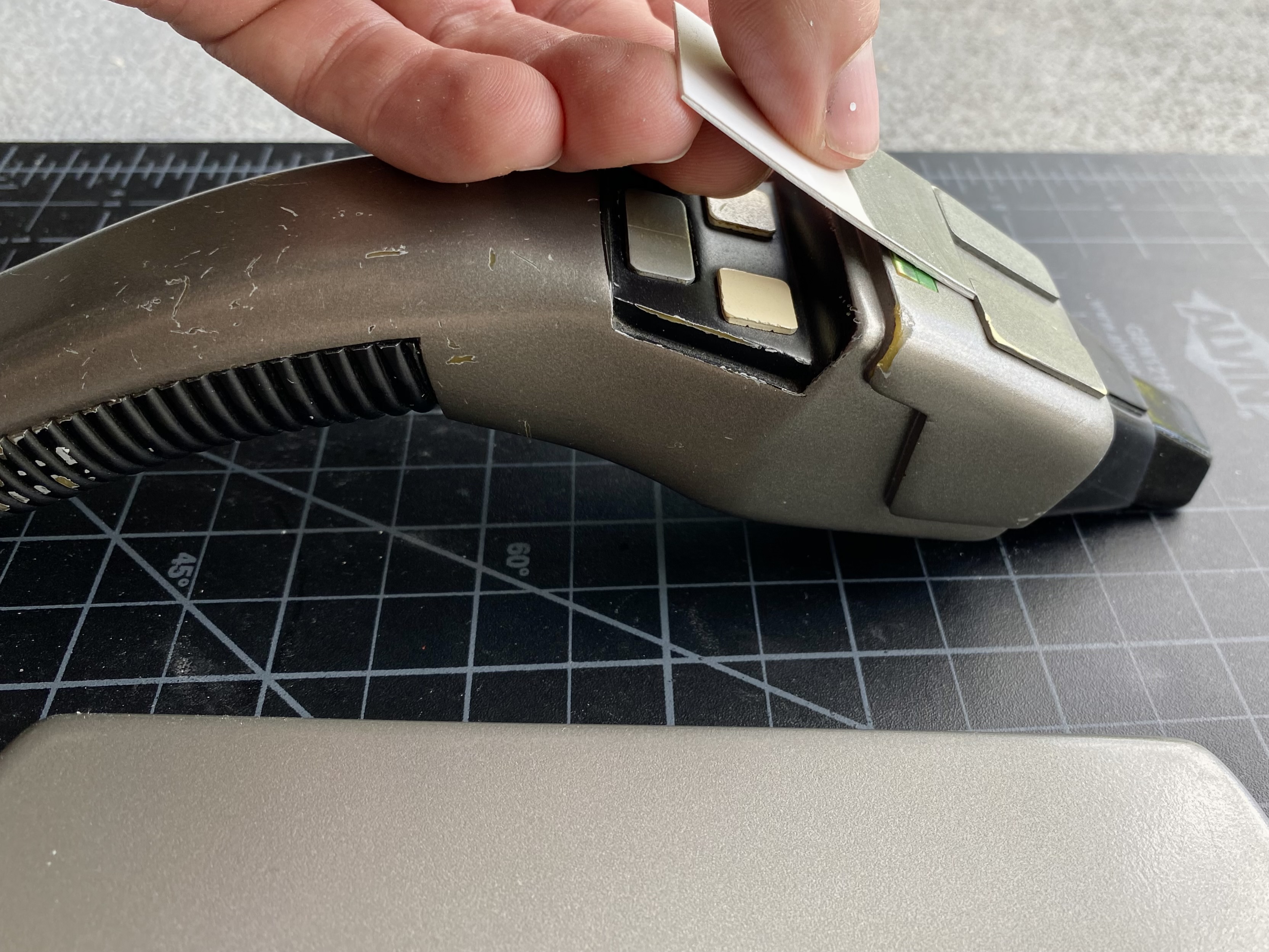

Ok I think this is my new favorite. I took the WA8311 code to the local paint shop and got a small amount to test. I took this swatch outside and compared it against my screen-used boomerang and a PADD painted in an older formula that's also really close:

Ok I think this is my new favorite. I took the WA8311 code to the local paint shop and got a tiny amount to test. I brushed some on a piece of styrene on top of a light primer coat. This paint is specifically meant to be clear coated, so I gave it a semi-gloss clear. For the ultimate test, I took this swatch outside and compared it against my screen-used boomerang and a PADD painted in an older formula that's also really close:
