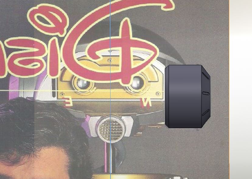

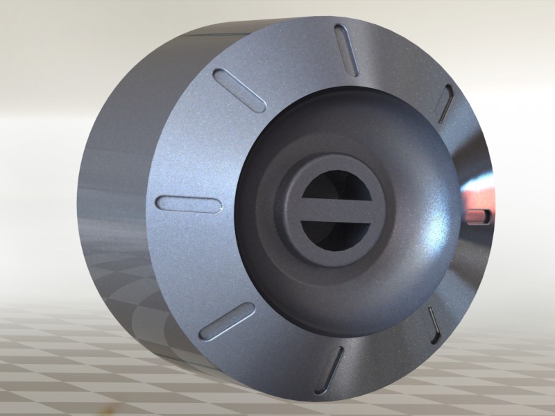

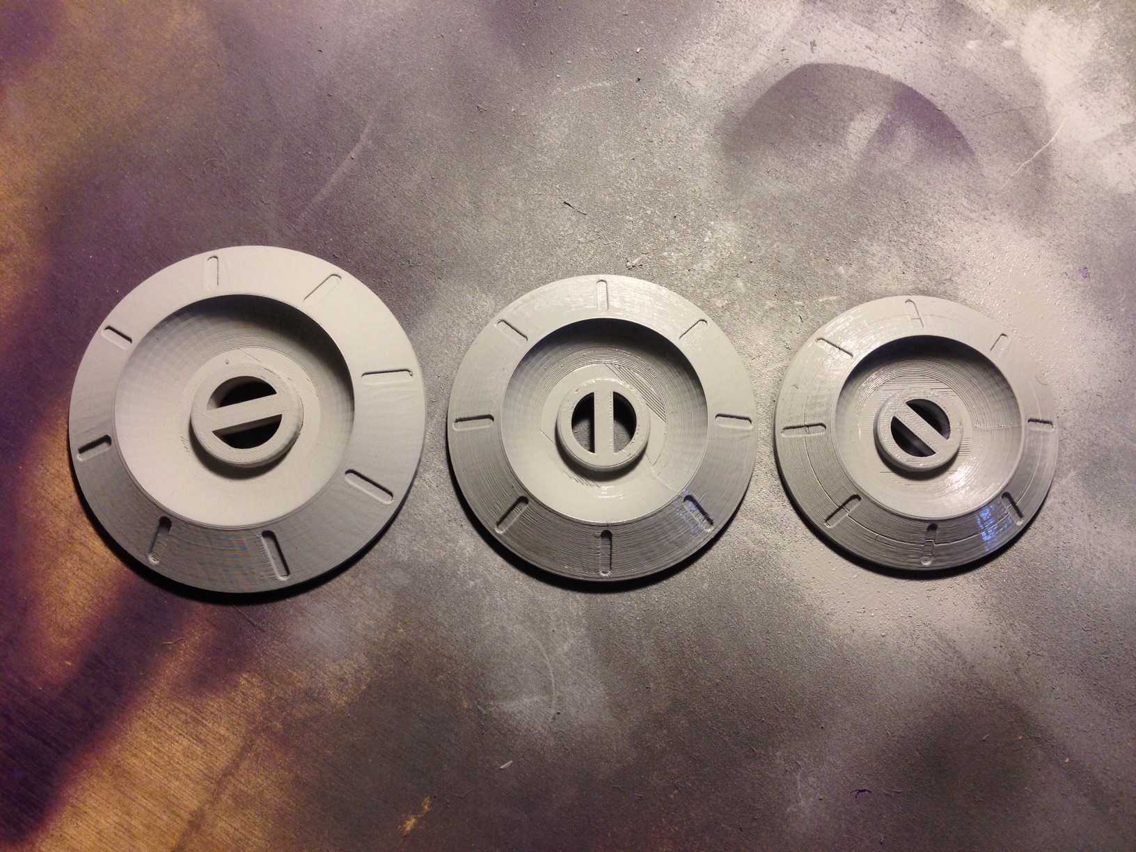

I built one entire ear in CAD, and decided to 3D print just the outer section to check for scale. Even when modeling, the ear was difficult to nail down. The reference images we have at the beginning of the thread are quite old and pixelated. The ear appeared to be 5" around or so and that was only .2" different from my original estimation so I figured I was on the right track.

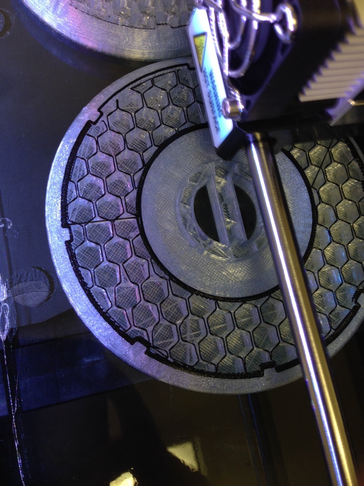

As soon as it was on the build table of the 3D printer though it immediately seemed too large. The printer at my work doesn't have a very large build volume so I talked myself into thinking it was just contextual.
Once we arrived at Disneyland, however, it was immediately clear that it was .5"-1" too big in diameter. I returned to work and printed two more at 4.5"dia and 4"dia and have just painted them in anticipation of nailing down the dang scale.

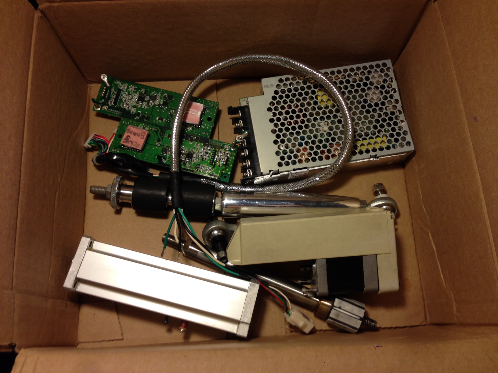

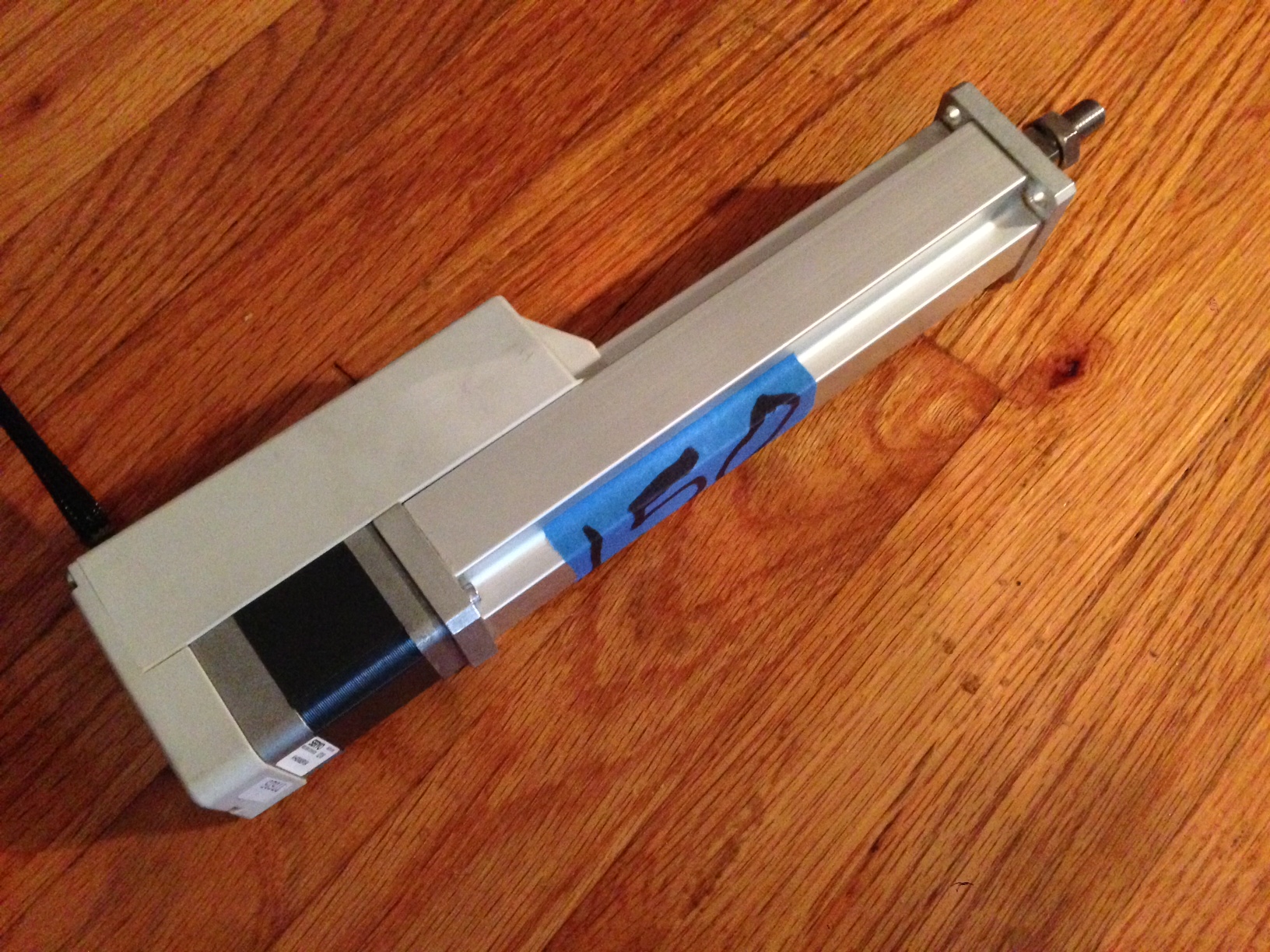

I've acquired 2 used Electro-mechanical actuators (lead-screw type) one with 100mm (~4") of travel with some maintenance required...
...and one with 150mm (~6") of travel that hasn't been used in years.
There's going to be some work to do but both should work just fine. I need to purchase a couple serial to USB adapters to get them to talk to the computer. I intend to use these in conjunction with an arduino controlling some servos and some LEDs to get all of the degrees of freedom necessary.

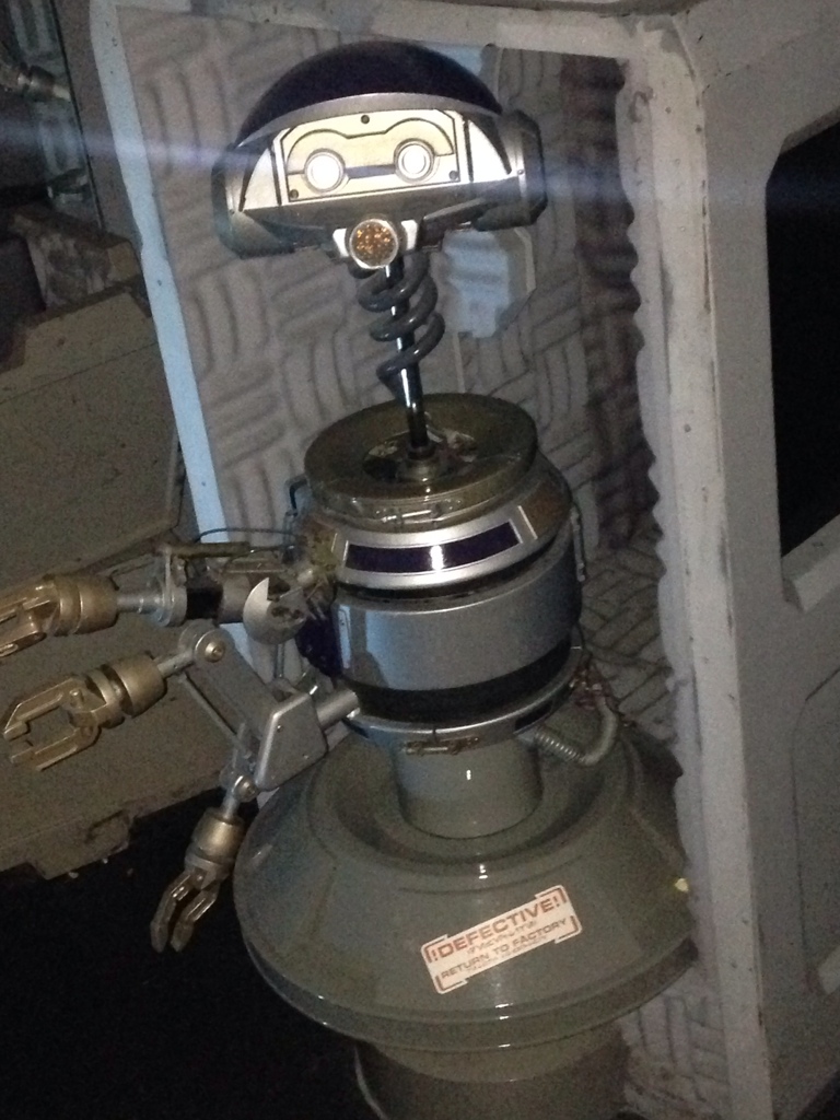

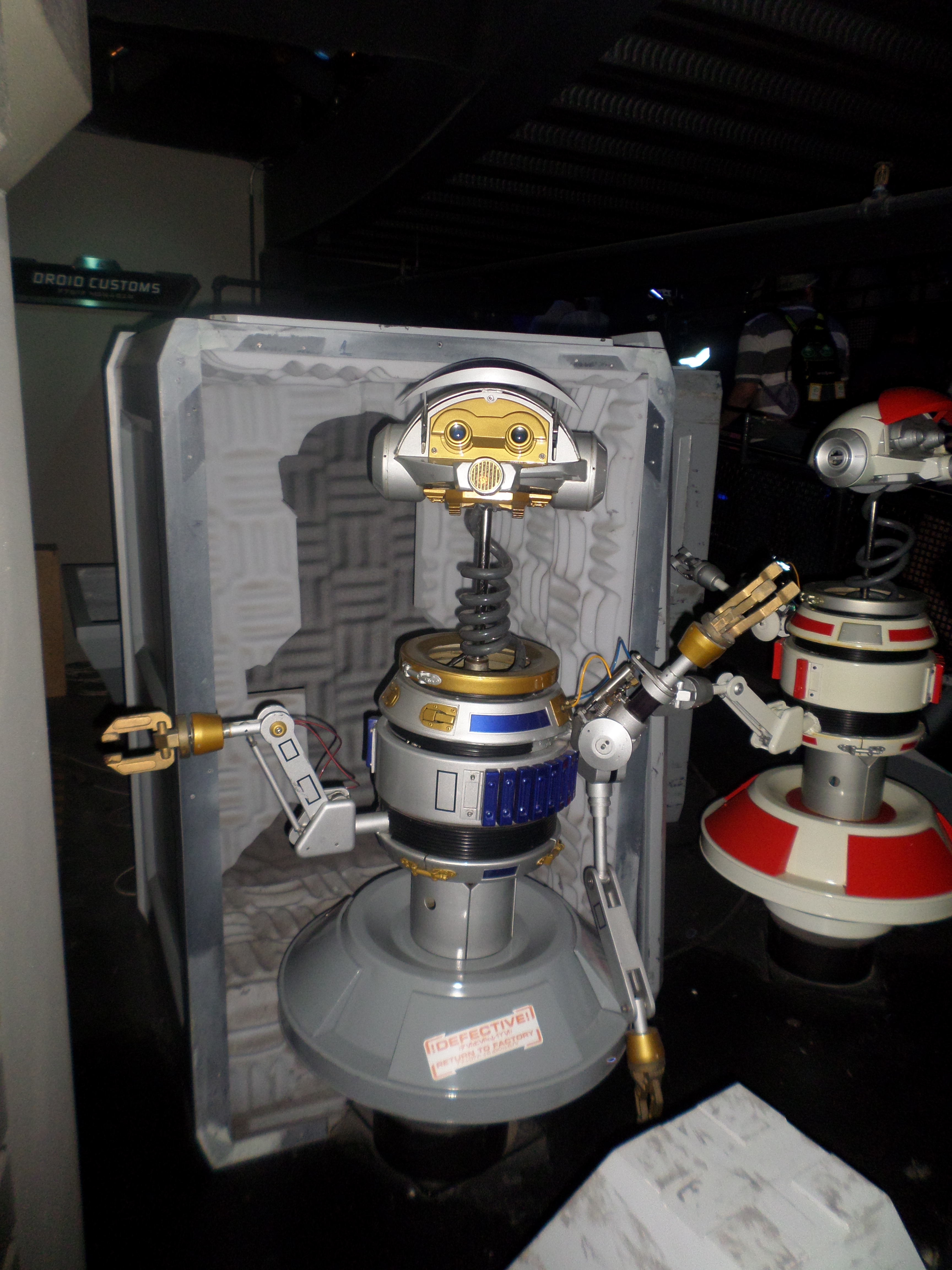

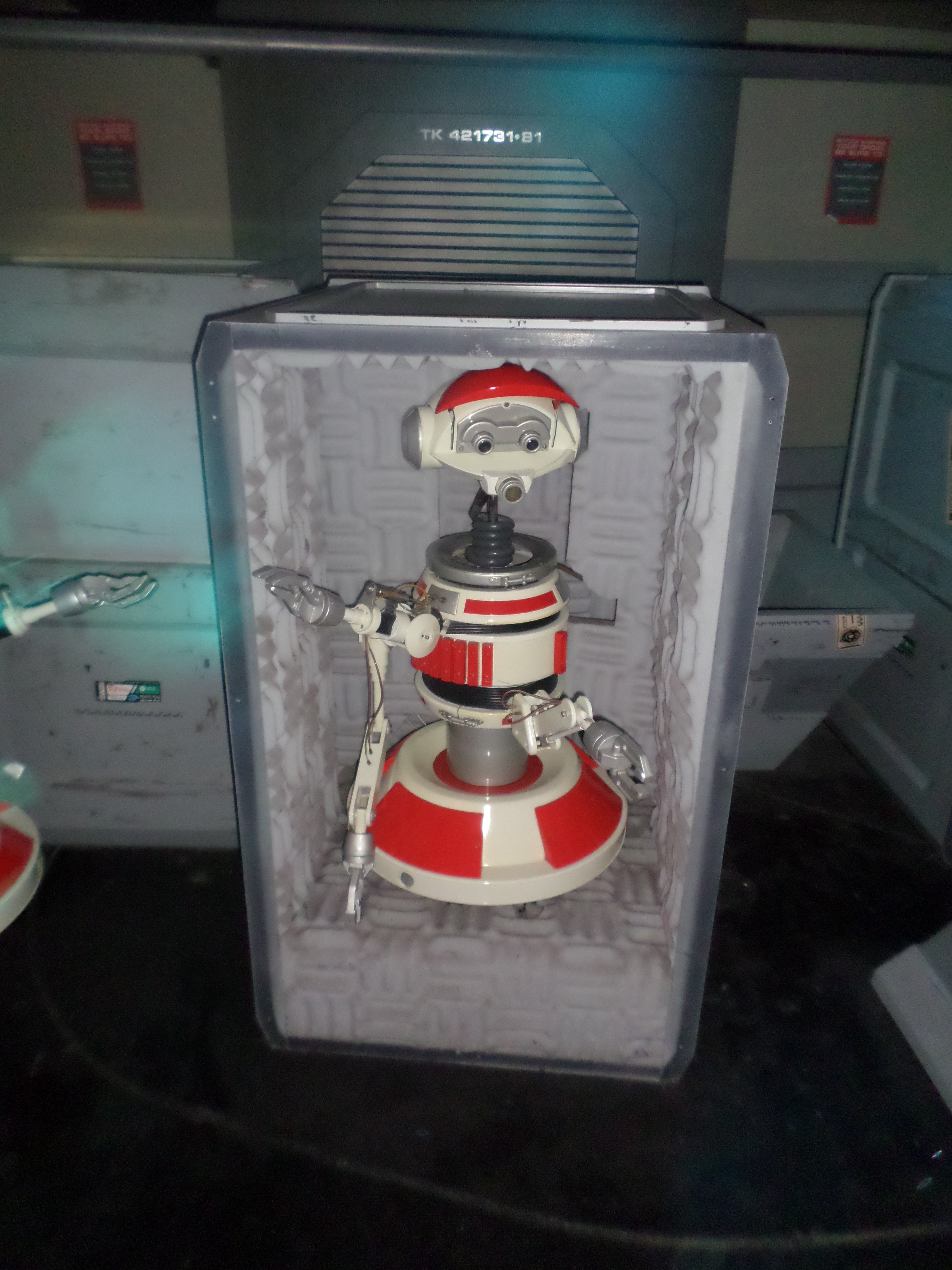

as it happens I was at Disneyworld a few weeks ago for Star Wars weekends and got some pics of Captain Rex :) Might be of use to you

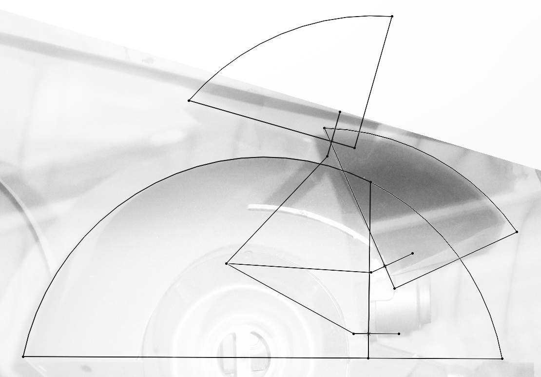

Well, it was bothering me so I decided to sit down and figure out the visor linkage details. Thankfully it is a one bar affair as reverse engineering partially hidden multi-bar linkages is not exactly fun. Turns out the bar is 62deg from vertical. I suppose that was a design choice based on internal room in Rex's head. Here's a shot of the linkage and the range of motion.
