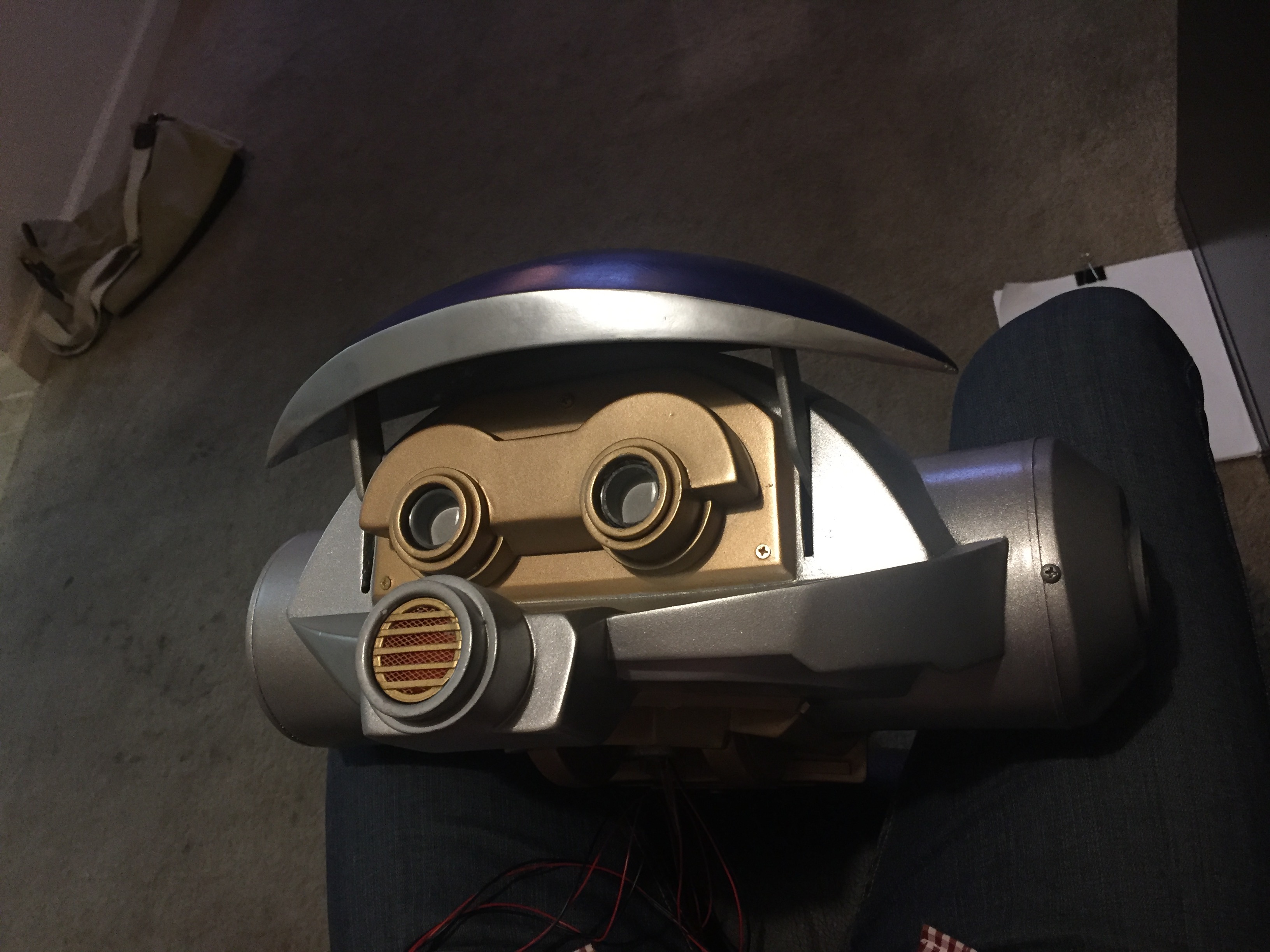

I'm brand new to the RPF and noticed this project. I've been working on my own Rex for the last year or so. I'm currently working on the body and it has been a learning experience. If you guys have any questions about this build, I can try my best to answer. Here is a pic of the head a few months ago. There are a few elements I've changed since, but....yeah...just thought I'd throw my 2 cents in.

Wow, that looks awesome! Details please. 3D printed parts, or a scratch build? Not started anything on Rex yet (I'd be happy with just a static head myself) so any and all info (with WIP pics) would be great.
It's a scratch build. I've 3D printed and molded new ear pieces to be more accurate since this photo. I've made molds and cast them in fiberglass so it is very light. Again, I'd be happy to answer any specific questions you have. I'll post a few pictures of the molds and fiberglass pieces before they are painted.

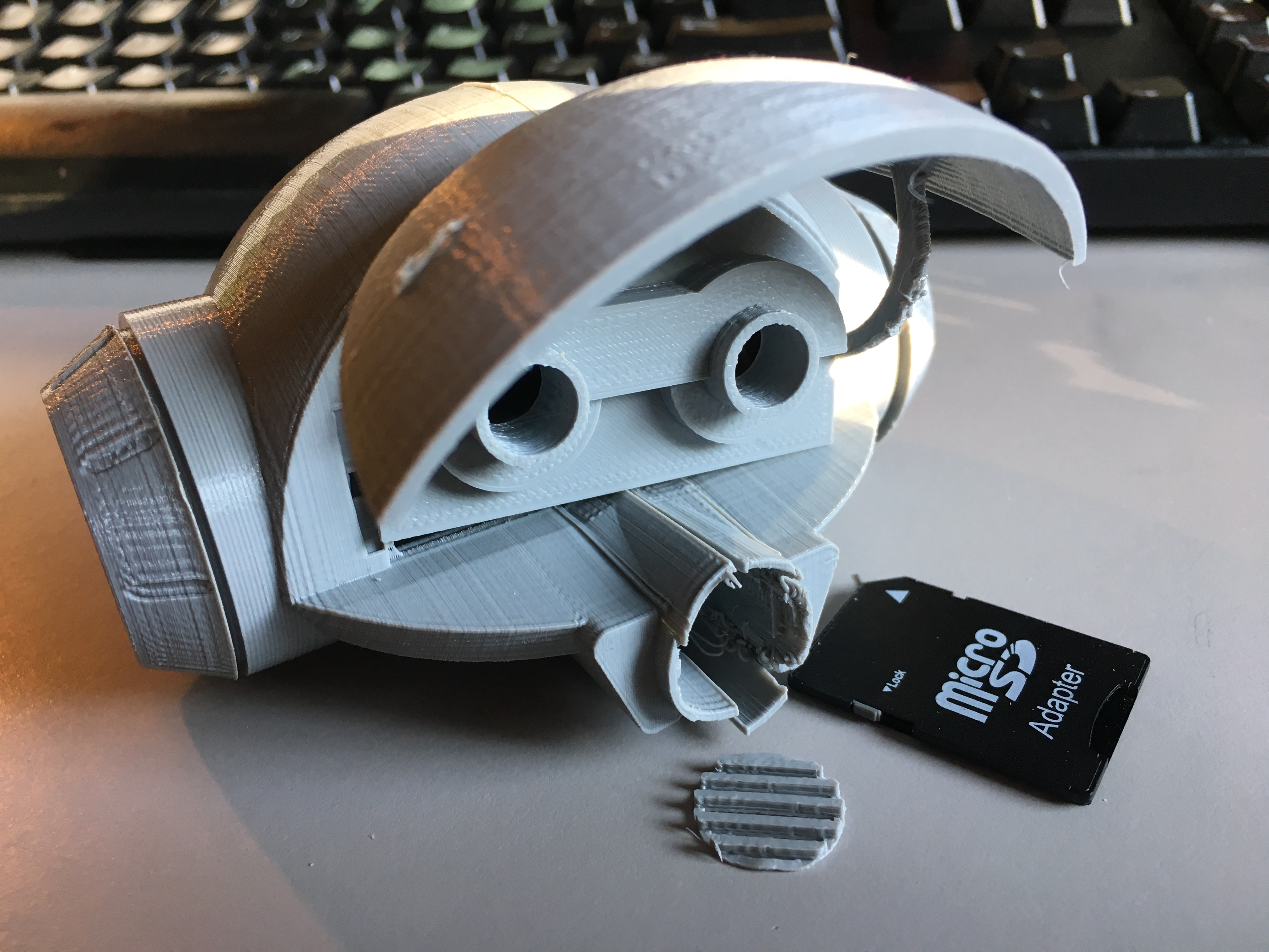

New to posting in the RPF, but a huge Disney and Star Wars geek. Haakesack's work has inspired me to start my own RX-24 build. I'm basing my model on a hybrid of the Star Wars Rebels version of the droid because it has cleaner lines that I think will 3D print much easier. I'm adding a smattering of the smaller details from Star Tours here and there as well - so it's a hybrid. Just starting on a head model at first, then I'll think about body design after I've got that in hand.
I've bashed together a pretty good model file using nothing but Tinkercad and have done a test print at 1/3 scale or so to see how things fit and work together before committing to all the plastic. I'm keeping the model as hollow as possible for the possibility of some future electronics. Have a look:
The supports on the visor lift arms gave up midway through the print, which seems to have botched a few of the travels (check out the cracked and warped mouth structure). But I'm overall happy with where the model is. With a few slight tweaks where I couldn't see collision in Tinkercad, I think I'm ready to order some more filament and start on the full sized beast.
Just for info's sake, I'm using a Monoprice MakerSelect v2 for printing.

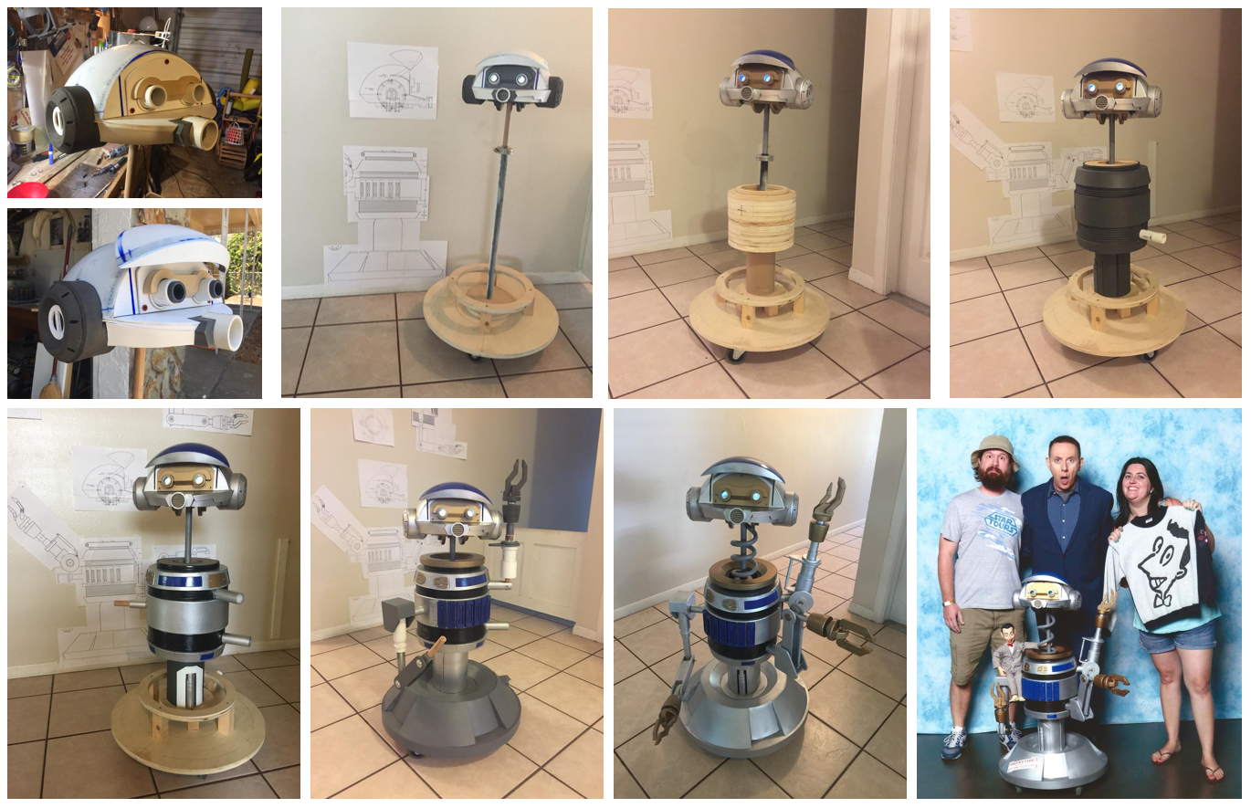

I realize that I'm pretty late to the party, but this thread helped me out immensely with my Captain Rex build! Star Tours has always been my favorite ride at Disney World, and Rex is simply amazing and I've always wanted to have him.

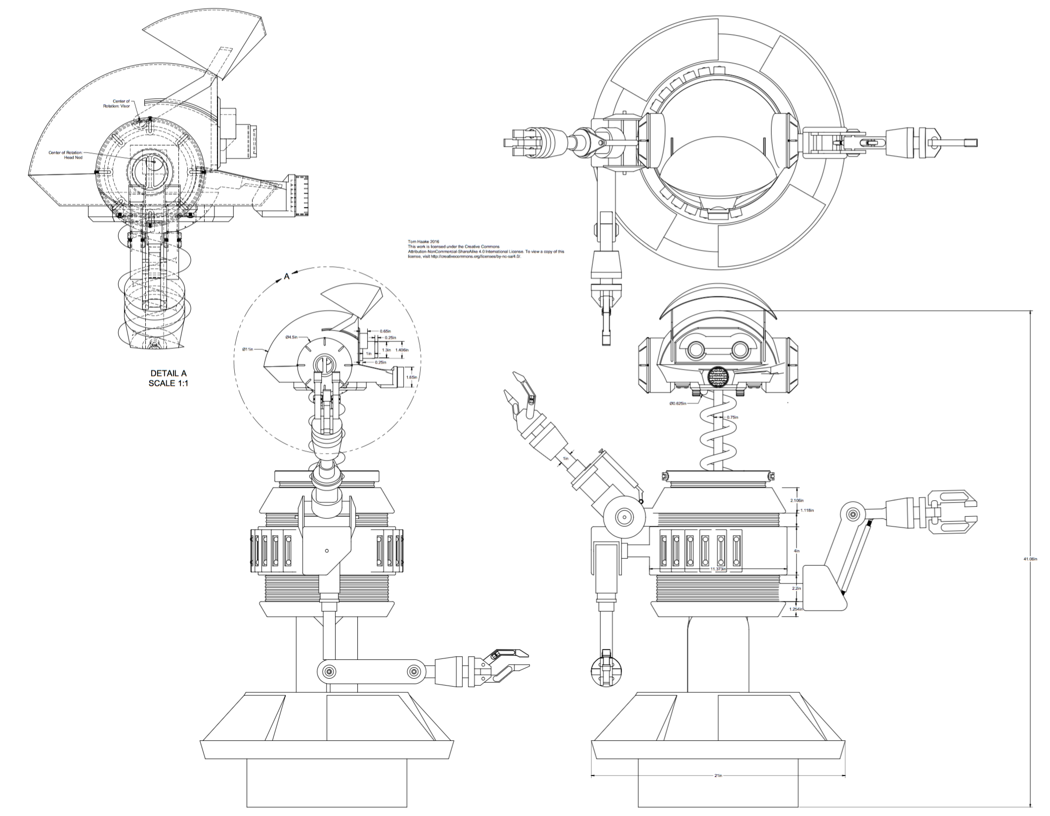

Special thanks to Haakesack for the plans and decals, I printed them out 1:1 scale and hung them on my wall. They were essential!
I made my Rex out of wood, PVC pipe, plastic and EVA foam. And I busted him out in 3 weeks (start to finish) so I could have him meet Paul Ruebens at MegaCon here in Florida. It was one of my greatest convention experiences ever and it all started here. Thanks to you all, I referred to this thread almost daily during my build.
His arms can all rotate 360 degrees around his body and are poseable. His eyes light up with a simple LED battery pack of Xmas lights. He has 4 castor wheels on his base so I can push him around easily.
I have lots more build photos, but here's a few of them:
View attachment 676708View attachment 676709
