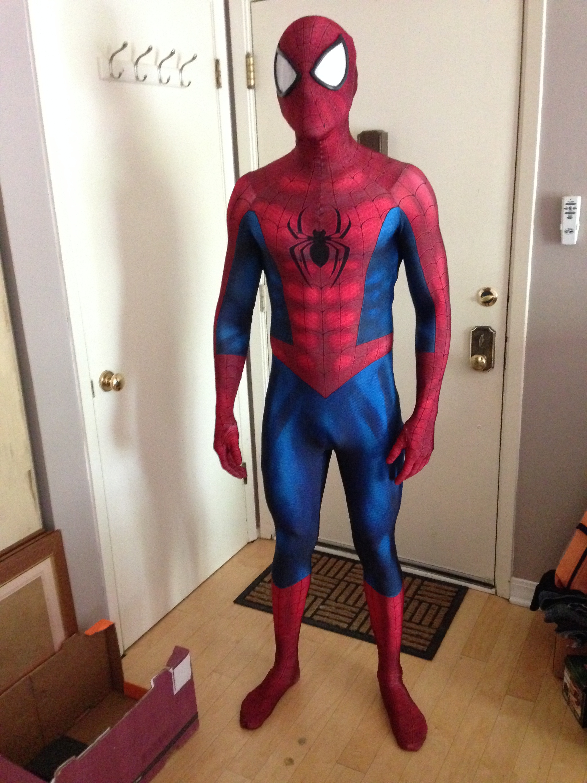

So I got my suit in and it fits perfectly. It's an Orhadar Print I sized up in both width and length. The 27" from middle mask to belt I sized up to about 31". I'm exactly 6 feet. I think if I didn't resize it, it would have indeed been way too small. View attachment 324727
Here is a picture of me with the suit quickly put on. Even the back zipper and mask zipper aren't causing any problems.
Looking great! Quick question, where should your belly button be when you wear the suit? I'm trying to firure out how much I should resize the pattern :D
