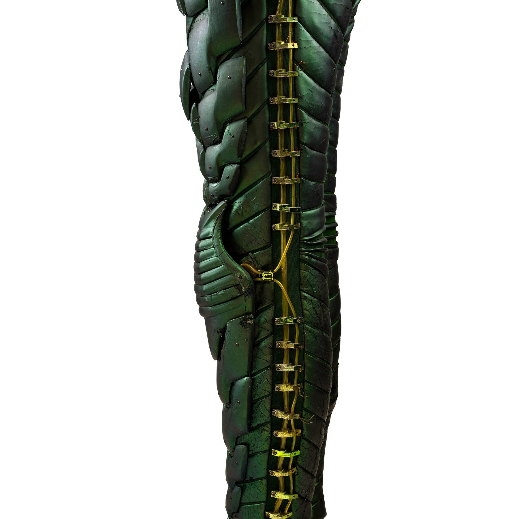

Hello everyone! I'm currently in the midst of building my Green Goblin costume from the first Raimi film! My printer is running hot putting out the 80+ armor pieces. I don’t have much to show quite yet, but I thought I would start off by asking for some input!
On the sides of the costume there are these two cables/hoses running down, these are held in place by these brass looking pieces. I’m curious whether these are found parts, or made custom specifically for this costume. I’ll probably end up resin printing them in the end for my costume, but if anyone here has any intel or information about these pieces, or the overall costume for that matter, please let me know!

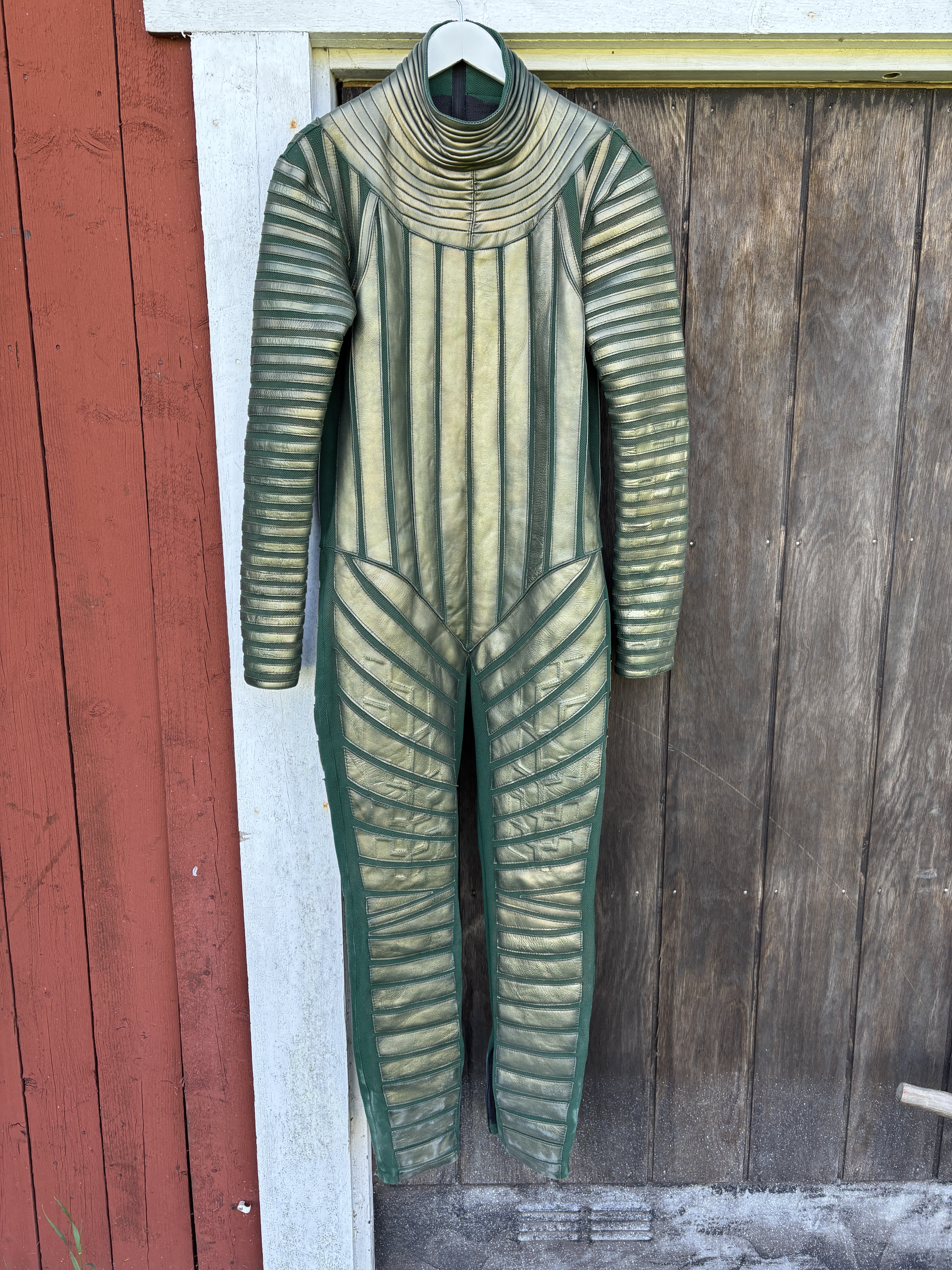

This costume will be built upon this leather suit from WhiteSheepLeather. It’s not 100% accurate in it’s design, but it will look fine when covered in armor. The color of the leather panels however were not quite to my satisfaction, I believe it’s designed more after the No Way Home suit. Either way I still wanted the leather to match the color of my helmet and armor, so one of the first things I did to it after seam-ripping off all the leather armor, was to paint the panels with the same paint as I will be using on the hard parts.

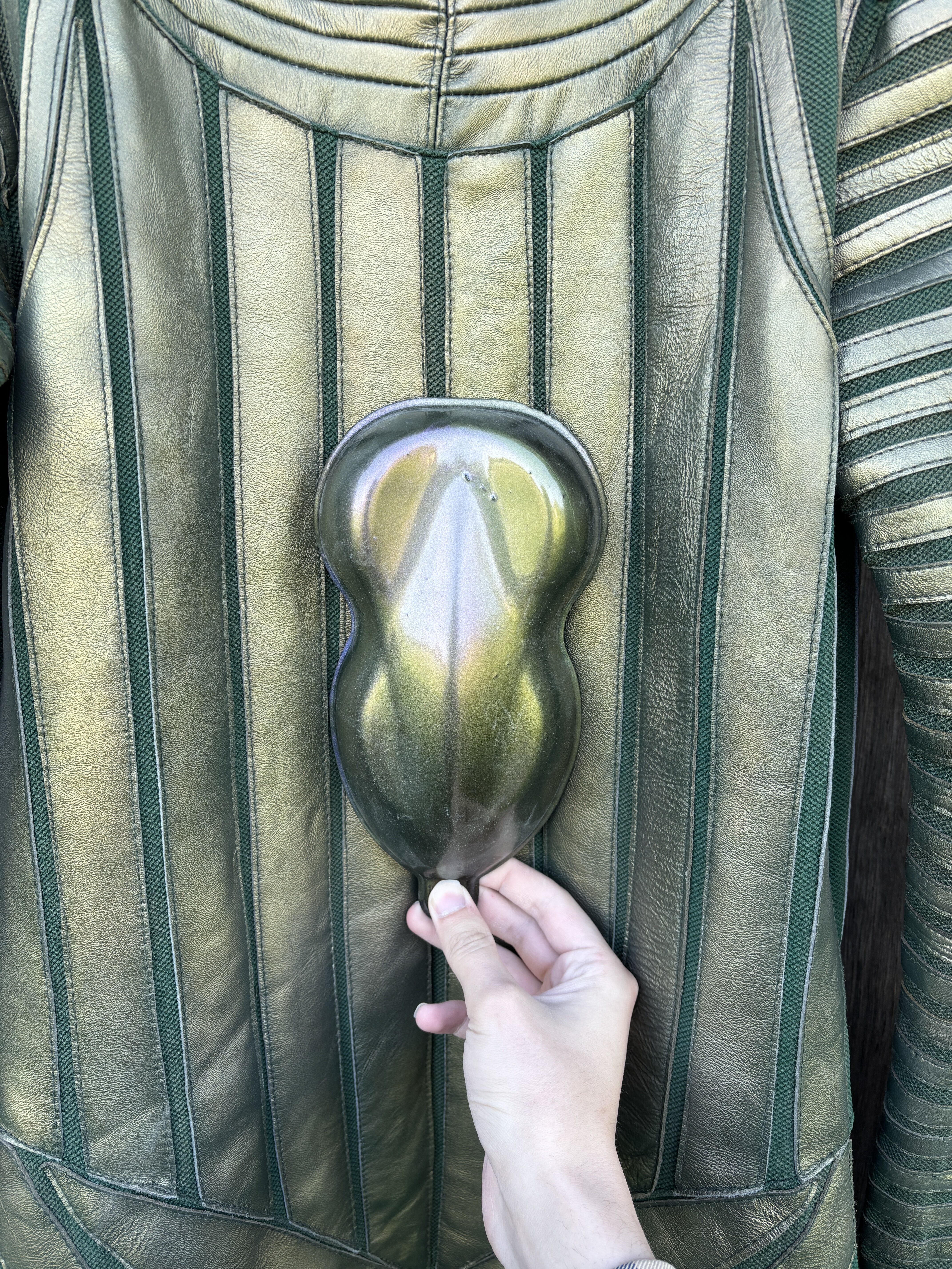

I’m using a pearlescent color pigment mixed in with some clear-coat to paint all of the green. The great thing about it is that I can use the exact same color on both hard and flexible surfaces, making the color matching between the suit and armor much easier!
Before:
After: (with reference for the armor paint)

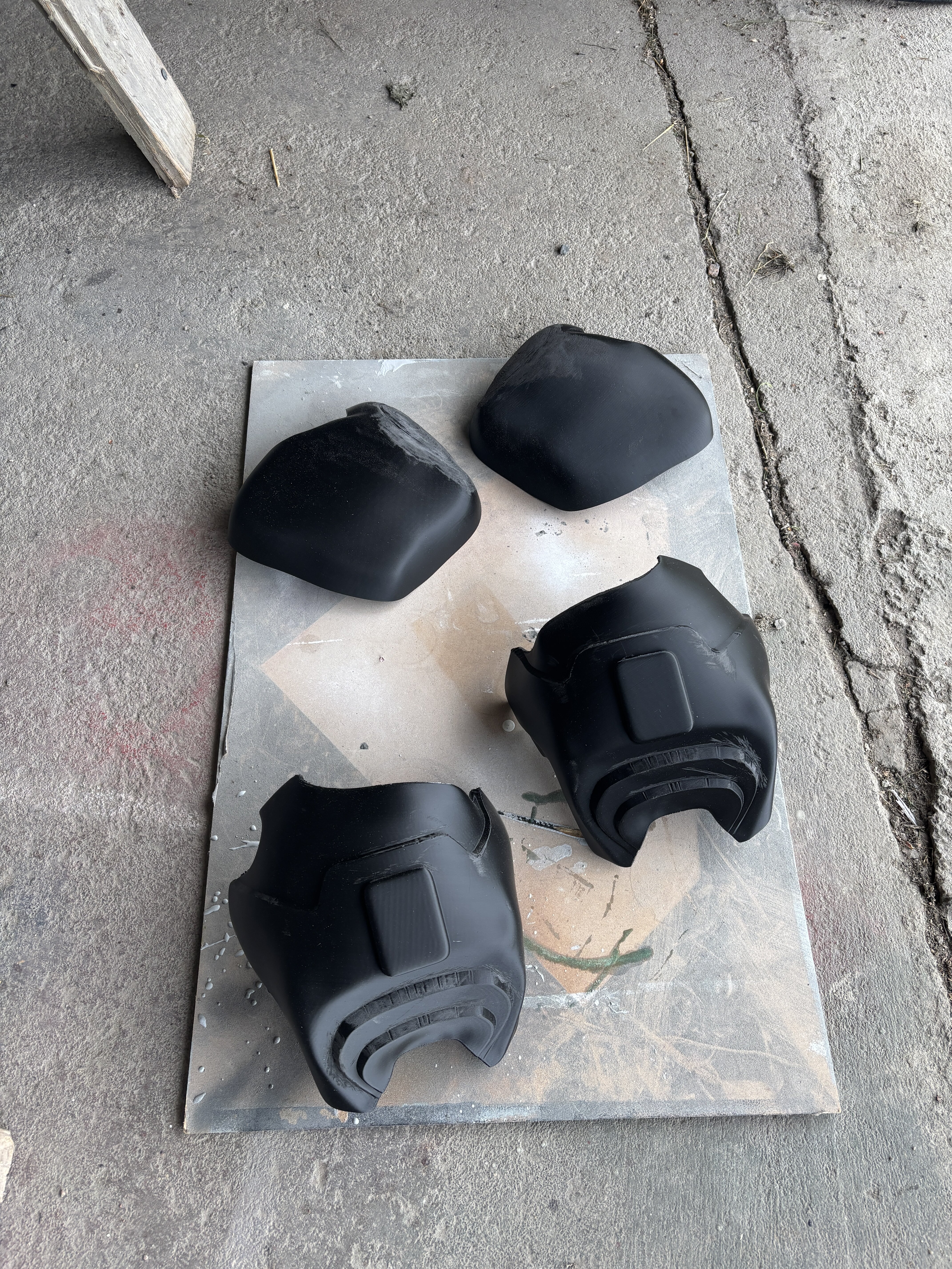

So, after having my printer slaving away for a couple of weeks, I now have the 80+ armor pieces printed and ready for post-processing!
For big project like this, I like to use a 2K filler primer (comes in a can with hardener) that I can lay down with a cheap spray gun. It’s a lot more cost effective compared to buying smaller spray cans and gives the prints a good base coat to sand on!

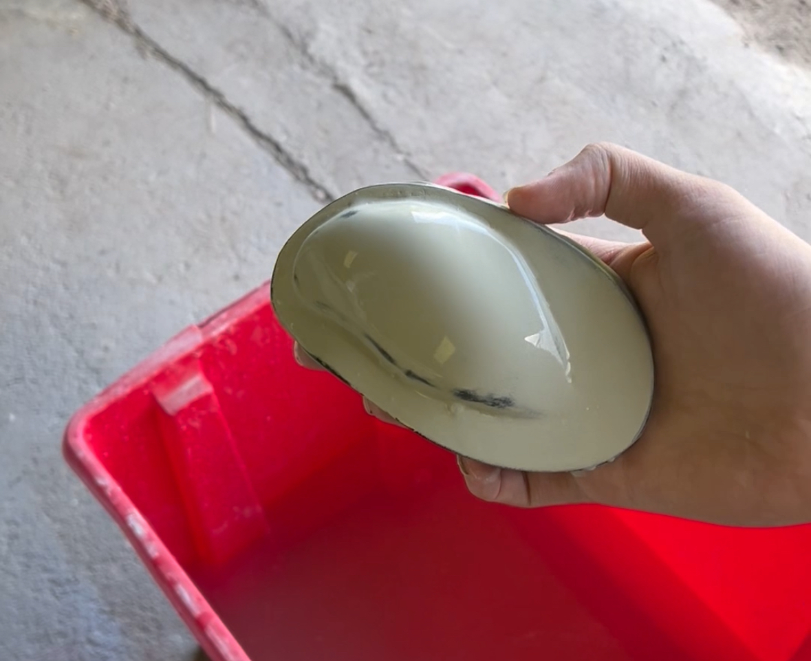

This was then printed and finished with the normal filler-primer routine. Here it is freshly wet sanded up to 1200 grit.

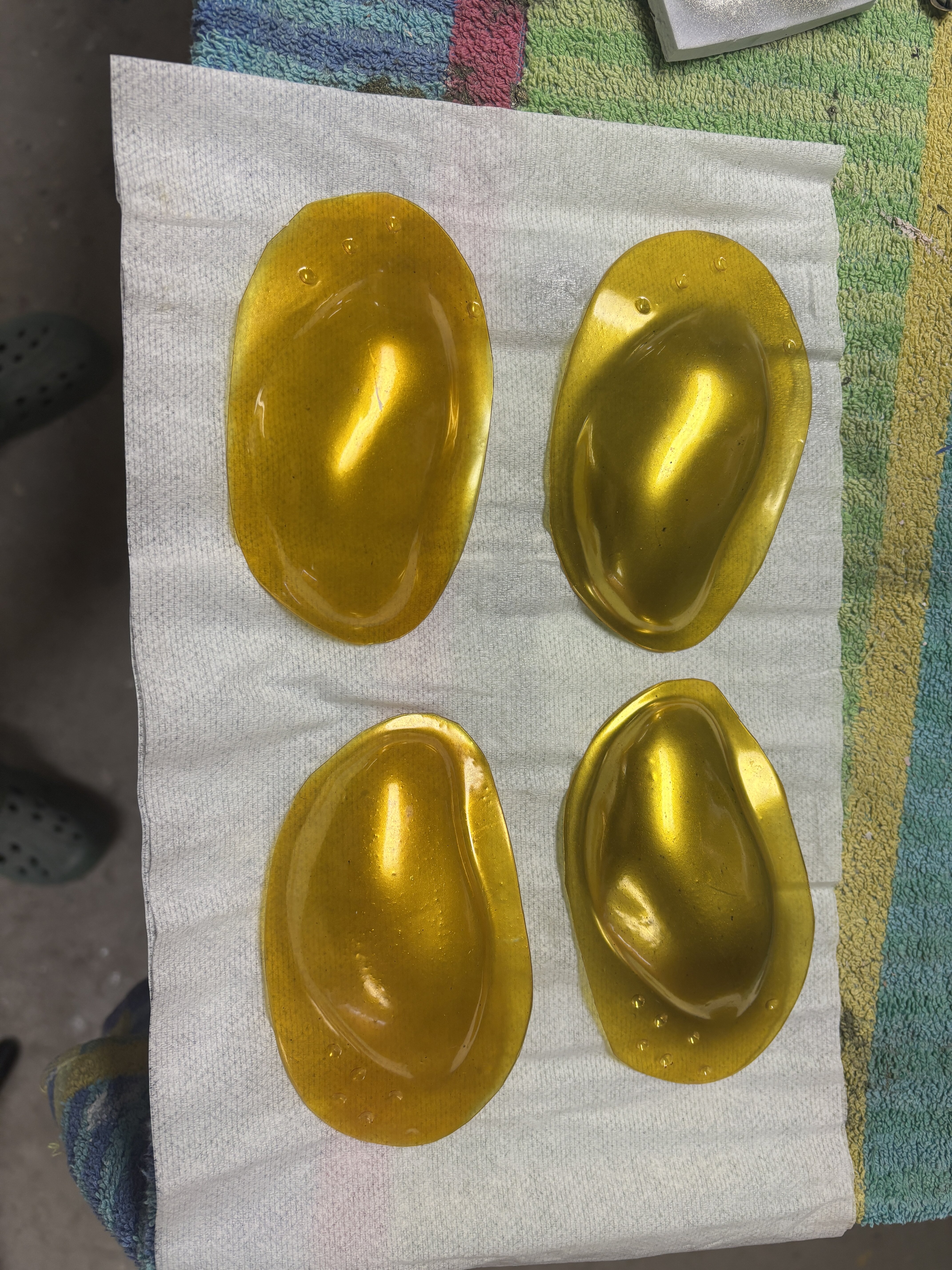

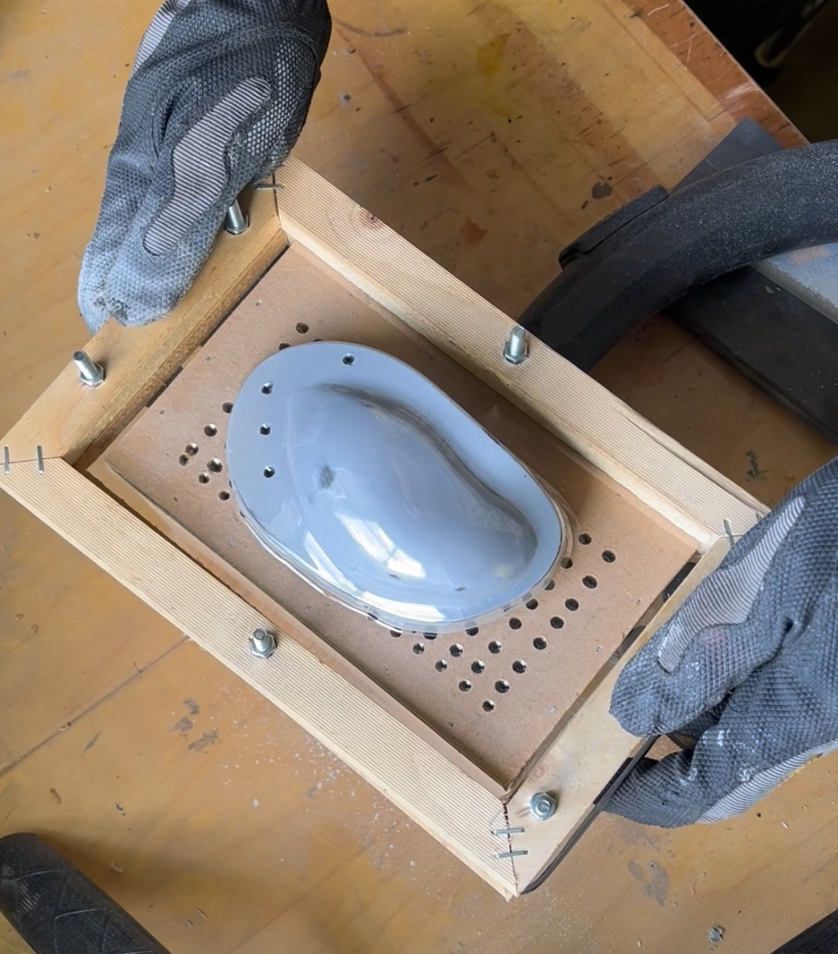

The next step was to dust of my janky self-made vacuum former and pull some lenses in clear PETG.
The lenses were trimmed and put into a bath of IDye Poly ”Golden Yellow” dye, which has no problem dying plastic. I experimented with leaving them in the bath for both a shorter and longer duration, which gives different shades of color. I think I prefer the more paler shade in this case, but I’d still like to experiment a bit more with this process!
To give the lenses the mirror shine I simply used some alclad (now known as A-Stand) chrome paint, which is sprayed lightly through my airbrush on the backside of the lenses. Again some more testing is required to find a good compromise between good visibility and sufficient mirror shine.
Still, the lenses I have now will work fine for the time being.

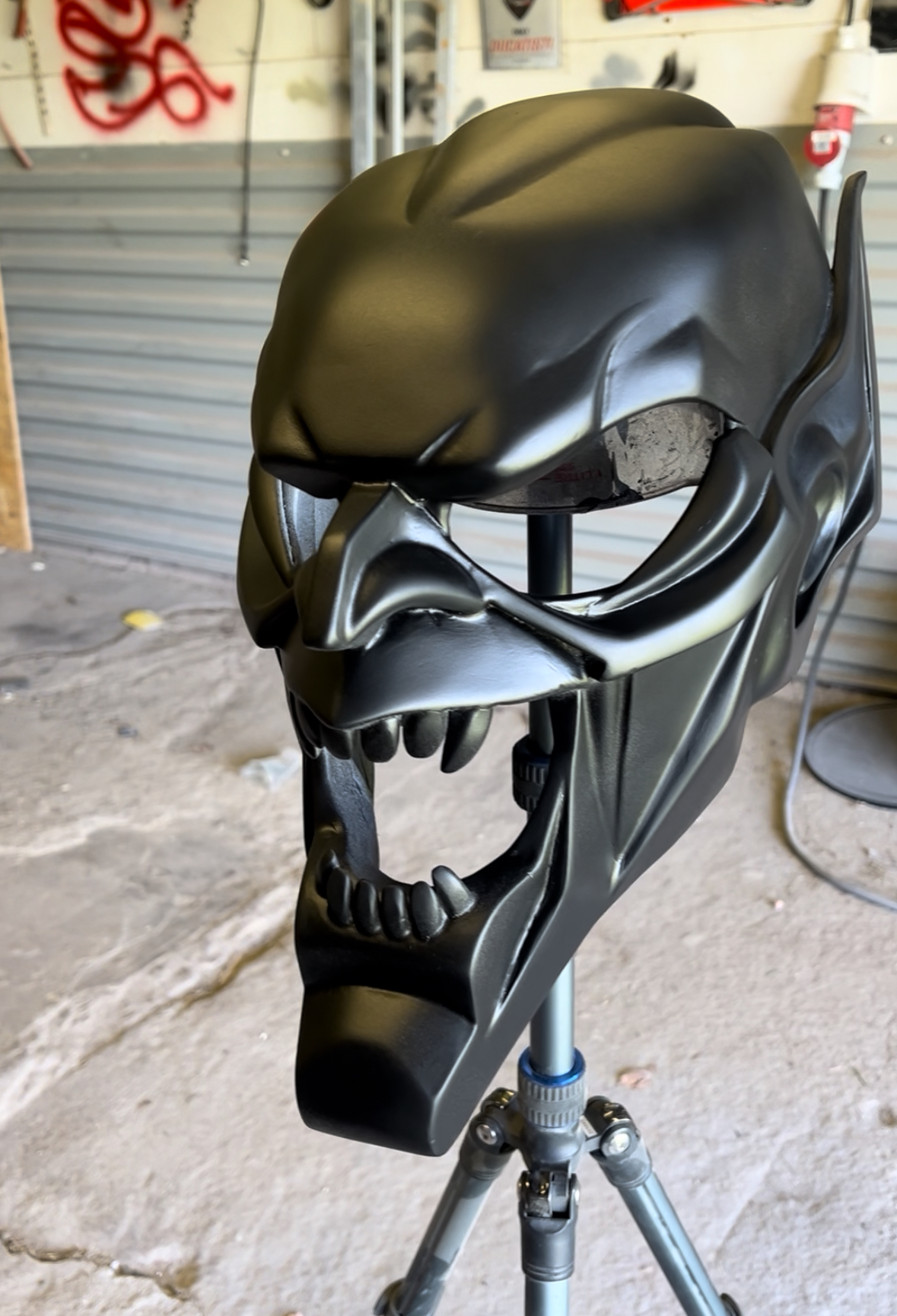

I printed this helmet several years ago and I’ve been working on it on and off for some time, and after the usual sanding process I started by hitting the piece with some matte black spray paint.

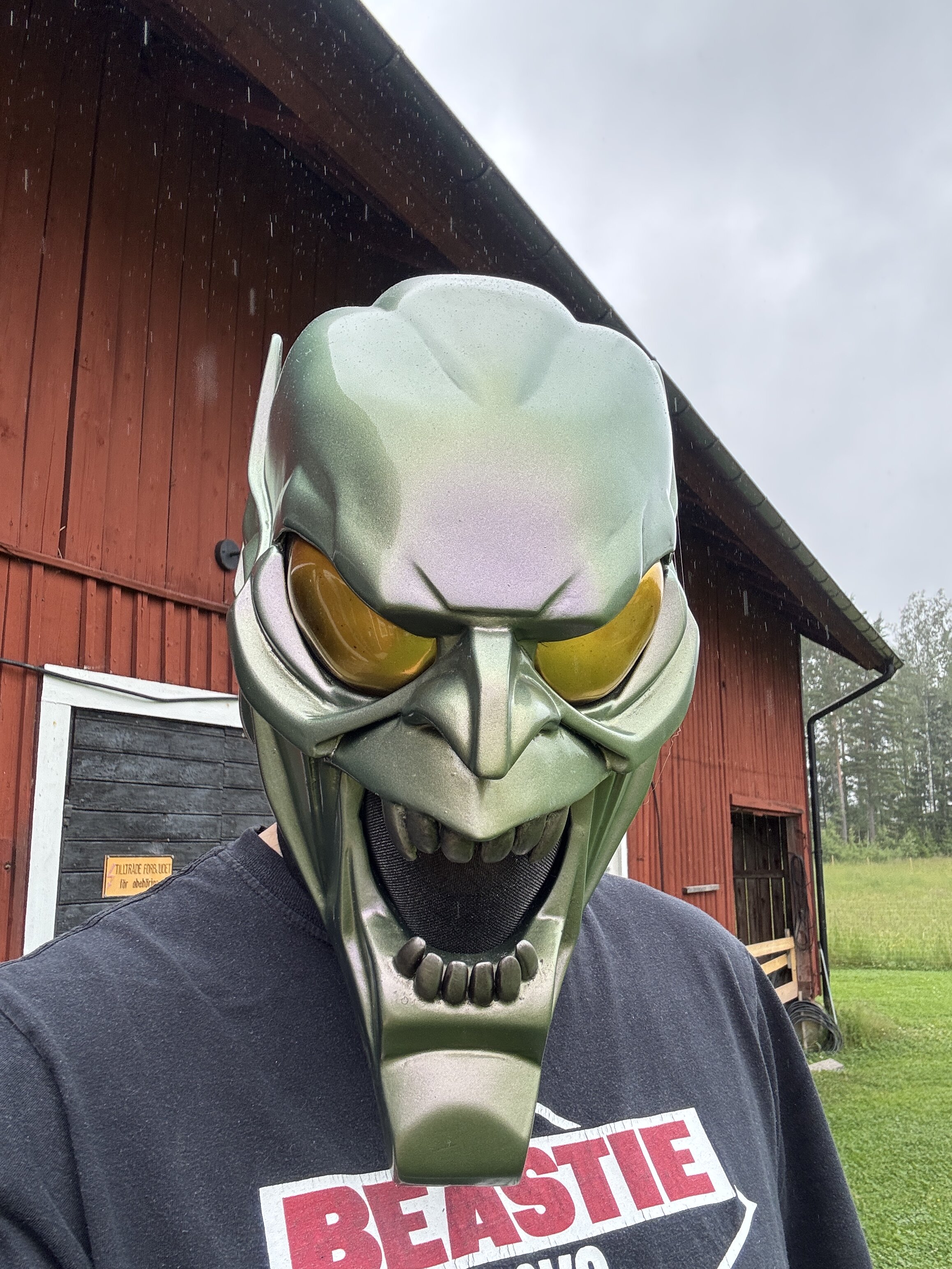

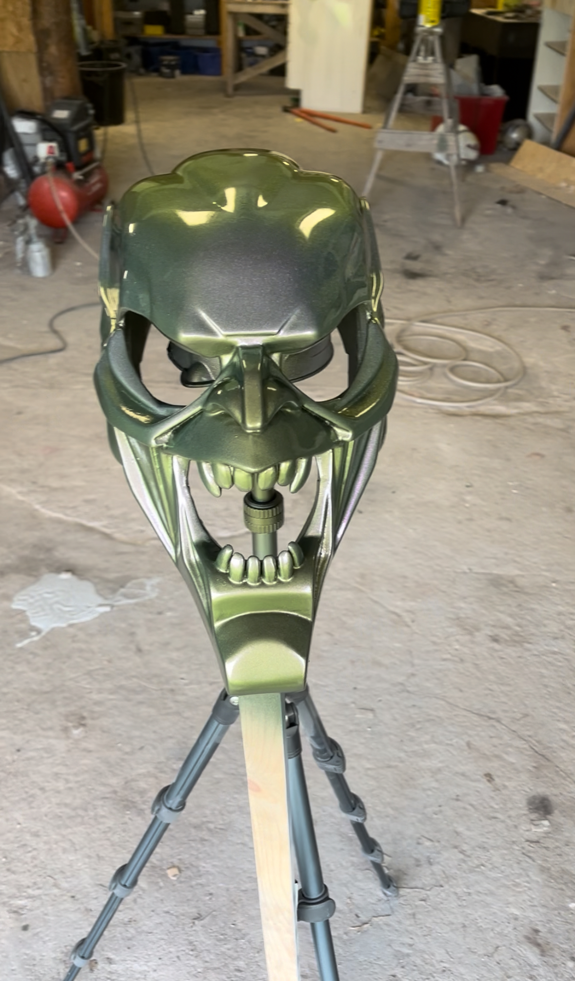

Once dry, it was time to add the green! The color comes from a pearlescent green paint pigment (the same as I’ve used for the leather bodysuit) this can be mixed into some 2K clear coat and run though a HVLP paint gun.
My setup is by no means ideal for this kind of work, but my 50 dollar HVLP gun still does the job just fine for my purposes.
After the base green coat is down, next up is to add the purple color shift effect on top. For this I use another pigment that shifts from a bright purple to a dark green.
Now you could of course use this pigment by itself to get the full effect, but I found that most purple/green shift pigments tended to have more purple than green in them, which was something that bothered me about all the pre-mixed spraycan color shift paints.
Instead I used this pigment in a smaller quantity, mixed with the same 2K clear, to add a sort of “tint” of purple that disappeared when it fades into green, blending into the base color.
This whole paintjob was then slightly matted down with some semi-gloss 1k clear coat, to better match the original look.
The back plate was also painted and held in place with friction and some elastic straps. (Sorry no picture)

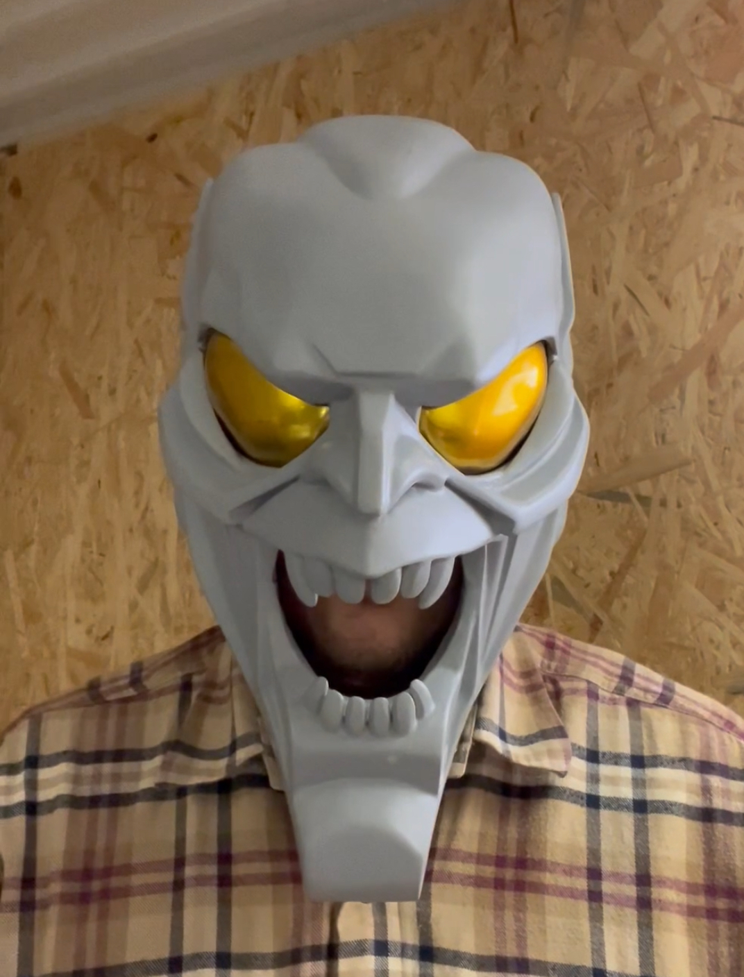

To cover my mouth I added some metal wire mesh that I painted black. The eye lenses and mouth cover were both attached with some hot glue.
The teeth were painted with some Alclad “steel” and slightly weathered in brown and black tones, to give them some contrast and depth.
And finally, to help balance this thing on my head, I added an adjustable hard-hat liner to the inside of the helmet.
