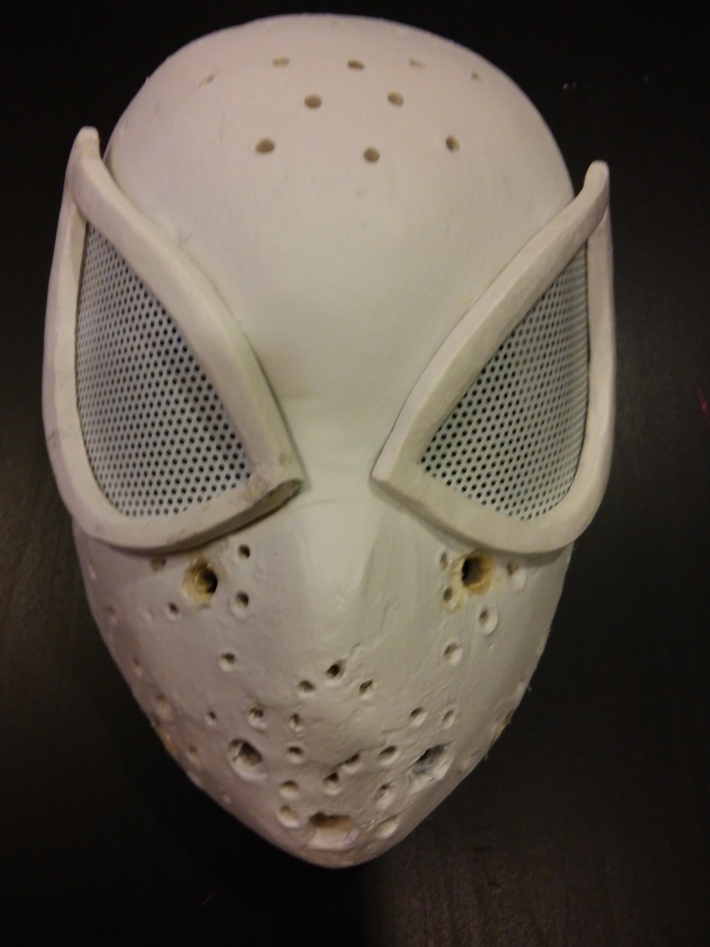

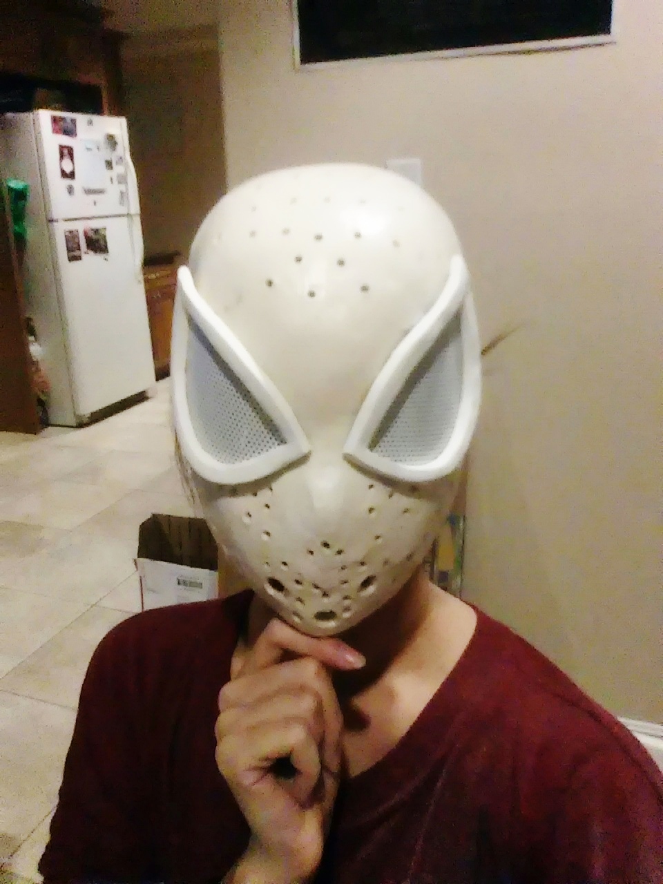

7. The lenses are just perforated vinyl attached to a thin acetate sheet. I had to make a few snippets on the edges so it could curve. Here they are just pressed against the shell with the magnets. I will attach them for real after I paint my frames pink and seal them!
I also have a sheet of thicker plastic that I might experiment with to try to get a dome shape, but that will depend on whether or not I can find something to cut it with...

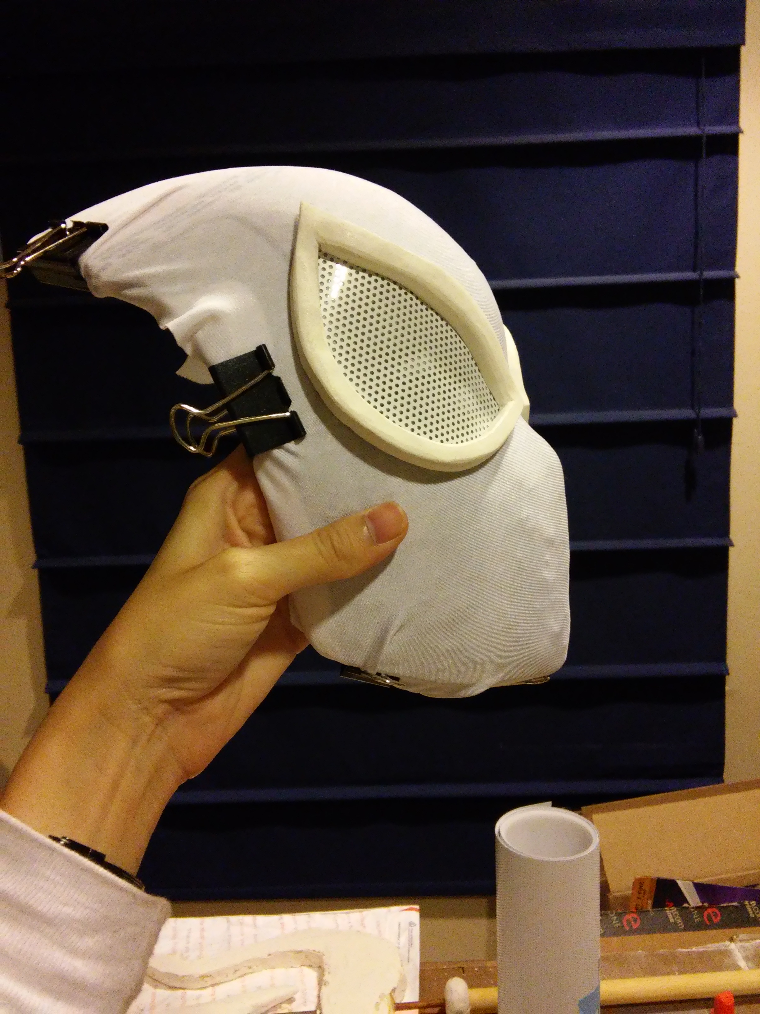

Here is a shot of the shell with my swatch stretched over it again. I can see where some of my holes weren't sanded smoothly enough and tested breathing through it. Definitely going to add at least two more of the bigger holes! I also think that the paint webbing I add might help hide the holes which you can kind of see through the white.

Update: Spider-Man Lenses and Lens Methods
Alright, so I tried out a lot of different things and think I've come up with an idiot-proof way of doing these Spider-Man/Gwen lenses. But I will talk about all the processes anyway from easiest to hardest.
Acetate and Vinyl Method
1. I've covered this in earlier posts, but here it is again.
2. You can find an acetate sheet on anything (sheet protector, binder cover, etc.)
3. Cut it out according to your frame shape.
4. Stick the vinyl on it.
5. Cut a little tick into the edge in some places to help it curve better.

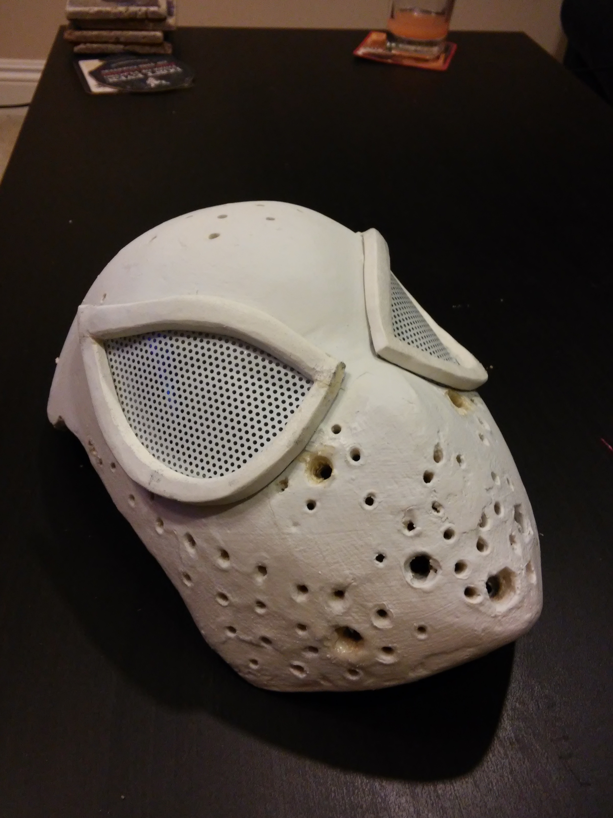

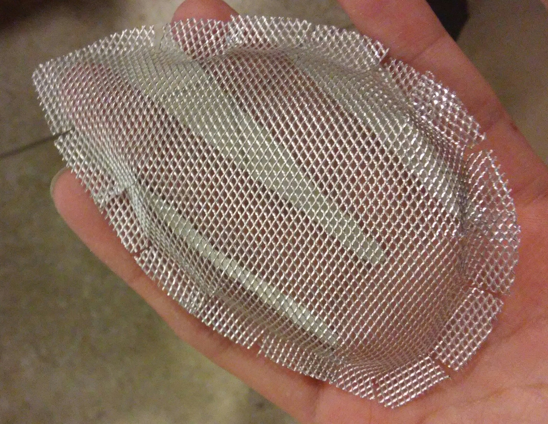

Splatter Screen Method (Avoids fogging!)
1. Like I said, you can buy this anywhere, like a grocery store and you actually don't need heavy scissors to cut it.
2. You can dome them (picture 2 & 3), but I found that this was more trouble than it's worth. I actually snapped by left pair trying to dome and fit them to the frames; not worth it (epoxy fixed them, they snapped cleanly unlike my other pair that got crushed)
3. The better method is to just cut them normally and curve them to fit the frame; this takes like 30 seconds.
4. Cut several pairs; it takes about 3 layers to make them opaque, but you can still see out of them just fine.
5. Then you'll spray paint them whatever color you want on the outside (Picture 4 is this method, white); black on the inside.

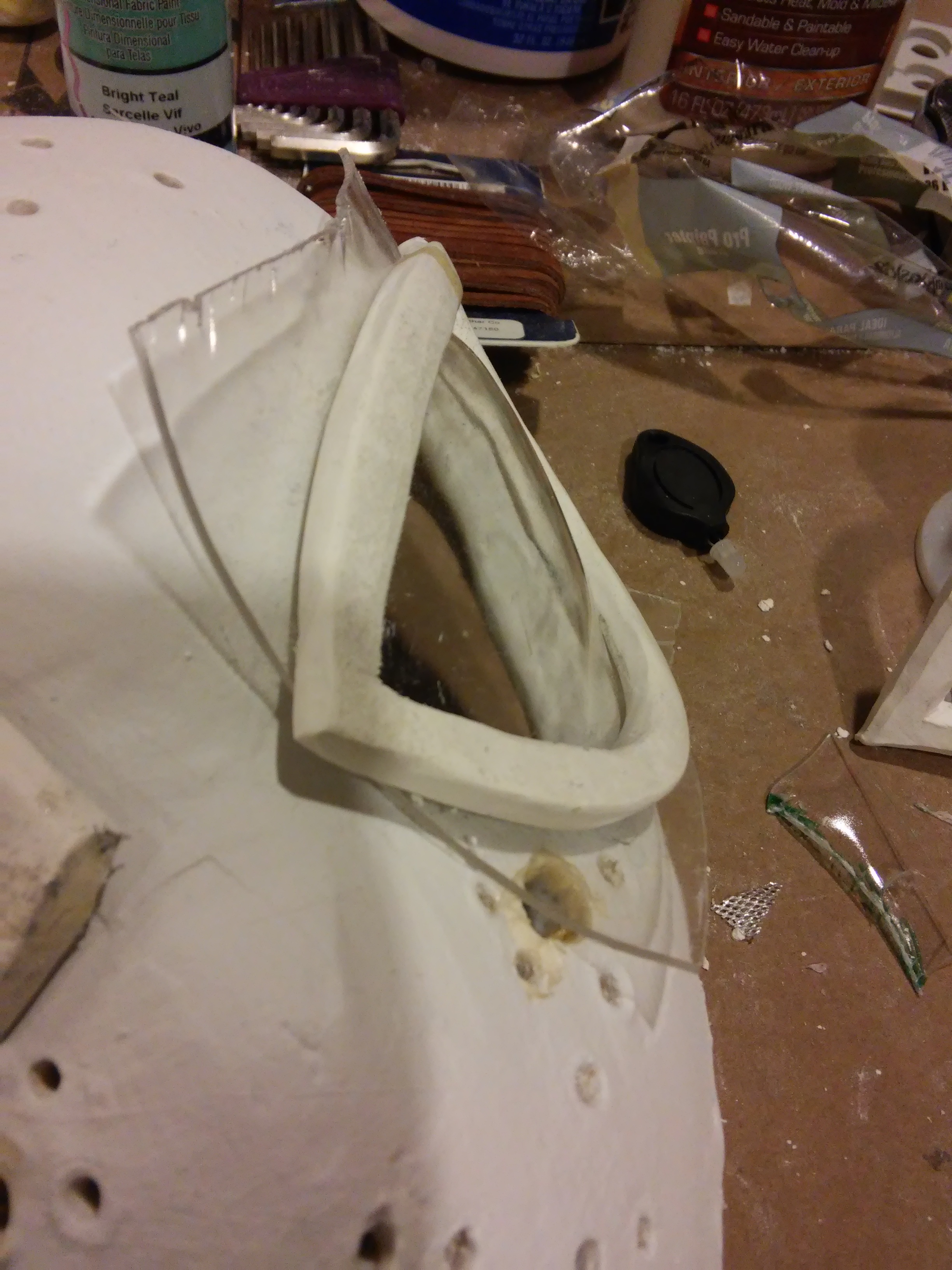

Plastic Sheet Method (Need Heat Gun, Heavy Scissors, and Gloves)
1. You can get this at a hardware store. I realized too late that mine didn't have great clarity, so ask someone about that before you buy!
2. Start with a rectangular piece; it's easier to shape than one that is already cut to your frame shape.
3. The plastic looks frosted, but turns clearer when heated; use the "Low" setting.
4. You'll start to see the edges curl up as it warms, but keep warming until they sort of melt back down.
5. You're gonna have to do this quick (Picture 2): Once melty, grab your frame and put it on top of the plastic.
-- You'll want to first dome it in a little bit with your fingers using a smooth circular motion (big red arrow).
-- Then hold the plastic against the frame to make sure it will sit flat against the frame (blue arrow).
-- A good way to ensure this is to use the excess as leverage, pull it against the frame so it becomes flush.
(This will probably result it in coming up past the level of the frame (small red arrow) but that's okay since we can cut it off.)
6. The heat from the plastic will melt the frames a little, so I warmed the plastic up again a little and pressed all of it against my faceshell to get the form back.
7. Flip it around to mark where we cut off the excess. I didn't take a picture of how it looks after you clean it but you get it.
8. Throw some perforated vinyl on it.

Splatter Screen (flat): doming isn't worth it (just to me), but the flat method is really painless. It is only more complicated because you need to paint the mesh. I think this one actually looks the best in person, but it requires you to make sure you used the same grain pattern in both ones. You can see here that the left one I did well, but the right one I photographs with slight vertical shades; that's because it didn't cross my mind to match the grain patterns with the other lens. Either way, it looks good in person but tends to photograph kind of strangely.
