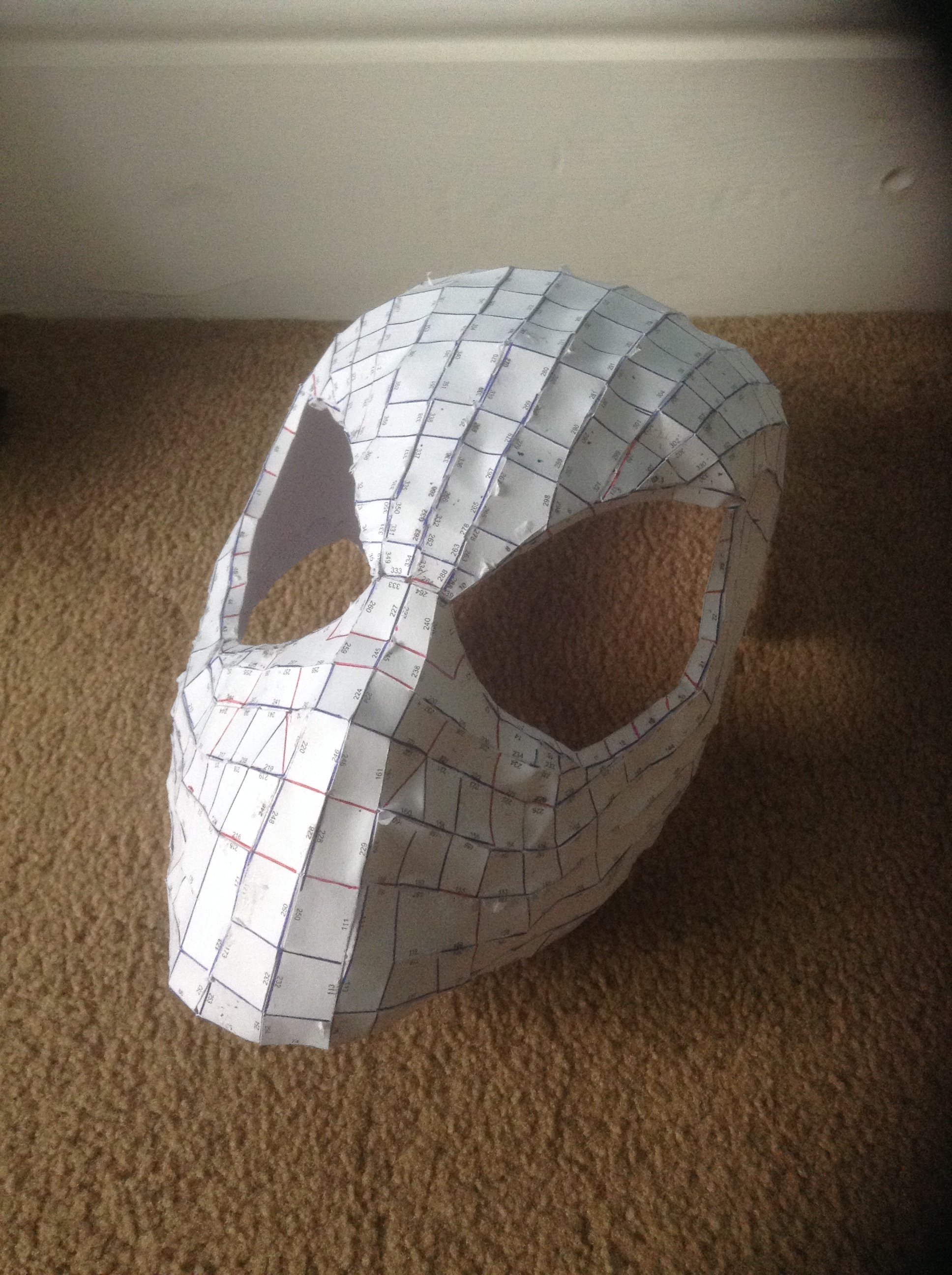

Hey I saw your work and I'm really impressed ! Actually your post was the most detailed and guided one I'd seen ! Question, I'm making a 2012 TASM suit and for the faceshwll I got to the point where I need to spackle it , I bought red devil filler, but when you did it did you just apply it straight ? Or were there any steps in between ? Because I've pepped it and covered it with masking tape but not sure if I spackle it straight ?

The spackle I just applied straight on. When you do the glue or sealant step, that will make sure the spackle holds on (otherwise it may crumble off if it gets knicked). Bondo is a much better cover, but this I'm still a noob and I know that spackle is REALLY easy to sand. Just slapped it on and spread it like frosting on a cake! I also discovered recently that there is a "Lightweight" spackle that seems to function exactly the same but weighs nothing. Used it on my cubone mask!

Looking forward to the Cubone one! And yeah! I got the Red Devil Onetime filler (lightweight), its sooo light! Problem is its ready mixed so i applied it straight on, on my 2nd coat (busy with exams). Thing is atm my faceshell looks nothing like yours! How much did you actually apply? It is really easy to sand but its like really crumbly. And with the glue what

I applied a pretty thin layer, only enough to cover the ridges of the tape. Although there is more on the forehead, nose, and chin where I corrected the shape. Can you post of picture of yours? As long as the paper form of your mask is good, you should be able to sand away any part of the spackle that is giving it an odd shape.
The glue (I used Mod Podge) serves as a sealant. I did about three layers and it's easy to brush on over the spackle. Just holds it all together and gives it a smooth finish that's ready for paint!

well this is after 2 coats (1 watery like, 1 straight from the box):
Its in much better proportion than it looks, its starting to get the strength i want, and the lenses i basically used the Gimpee one, and modified it to get the TASM1 look rather the TASM2 one.
