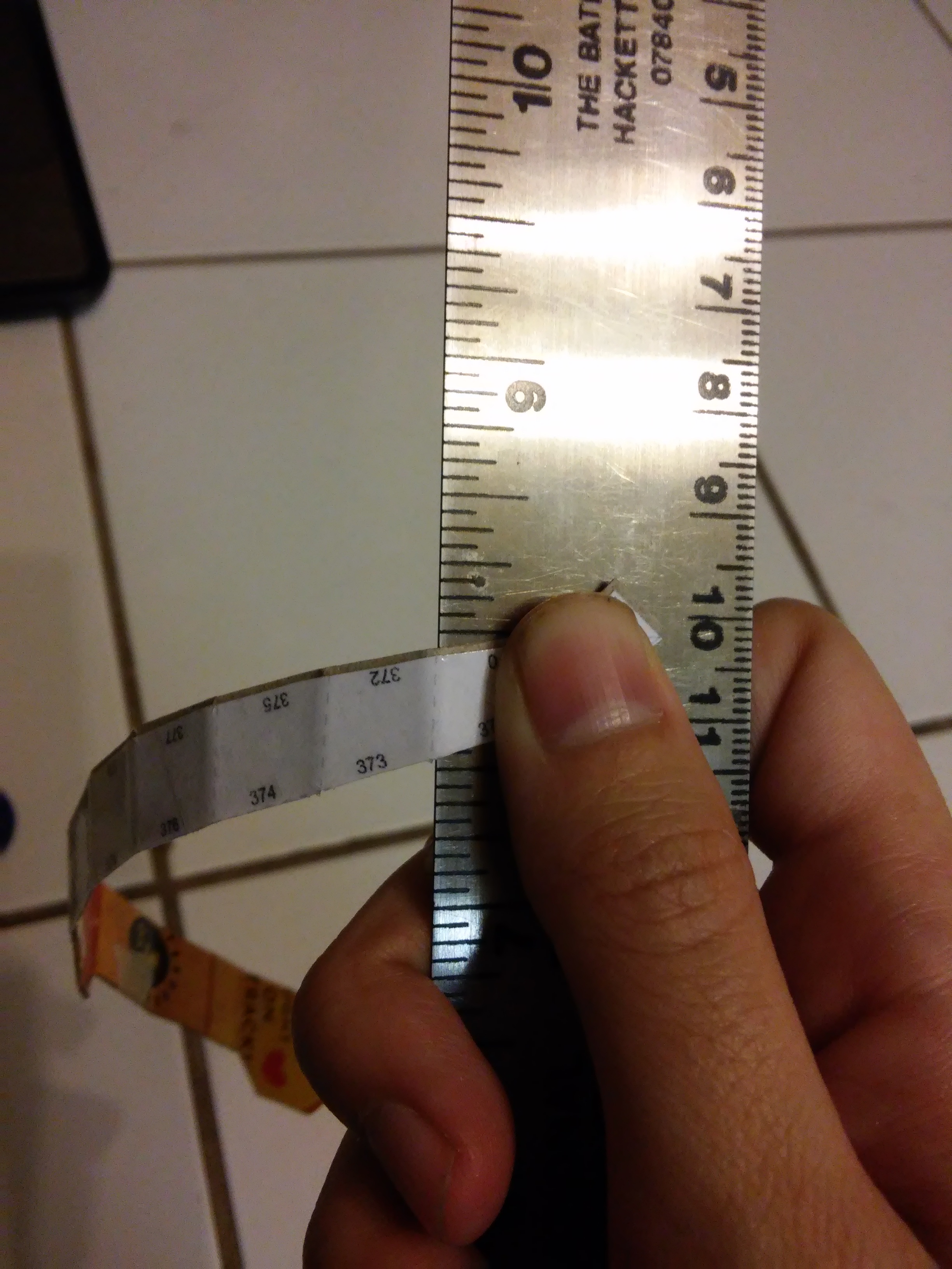

  2. Measure what this distance (tape measure is $1 at Michaels) on you, from between your eyes down to your belt. Remember not to look down while measuring!
  3. Resize the image until this ruler distance matches yours. Do this by going to Image à Image Size and fiddling with the Document Size inches until you get it right. It should be linked to height, so you only have to adjust one parameter.

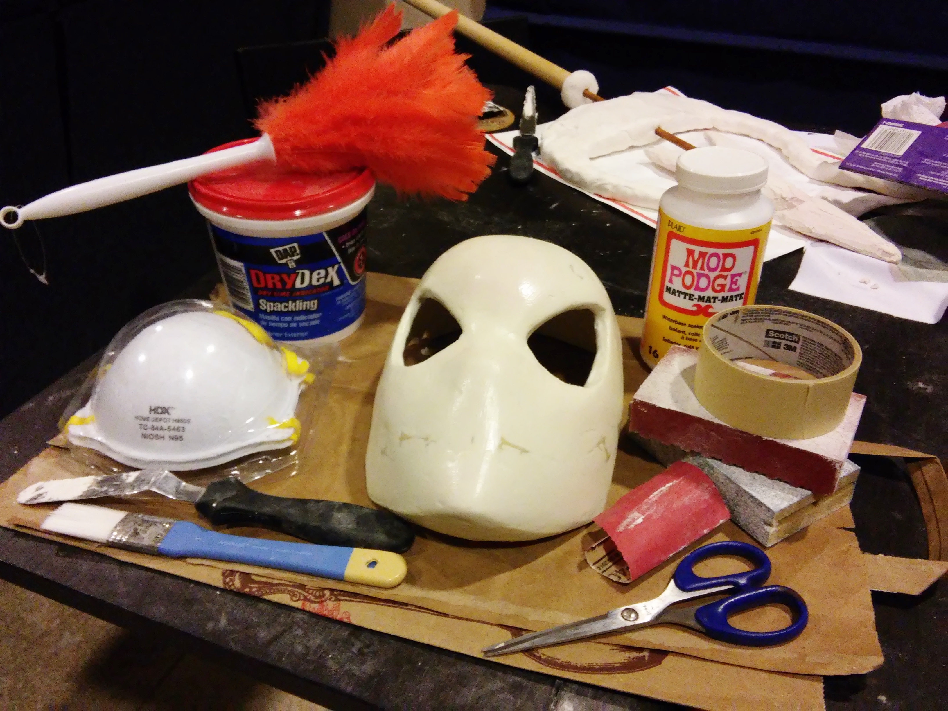

Materials (Pictured)
I downloaded Pepakura Designer 3 and picked up Gimpee’s faceshell pepakura file.
http://www.therpf.com/f78/spiderman-face-shell-pepakura-file-foam-version-jfcustom-pdf-added-211099/
- Cardboard (cereal box): $3
- Masking Tape: $2
- Dry Dex (quart): $6.50
- Sanding block: $3
- Sanding paper (400grt): $3.50
- Modge Podge (16oz. Matte): $7
TOTAL: $25

1. I taped the paper onto a cereal box and cut out the pieces. Honestly, if you are using cardboard, You don’t really need to cut out all those tabs. I basically left one or two on each side just to add structure, but doing all those tabs would have been a pain in the a*s and probably made it look a little bulky.
2. One thing I recommend is bending the folds around a hard surface instead of with your fingers. It's cleaner, faster, and your thumb won't go numb, lol.

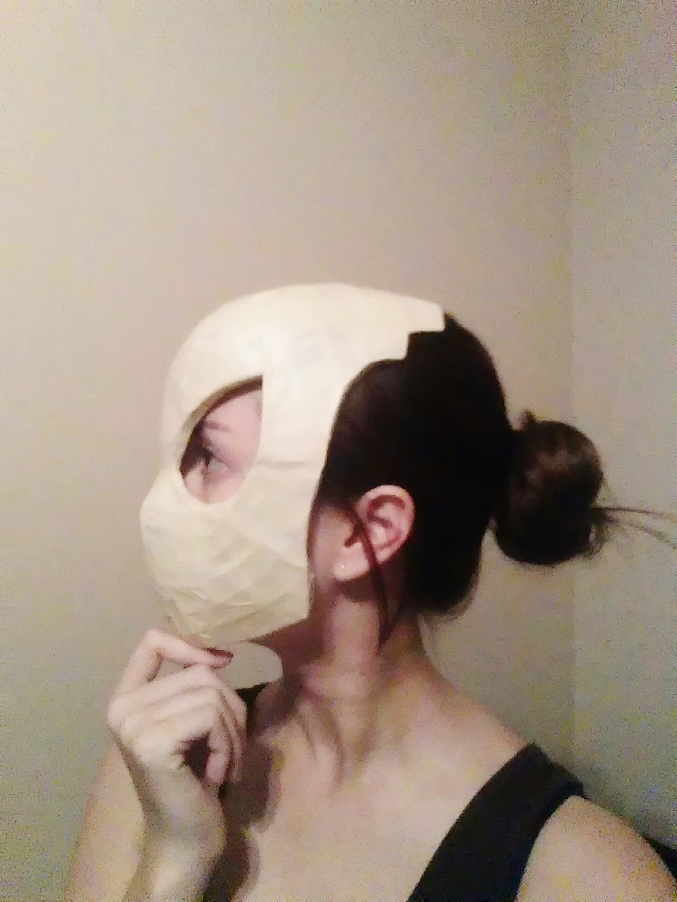

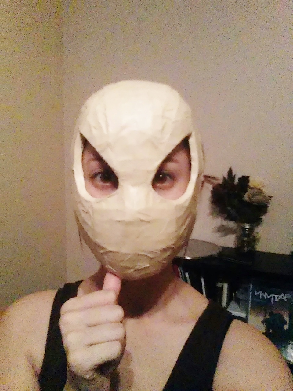

3. Once it was about the shape I wanted, I covered the whole thing in a layer of masking tape to add a bit of stability

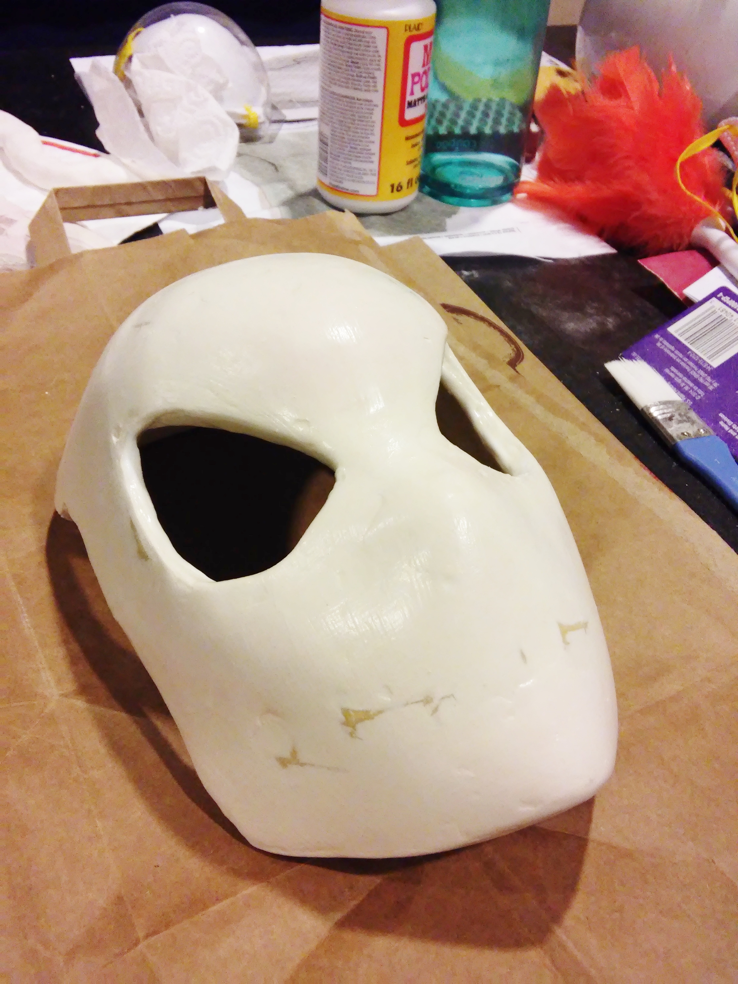

4. Spackled and sanded. Stretched my fabric swatch across the mask to see if the shape was right. Added spackle to fix the flat brow, make the nose higher/wider, and add a sharper chin.
5. Sanded, then sealed with glue!

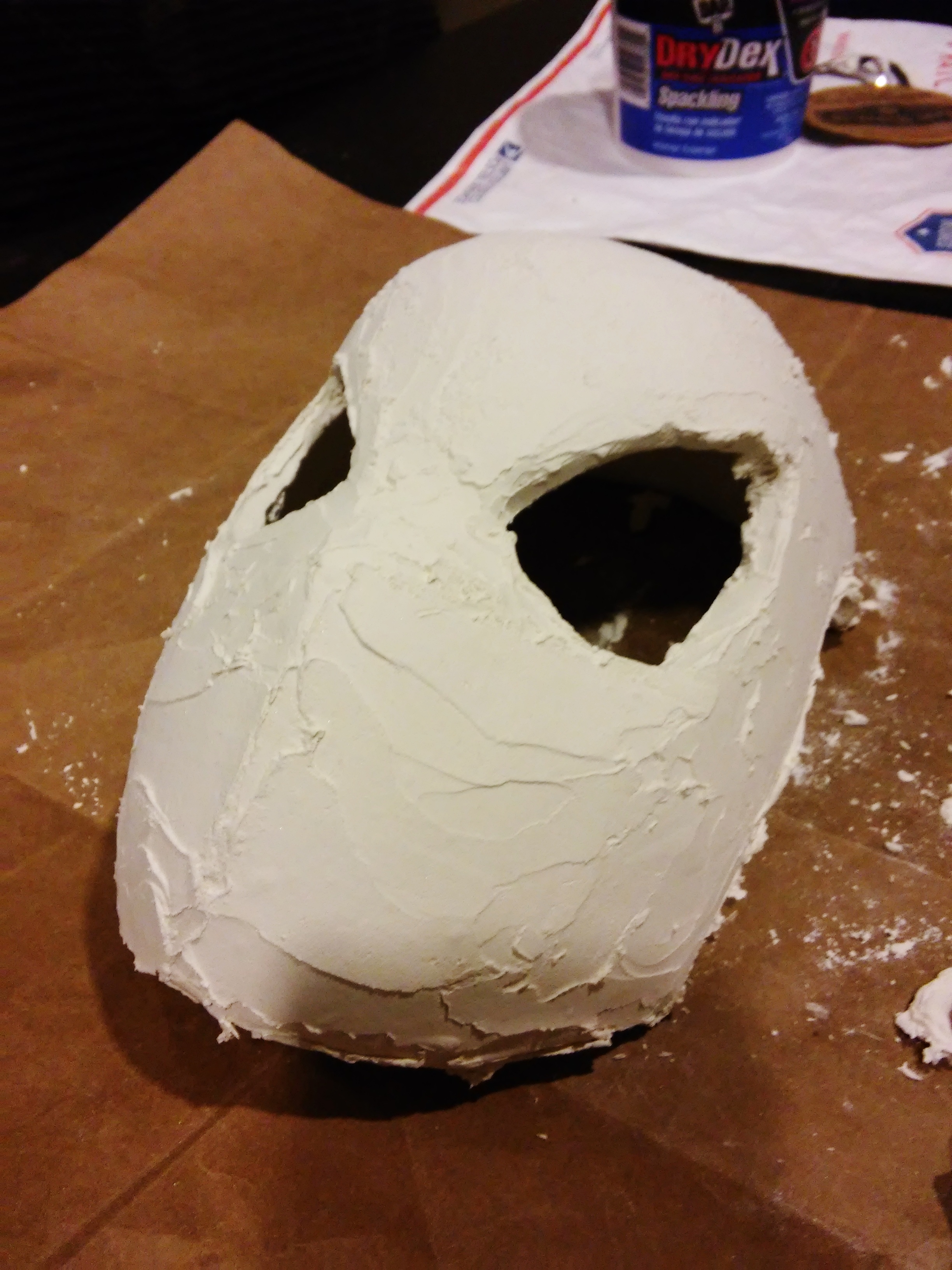

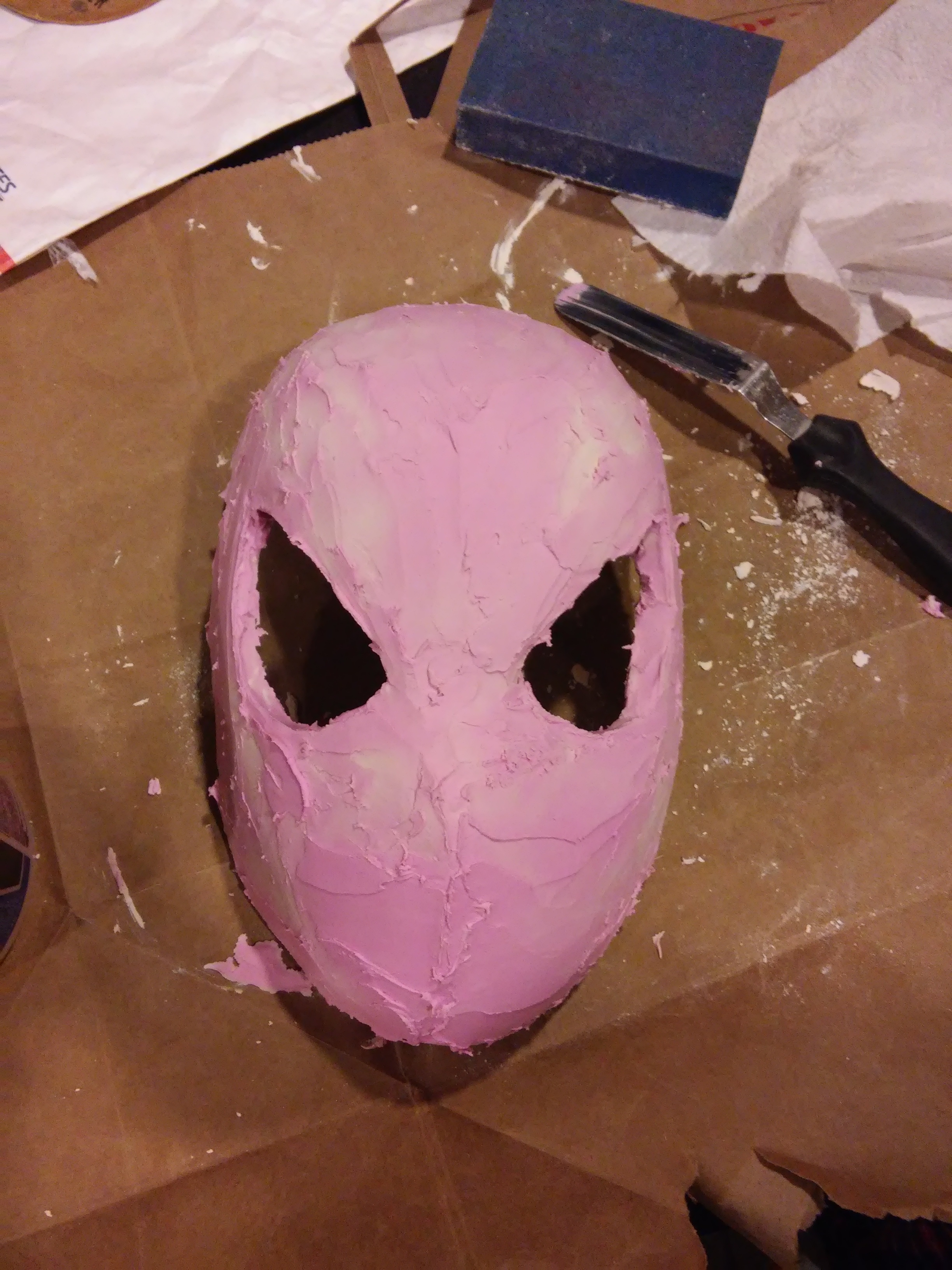

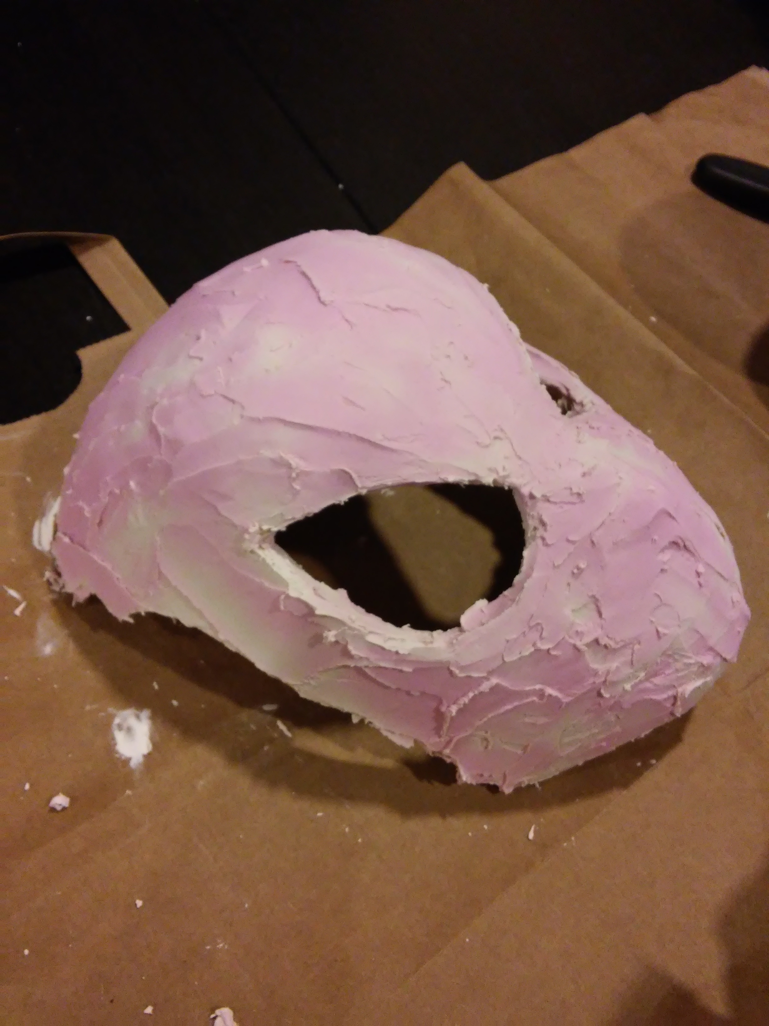

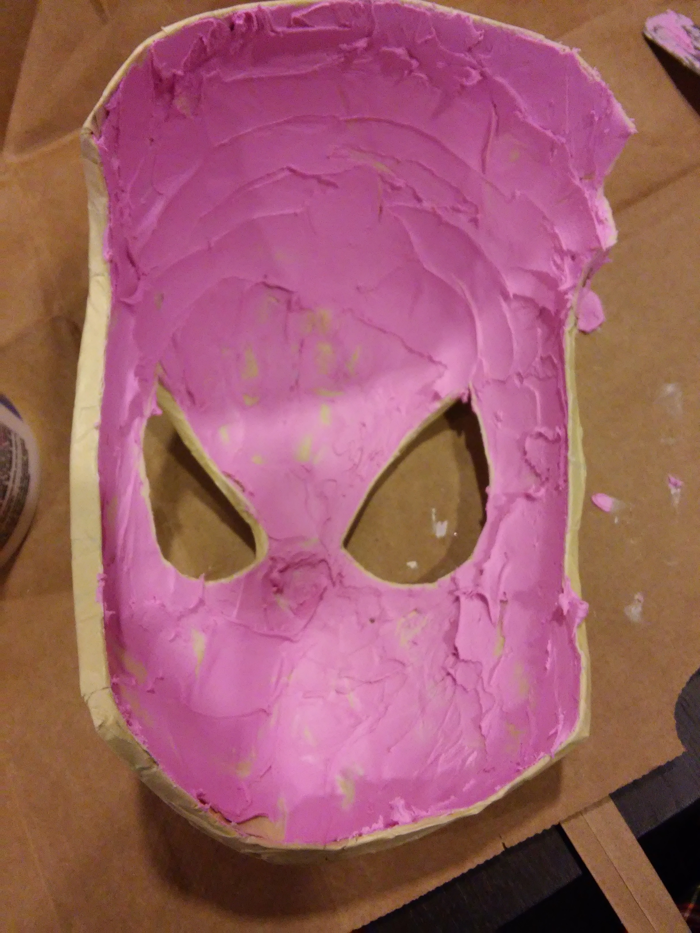

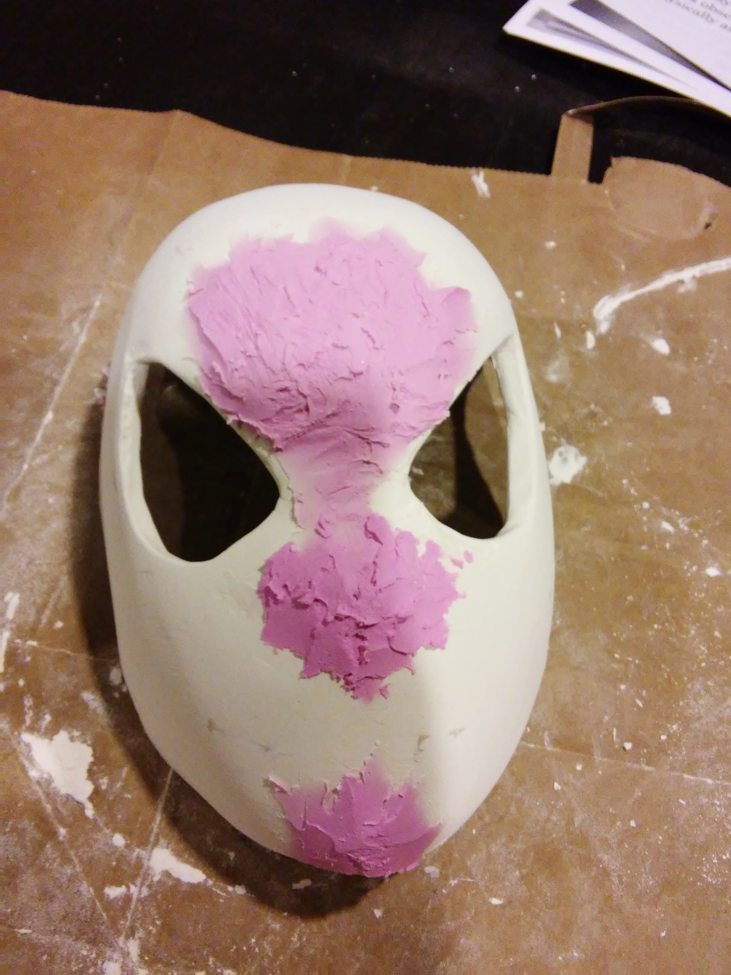

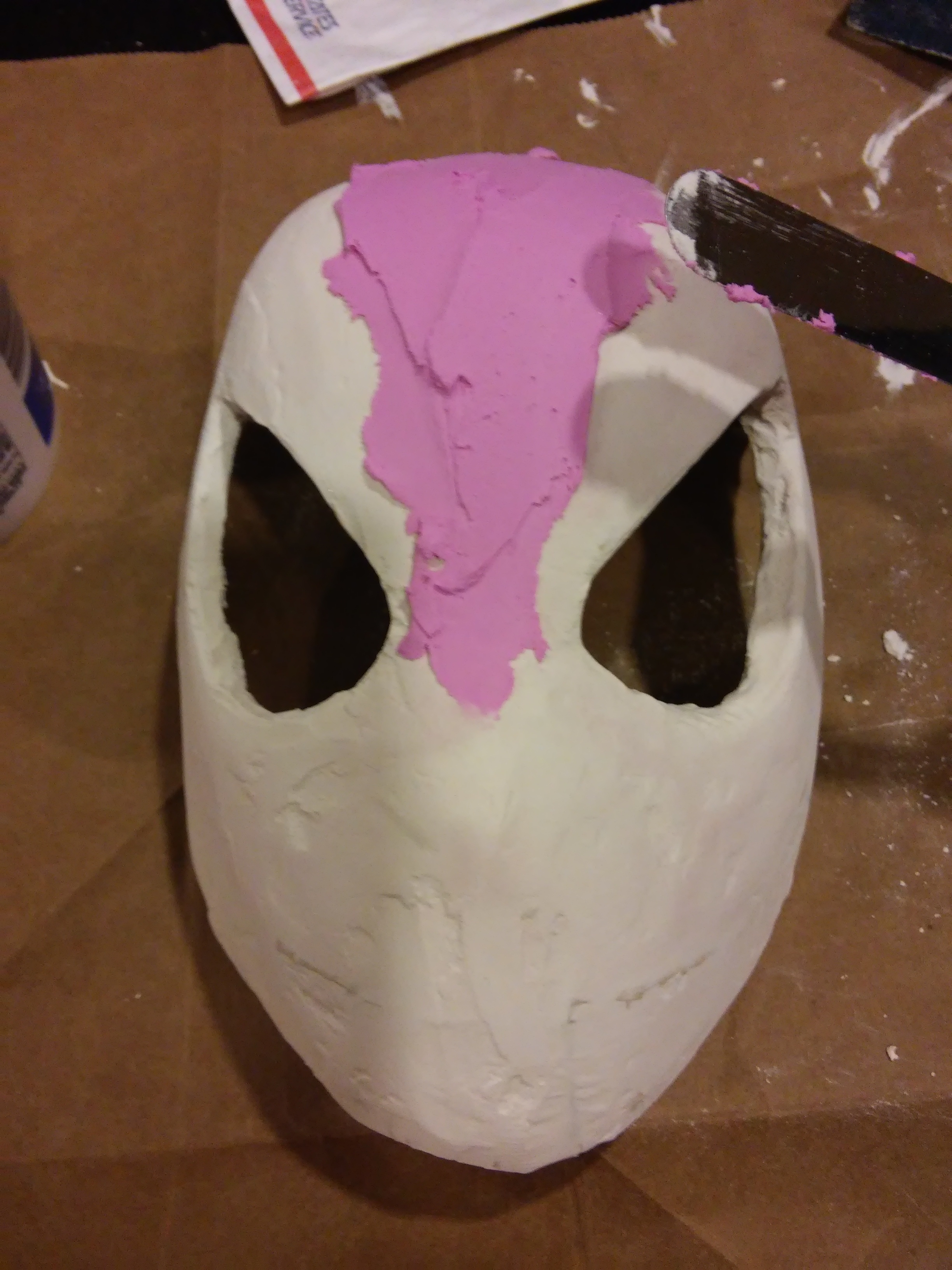

Update: Spackling the Faceshell
I used DryDex spackling on top of the masking tape. I used a spoon to apply it on the inside and a frosting knife for the outside. I didn't expect it to be so pink, but it helps a lot in telling if it's dry. I found out that I didn't tape on a few strips quite tightly enough, so when the spackle made it damp, it wrinkled a bit. Not a big deal, but I had to cover those two areas a little more. Tape tightly!
It's also crazy easy to sand! It took about 3 hours to dry. This is just the first layer so I sanded pretty loosely. Waiting for the second layer to dry. I added more spackling around the eyes since I'd like to drill a little there for the magnets.
Looks good! I did used the same method to make my faceshell from Gimpee's file.
I found that the spackling will become "pink" again if it gets moist or water is splashed on it. I suggest painting over the spackle so it won't turn pink and to avoid breathing in any of the dust that might fall off.
I realized later that I should have been wearing a mask when my cat jumped into the dust residue and puffed it all into my face. Lesson learned.

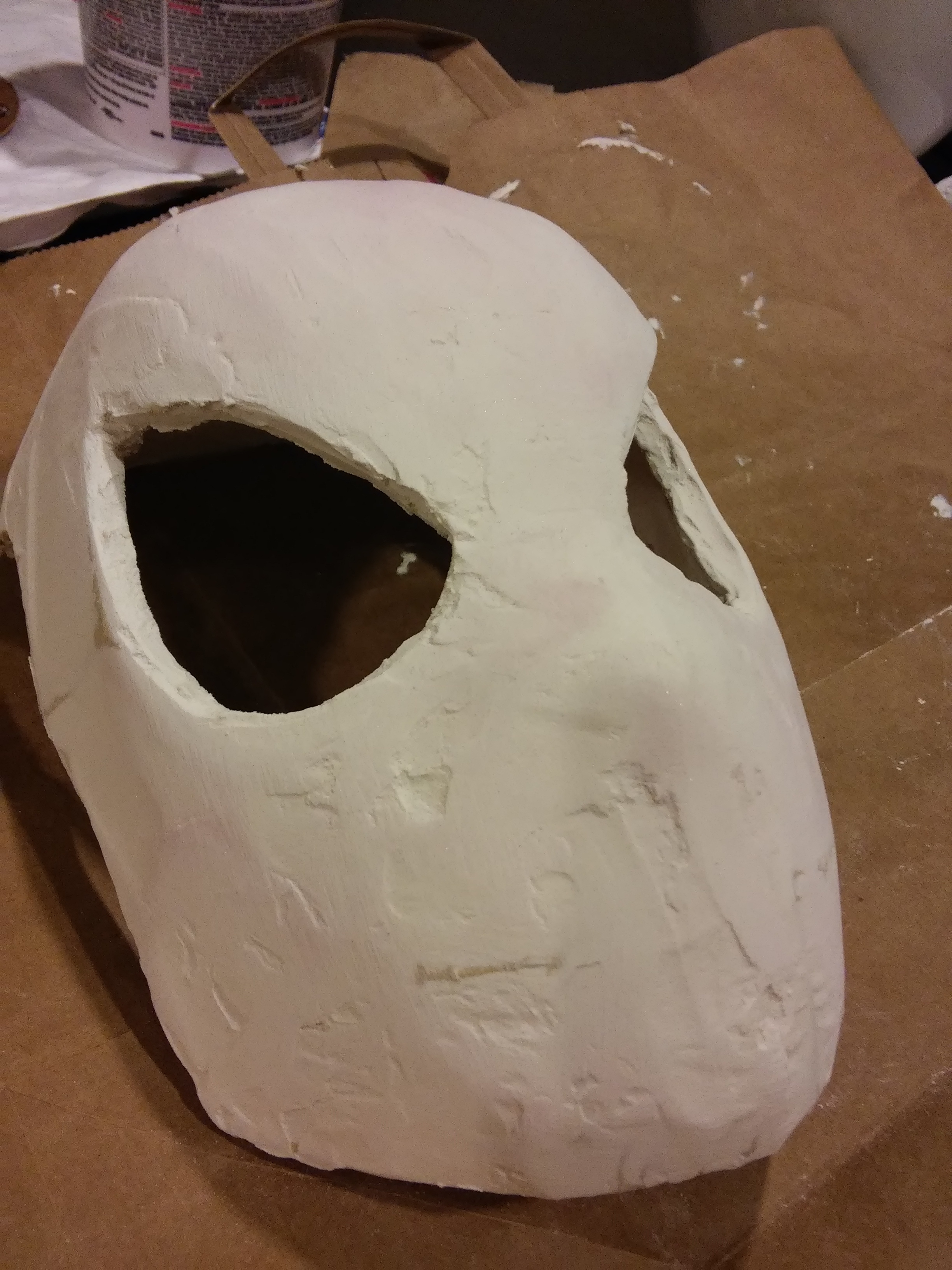

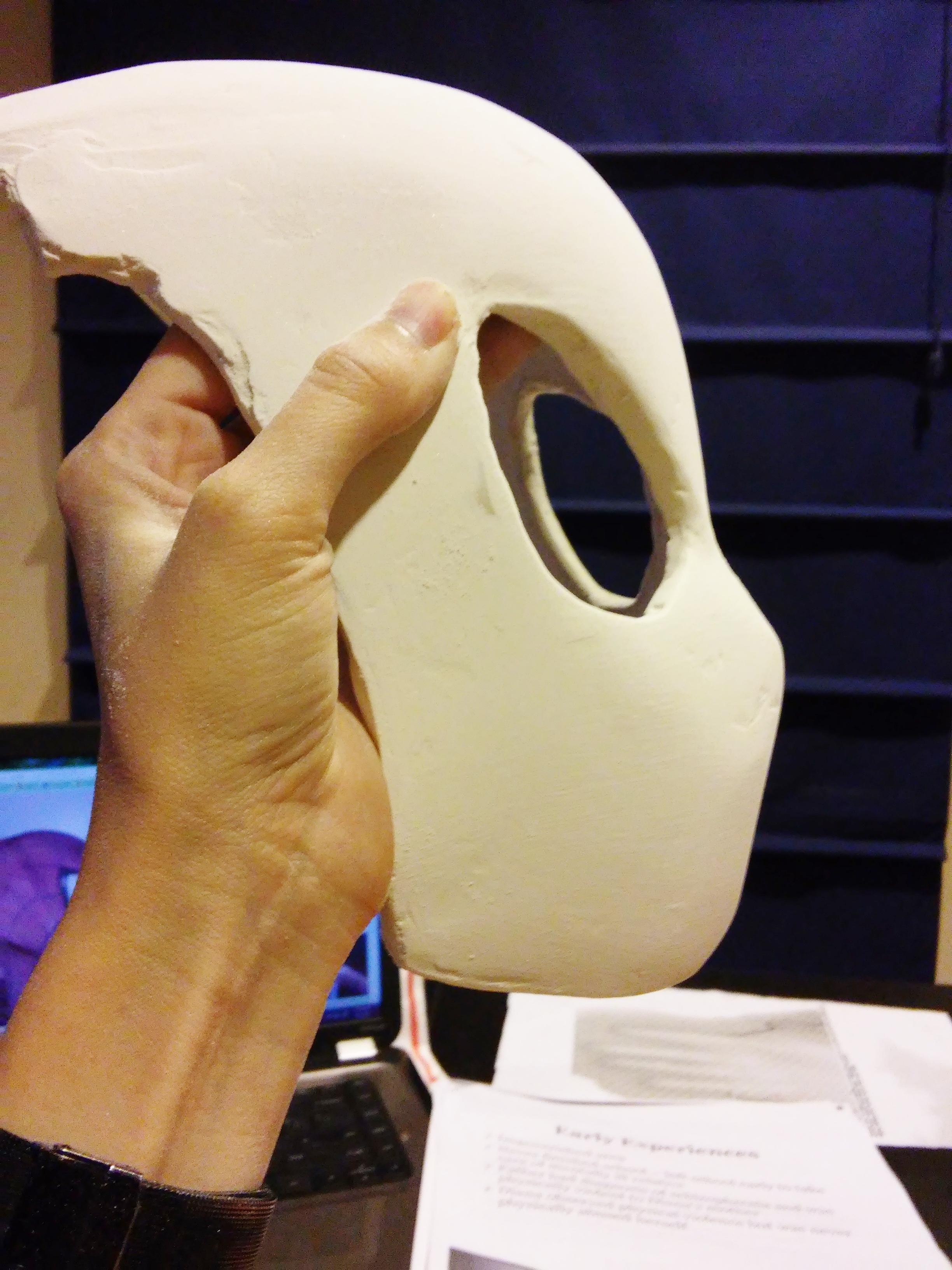

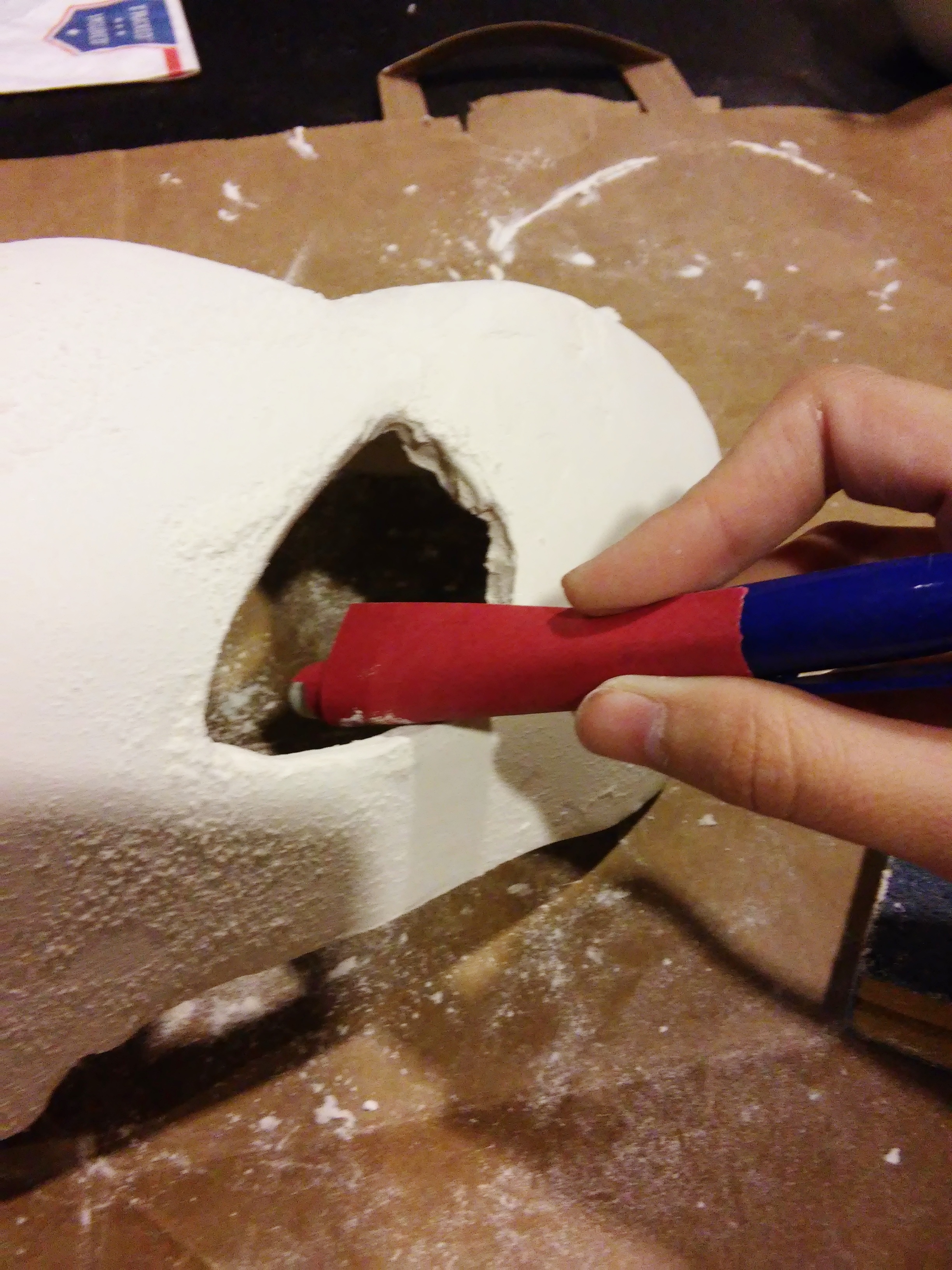

Update: Sanded the second layer (this time with a mask!) and evaluated final shape.
1. This time around, I actually sanded everything down so I could see what the final shape was. For the eyes, I wrapped sandpaper around a marker. For the eye corners, I folded the paper in half and got up in there.

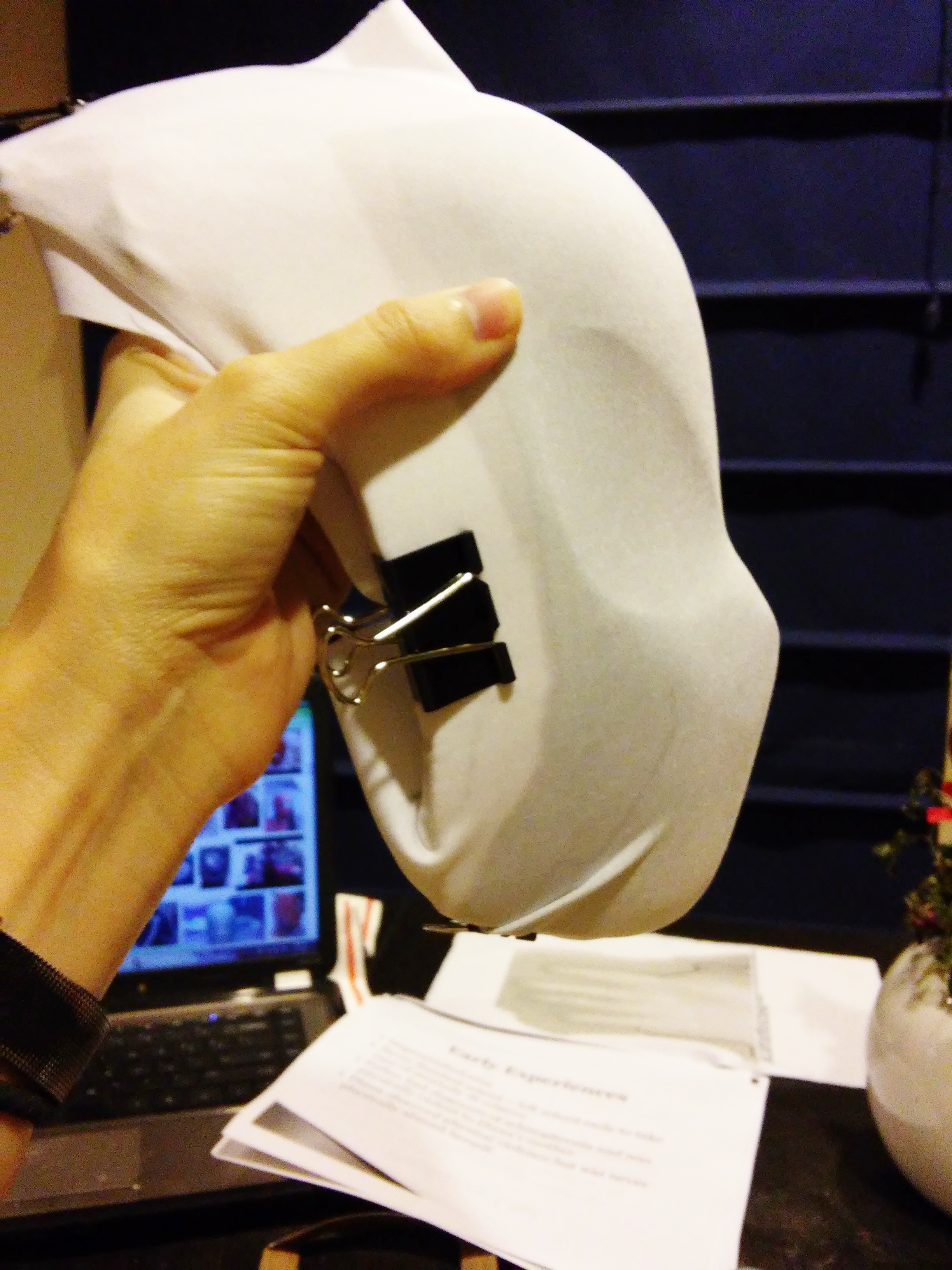

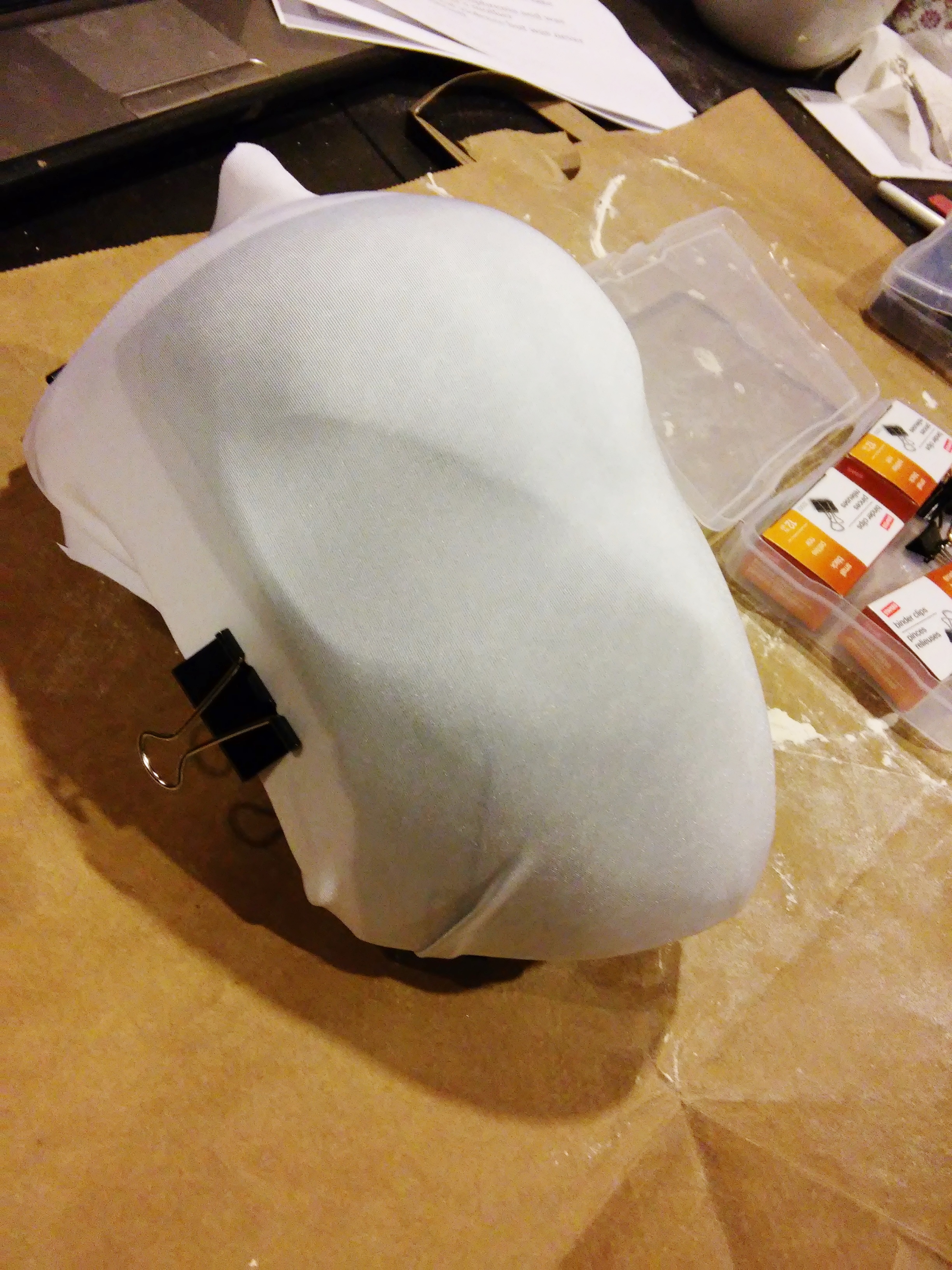

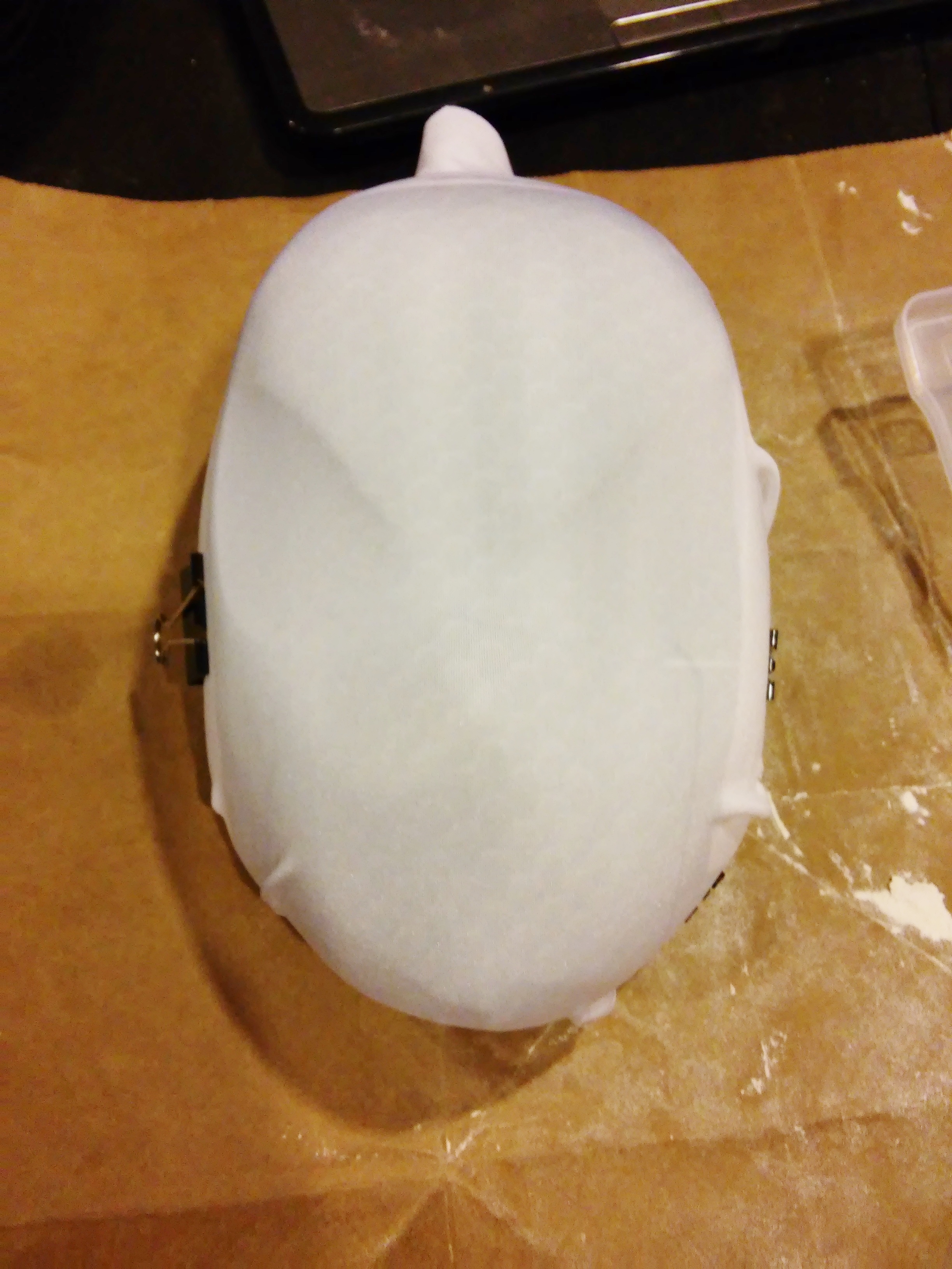

2. I had a hard time looking at the plaster and seeing the shape (the stoke marks messed with my eyes). I picked up a swatch I had printed from fabric on demand, stretched it across my mask, and binder clipped it. This helped a LOT. I decided that I needed a more prominent brow, the nose should be a little higher and wider, and the chin should be a little sharper (all areas that FirstPick mentioned are important, funny enough).
3. Just pictures of the patches I added. Should be done with sanding tomorrow night and be able to seal!
