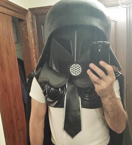

Hey! Coming close to building this costume for myself. My question is what did you use for the two circular flat pieces for the chest?

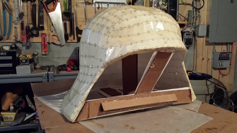

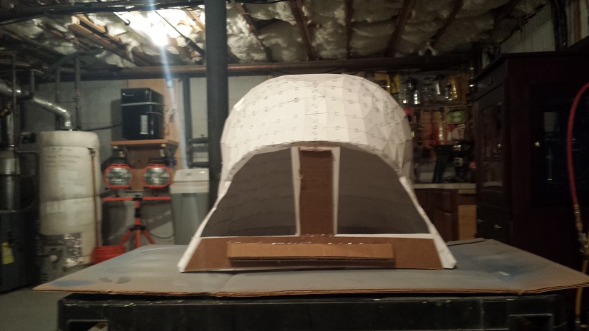

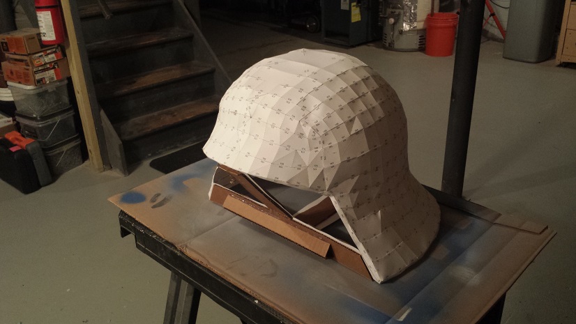

Step 1 - Obtain a pepakura file of the Helmet. For that, I used Dark Helmet helmet by Darkside501st. I have to give the creators of the pdo files a lot of credit for their time and effort contributed. Thank you. After resizing and printing the helmet on 100lb stock paper, it was time to start cutting and gluing. Nothing new here, just applying what I did with Halo armor below:
Used cardboard to reinforce supports. This decreases warping when applying fiberglass resin.

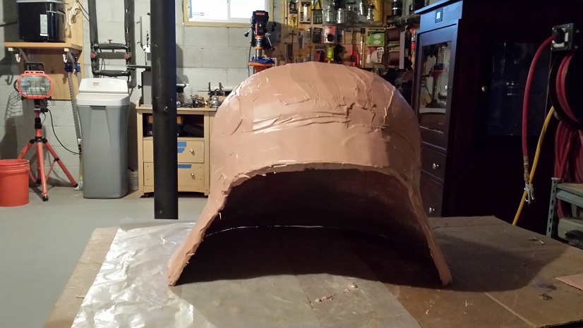

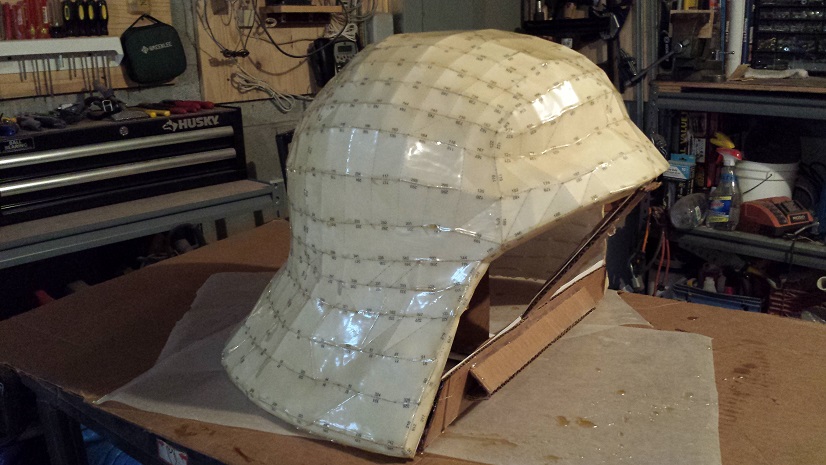

Step 2 - Coat with Fiberglass Resin:

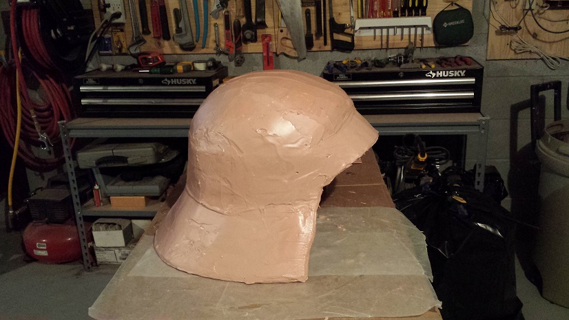

Step 3 - Apply the Bondo:

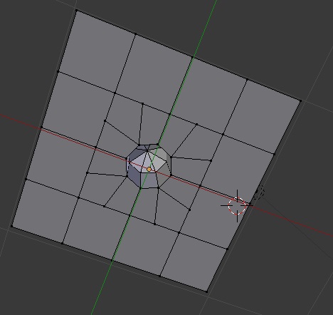

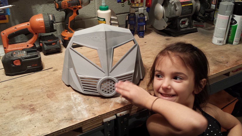

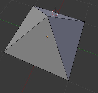

Step 4 - I decided to pull part of the mask out of the PDO and use the program Blender to help turn it into a 3d print .stl file. The below was the result:
Daughter photobomb! Since the mask was too big for the printer, I split it into 3 parts. You can see the seams above. Each seam was sanded and painted smooth. When gluing the parts together, I used hot glue first, then a rondo layer over the seam and fiber tape across the seam as well. The fibers add a lot of strength.
Dry fit the pieces together. Looking good so far.

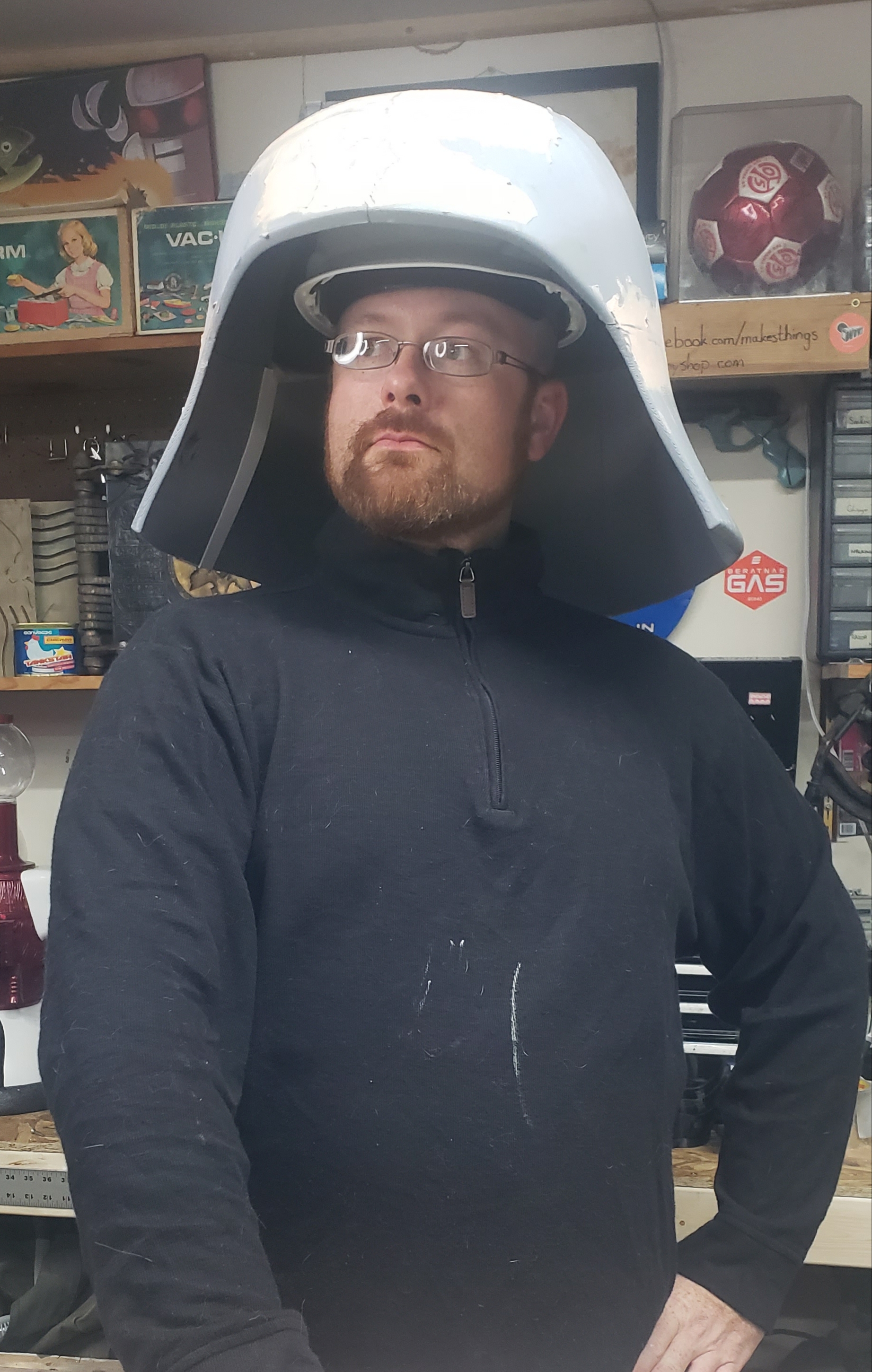

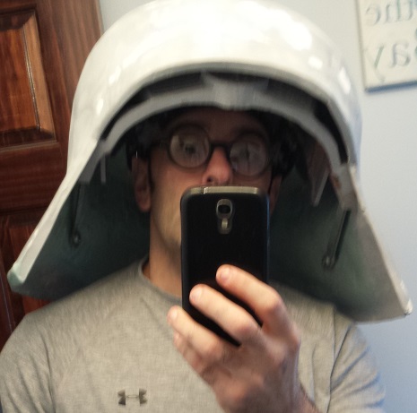

Step 5 - Now for the hard part. I need this thing to sit on my head and not my shoulders. I don't have many pictures but I should be able to give you an idea of how it was done.

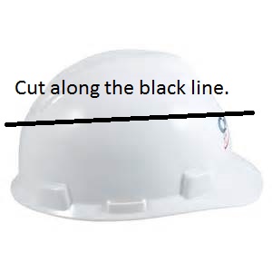

I took a a hard hat that has an internal head holder like the one below:
Then cut the top of the hard hat off.
I cut along the top so that the dark helmet faceplate has a place to go when it is in the up position.
With the hard hat ready, I mounted it to the helmet making sure to place screws on the back half only.

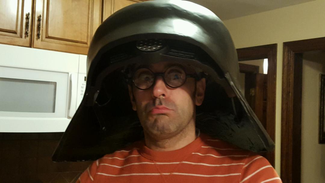

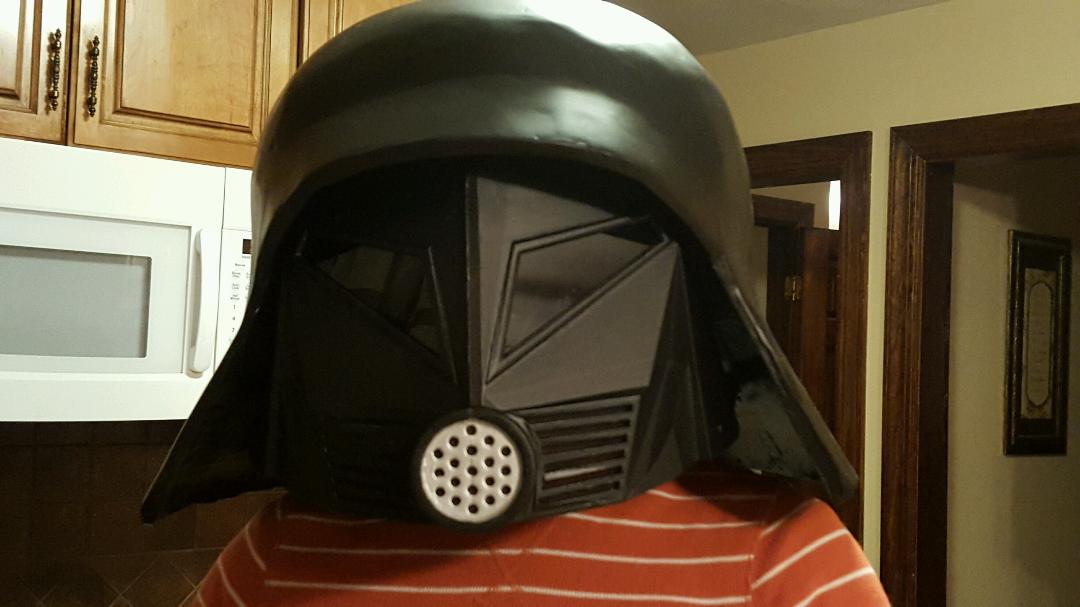

Step 6 - Dryfit the helmet.
You can see the hinges above on either side.
Step 7 - Create tinted visors using plexiglass and car tint.

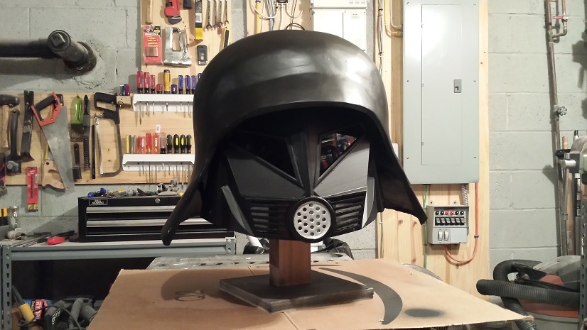

Step 8 - Paint and Finish assembly

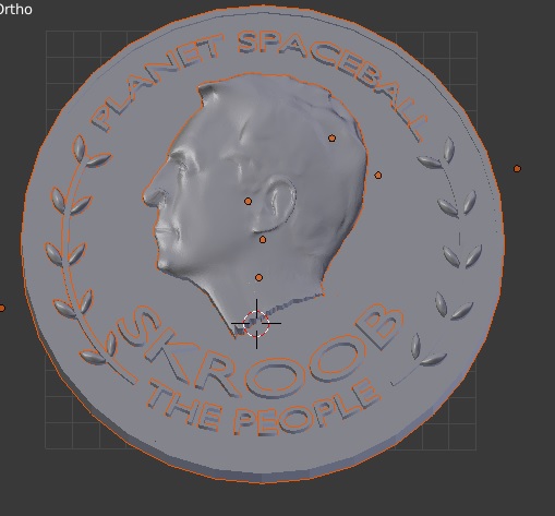

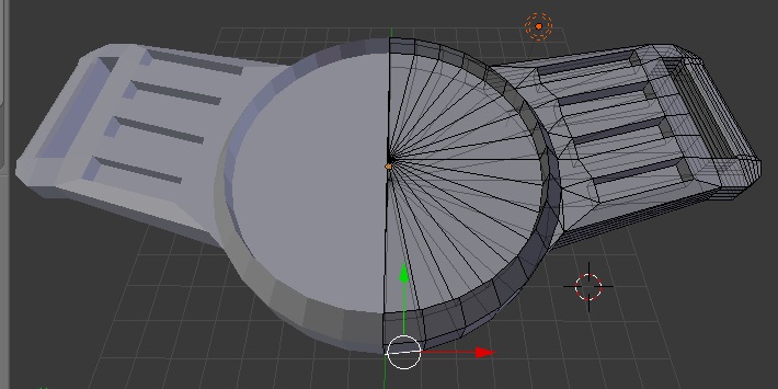

The Belt Buckle:
This was rather involved and I needed to know how to use blender. After some time creating, I finished with the following designs:
Pyramid studs:
I couldn't find any online the right size (3/4" x 3/4") so I made some on the 3d printer and placed a hole in the bottom to screw in an 8-32 1/4" screw. Worked nicely.

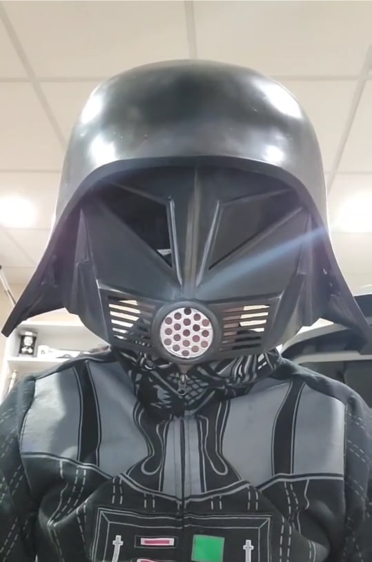

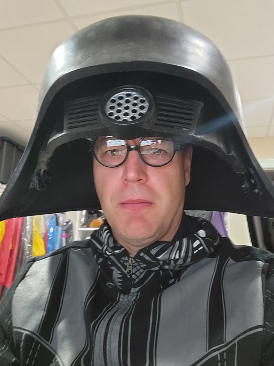

Hey Moe! Just wanted to say a big "THANK YOU" for this thread and your generosity with the 3d prints! I finished my helmet and working on the soft parts. Now if I can just lose six inches of height!!! :lol:
View attachment 1473308 View attachment 1473310
You are welcome and that is absolutely fantastic. If you have some screen door material laying around, you can layer the grates in the front to black it out more but great job overall and the engineering seems to look spot on as well!
Was going to try black foam to block out the grates, but like your idea better - thanks!

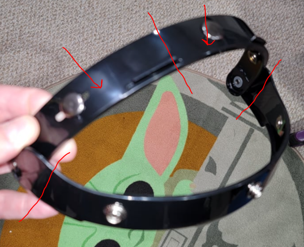

For the engineering for the front to flip up, I thought of the ratcheting mechanism that motorcycle helmets have for their visors to keep it in the "up" position. So took a motorcycle helmet flip up base attachment, cut it in half, and used a heat gun to straighten it to make the "arms" to hold the front. Kind of hard to put into words, so have the photo below to try to illustrate. I made cuts where the red lines are and used the two pieces marked by arrows for the mechanism, removing the snaps and straightening out the curve with a heat gun. The other tricky part was making sure no glue or whatnot got into the mechanism when I was mounting it in the helmet.
