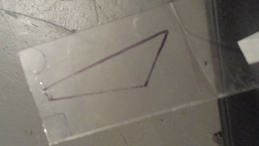

Step 7 - Create tinted visors using plexiglass and car tint.

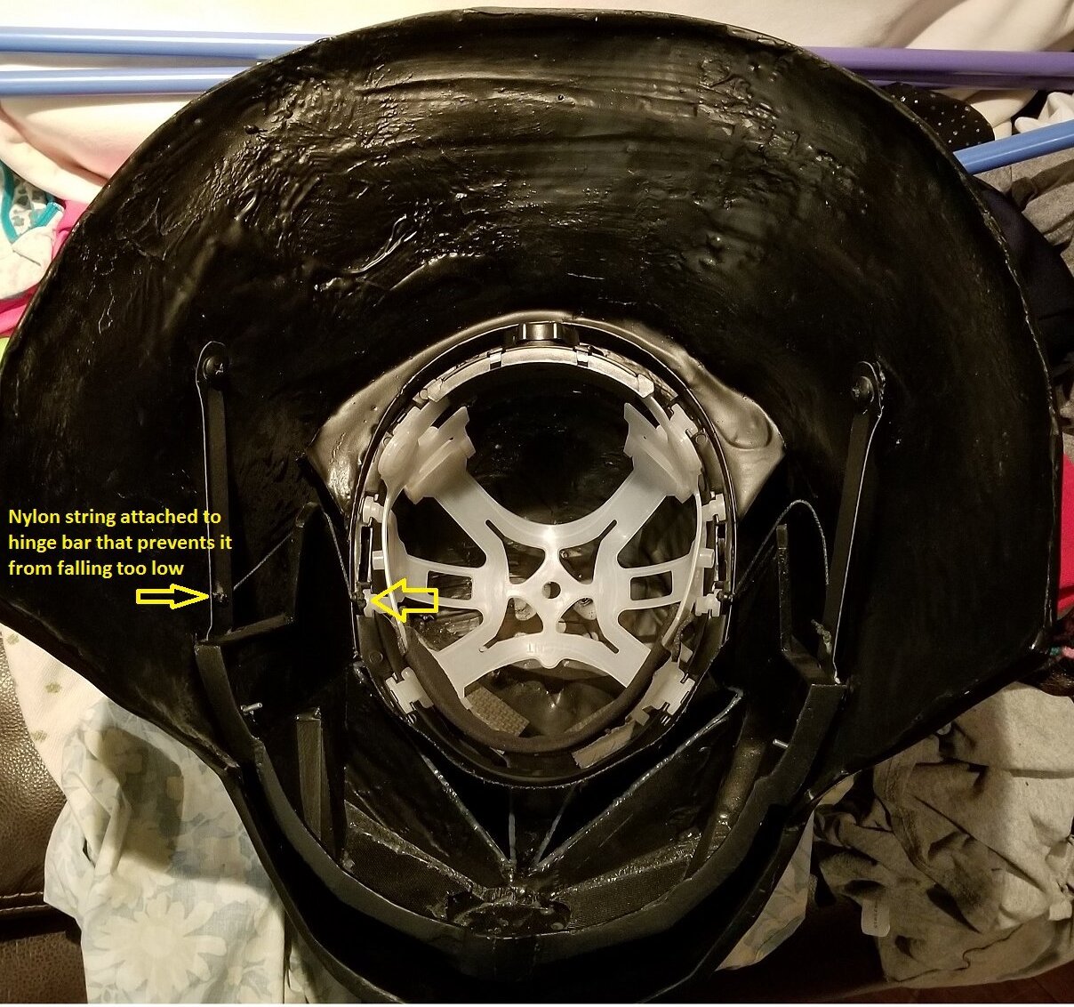

This has changed a bit with the new setup but the idea is still the same.

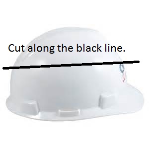

Step 1, cut the construction helmet along the black line:

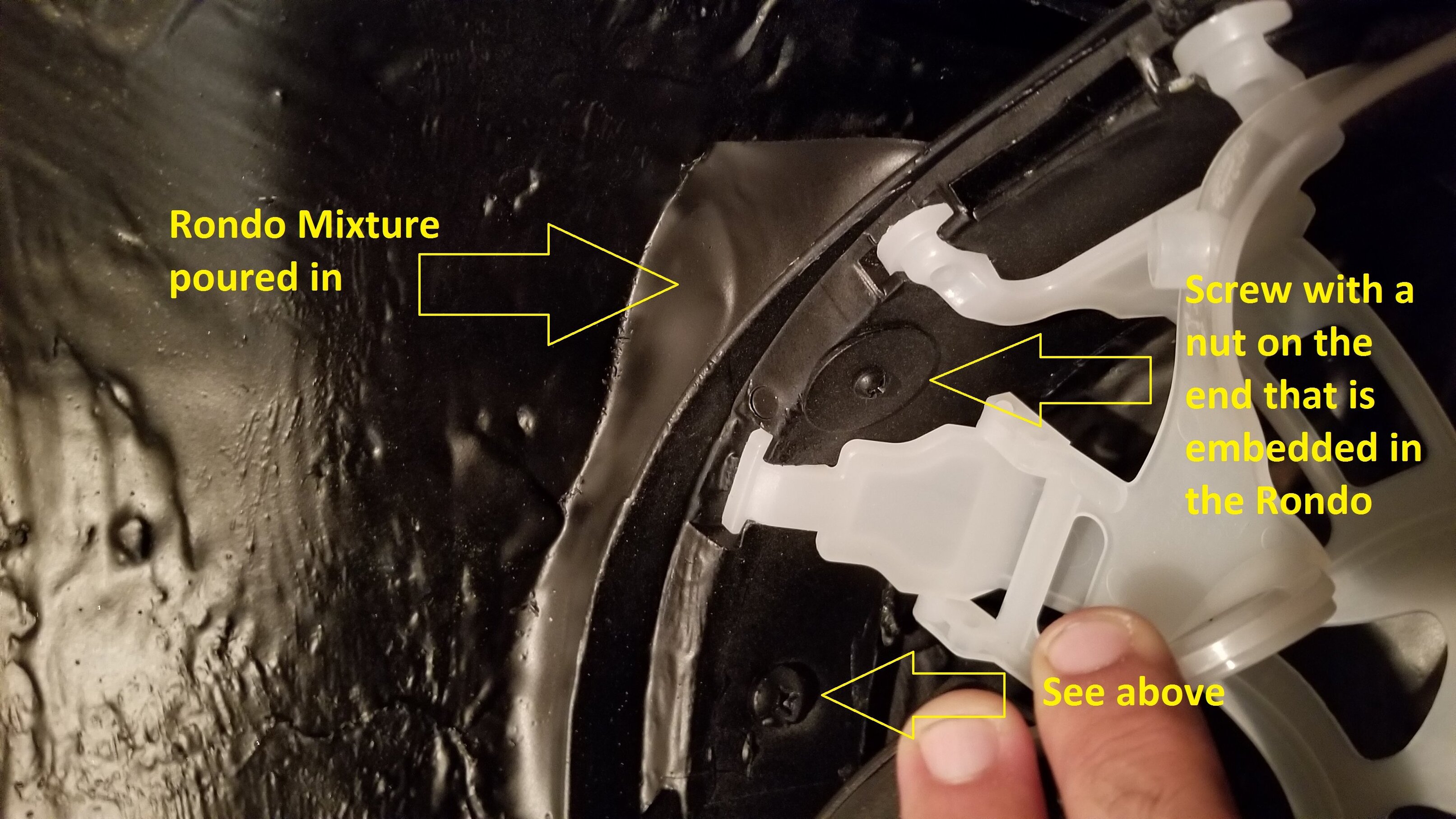

Step 2: attach the back of the construction helmet to the back of the Dark helmet using any means you like. My first one was casting a nut inside of rondo and using a screw with a fender washer from the back of the construction helmet into the nut.
Below are pictures of the original:

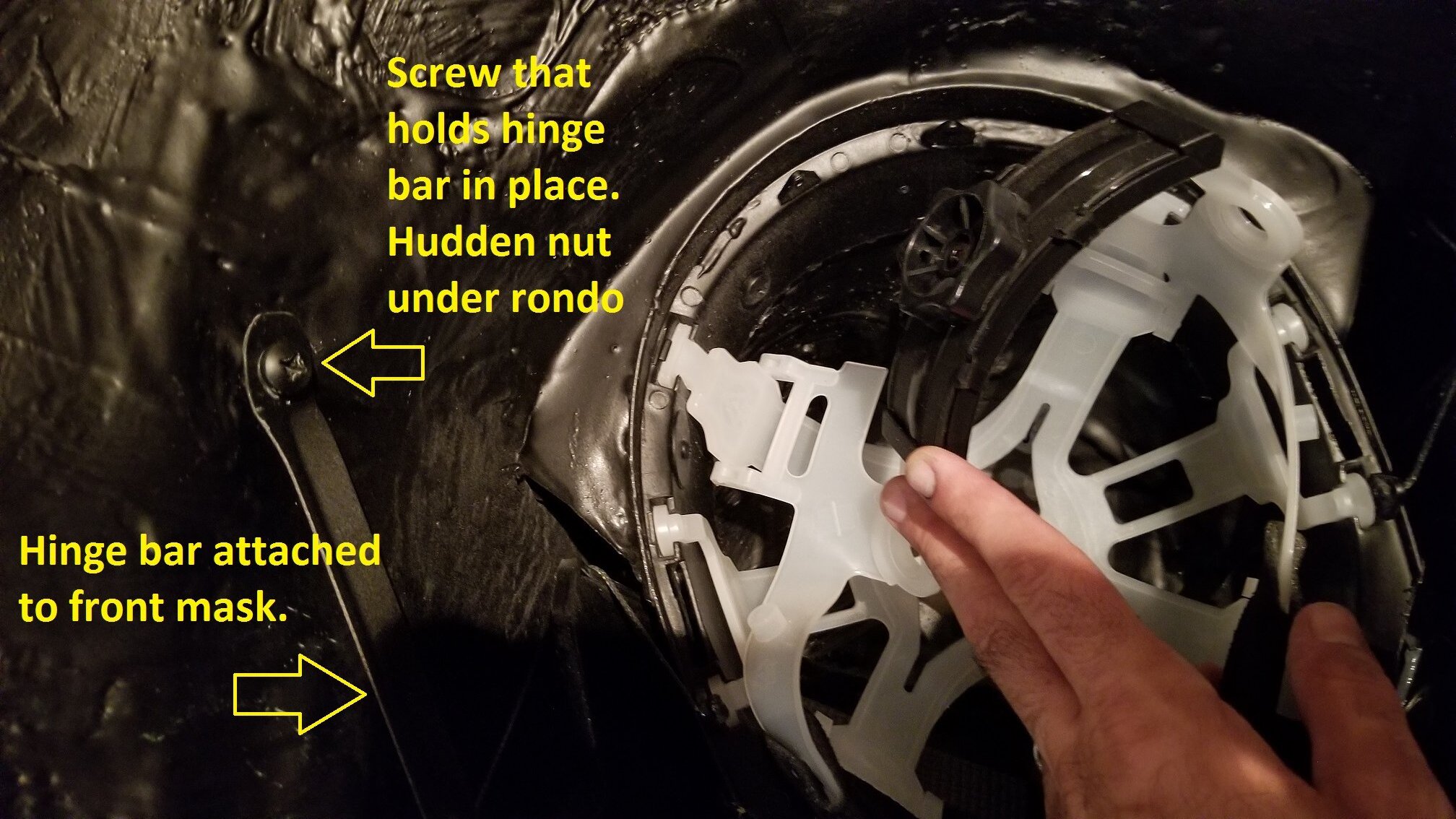

Step 3: Attach a hinge for the front mask to get attached to. The hinges on the side of the helmet are just T-nuts glued to the inside. The metal brackets are Simpson Strong Tie Tension Bridge cut up and drilled as I needed them. These simpson straps run to the face plate through the 2 slots on either side and secured with a screw.
Step 4, attach a string from the hinge (close to the helmet) to the construction helmet on both sides. This will prevent the helmet from fully swinging forward and down.
Can this proceedure be perfected? Sure, but this was my proceedure even on my second helmet with the 3D printing.

The Hinges I used were custom made. These were the parts I used:
1) 8/32 t-nut (m4 if using metric)
2) 8/32 screws (cut to length)
3) 8/32 Nuts with nylon
4) Nylon String
5) Simpson Tension Bridging tie (Hammered Flat)
6) Foam Pad
7) Red Thread locker
The Foam at the top is to provide friction for the helmet to stay up when pushed in the up position.
The red thread locker is so the screw does not come out of the T-nut glued to the helmet. Use an epoxy to glue the T-nut.
The String prevents the helmet from falling down too far.
The tension bridge on the inside of the face mask prevents the helmet from tipping forward too much
Since the hard hat is cut, this allows the face mast to glide up above your head. The majority of the weight is being held by the back of the helmet where it attaches to the hard hat band.
