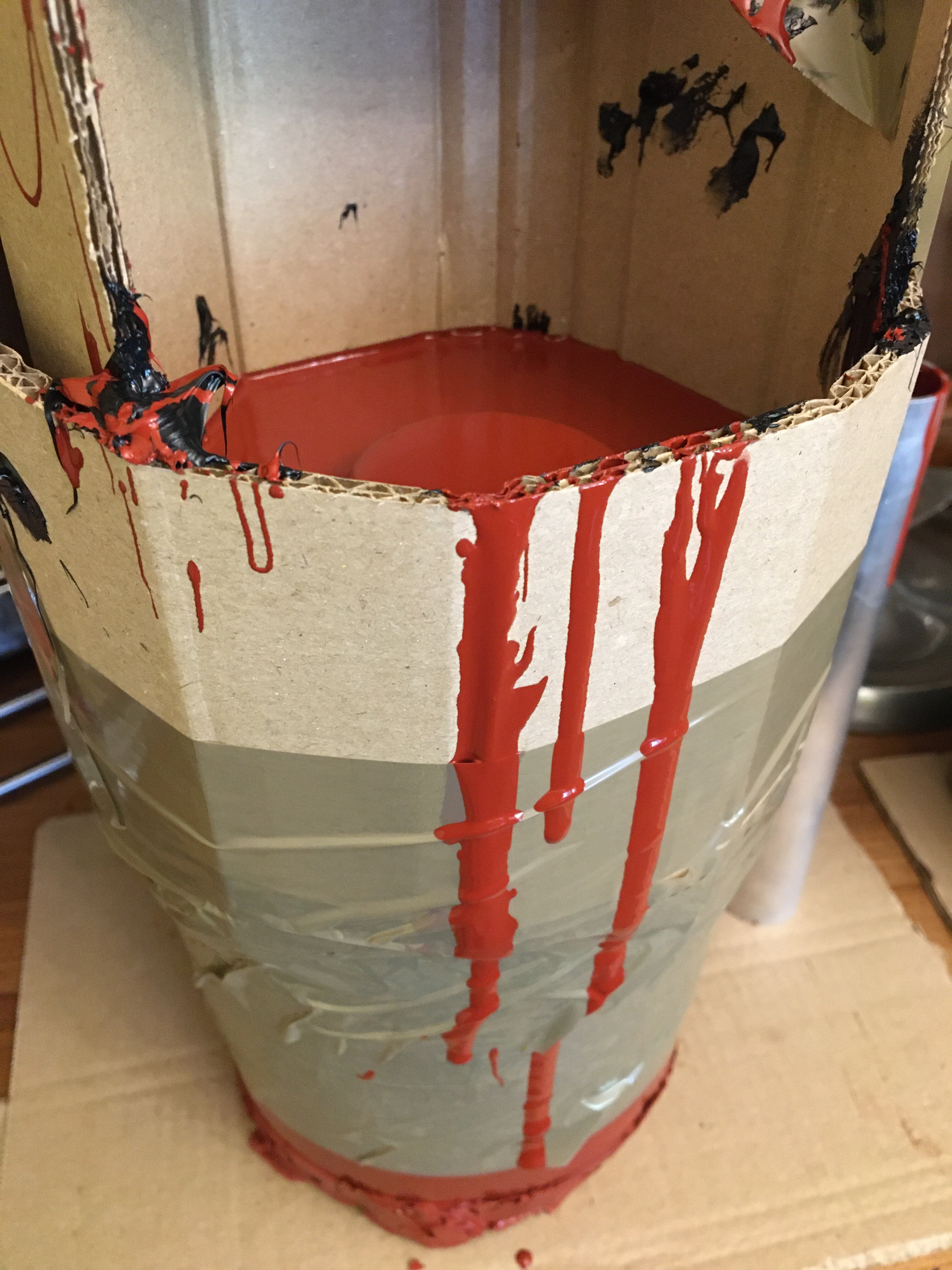

Being able to cast metal straight into a flexible silicone mould is a super nice easy cheap and quick way to do it, so the extra cost of the metal saves you a lot. Yes aluminium is cheaper, often free, as you can melt scrap. But you need to work at a higher temperature so need to use different methods such as sand casting or investment casting but the equipment and materials for that cost more, it takes longer and it's harder to make the patterns which often need breaking down into many small pieces and then welding together after casting.

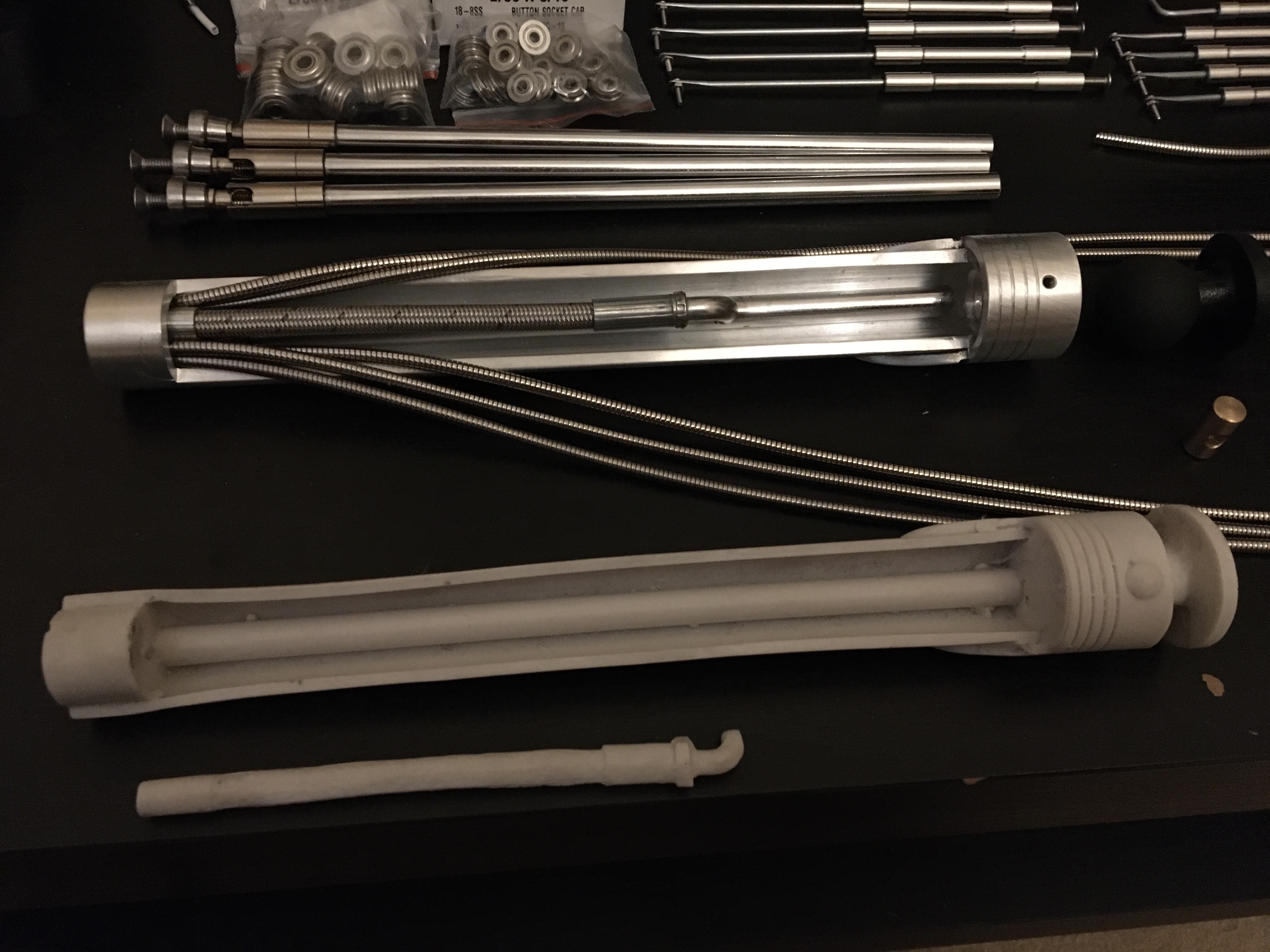

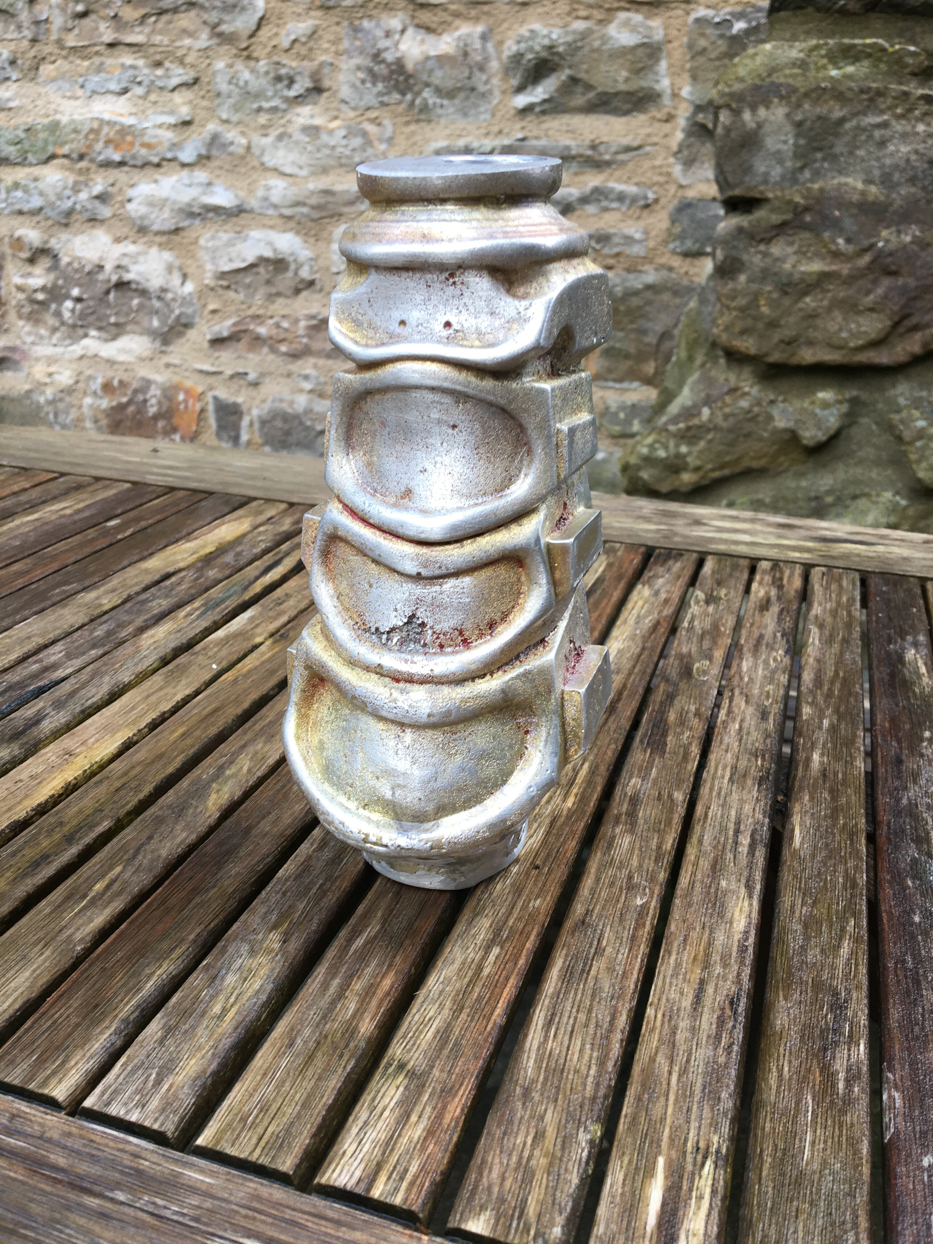

I'm currently experimenting with 'lost PLA' casting. It seems very attractive to be able to go from a 3D print to a real metal part, but to get good results is difficult. You need a kiln that can heat at a controlled rate to over 700°C, a vacuum casting setup to pull the metal into the mould, and even the investment casting plaster is expensive stuff. I've seen people use plaster of paris mixed with sand, but it's prone to failure and doesn't work for complex shapes or intricate detail.
