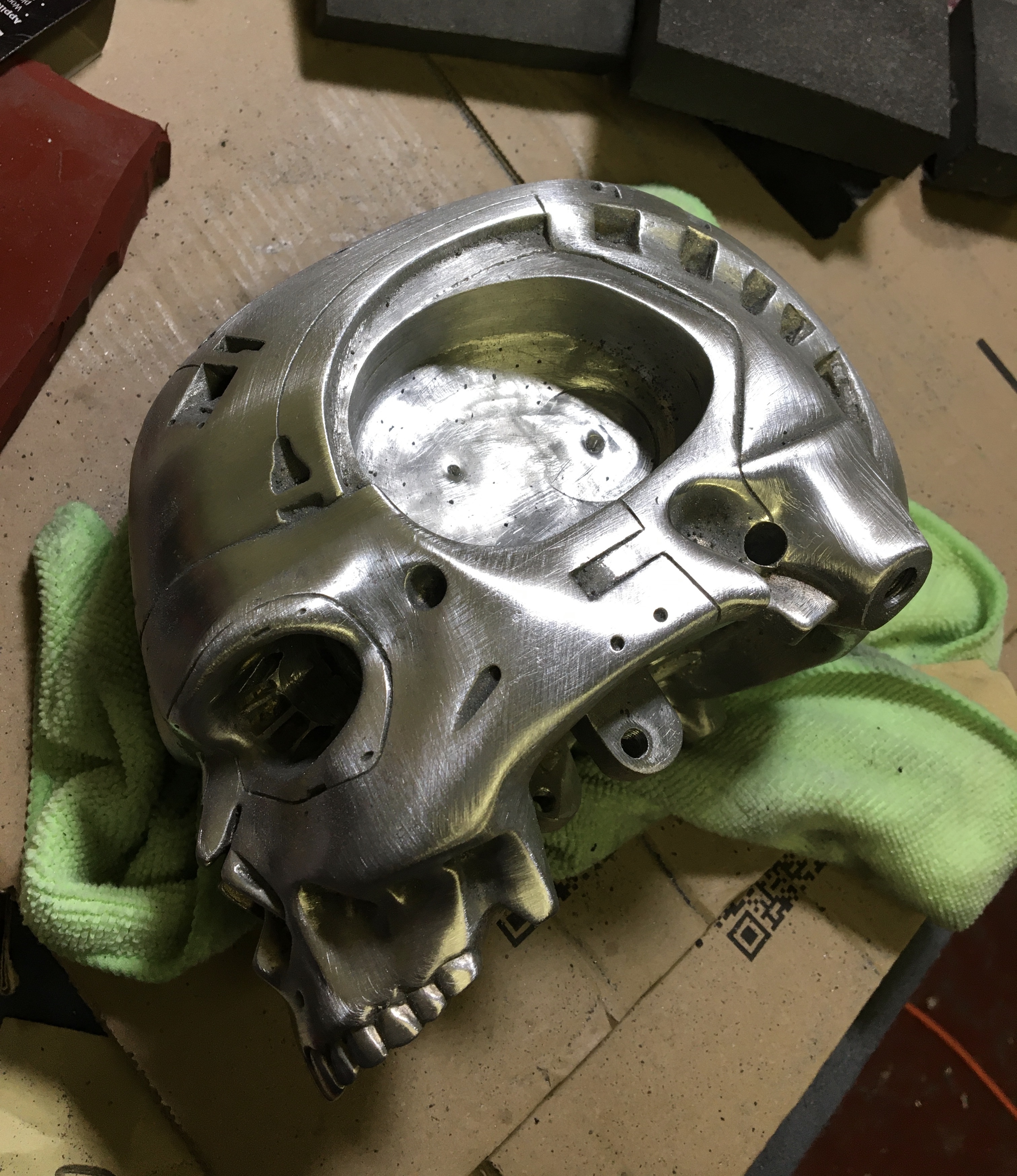

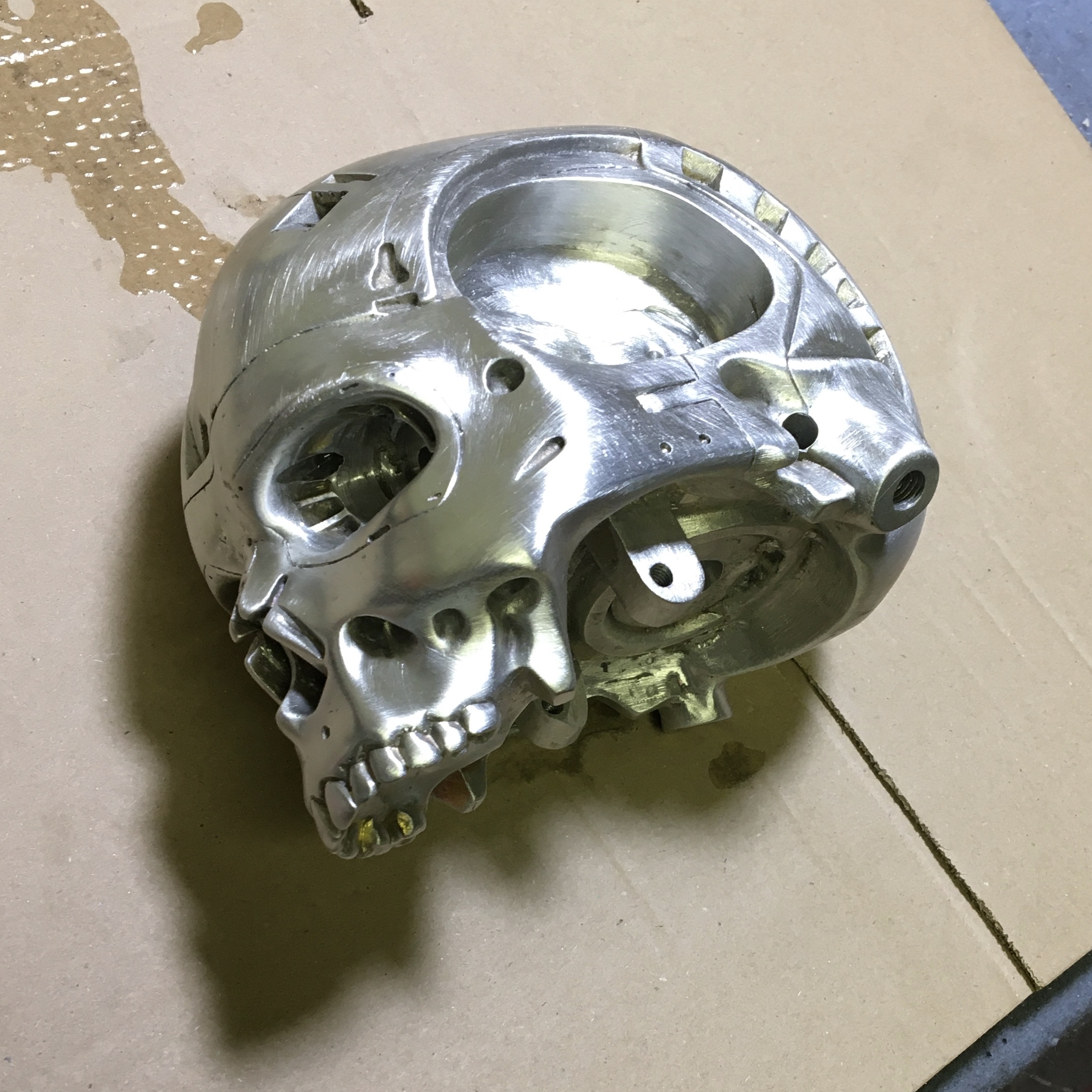

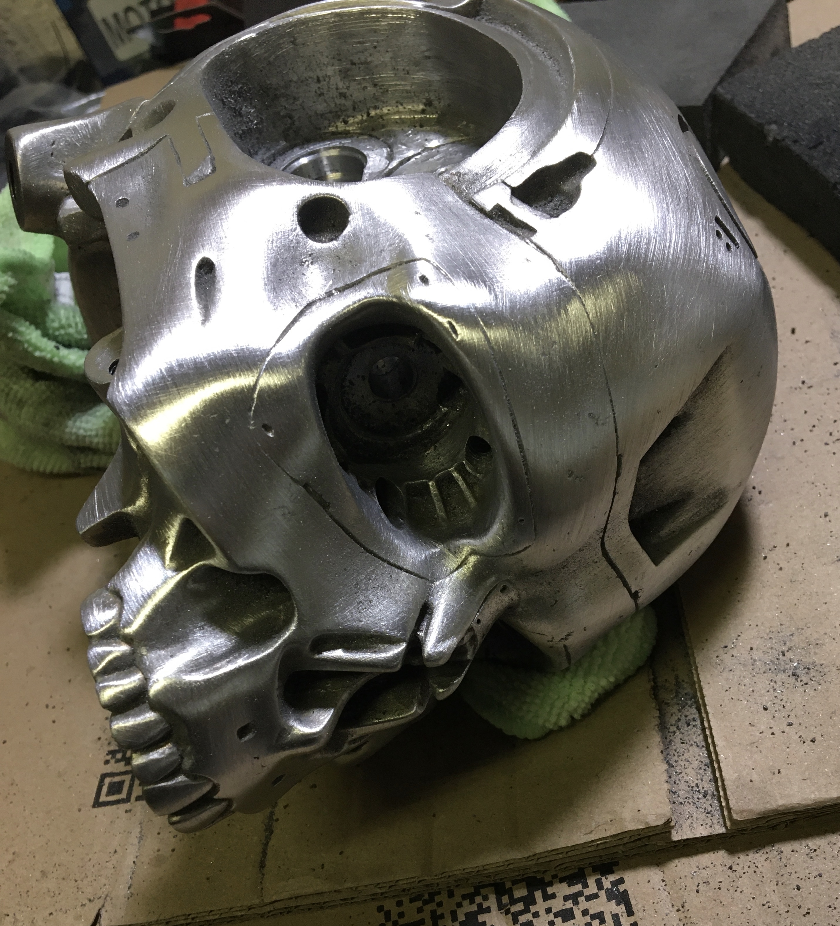

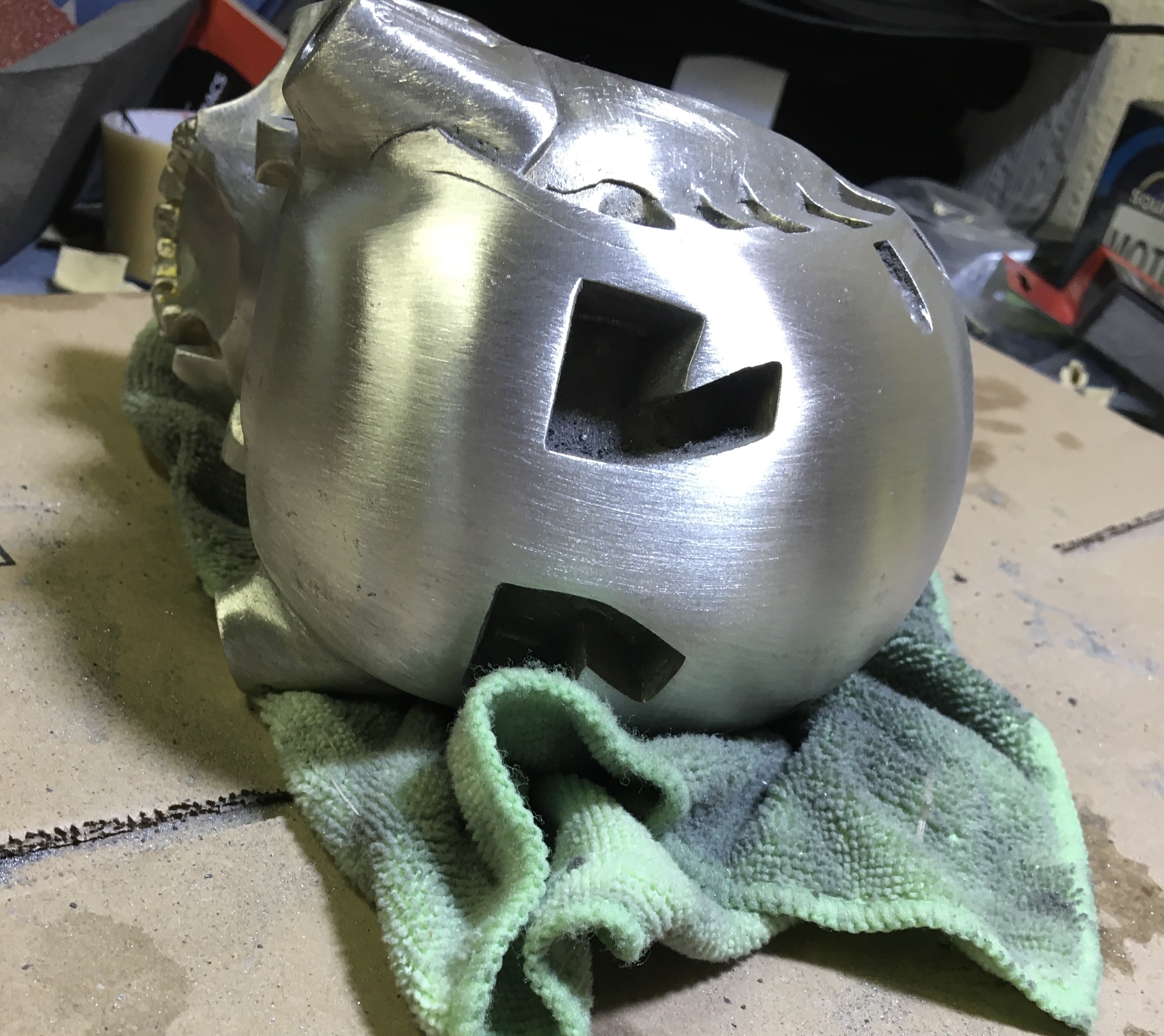

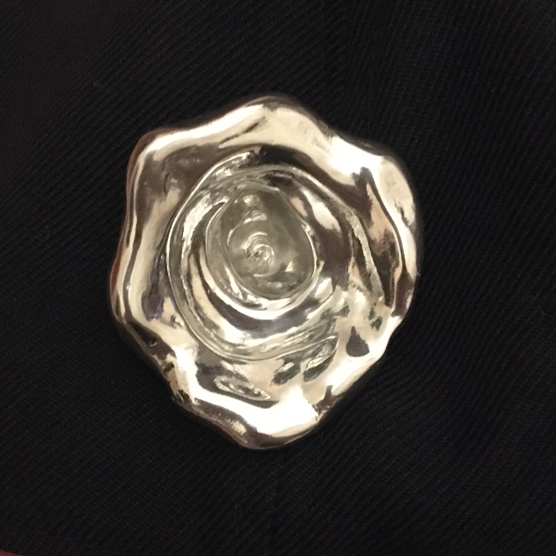

I have been busy sanding the skull to remove any pitting marks or deep scratches in the metal. Now it is ready for its final polish. I want to get as close to a chrome finish as possible. Pewter comes up nicely with a decent polish, as can be seen with my test polish on a pewter T-1000 bullet hit I cast.

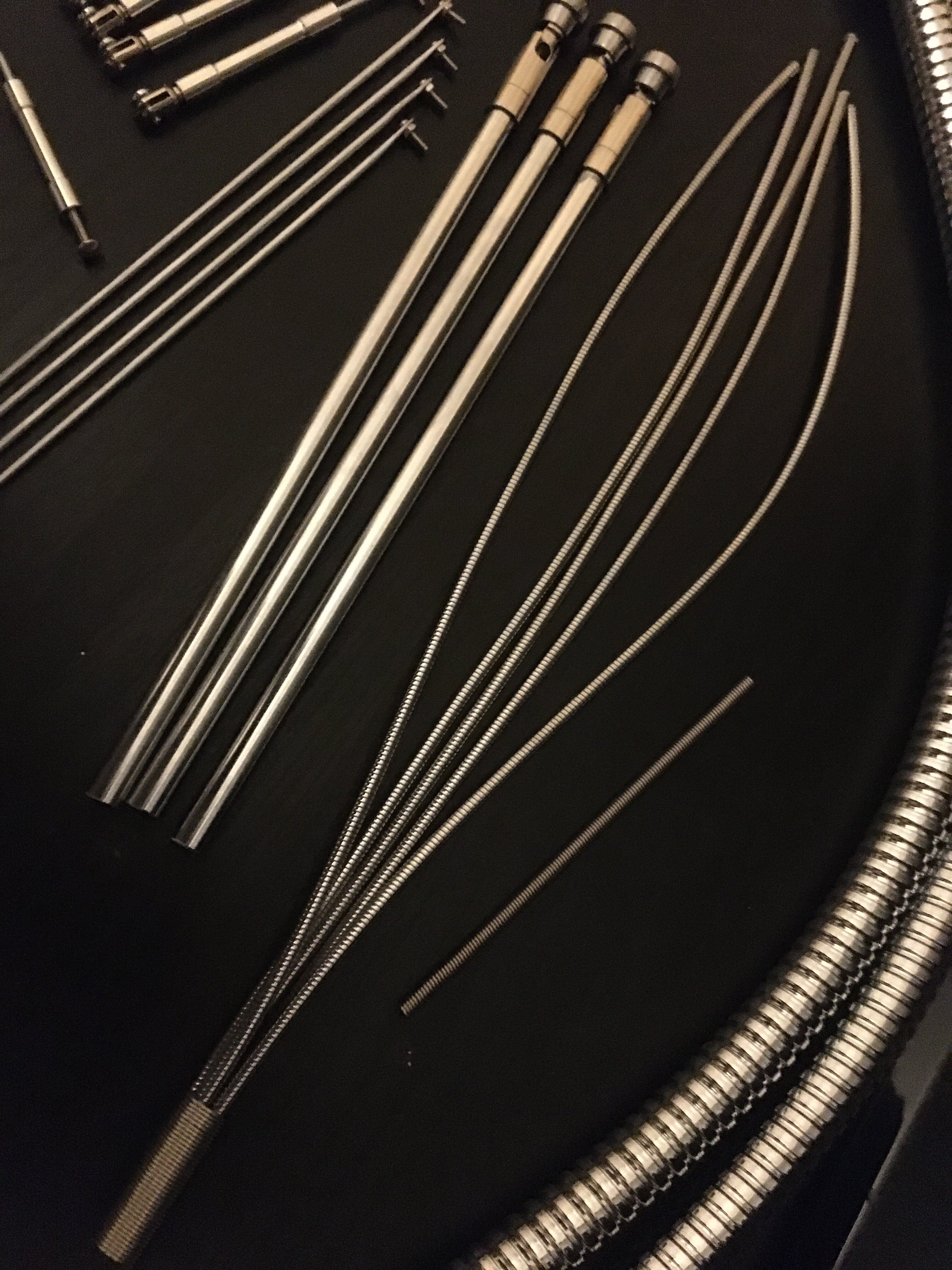

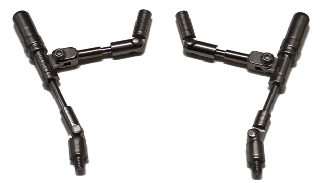

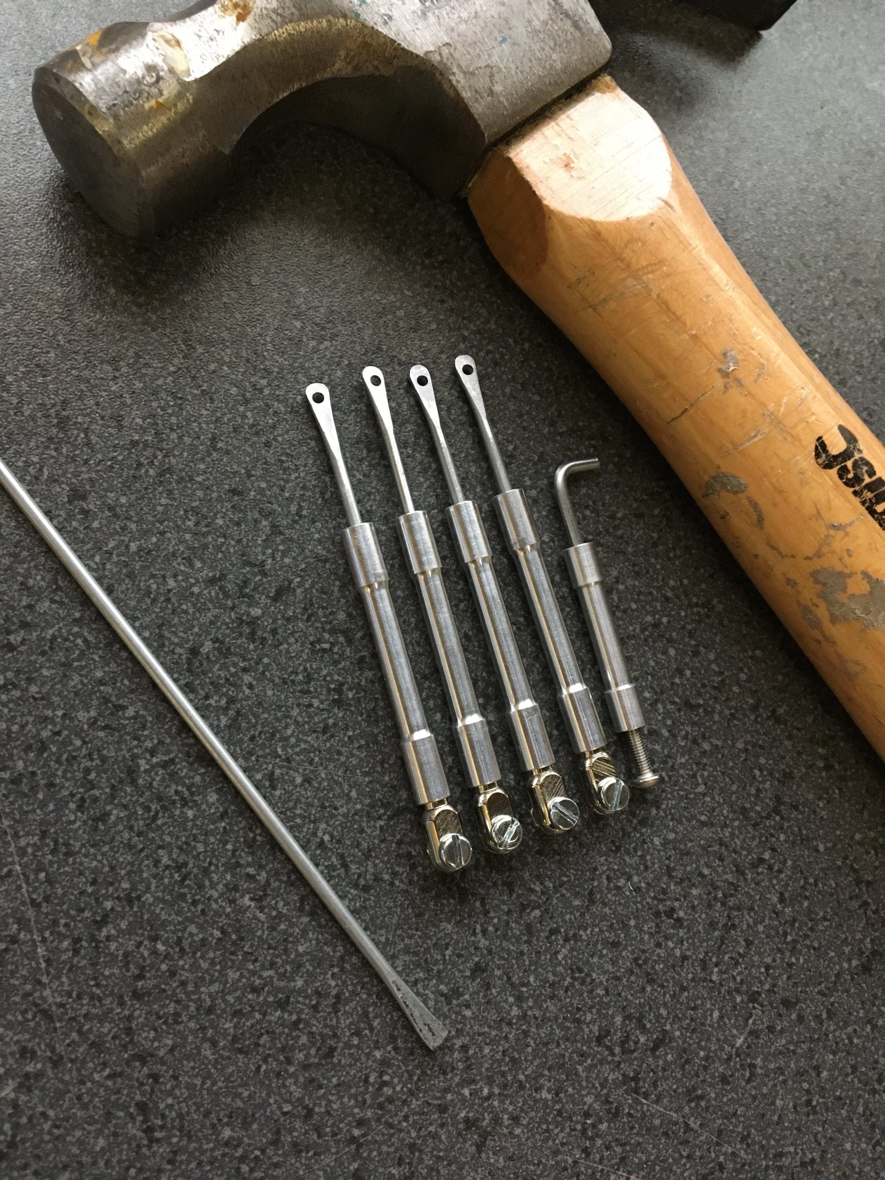

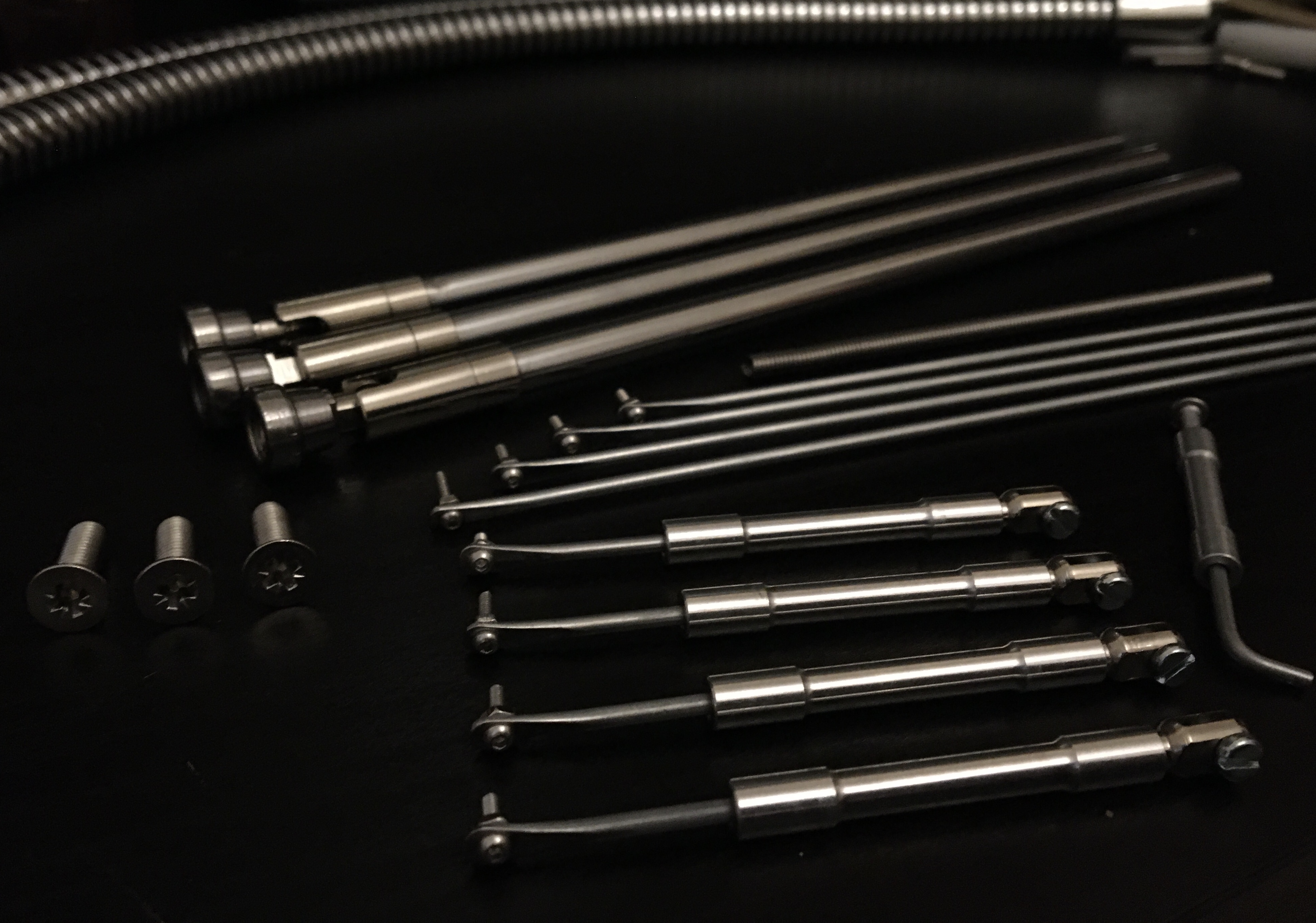

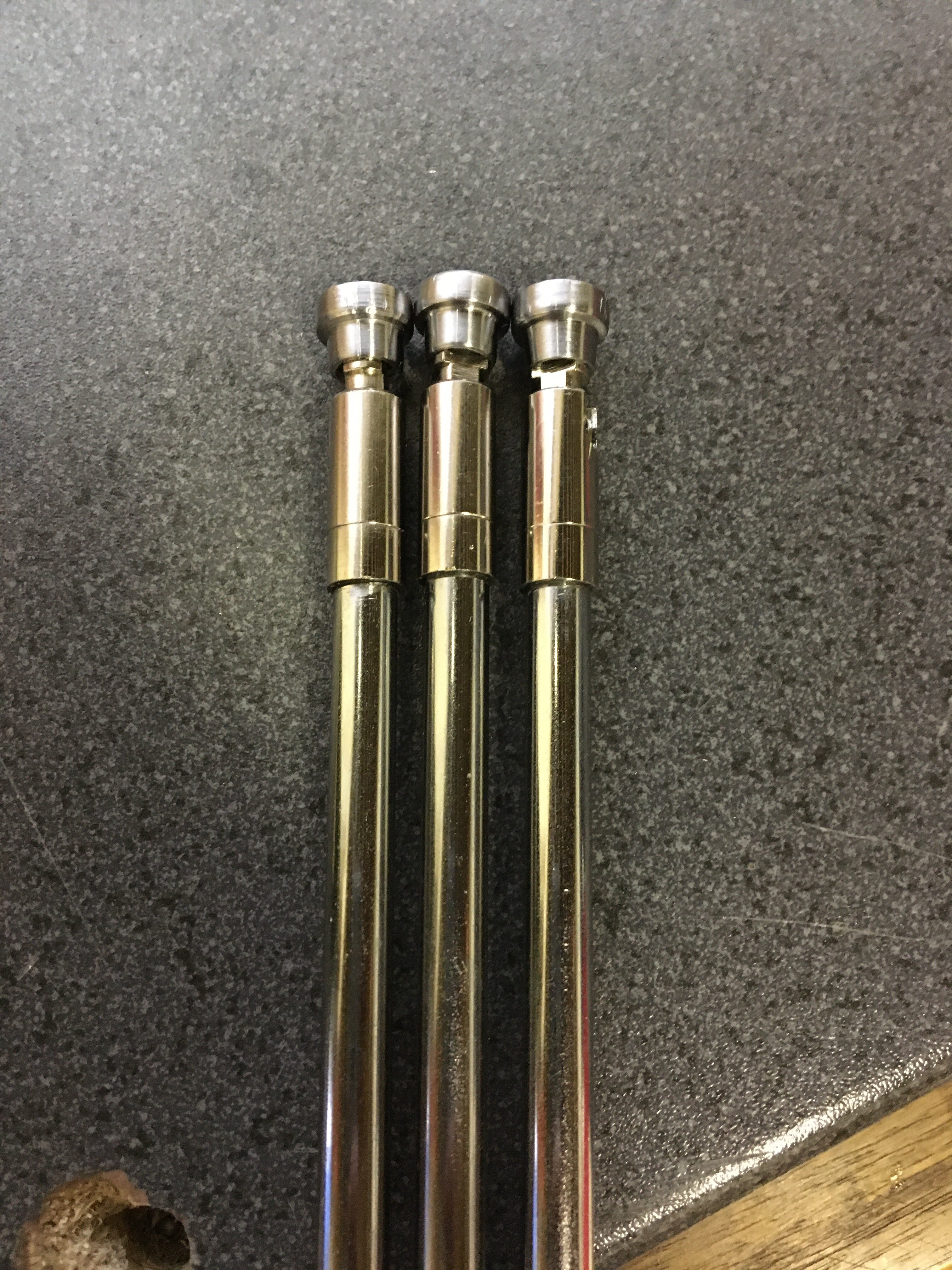

I'm building one too, from metal, but I'm taking a different approach, not casting from moulds, more free-hand. It means mine is not as screen accurate as yours. I made my own jaw pistons by turning and milling them from stainless steel:
I also used some rods from an old CDrom drive, they seem to be just the right size. I think the piston assembly is probably the most accurate part of my build.
Cool, yeah I see your build on YouTube. Impressive . Keep up the good work. I wish I I had a lathe and proper tools.

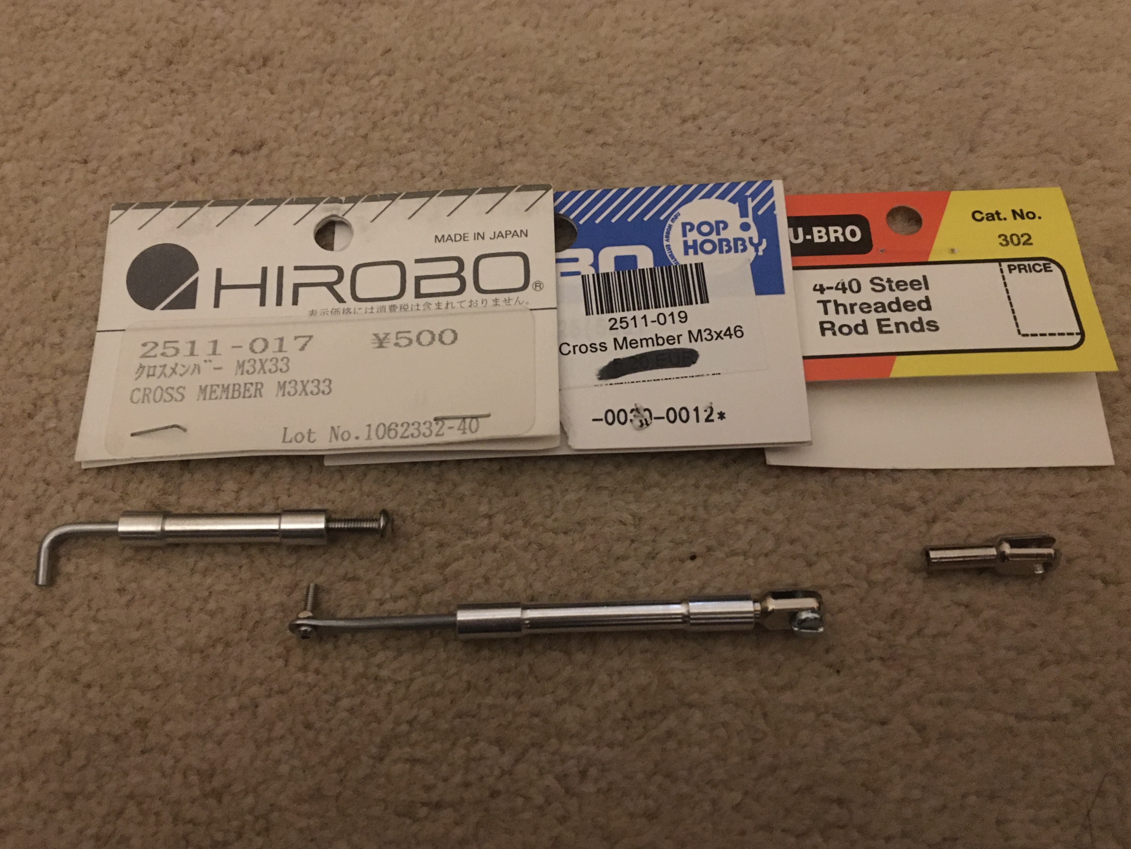

Yeah they are nice and accurate, Good job. Piston part is lovely. Nice machining! The only thing maybe is to use the du-bro piece, it is screen matched for the part that joins to the piston. You can get them on eBay easily.
Luckily I literally got my hands on some screen accurate pistons yesterday, just need to do some work and the part that was bugging me will be spot on now. Will post some updated of the finished 100% accurate ones when done.
