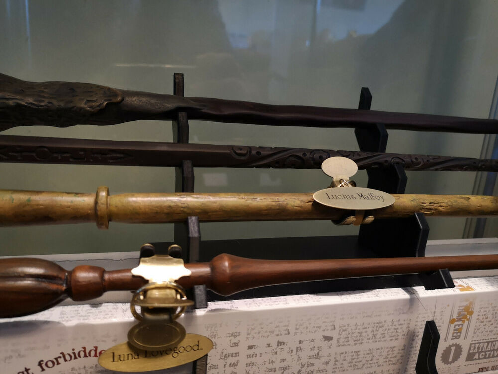

Though, here are a couple photos I drew inspiration from:

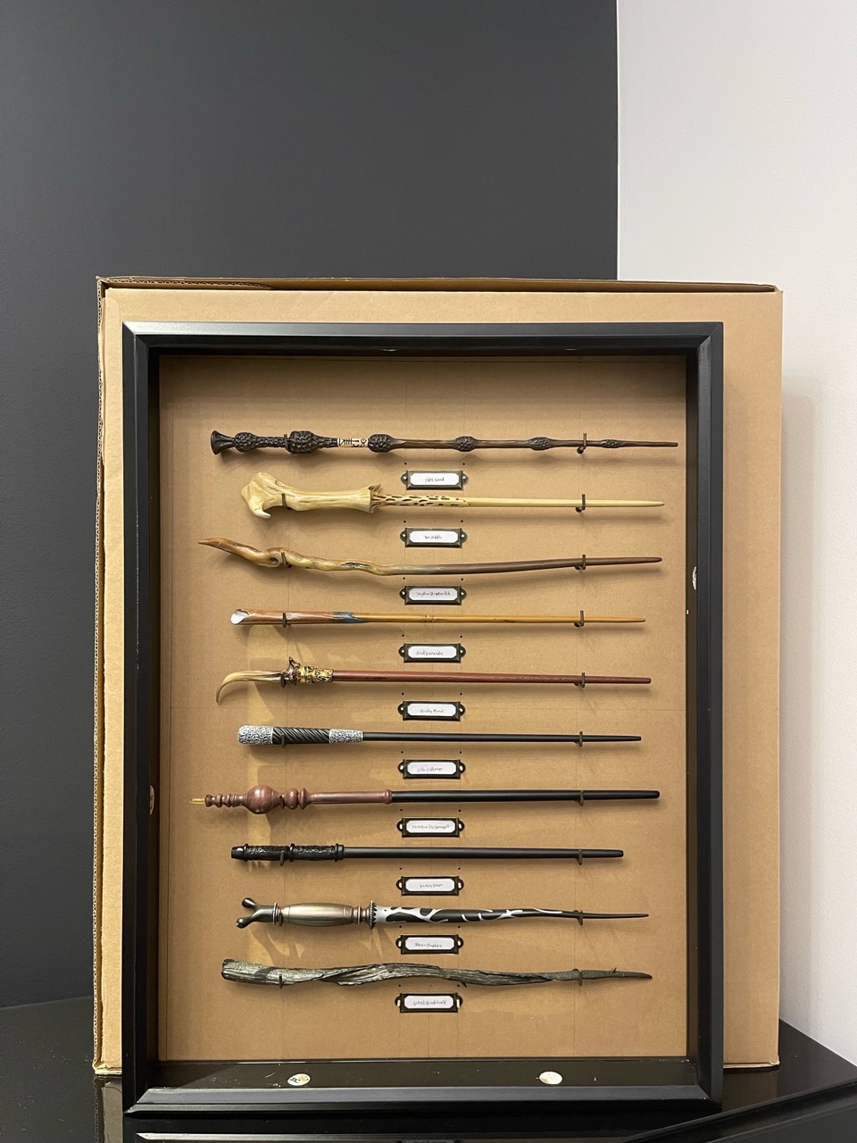

Then I took apart the shadowbox to remove the front glass - I wanted the wands to be accessible.
I had a cardboard box lying around and used it to test out the wand spacing.
This is what I ended up with for an 18” x 24” canvas:
  • L hooks spaced 10” from each other, centered
  • First pair of hooks are 3” from the top and each pair of subsequent hooks are spaced 2” apart from each other vertically. This also leaves 3” at the bottom which works nicely to even things out. This spacing allows for 10 wands to be displayed. Anything more or less for this frame size looked worse.
  • The label pulls are also centered and evenly spaced between each L hook row.

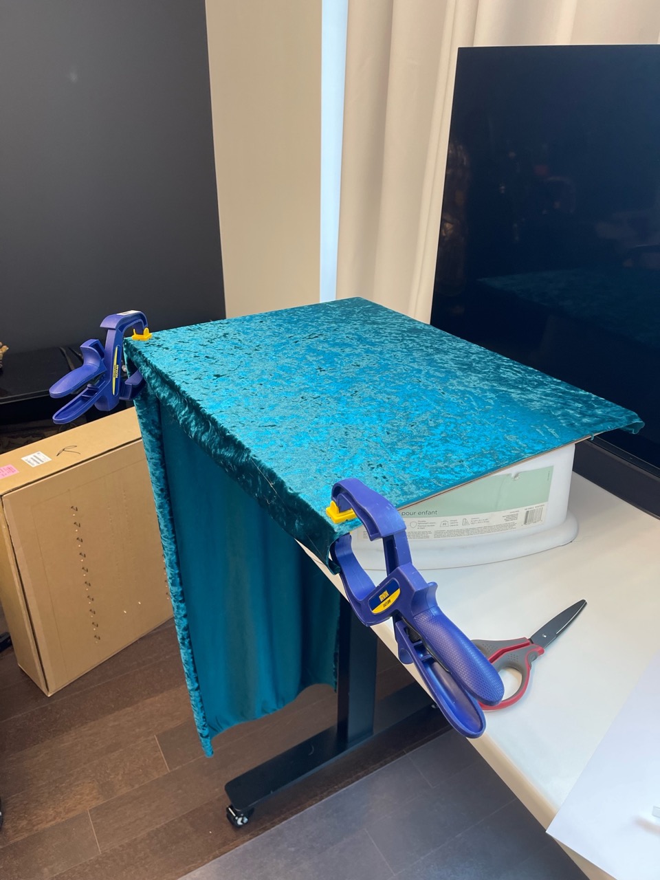

I then used hot glue to adhere the fabric to the back panel - a couple of small dabs in the corners and along the edges. Minimal use of glue here is important. I did not add any glue to the middle of the fabric. Excessive use of glue will distort the fabric and leave visible markings. I experimented with small swatches of the blue velvet and this was the best and simplest method I found.
