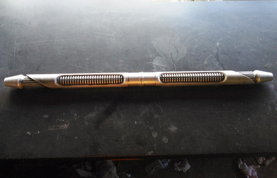

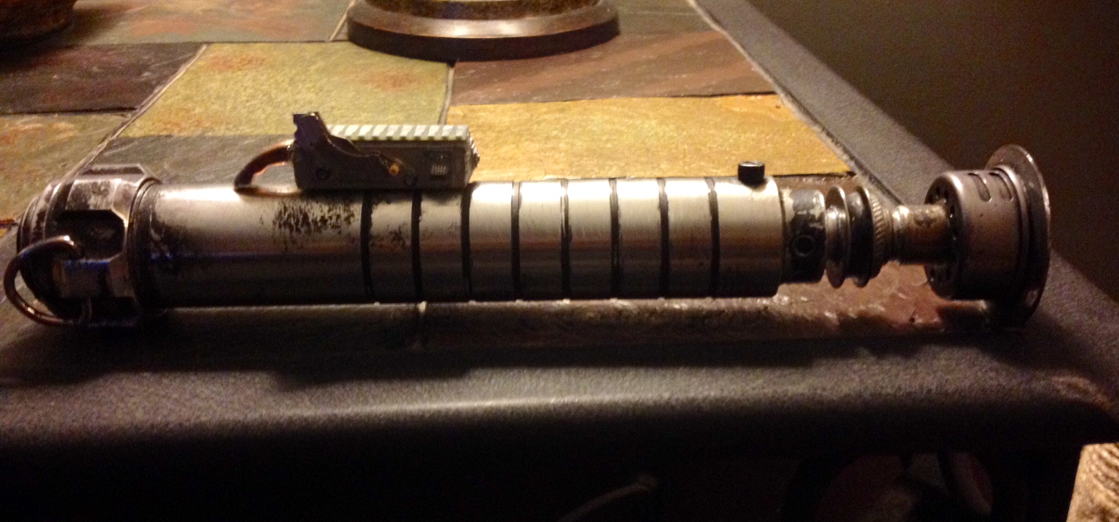

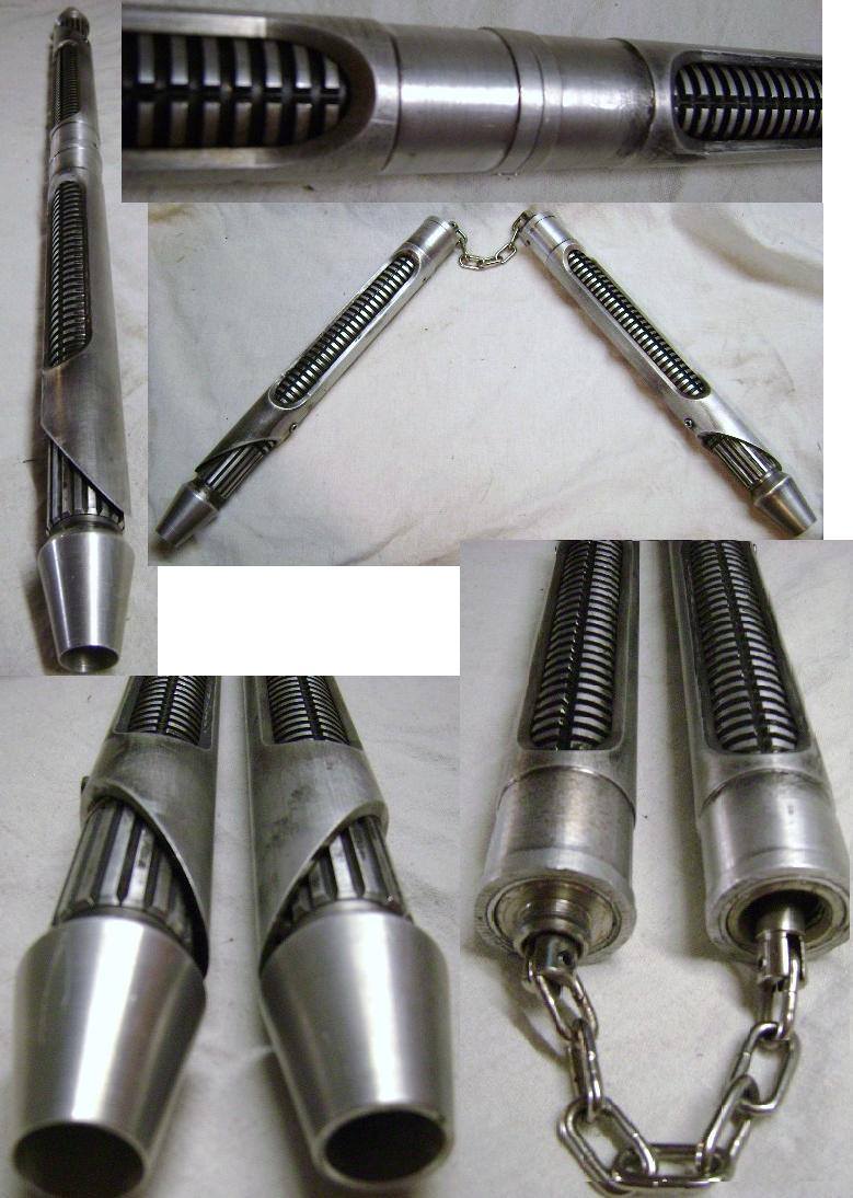

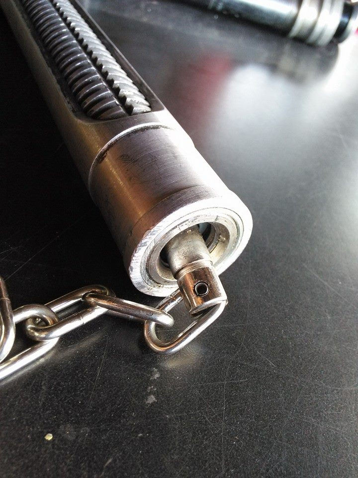

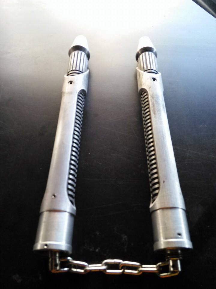

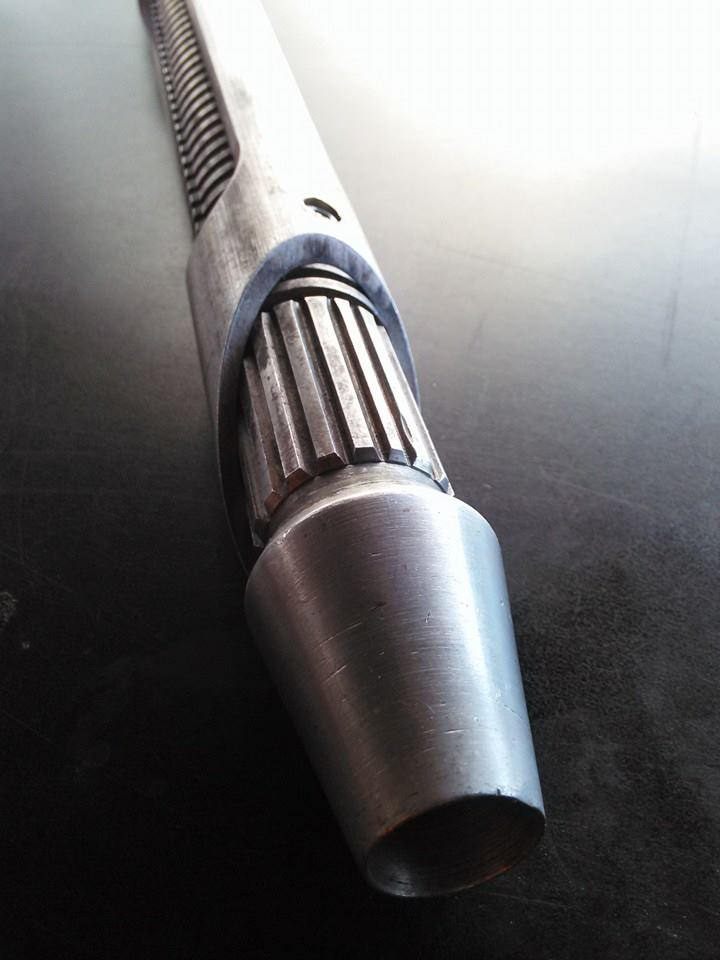

My custom fabricated Lightsaber Nunchuks, made from 5051 aluminum round and pipe, took over 2 years designing, re-designing of various designs and styles, this is final look, this is also a double bladed saber that comes apart as a nunchuck typer saber weapon. This was made this for a Fan film for the main villain.
still a work in progress, working on putting Sith type runes and tribal patterns engraved into the hilt.

Man I remember those. I always loved your saber chucks. I remember several years ago asking you on the theforce.net Fan Films forum, how you weathered those. You were kind enough to teach me your weathering method so thank you very much. I wish your fan film could have been completed. It looked like it would have been epic.

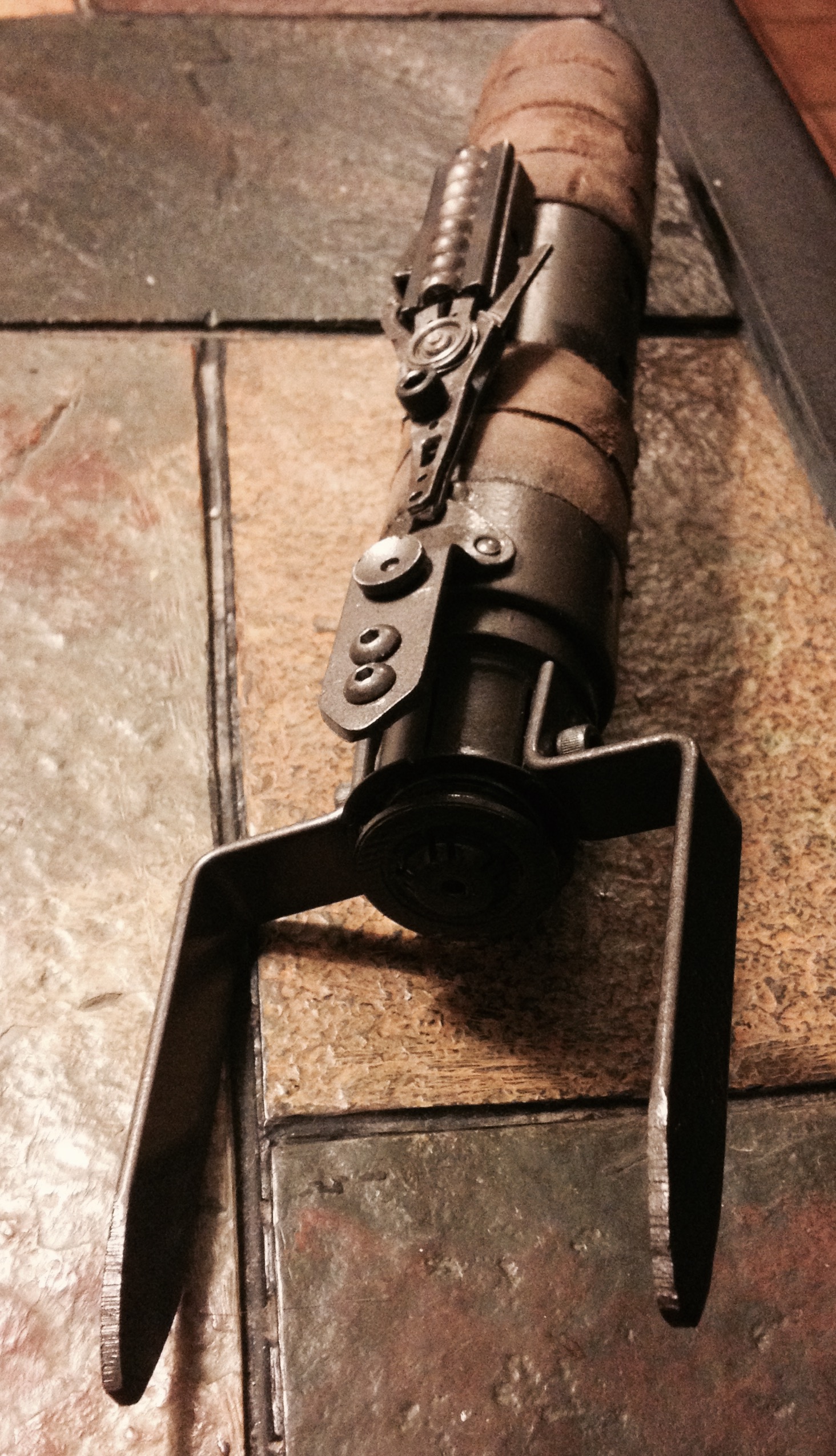

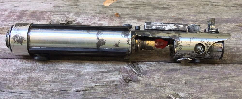

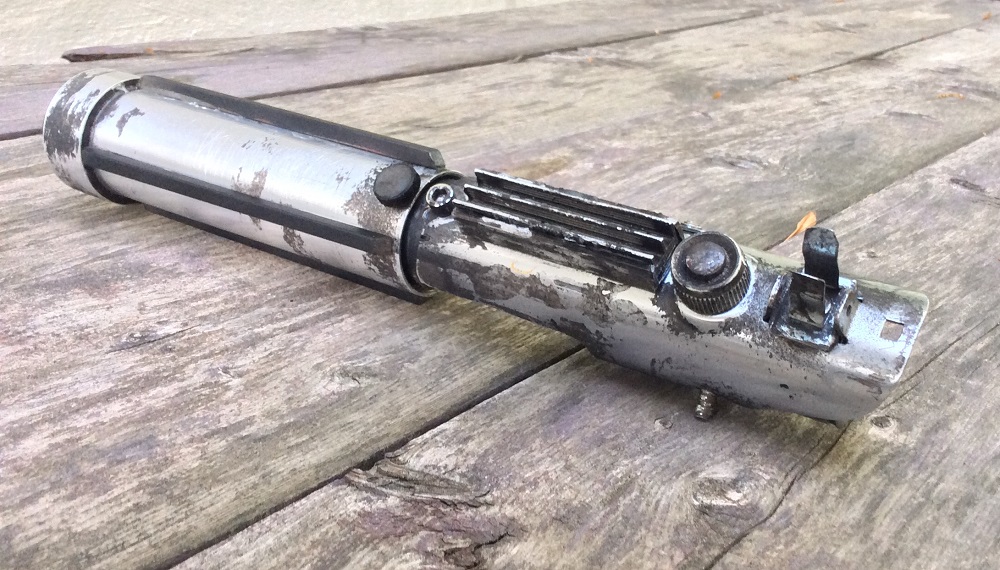

Riddick Type Saber Claws Lightsaber hilts

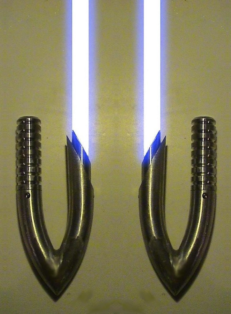

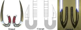

These took awhile to design, the outcome was more wicked than the original concept, fabrication took some time and it changes were for the better. Also made for fan film used by one of the jedi knights,View attachment 480912View attachment 480913
conceptView attachment 480914

Oh man, this is awesome! These bad boys are the one reason I got into making custom sabres in a big way. Never thought I'd have a chance to thank their creator for inspiring me to get started on my own sabre smithing adventures :D
That's some serious skills you have there dude and a high benchmark for me to reach in terms of fabrication skills, giving it my best shot though ;)

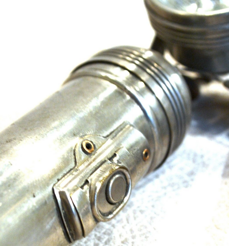

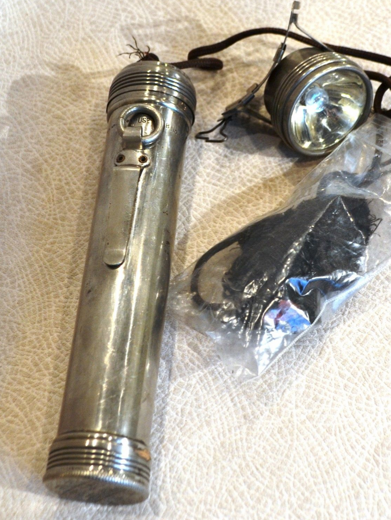

Just picked up this old Winchester headlamp from the 20's because it instantly screamed "lightsaber" to me. I love the button on the front, and it looks nicely aged and machined, being a quality Winchester product. I'll post progress once I start tinkering with it.
Screen Shot 2015-05-28 at 4.08.06 PM.pngScreen Shot 2015-05-28 at 4.08.17 PM.png
Awesome find! You're right, it does look....forged in a galaxy far far away. I especially like the look of that button

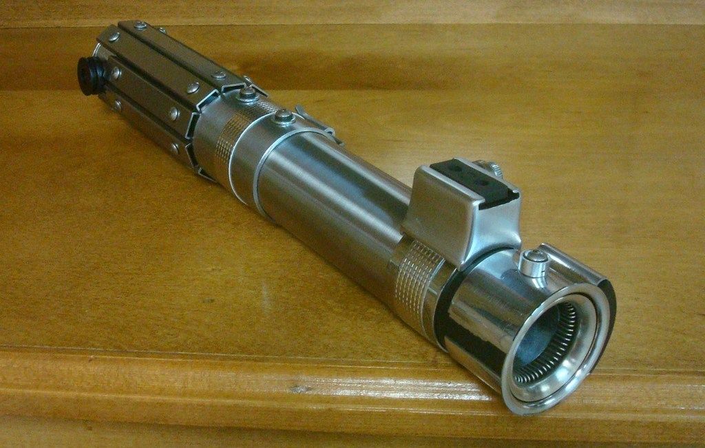

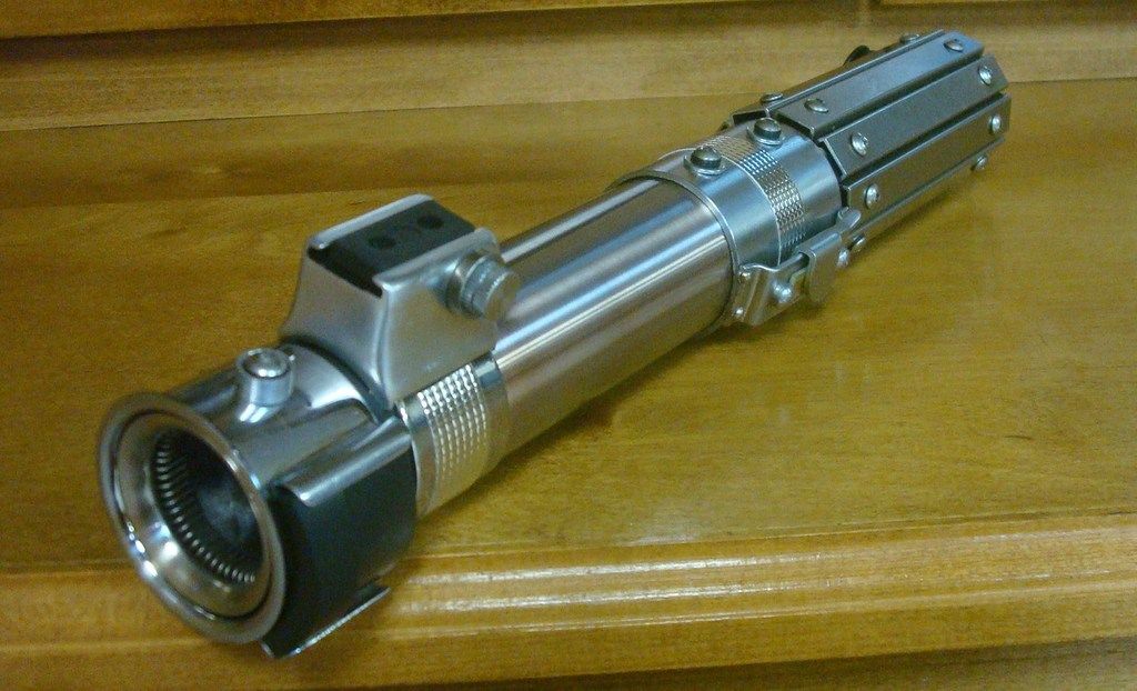

I gotta say the 2nd Star Wars teaser trailer is what inspired me the most. I know the RPF currently has Graflex fever, but I've already been there/done that/got 'em on display, so I came up with an idea to do something else.
I've always liked the look of Jeff Park's Mara Jade Lightsaber, so I decided to make a "hardware store version" that would at least have some similar features, like the grips and the control box near the emitter.
15+ years of prop collecting/building will create a good stash of greeblies, so that made everything come together quick. The center clamp is from a Peak 3 cell flash and the two clamps up front are from a Heiland Sol and a Syncronar. The emitter is from a Heiland, too, a leftover part from my recent Fett ESB Rifle project.
The textured chrome tape and some of the button head allen screws are leftovers from the Yodashouse/Blast-Tech days.
No special machine work. I didn't even cut the sink tube down to a shorter length and left it at 12 inches. The saber looks like a "Brute" when placed next to my converted 3 cell flashes.
I did take a scuffing pad to the sink tube, knocking down the bright chrome plating and making it look somewhat machined. Same treatment for the endcap, too.
The grips are made out of u-shaped strips of stainless steel. They were already cut to the length you see. I still have some more of this "grip material" in different lengths leftover for future projects. It wasn't very fun fun drilling the holes in them, though. There was a lot of cutting oil applied and dipping them in water to cool them down.
The tall Heiland clamp was stripped of it's black crinkle paint and wet sanded/wire wheeled to make it look machined/polished. The silver knob on the side of it is a vintage reflector knob, probably from a Graflex reflector. It was even the correct thread size for the existing hole, so no need to tap it.
I did have to drill and tap 25 holes for the grips, clamps and Covertec knob. I like to build props as sturdy as possible, and that's one of the best things about building customs...you can always build it the way you want it.

Very cool.
Has that Jade look to it.
What did you use for the emitter? Looks like a bulb socket.
