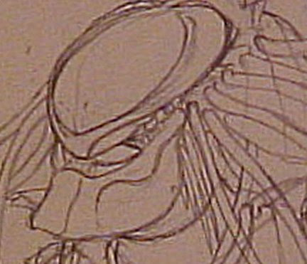

The drawing that inspired this was done by Rob and is blend of a P1 and P2 Bio. The thing that captured me was how the dome is pronounced and curves inward as it goes down and meets with the nose/eyes. This angle makes it difficult for me to determine how much that area curves in, but I'll do my best to interpret a 2D drawing into 3D.

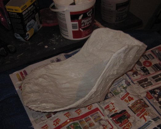

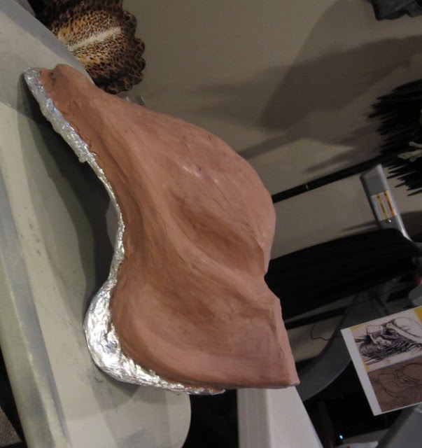

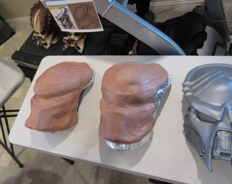

Starting off with the armature. Nothing special, just a wire frame with a bunch of burlap and plaster on it.

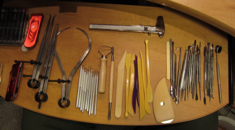

I've been buying tools here and there over the past year to get ready:
I don't have any rakes, so I used my dremel to cut teeth into one side of the sculpting tool:

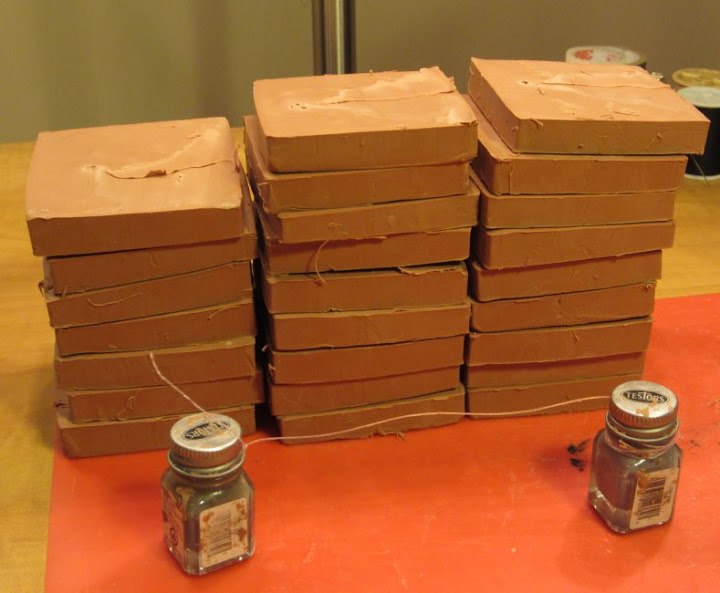

I'm using Chavant medium and soft. I wish I had gotten all soft clay, but oh well. To cut the clay, I used fishing line attached to some Testors paints, which worked perfectly:

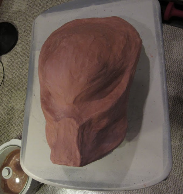

The one on the left was done today after about 3 hours of melting chunks of clay in a crock pot:

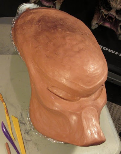

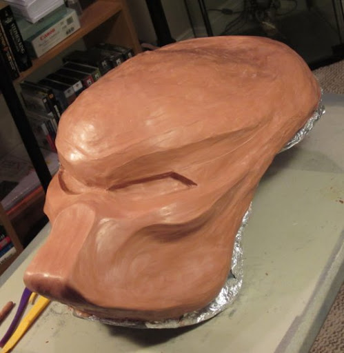

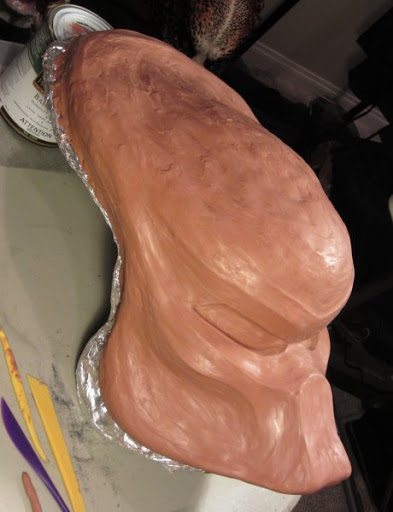

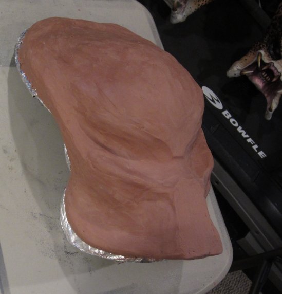

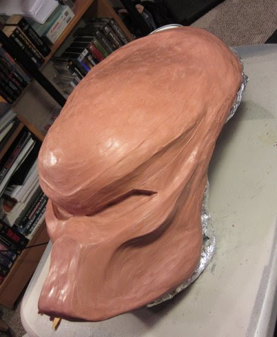

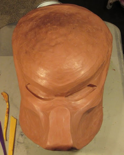

Here's where I'm at currently:

I like the armatures. I may have to try that sometime. What gauge of wire is it?

Not sure what wire gauge it is, but it's stiff enough that I needed pliers to bend them.
With Robs drawings being a major influence for me, it's only logical that I try to sculpt one of his designs.
This is really taking shape! Gotta love that P2 influence in Rob's drawing. You're gonna knock it out of the park!
Just a clarification - I've used two tools so far. One to cut into the cheeks and the other to cut the jawline down and put holes where the eyes are. The rest if just from pushing the clay around with my fingers. I've been told there are two kinds of sculptors: those who build up and add clay to the sculpt using their fingers, and those who use tools to cut and dig away at the clay. I think I'm going to be one of those people who uses their hands. I can get precise lines that way.
I used the calipers to make sure the eyes were the same length, but I guess I should start using them more...

I'm trying to find some wire sturdy enough to copy that armature of yours. I really like the shape it gives the helmets.
Go to a hardware store and tell them you need a thick and heavy gauge copper wire. It's heavy, it stinks when you get it on your hands, but it works beautifully. If you can't find any, I would be more than willing to send you some if you want to pay the shipping ;)
