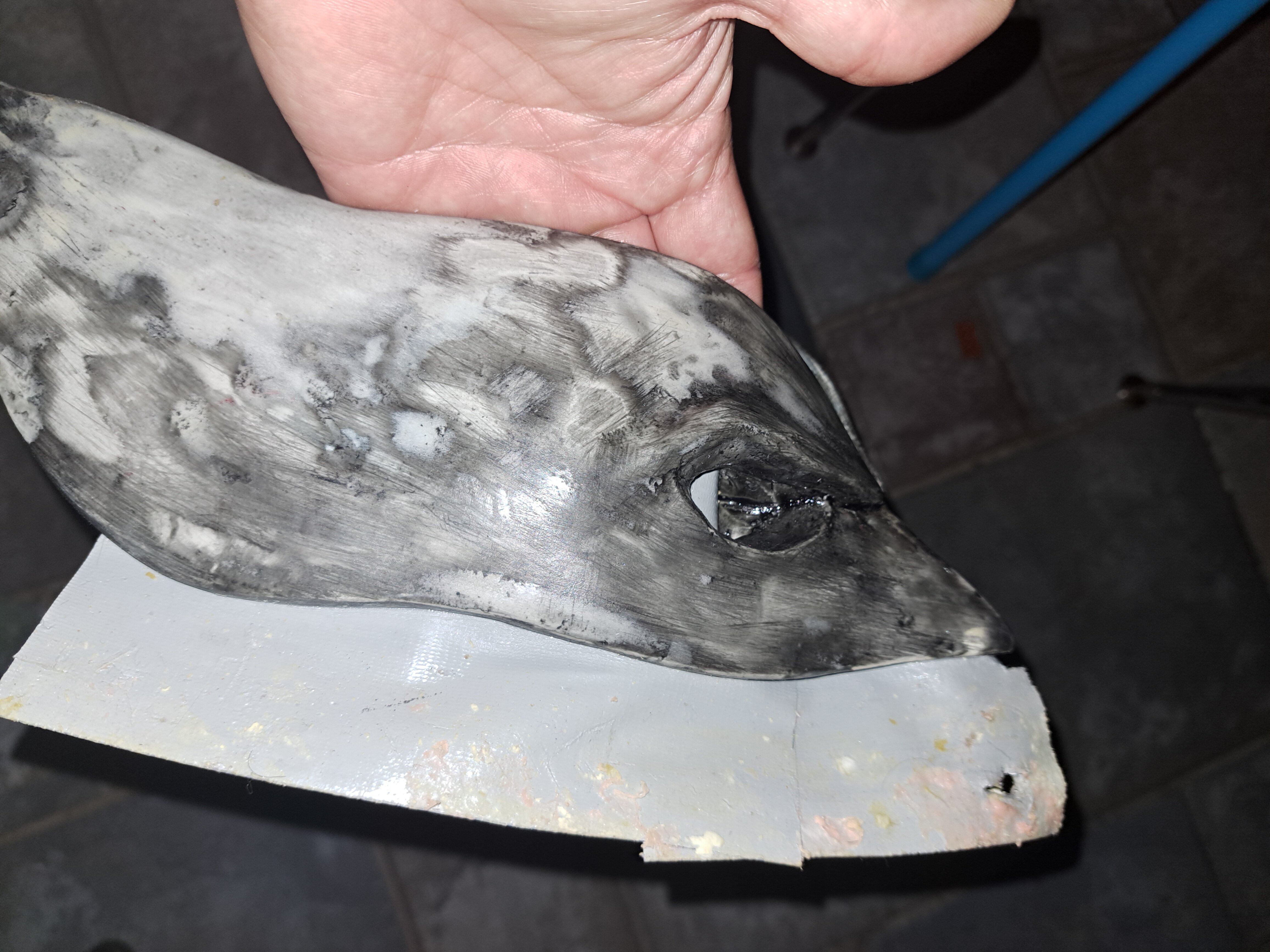

When I made Green Lantetn mask, I spray painted it with --I believe it was Rusoleum-- and used Rebound 25. The mold came out looking like a burn victim.
Test the clay with whatever you applied to it, on a sample first.

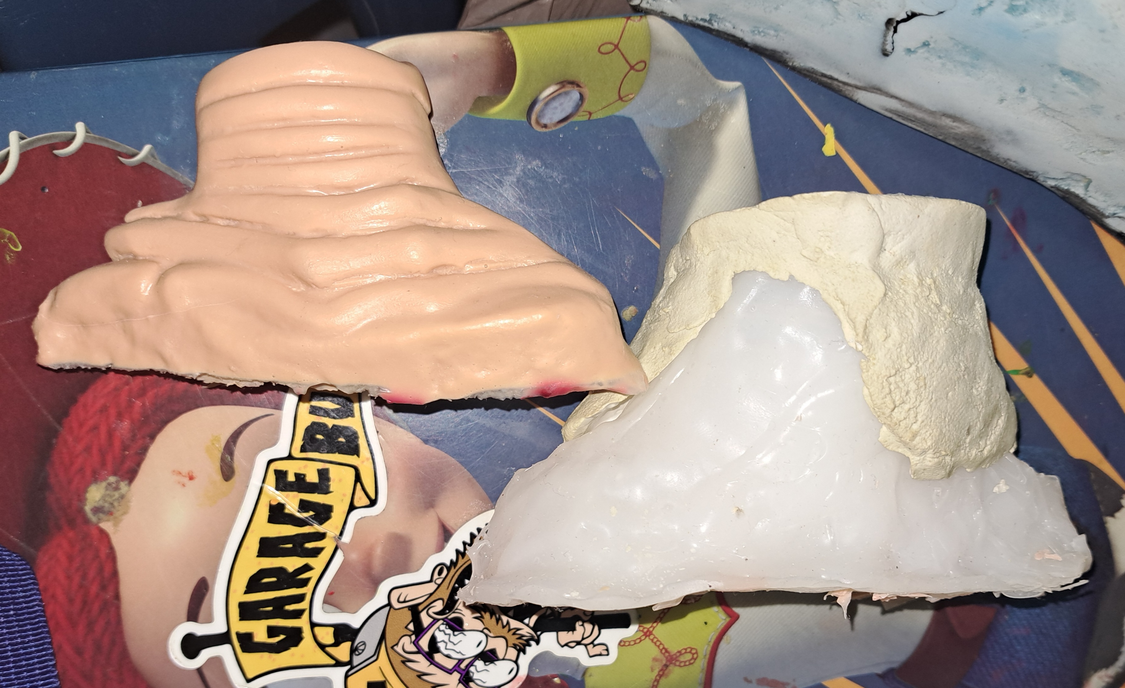

I use Rebound for most of my molds. The only time I really used dragonskin was for a demold that needs to be really, really sstttrrreeetttccchhhed.
Like on an alien valve where the internal base is wider than the exit hole. Repund cant stretch and deform that well, but Rebound will get you great detail.

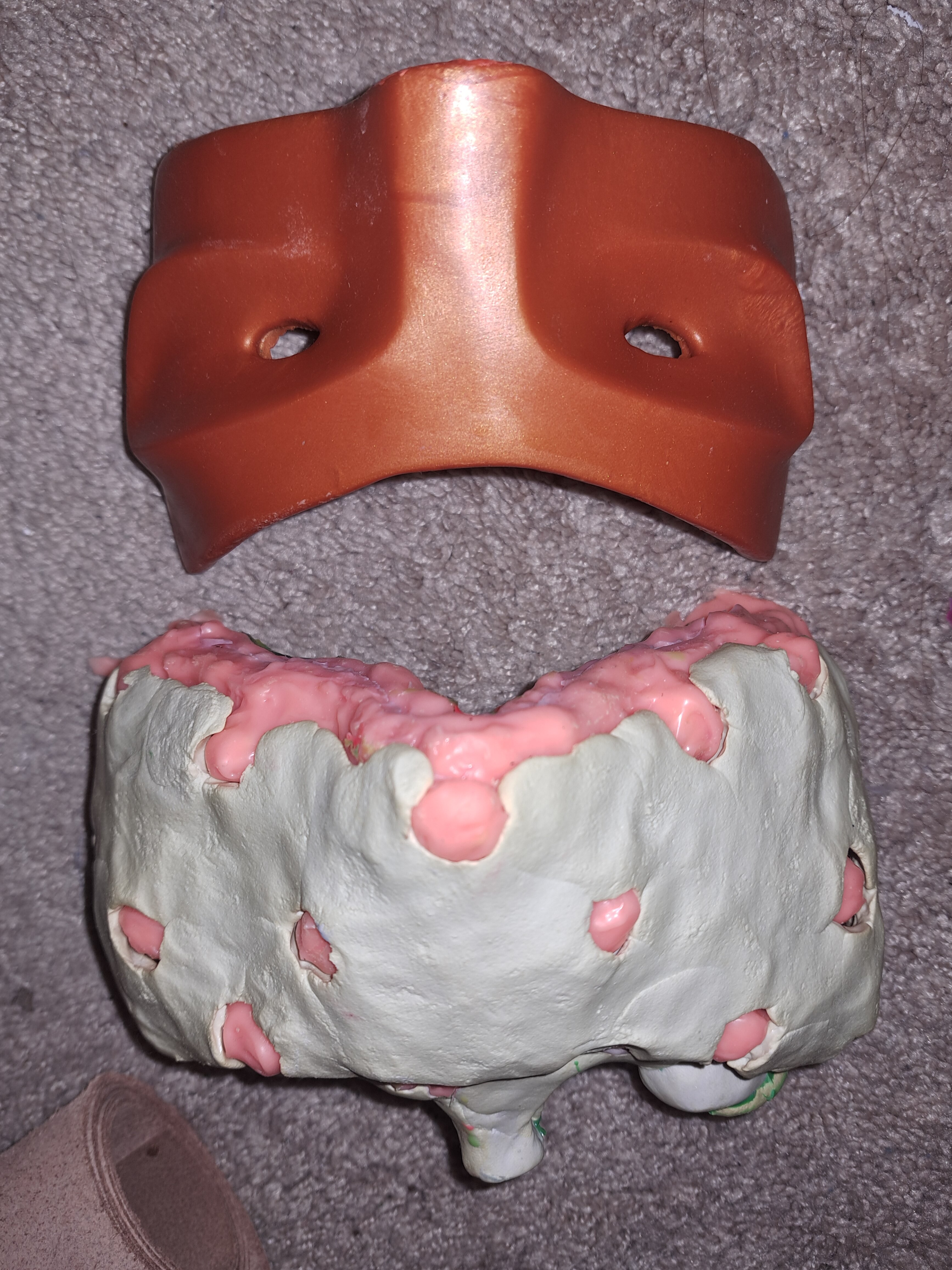

I glue Gorilla tape to the botton of mask molds.
That is the semi-rigid material to the back of the sculpt. I then apply Rebound to the mask, knowing I will use the mold upaide down when I make castings.

Gorilla tape on Wolvwrine cowl. Also over the eyes, so the mold has a front and back.

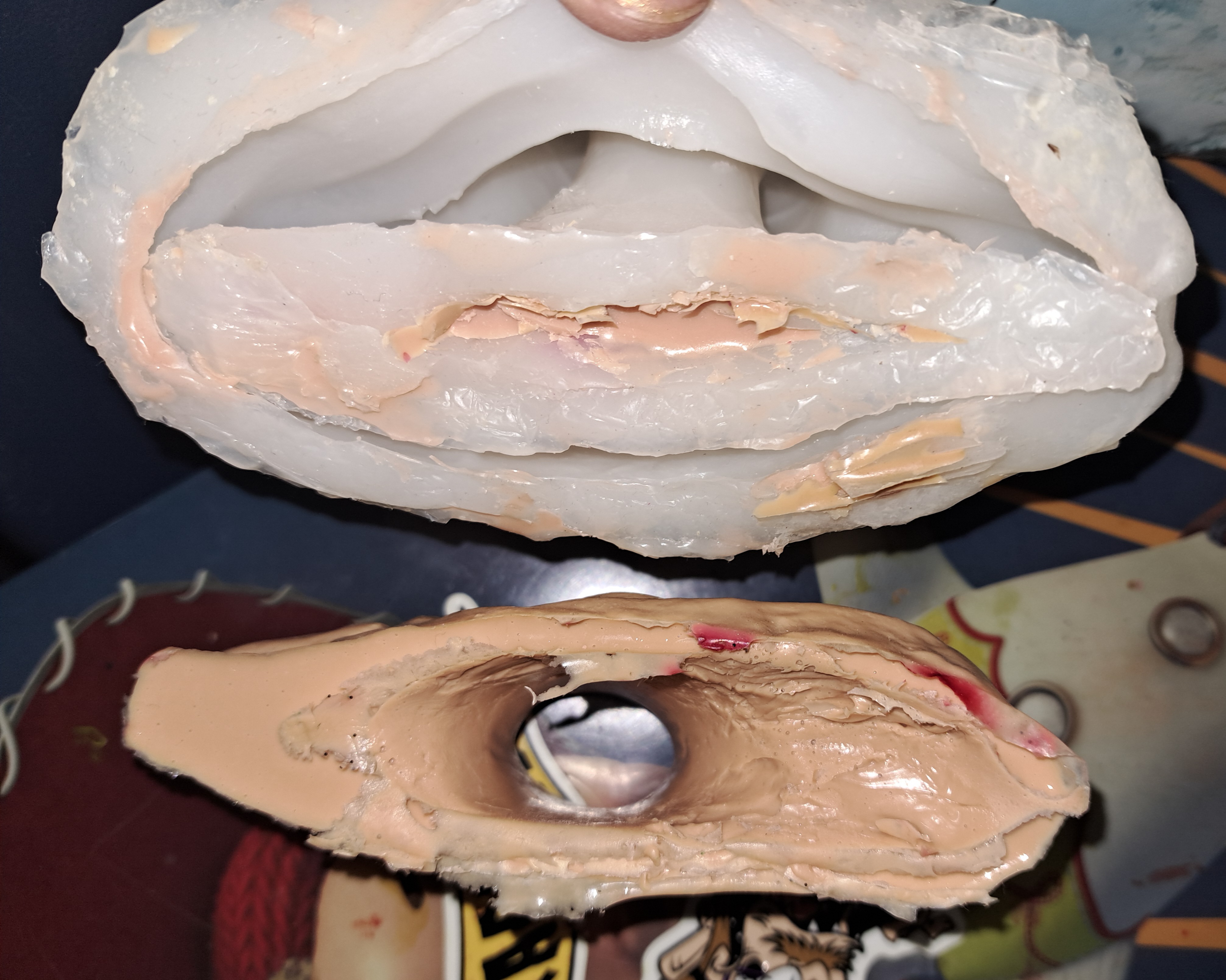

Dragonskin for a valve where the demold involves pushing a wide base tbrough the small opening...uae release agent
