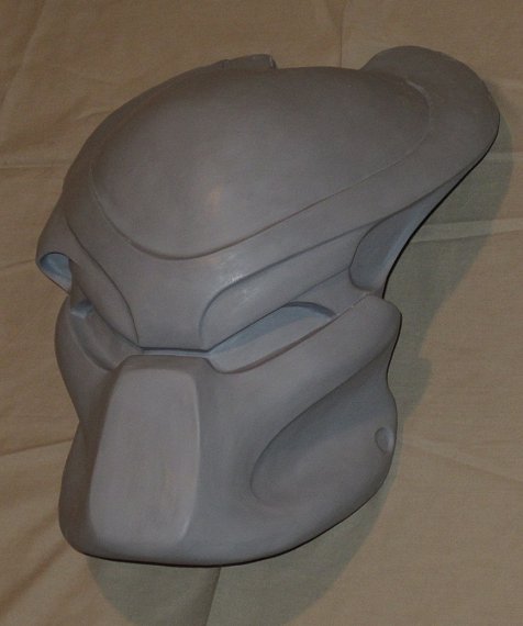

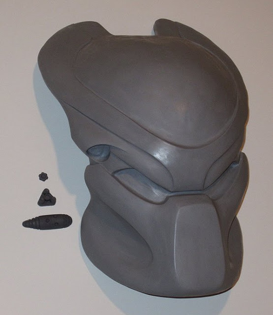

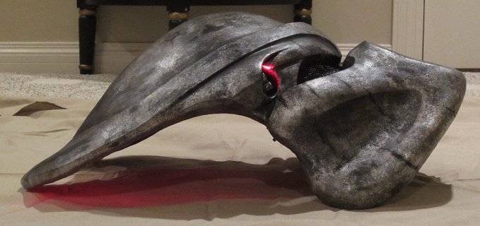

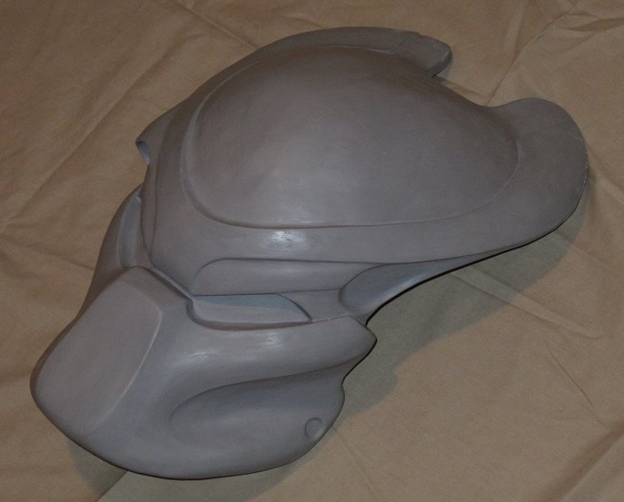

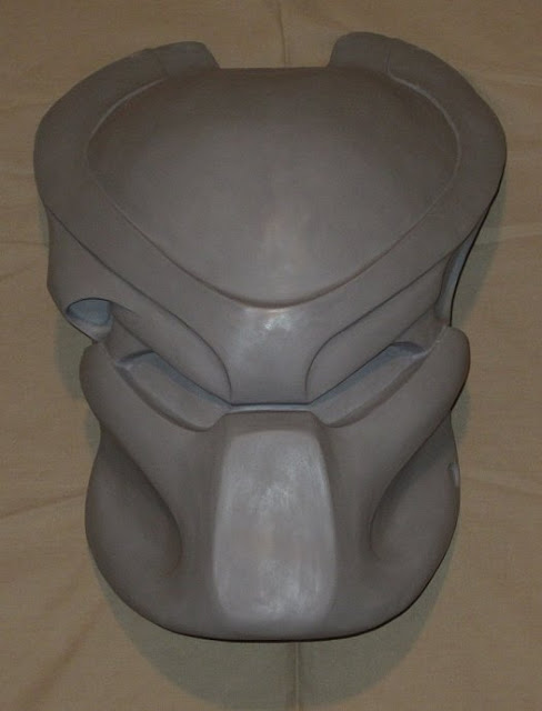

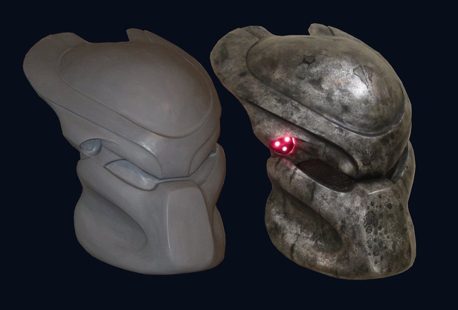

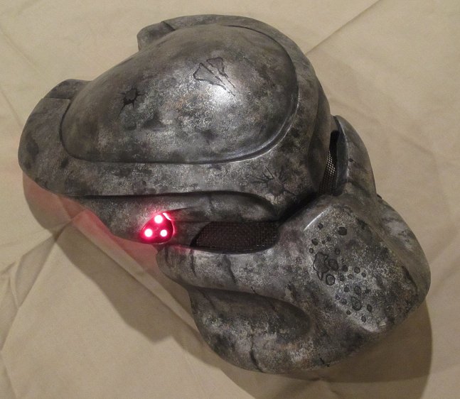

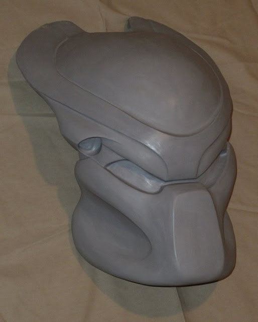

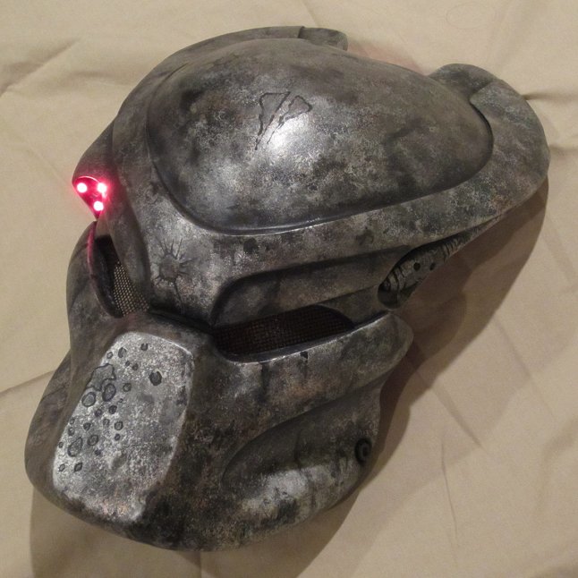

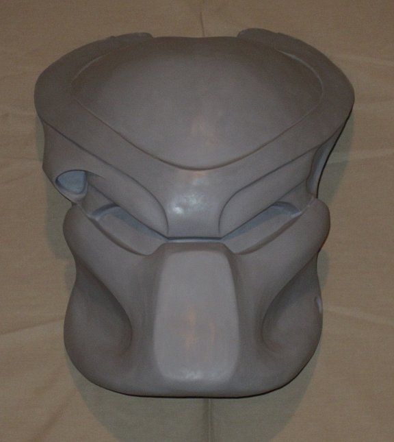

Thanks so much for all your encouragement guys! Here's some pics of both raw and painted:
****** on a bike man....they came out great
As has already said.....one of the best out there.....you should be VERY proud of yourself man,
post 225 is your best P1 paint up so far, i bet that feels great on a bio you sculpted. :)

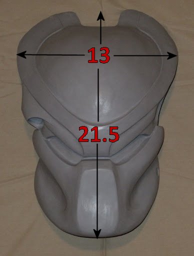

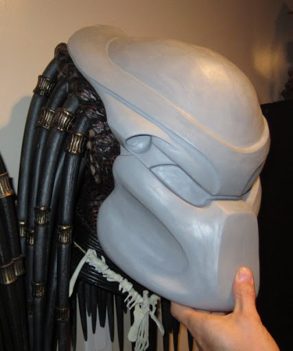

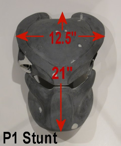

The head underneath is Scott Marshall's 1st gen closed mouth. The Bio fits but would need some adjusting with a heat gun to fit perfectly.
The measurements are:
Here is the P1 Stunt in comparison:

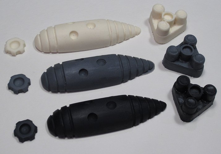

What type of Resin did you use, I used smooth cast d65 i believe on my OZ bio, took a huge amount, this is very impressive for 4 layers, EXCELLENT JOB MY FRIEND!!
 Thanks so much for the info, how many casts were your able to yield in a gallon? if you dont mind my axing? And did you brush the coats on or just swoosh it around?
I can say that when doing castings of my bio, I was able to get around 6 thick pulls about a 1/4 inch. And another 3 slightly thinner pulls. It really depends on how thick each copy is. The best method to use is a slush/brush method for all layers. I usually slush each layer until it thickens up then use a brush to push around the resin. Thats my method anyways. Hope that helps
