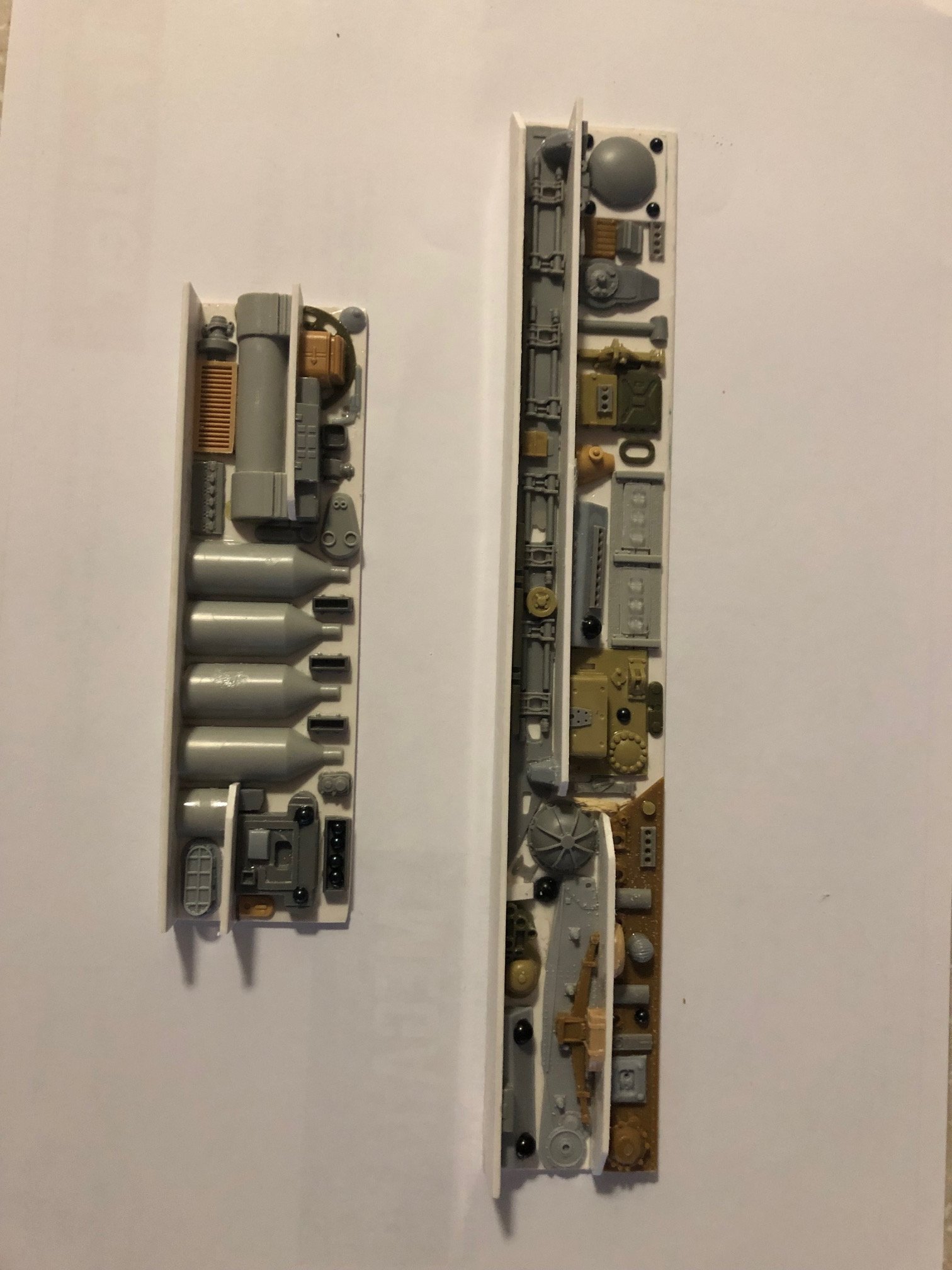

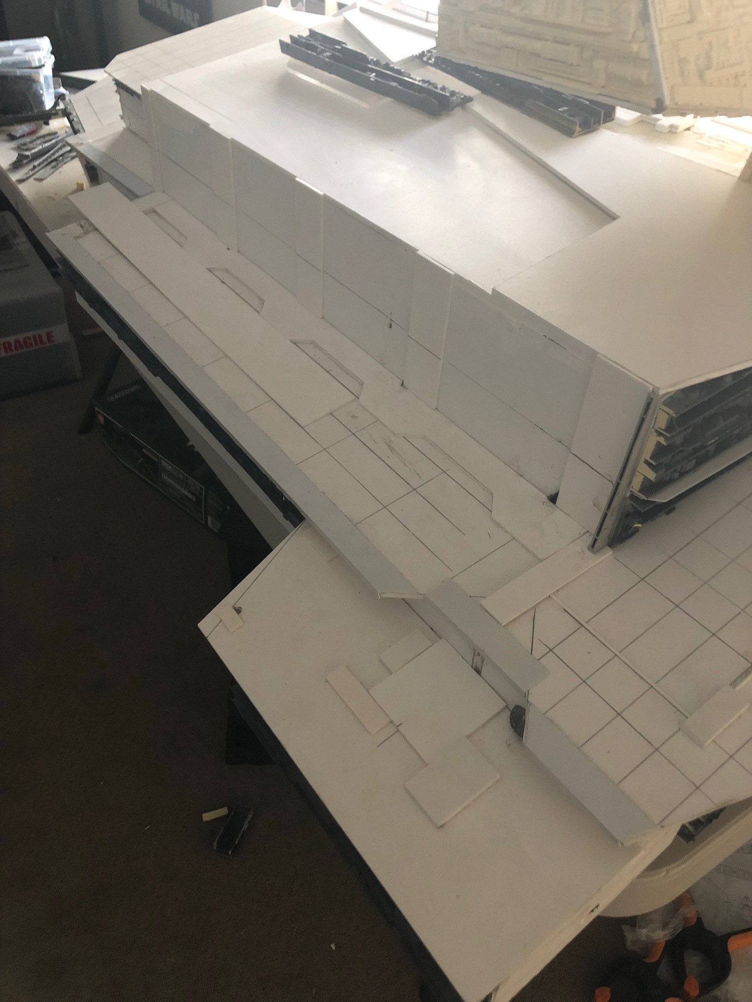

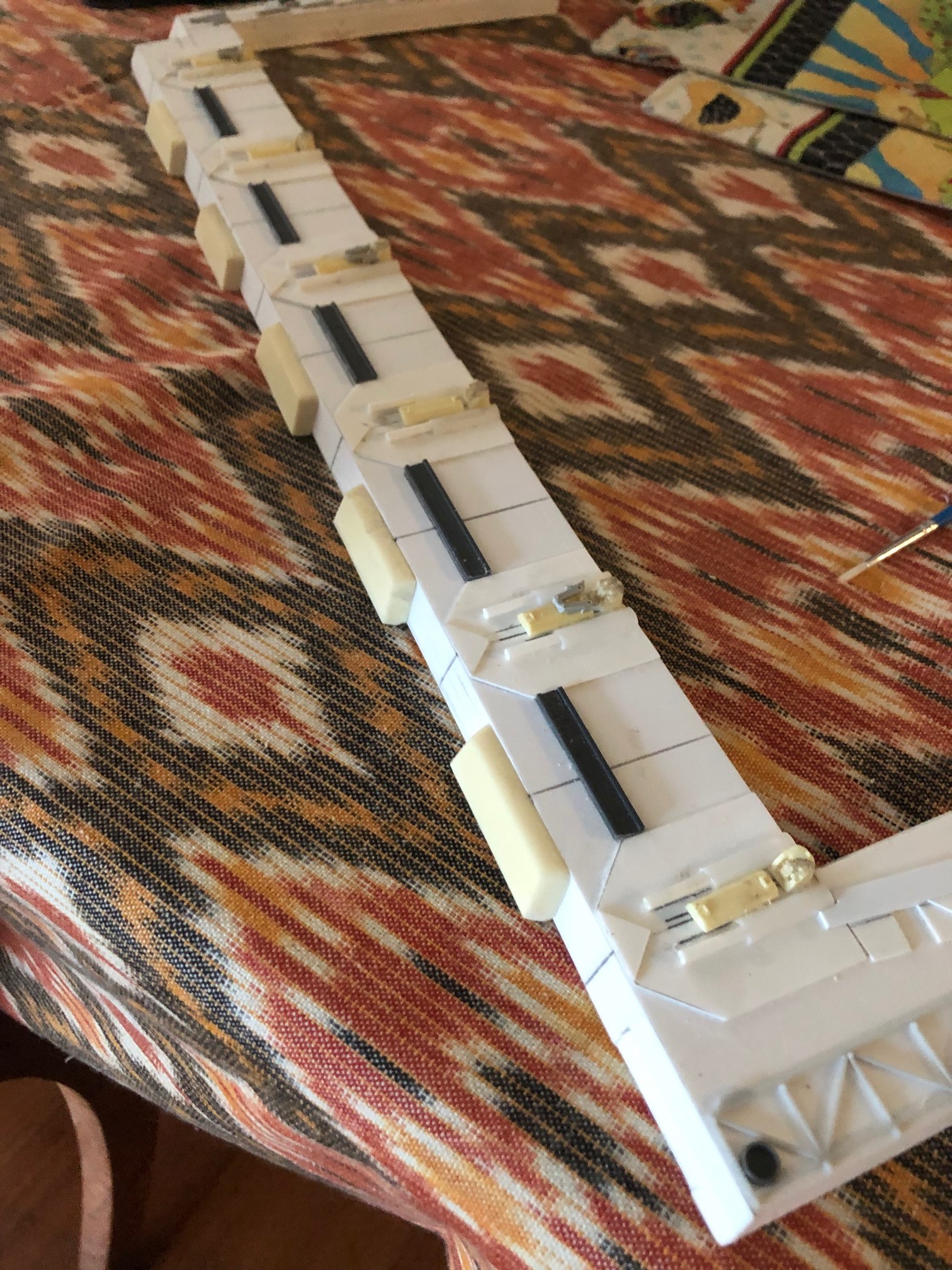

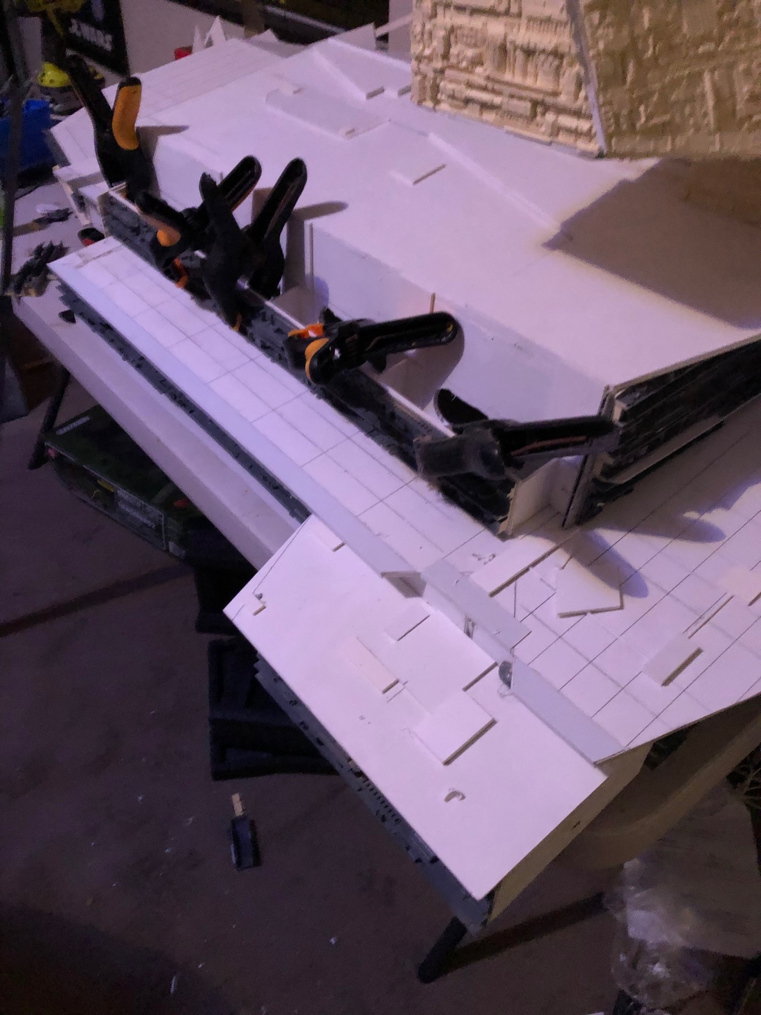

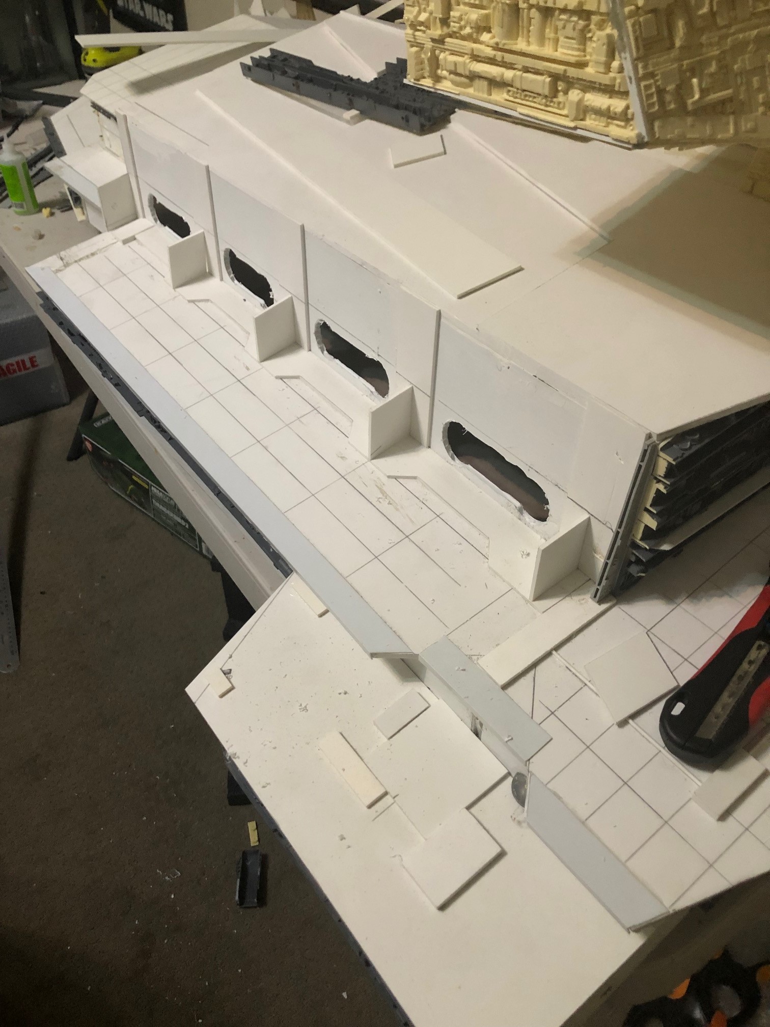

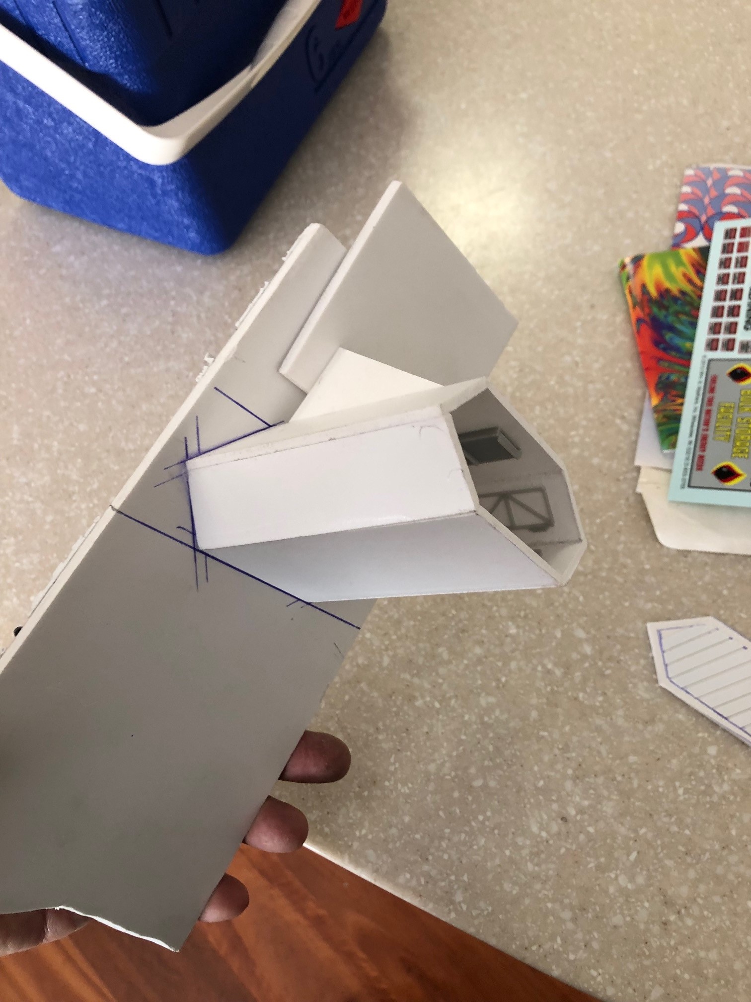

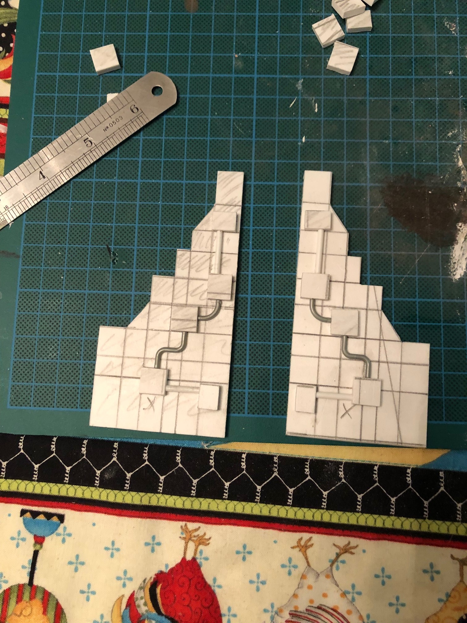

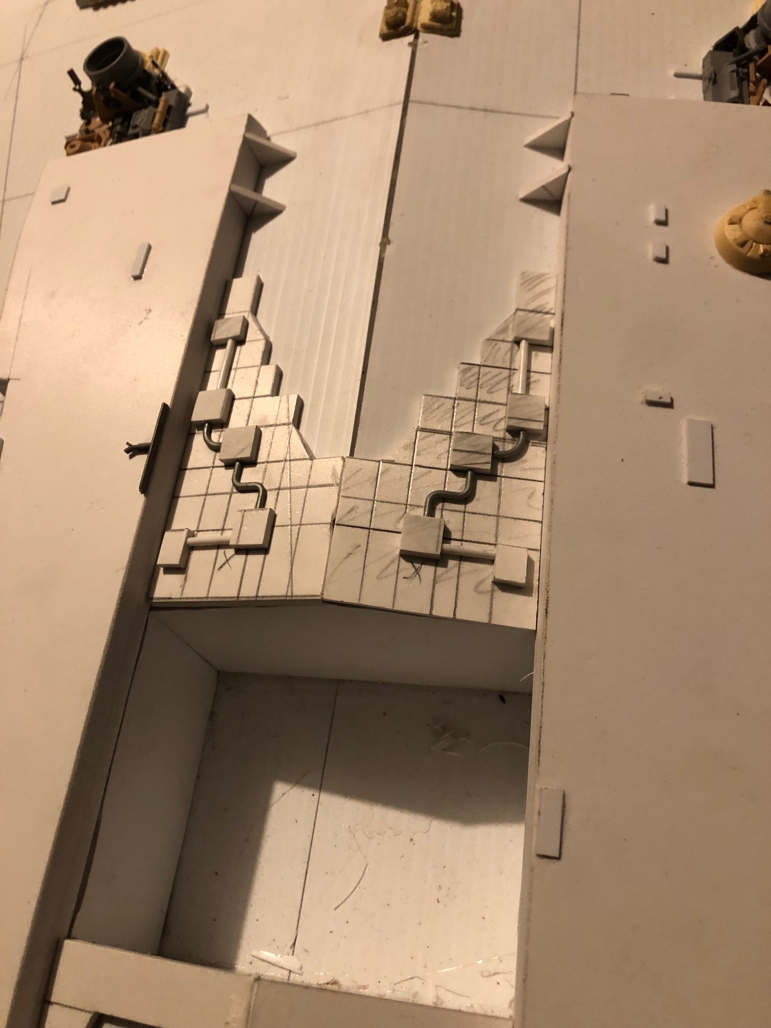

Worked on the detail piece going around the hanger under the SD.
Much easier to work on the kitchen table the glue the finished piece onto the ship rather than leaning over to glue all the parts on.
Just a few more parts to add then it will be glued into place.

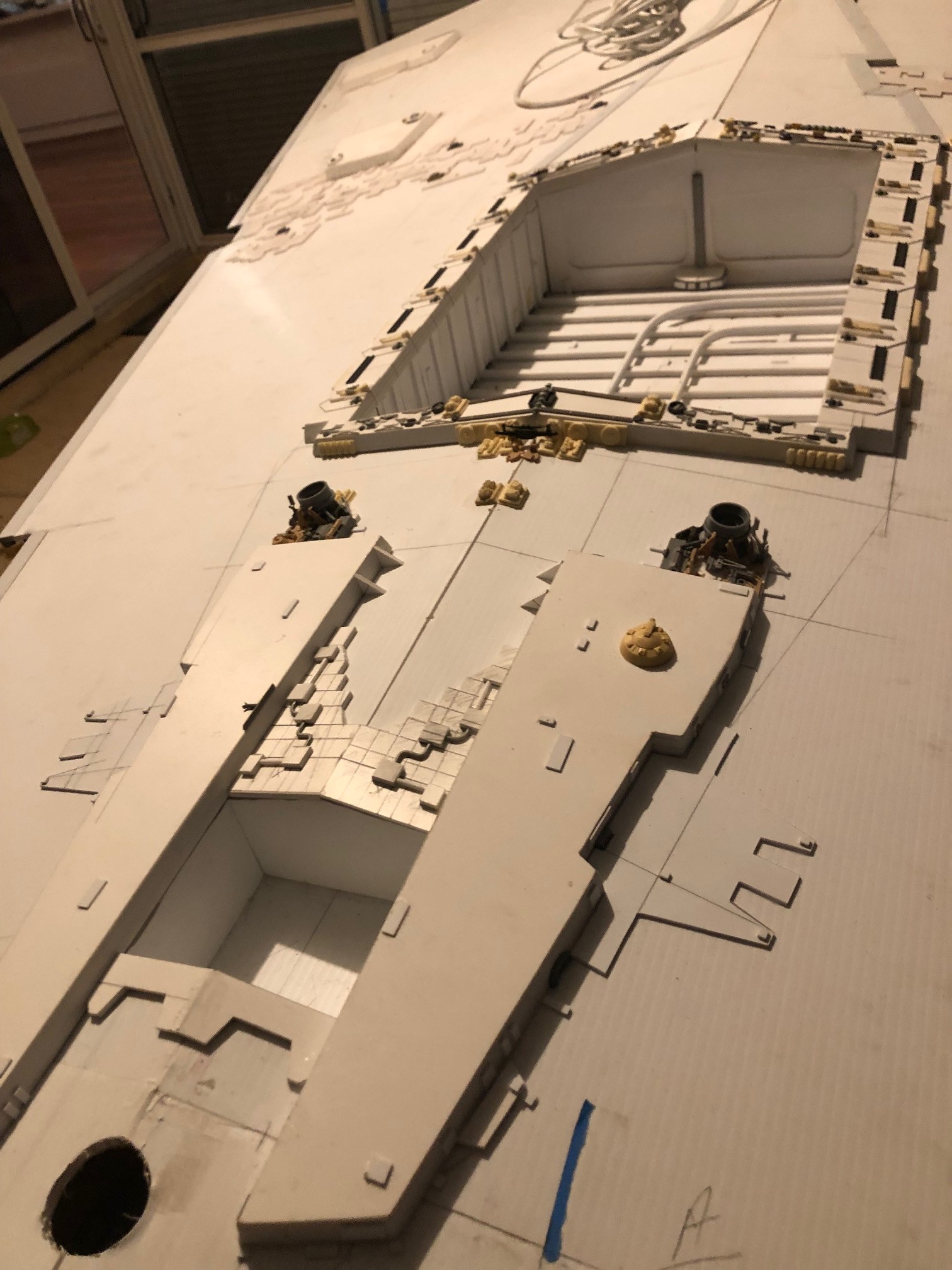

yaris

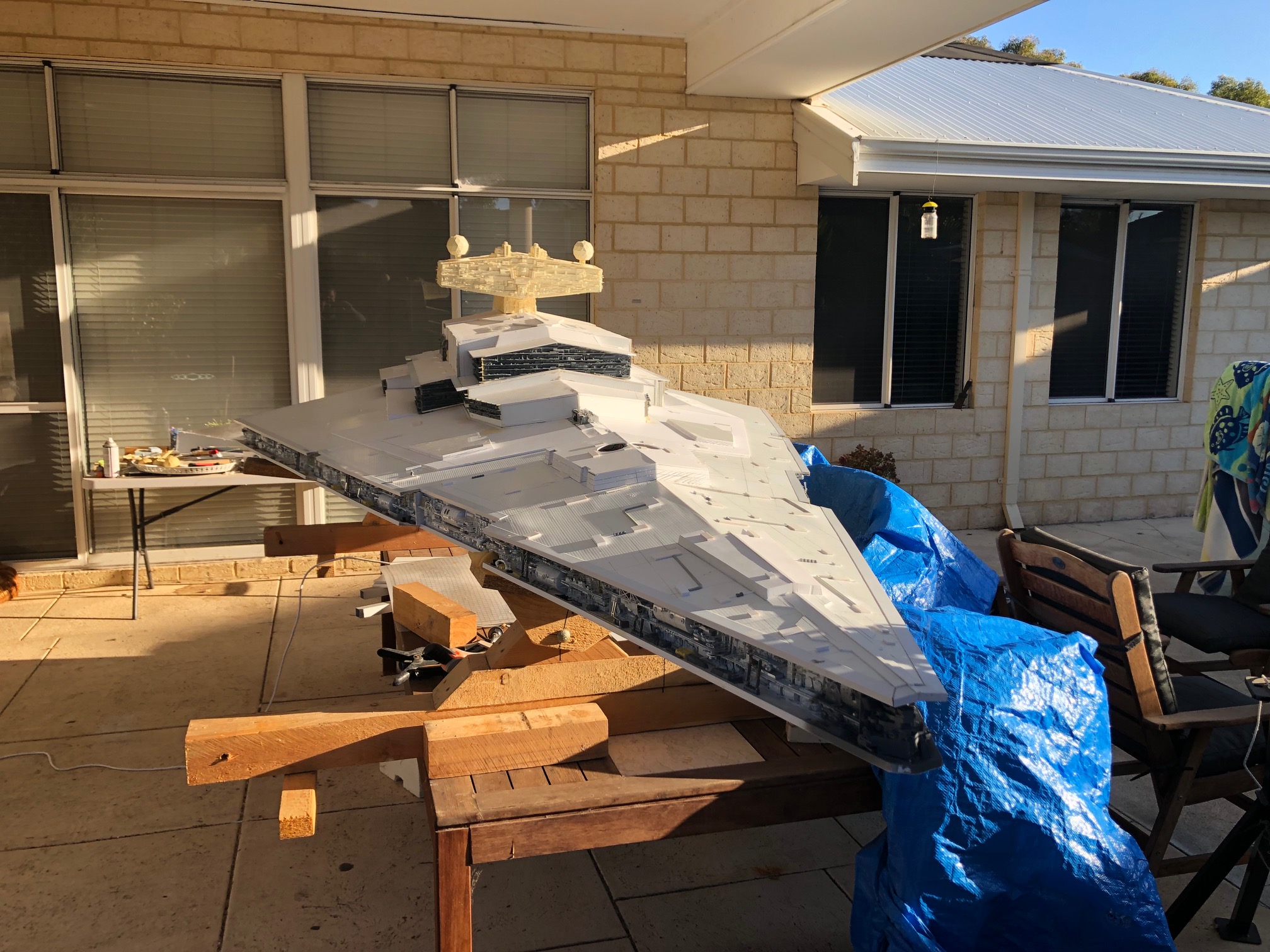

That thing is huge!...great job so far..!...what type of glue are you using..? I see corflute and styrene as some of the substrates, did you use just one type of glue or different types depending on the material...?
Muzza
I started using coreflute plus I have used foam board 3mm and 6mm this stuff has a pvc lining that you can glue you greeblies directly to it using normal model glue.
Yes I did use many different glues in the construction Super Glue, Hot melt glue and Sika flex.

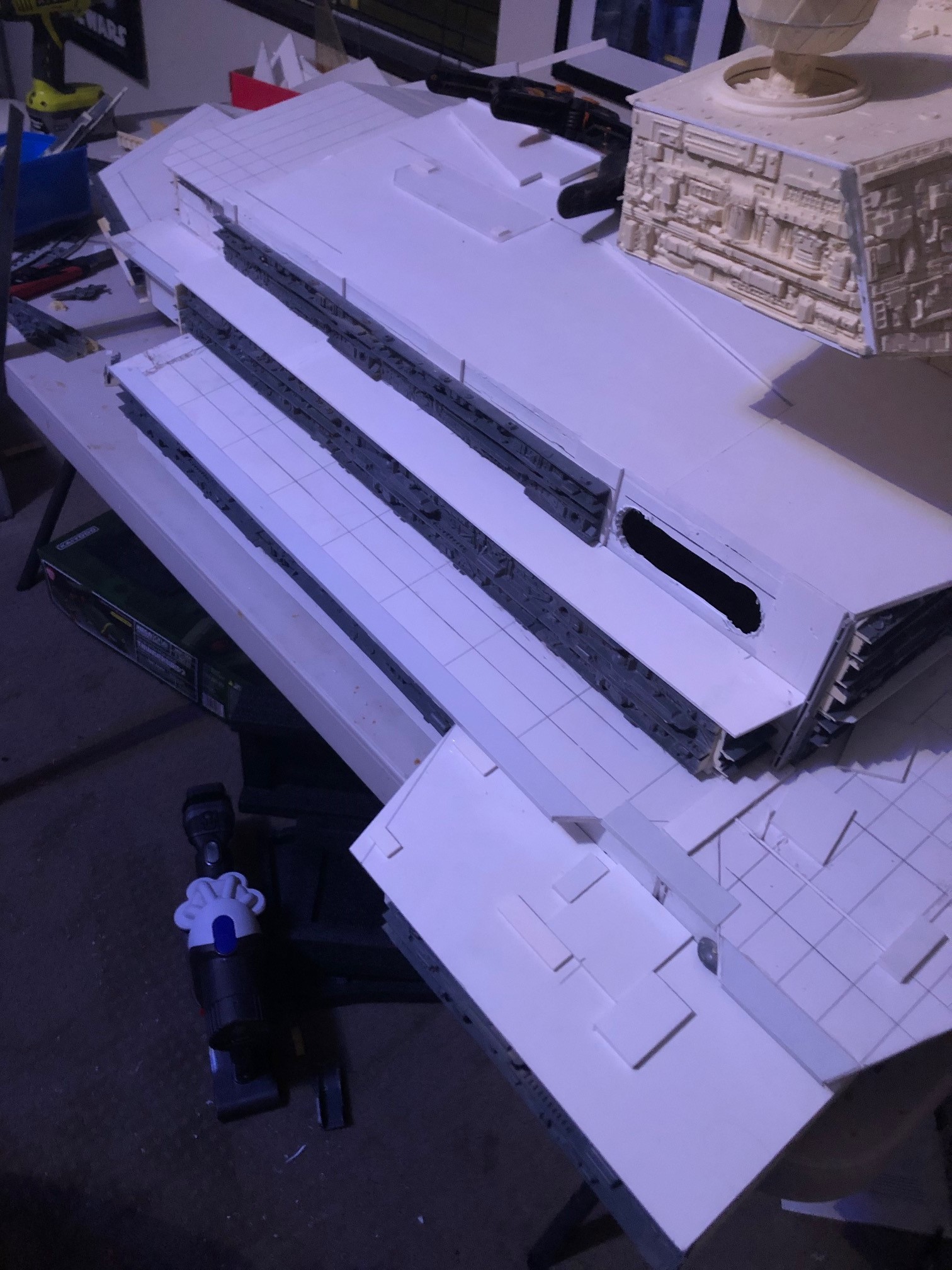

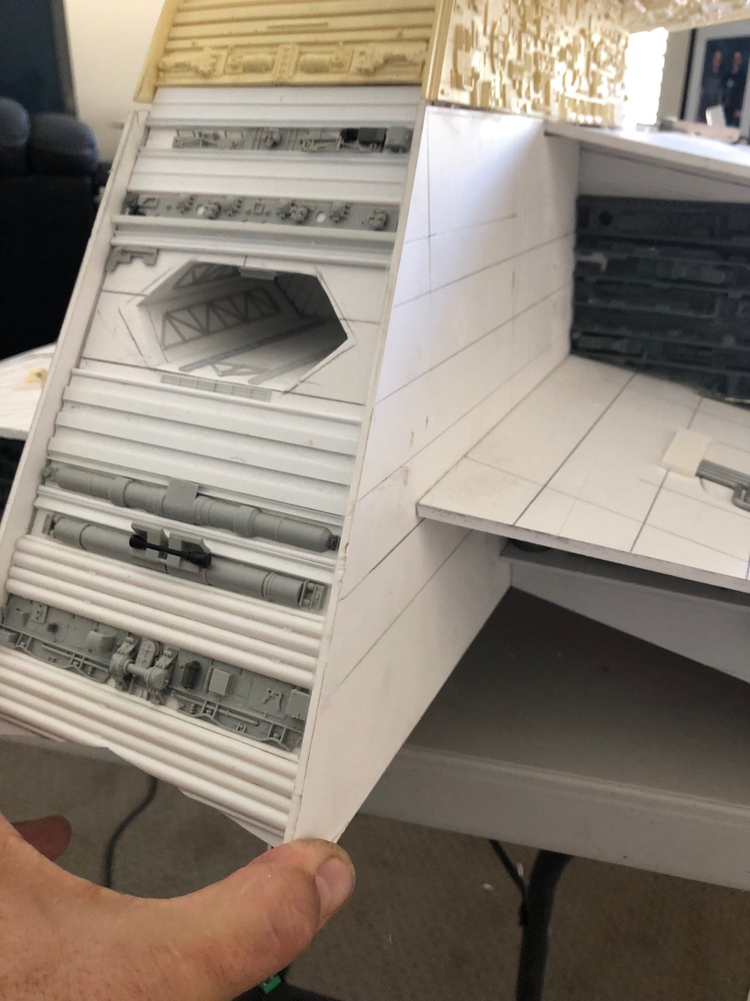

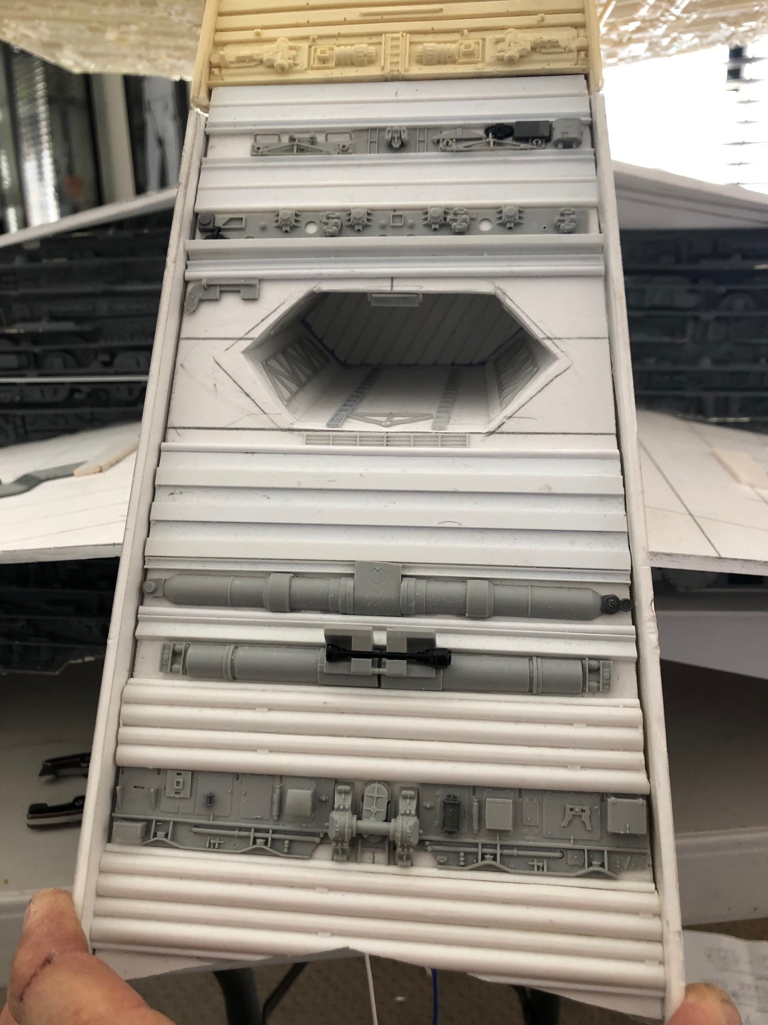

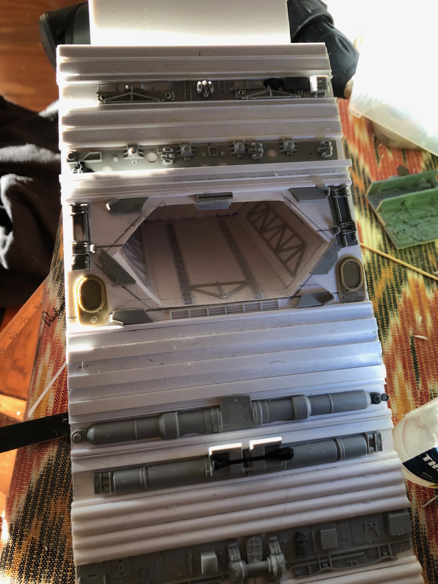

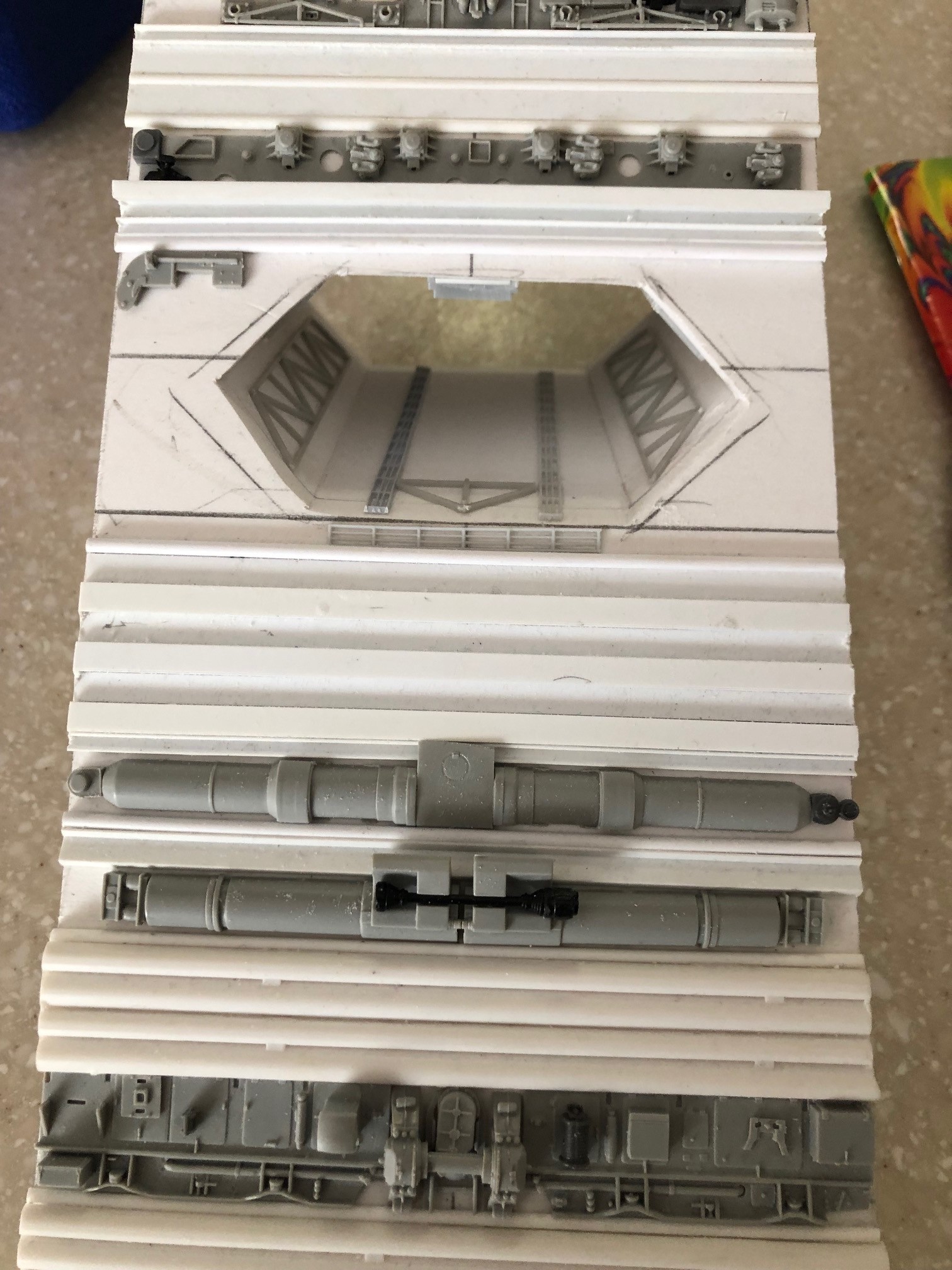

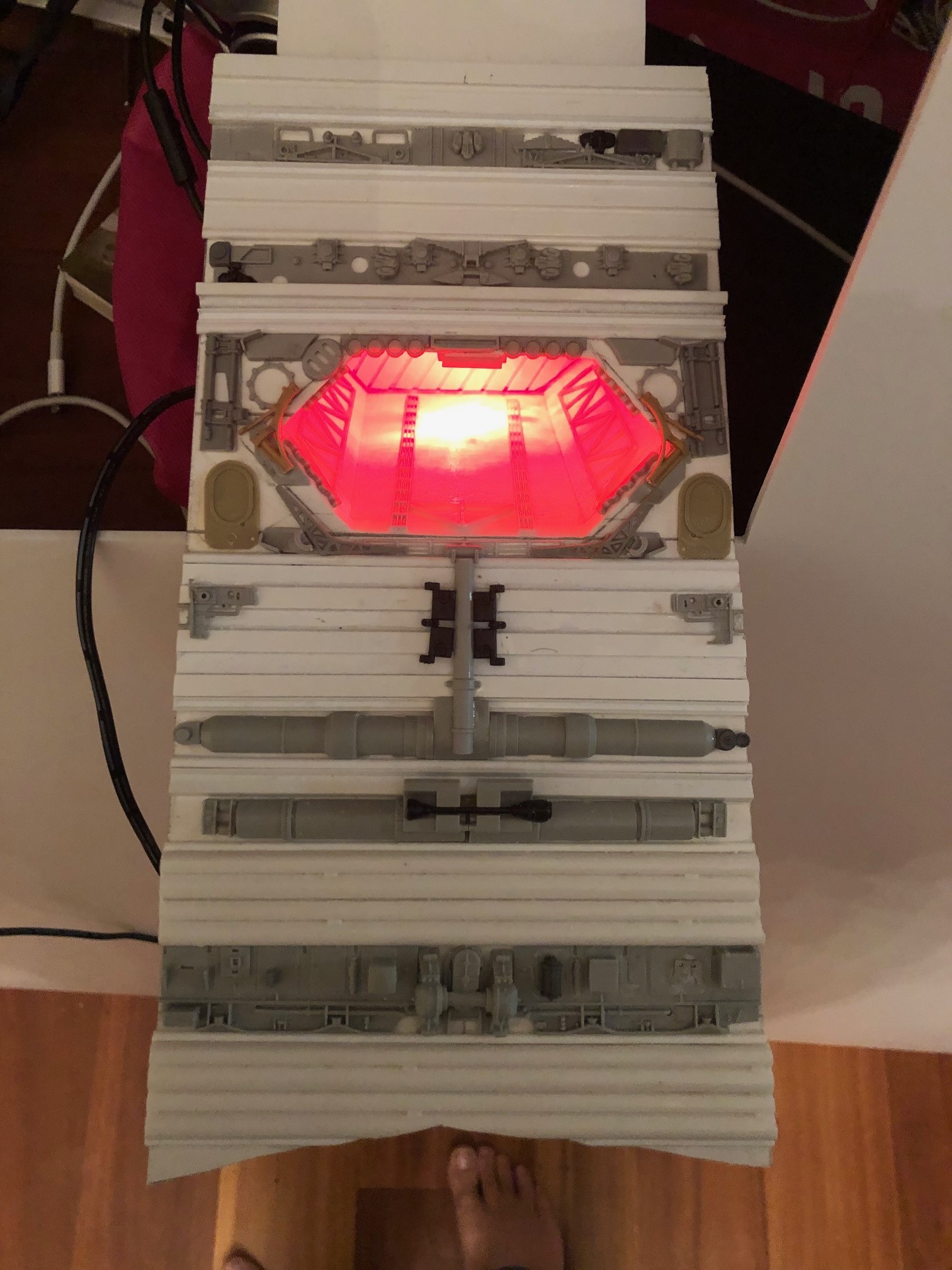

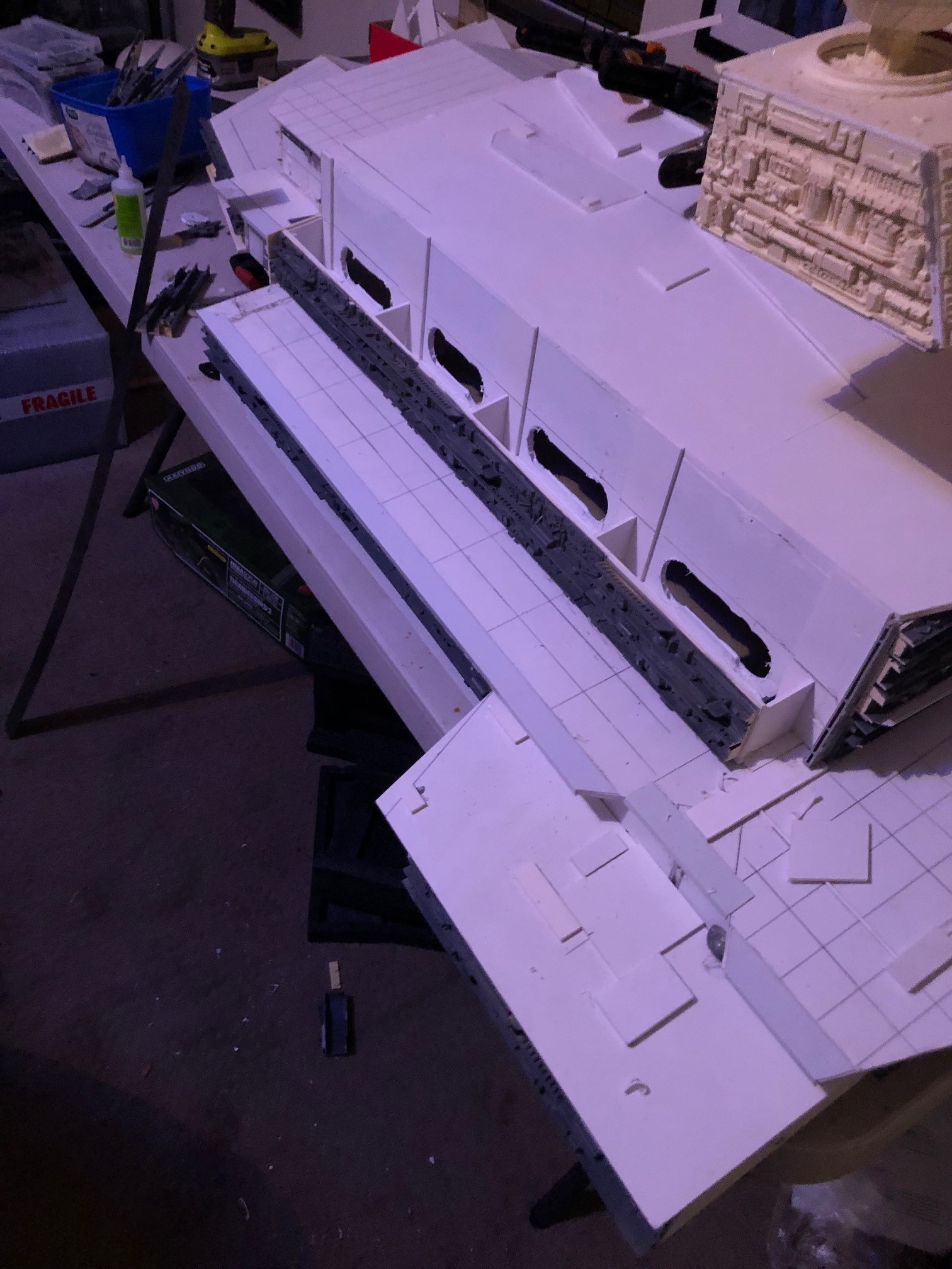

Adding more detail resin strips to the side of the bridge section.
Next cut holes behind the panels for fiber optic lighting.
Add Panels spaced out 45mm.
Add the top then start adding a row of panels again cutting holes behind so it is easier to light.
Add the to row of panels.

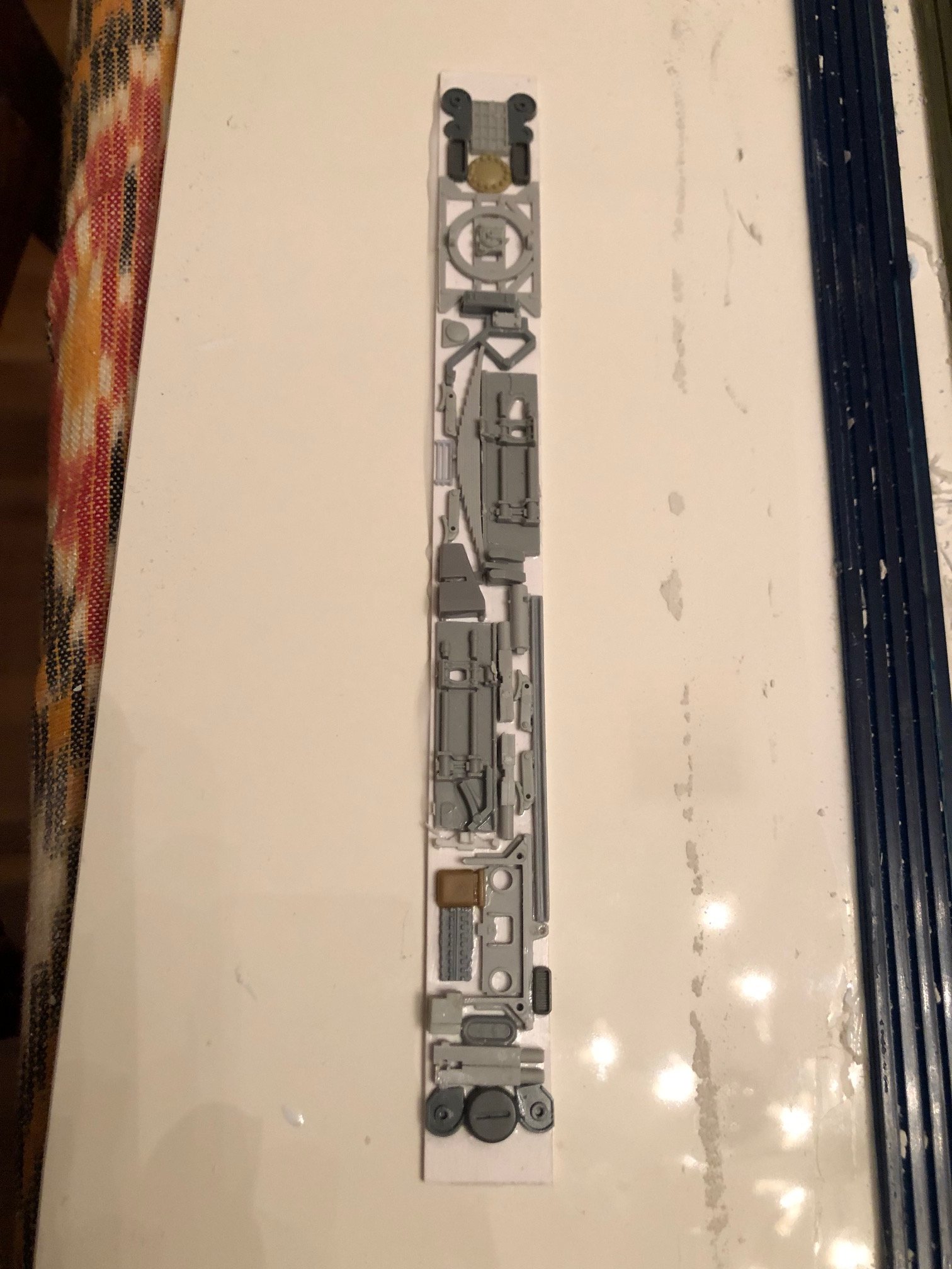

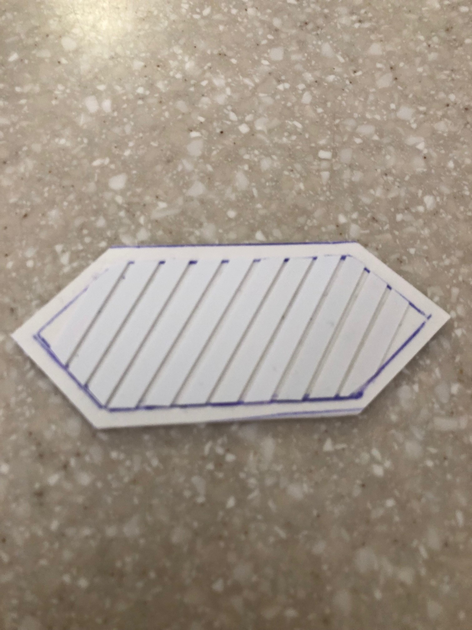

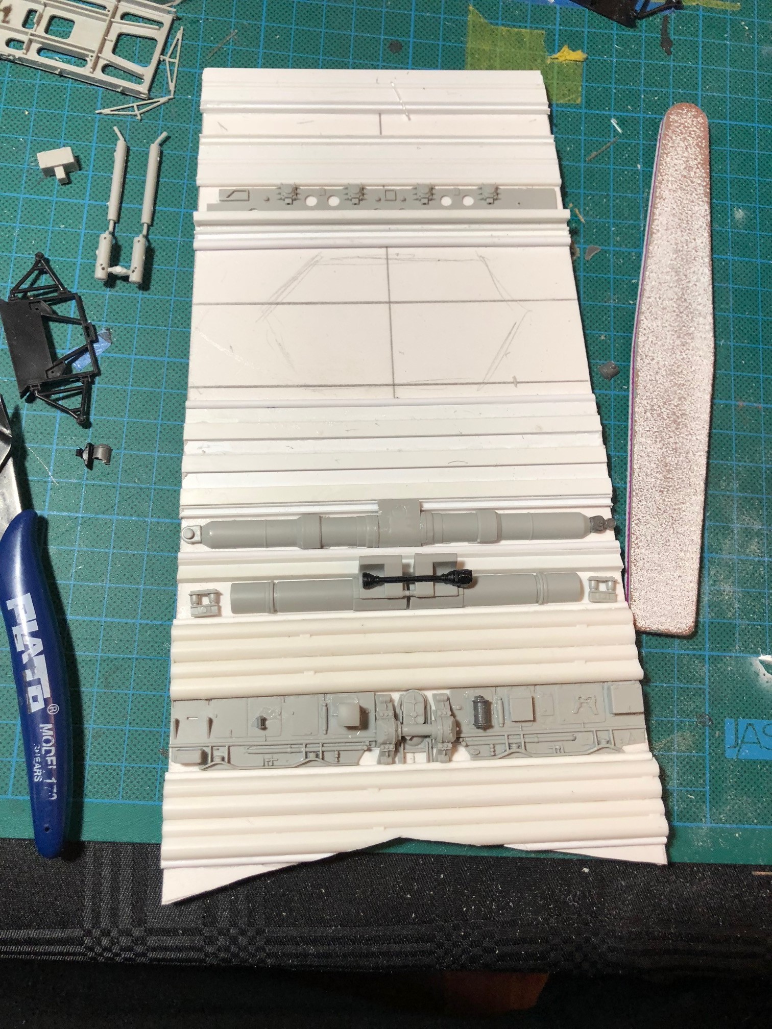

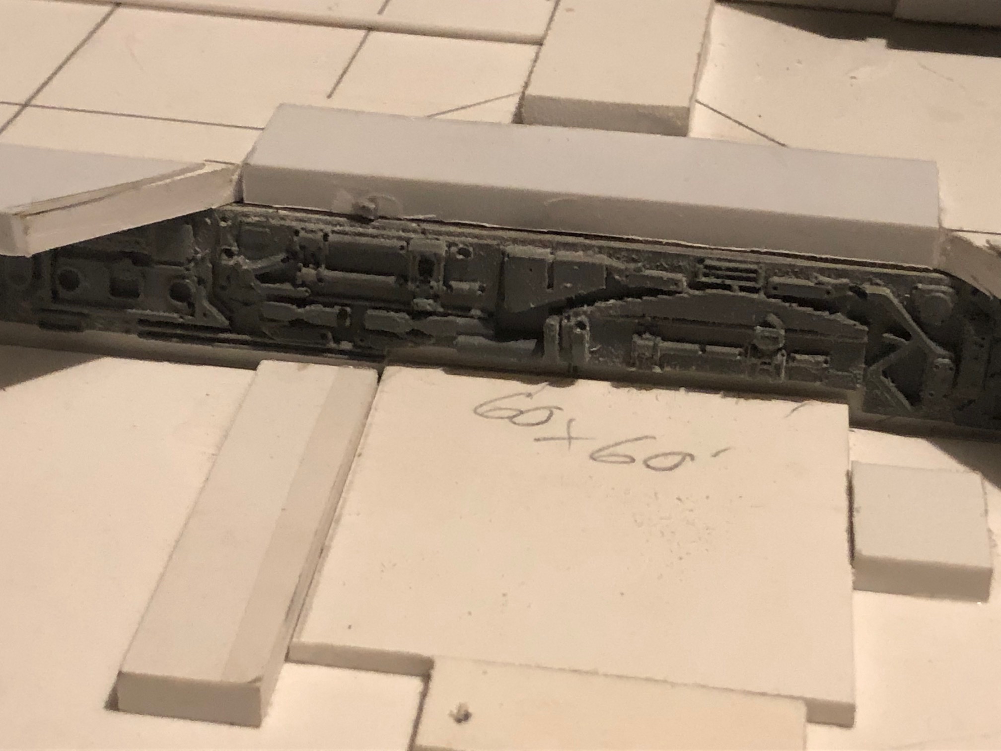

Made another greebly strip to add in the smaller areas.
I make the molds on a old gloss wall tile it is very easy to clean up after the mold is made.
and glue the piece to the tile with wood / PVA glue. it makes the piece very easy to remove as well.
