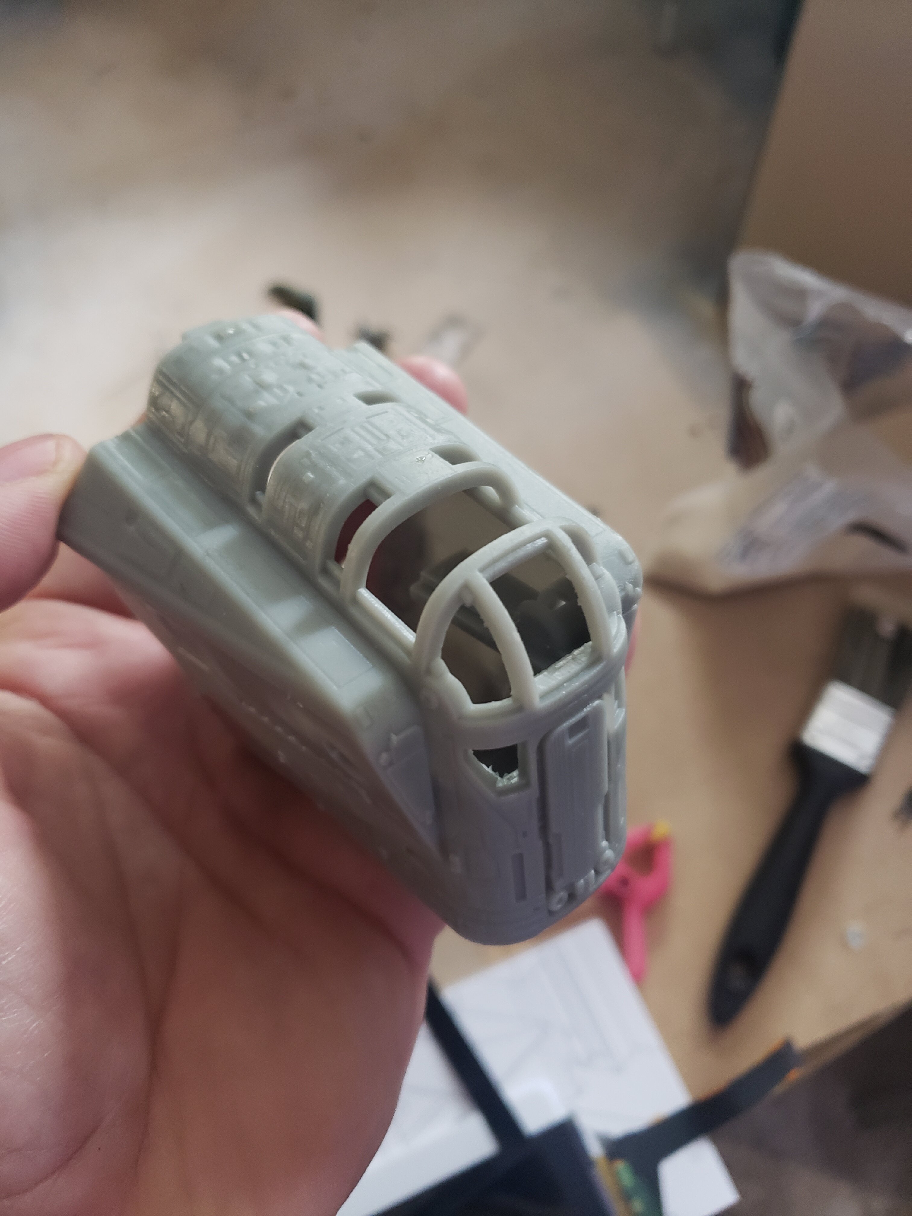

This was printed with the above mentioned resin from Siraya:
It took about 3.5 hours to print which was around an hour faster than with the other resins I've used.
1/72... I scaled it down 6% from the original stl files.
I wasn't sure, I knew it looked smaller than I remember unless you have huge hands :lol:
I didn't think 6% would make much of a difference but I guess it does, although looking at the one I printed in person now, I guess it yours is not much smaller than I originally though.
It also looks so much better printed that way without the seam running down the middle. I guess sizing it down let that part fit the plate better instead of going with the halves

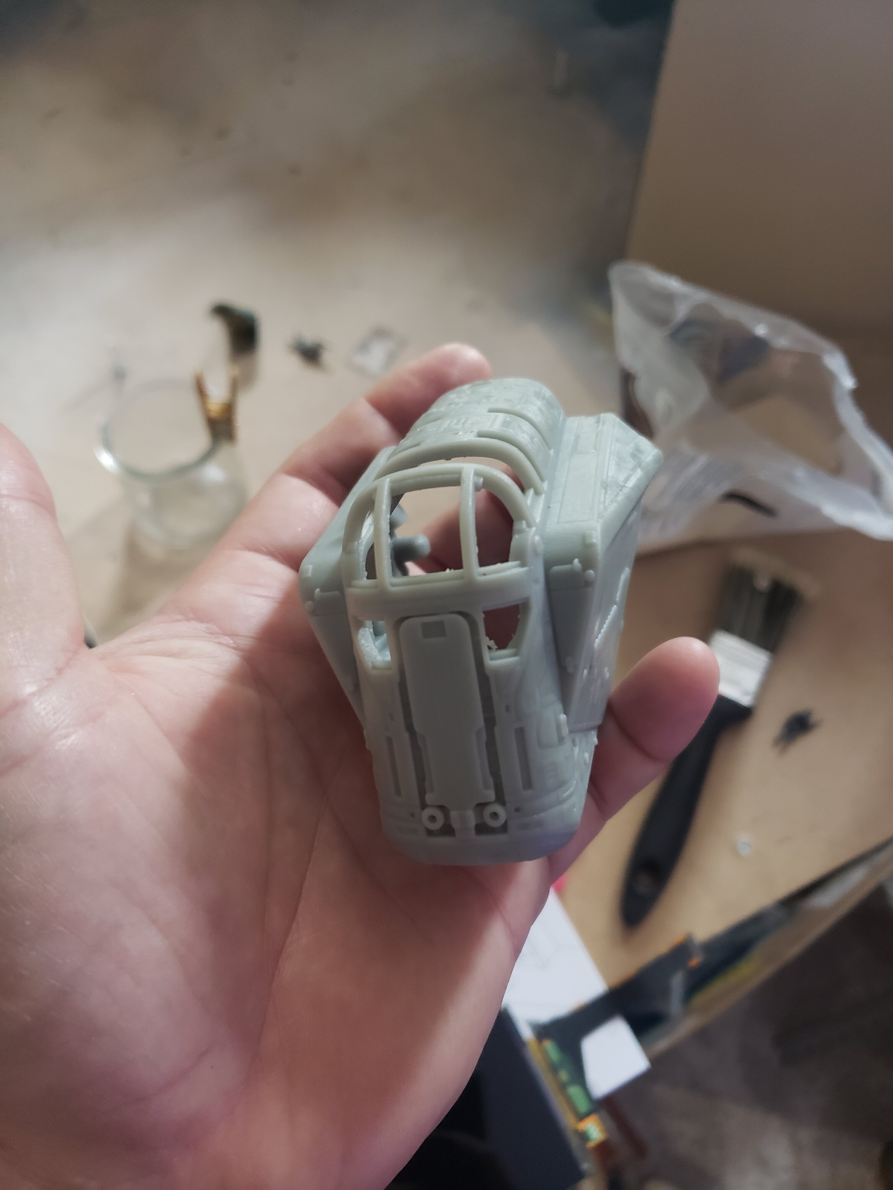

Yes, but it was a pain to cut the supports inside...lol... the center and rear hull were too large for my print bed to get in one piece... I'll have to upgrade to the Elegoo Saturn for that...lol...
That was the other reason I decided to do the halves.

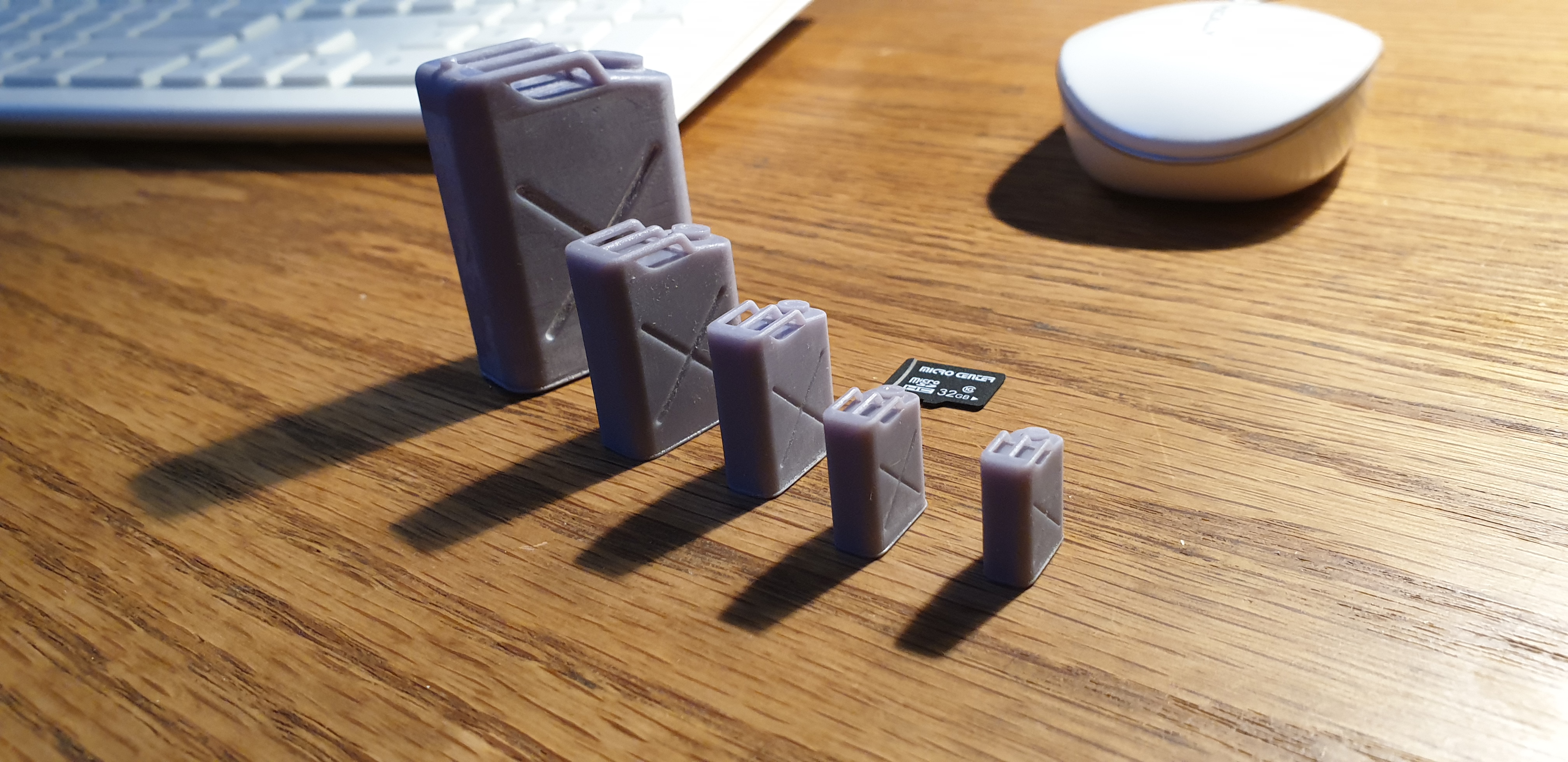

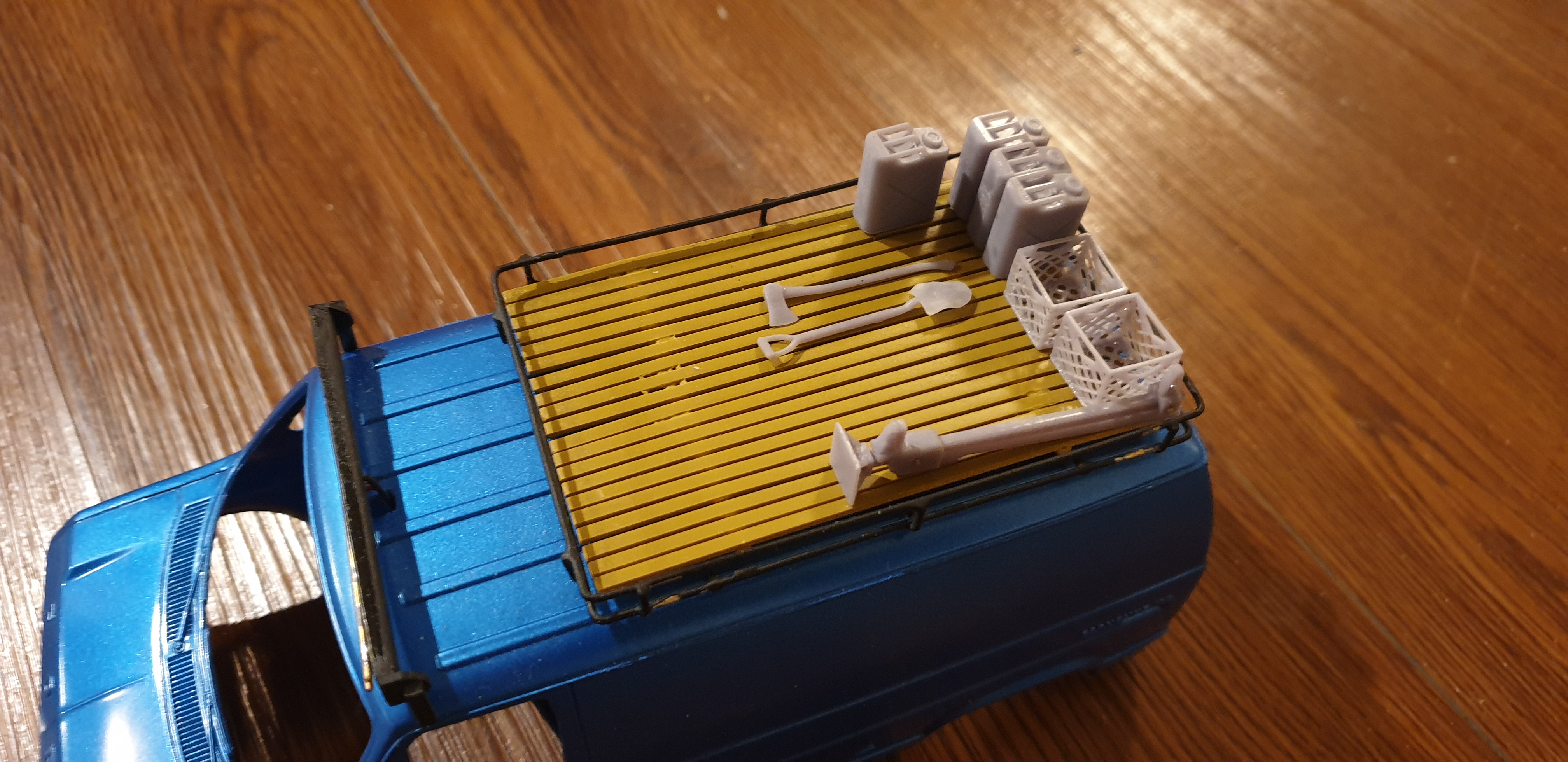

P.S. Where did you get the files for the jerry cans? I've been looking for that sort of thing for a non-sci fi model.
I've never used anything other than the water washable resin - I just don't have the space or the ventilation to be sloshing litres of IPA around. I obviously can't compare it to the normal resin, as I've never used it, but I seem to get good results. The only problem I have now is that I want to print some stuff in clear resin, which doesn't seem to be available in a water-washable version.
i got it off thingiverse: Jerrycan 1/10 scale by lixtap21

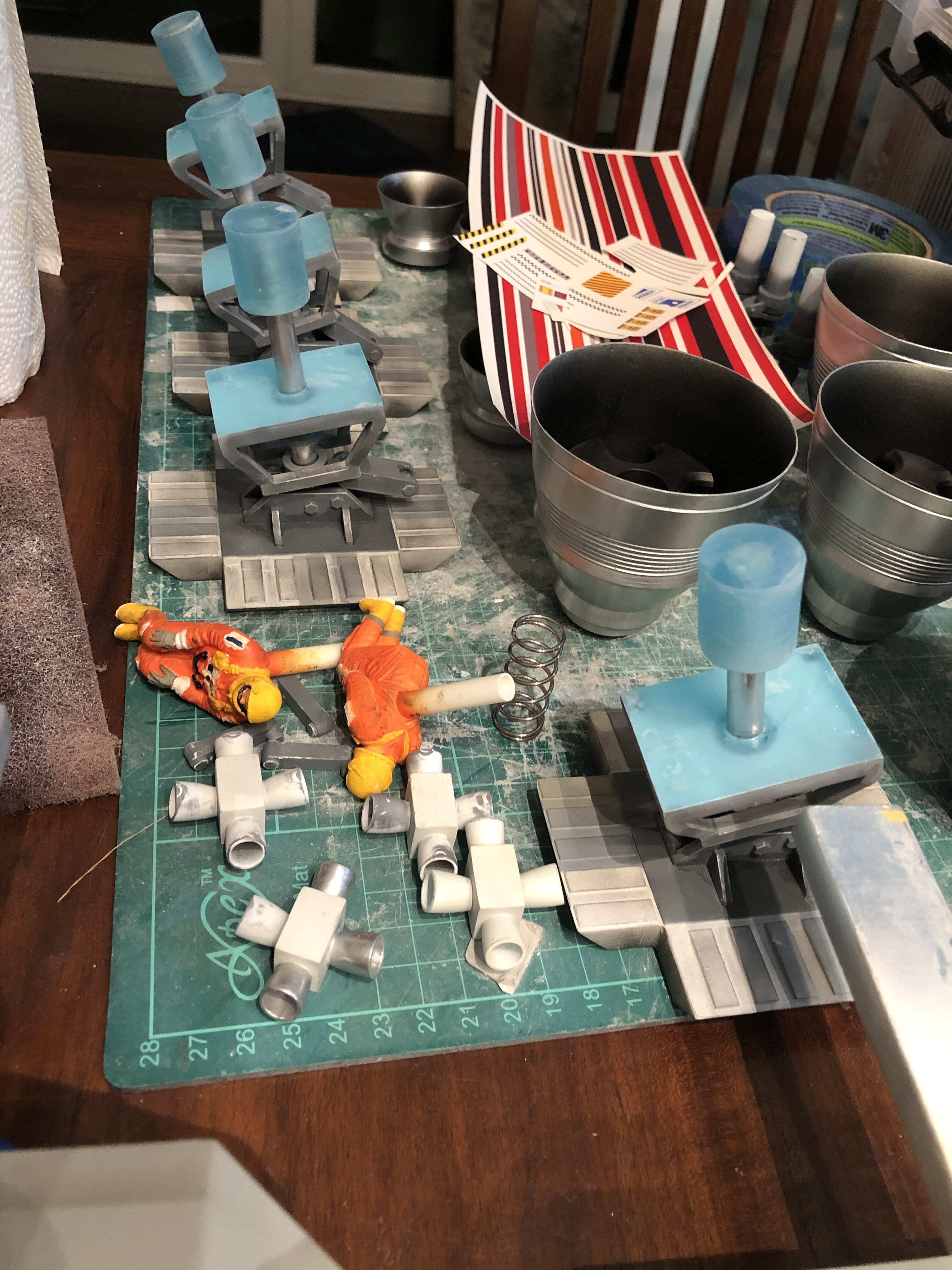

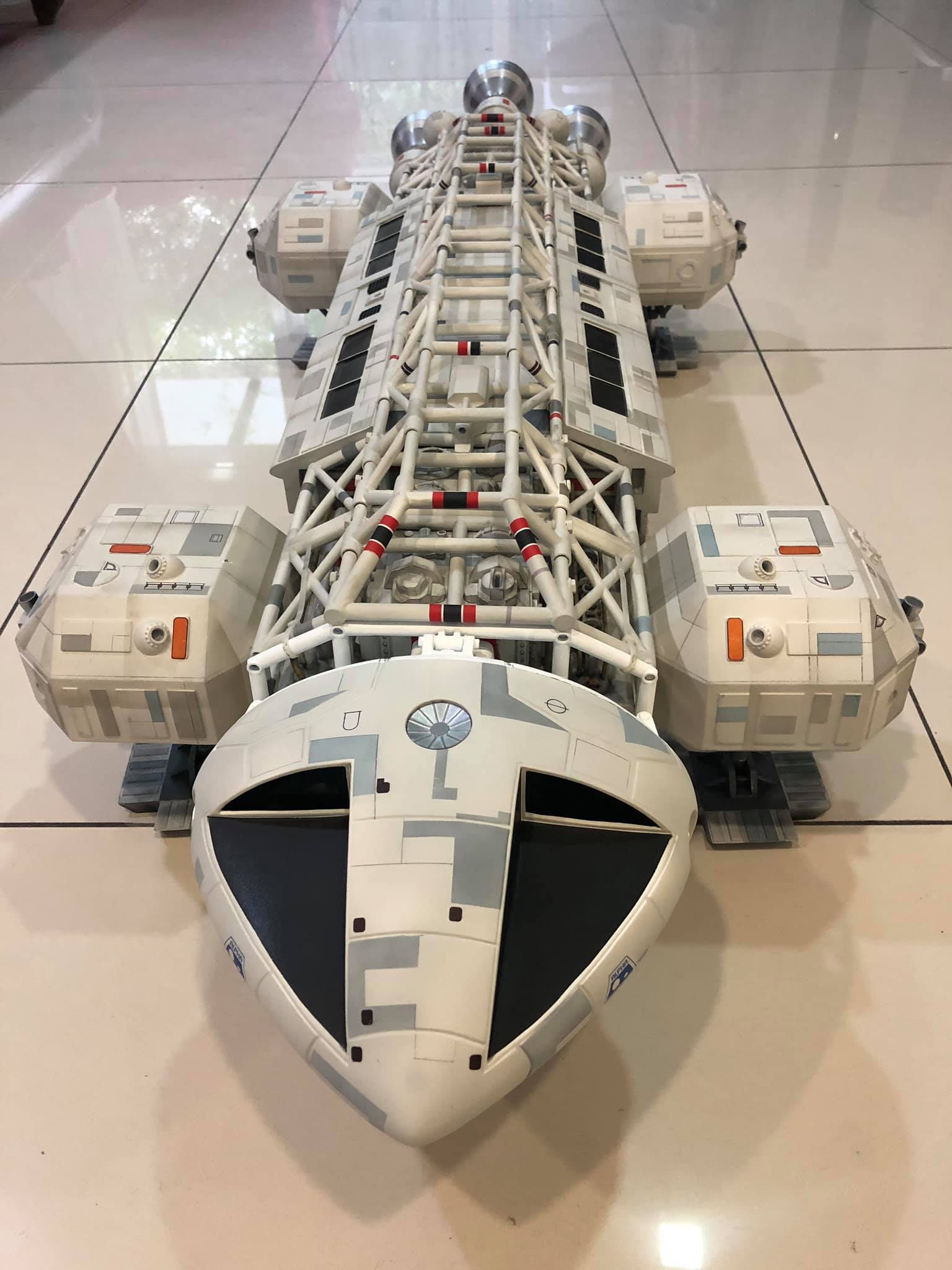

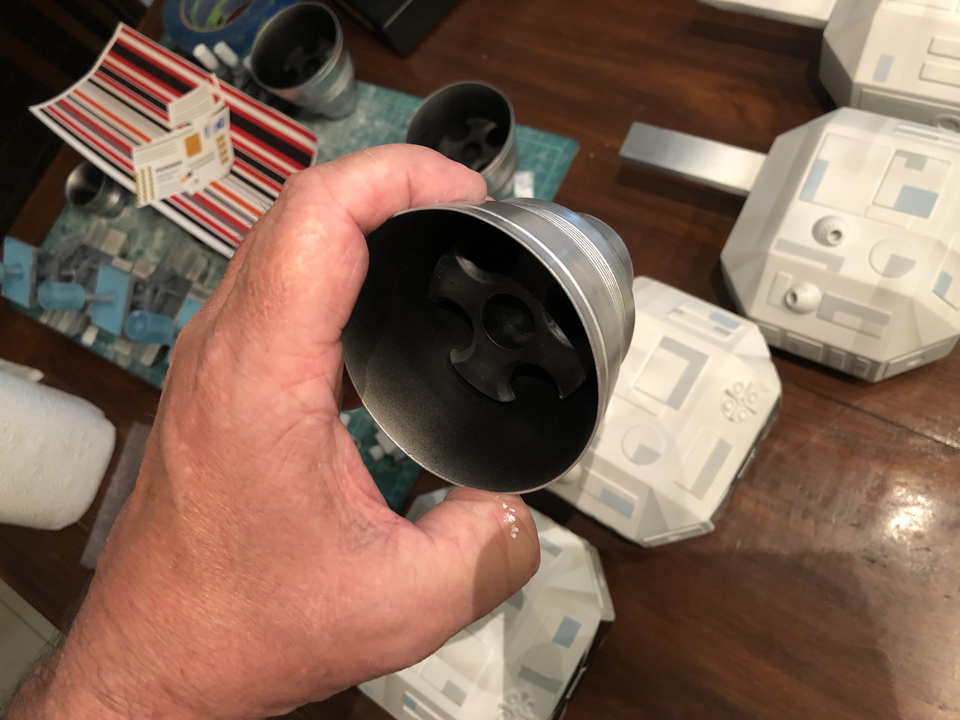

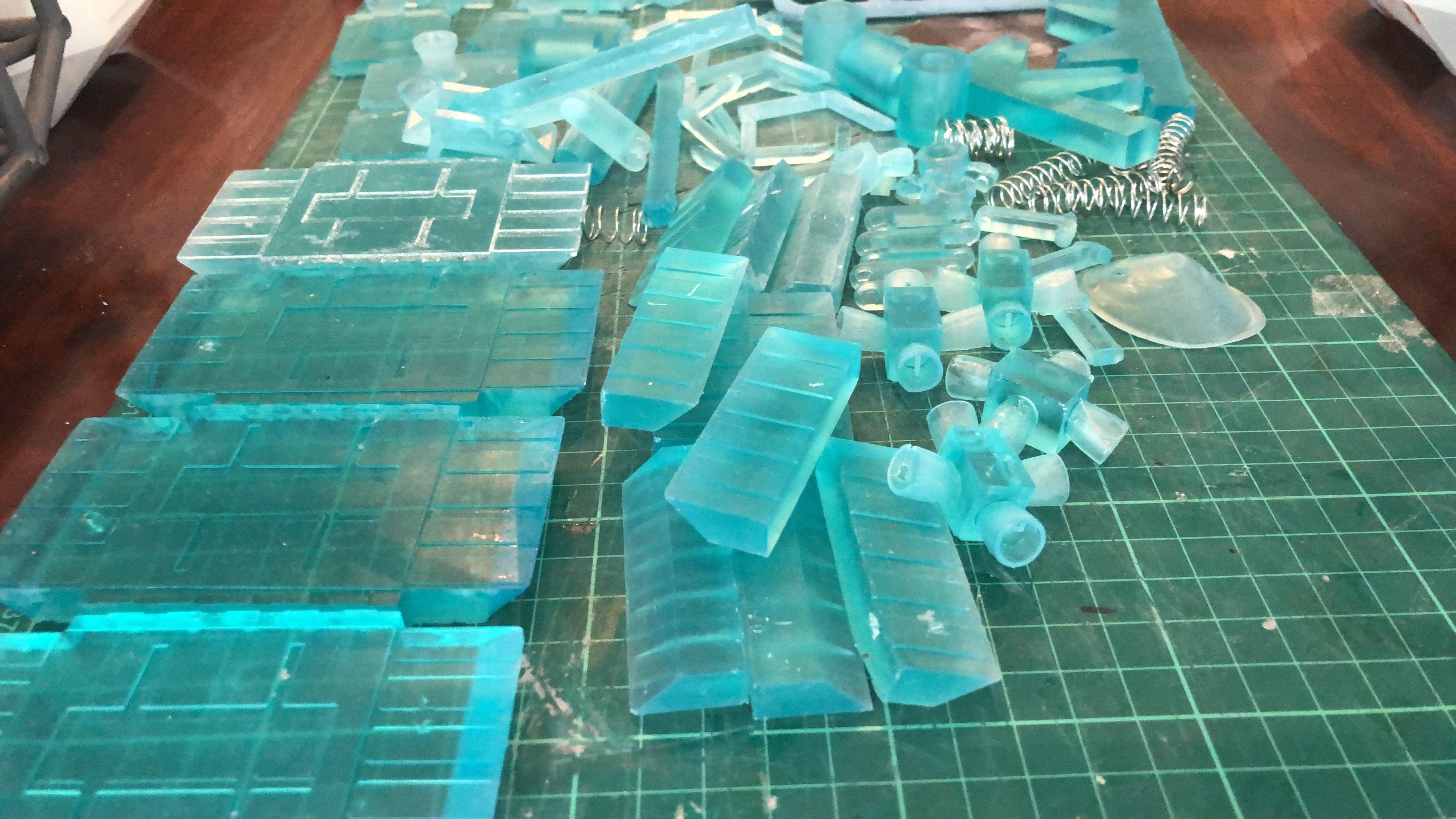

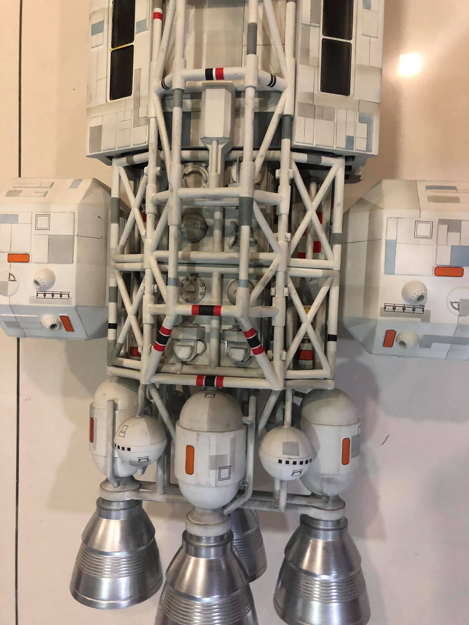

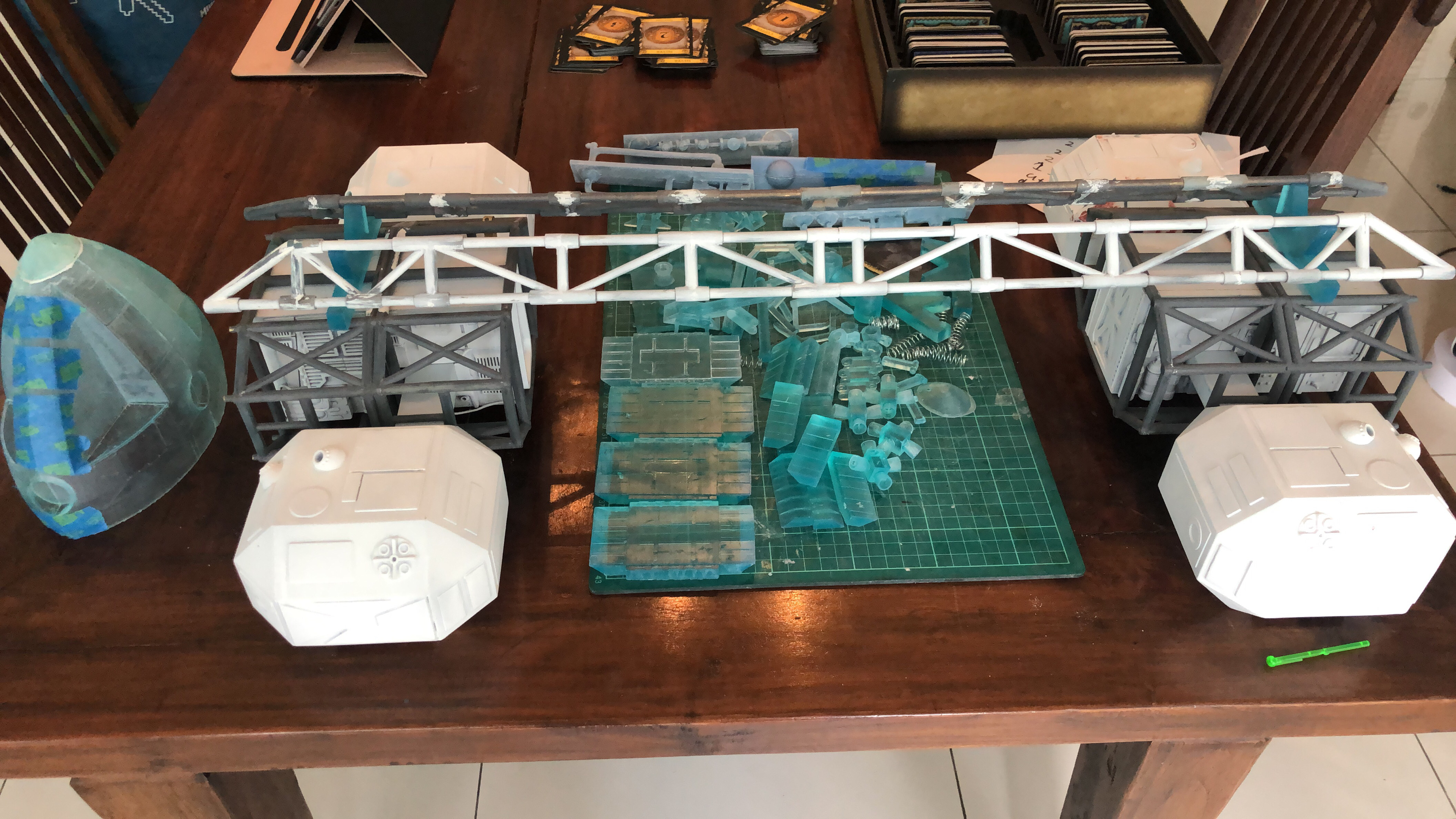

Just about finished by 44" Eagle from Space:1999. I'm waiting on a little more paint for last bit of cockpit, but pretty much finished.
Printed on Mars with Siraya Tech blu.
Uses Brass rods to support frame.
It weighs a LOT!
Files from CGtrader. I modified a bit in blender, and used a cockpit from a different model.
Sliced with Prusa to fit onto build plate.
Leg pods were about 9 pieces in the end. I discovered about half way through gluing using resin and UV light.
Definitely recommend this way of bonding and joining.
