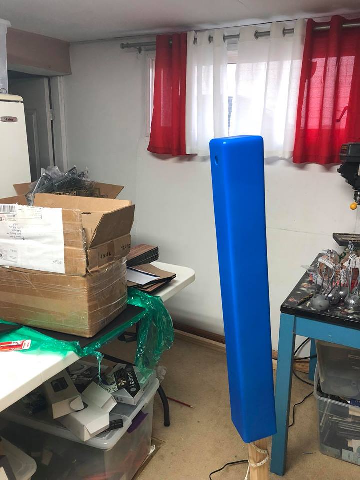

Damn, Jason, you have your own ILM now? Mount looks cool! Hey, did you happen to get my email?
Joe
Sent from my SM-G900V using Tapatalk
I don't think i did?
Yeah, Faux ILM East ;)
Wait - that pic is from the shop in Oregon where my friend is making those. I'm still toiling away in an East Coast basement built in 1925... lol.

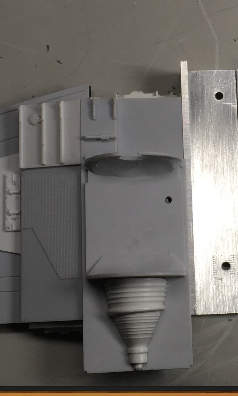

Another question... The metal armature looks like it is fastened to the wings via screws. How do we do this without damaging or cracking the resin? I know you have to pre-drill the holes but do they need to be tapped or can the screws be self tapping without damaging or cracking the resin?
With the V5, you only need to drill one hole - through the plate/wing as shown here:

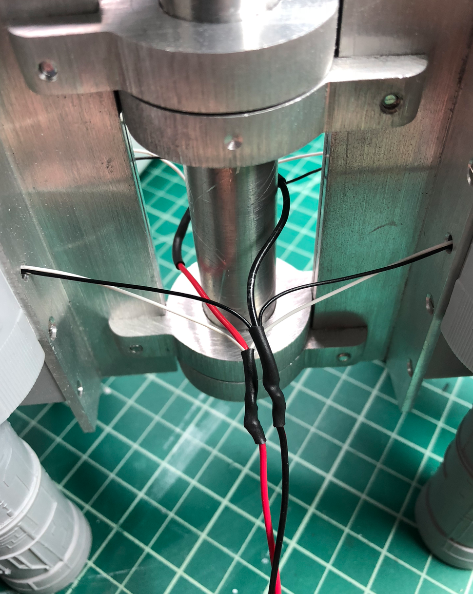

Wires go through the central hole in the L bracket, up and through the hole drilled, and back into the engine (which is hollow/accepts lights with a quick drilling)
For a bottom mount, wires can meet at the bottom - tie all four together:
AZIZ! LIGHT!
Yeah, if you pre-drill, the screws self-tap, and are pretty solidly in place when tightened down.
Without being the ‘Master of the Obvious’...I would glue the wing to the aluminum ‘L’ bracket first, then drill/screw it together to make it a strong unit.

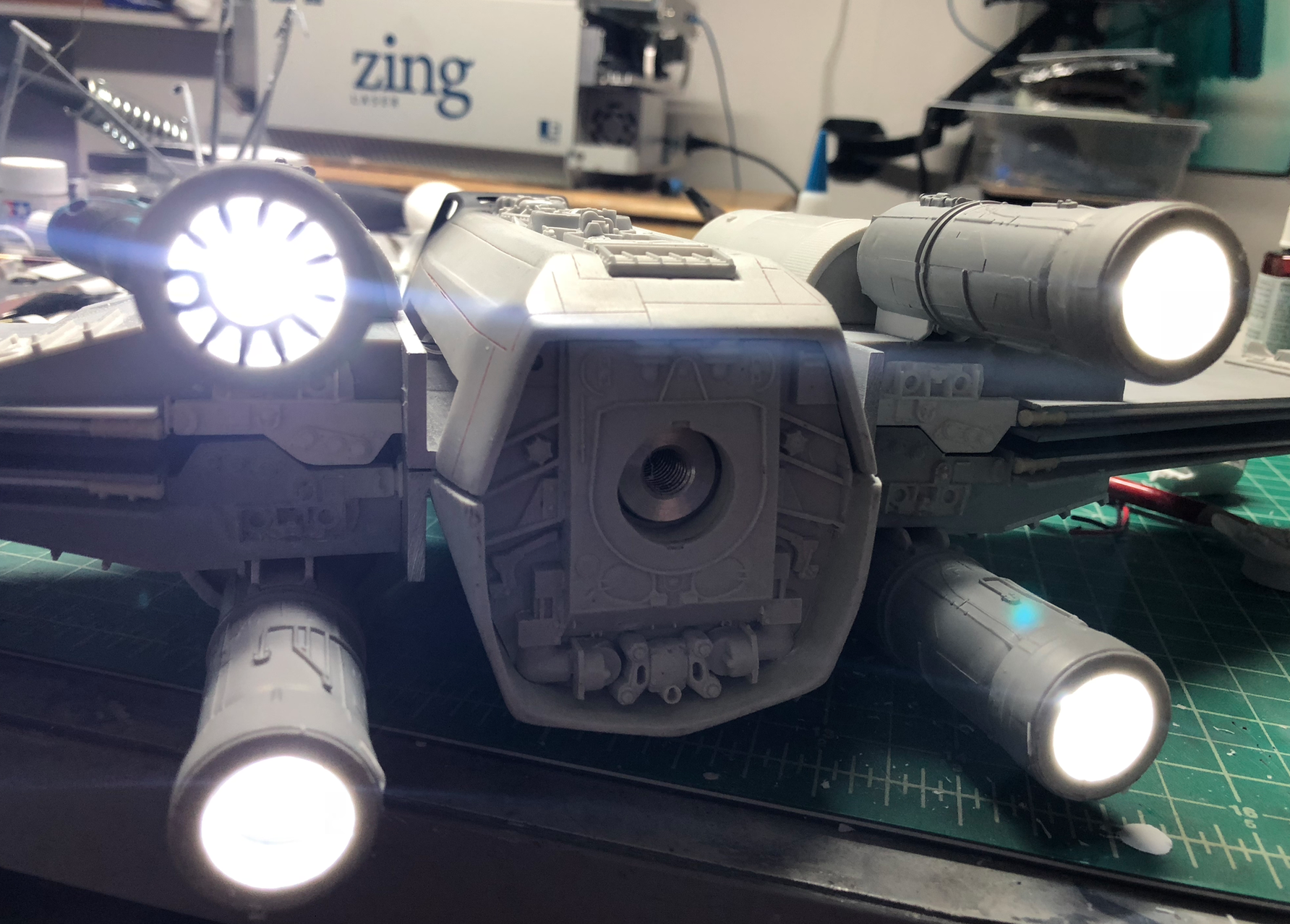

I got my replica pylons in the mail yesterday and initial test with leds look great!
