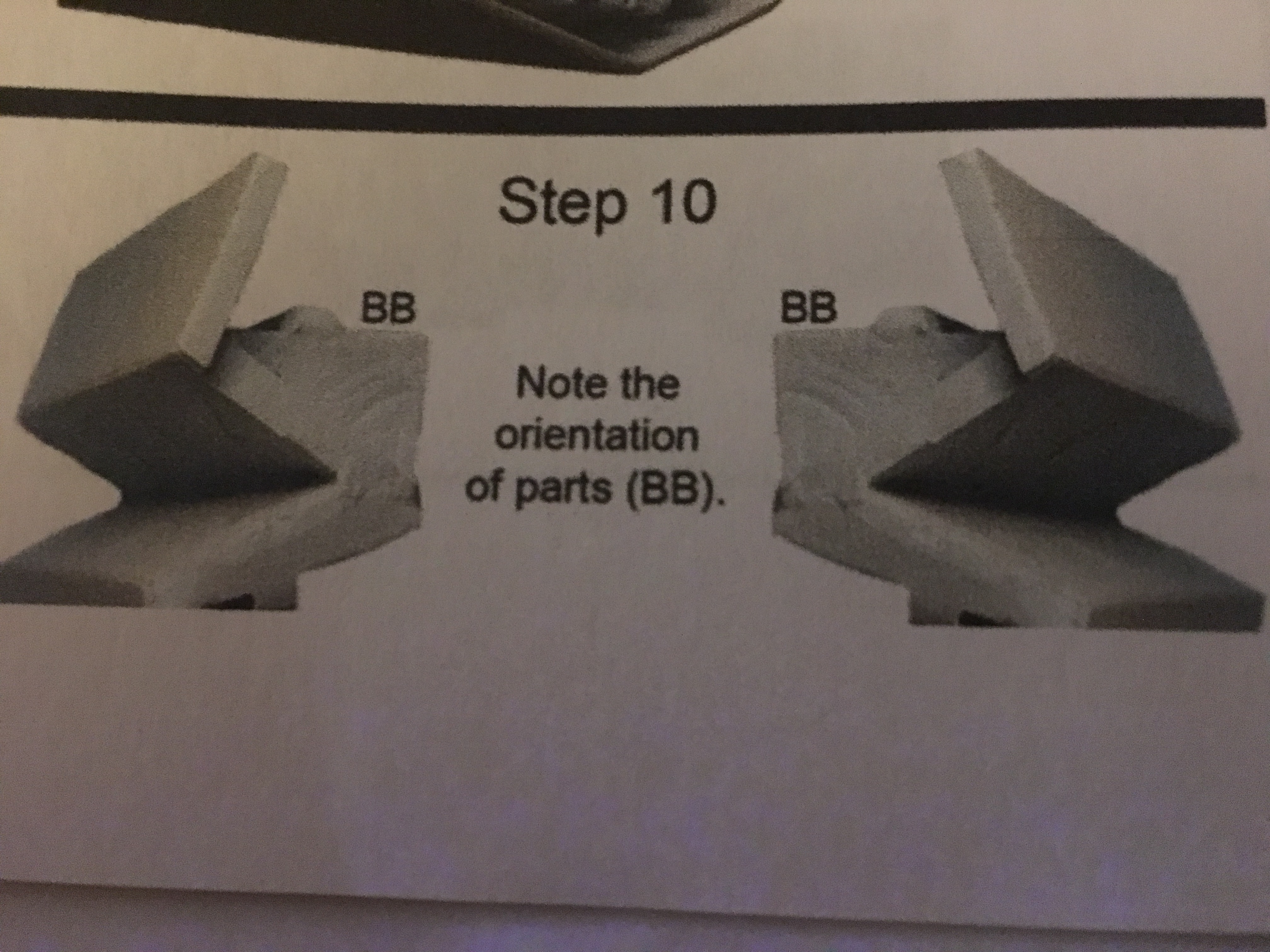

I have a pic of the V3 wing blocks from the excellent instruction manual written by dtssyst. I imagine the V5 blocks will be similar.
Extremely helpful, thank you.
So I take it that if one decides to go with the Reader armature, then the armature is used in lieu of these resin blocks? The wings themselves out of box will be the same either way?
Seems the logical approach.
Thanks for any insight.

Indeed, Mike offers both versions but when I asked him for a reason to choose one over the other I did not get a response back. Are there bulkheads inside of the fuselage that the rod passes through for added stability? Could somebody explain the reasoning behind the nose mount option and why anyone outside of ILM would want to mount that way?
Thanks in advance to anyone with insight to share.

I got added to the list for the metal armatures. So how exactly are the wings attached to the armatures? Can they be attached last to make it easier to paint the main body without the wings being in the way?
The wings will glue/screw to the armature. The angle brackets will unscrew from the mechanism for painting.

The instructions I have are for the V3. Totally different from the V5. They were written by dtssyst, and are posted somewhere on the site .
Once the wings are in place I can't see how a screwdriver can fit in to screw the brackets in place. is there any images/videos/instructions anywhere you can point me to? Thanks!
