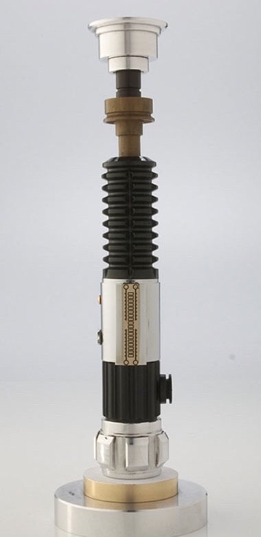

General question about the original Obi props used in ROTS: I've heard some Obi hilts had a cast and chrome plated control box, but machined emitters and pommels. On the other hand, I've also heard some hilts had a machined emitter but cast and chrome plated control boxes and pommels. If both of these are true statements, do we have any insider knowledge or evidence as to what combination of parts Ewan's belt hanger hilt had?
View attachment 1548112View attachment 1548113
In both of these pictures, the emitter and pommel are aluminum and the control box is plated resin.

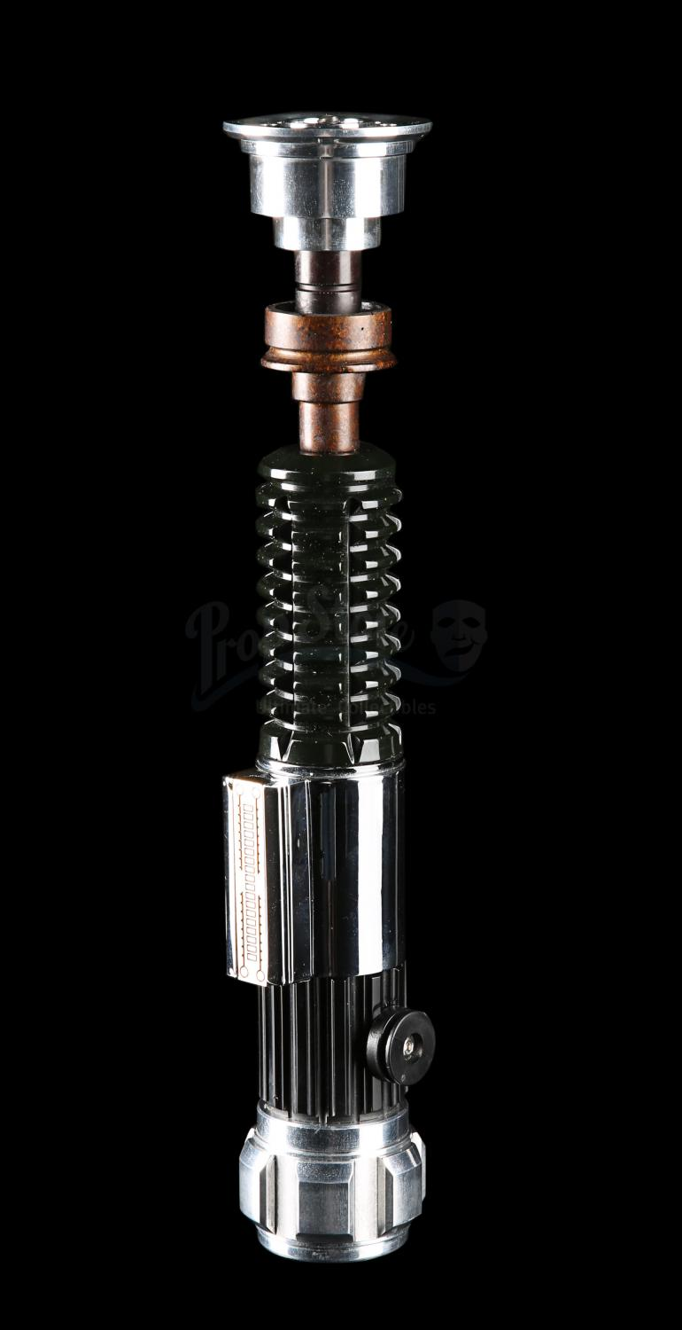

Thought I’d drop this here if no one has seen it yet; looks like a new ROTS hero belt hanger went up for auction. The description on the auction lists the materials used in the construction of the hilt which I thought was a pretty neat insight. I’ve included the description from the site below for convenience.
“This hero hilt was made early on in production and therefore incorporates metal components; later in production additional hilts were needed, and they were all plastic-cast components in order to be produced as fast as possible. The metal elements on this lightsaber include the end pommel, the detail greeblies near the control box, the full neck vane assembly including the gold-colored component above the grip, the thin copper-colored section, and the aluminum base below the emitter. The black ridged section above the pommel, the control box section,the ridged black handgrip and the emitter are cast plastic, with some components chrome-plated. Also included is an original belt clip. The lightsaber shows slight wear throughout from production use and age. Dimensions: 11" x 3" x 3" (28 cm x 7.75 cm x 7.75 cm)”

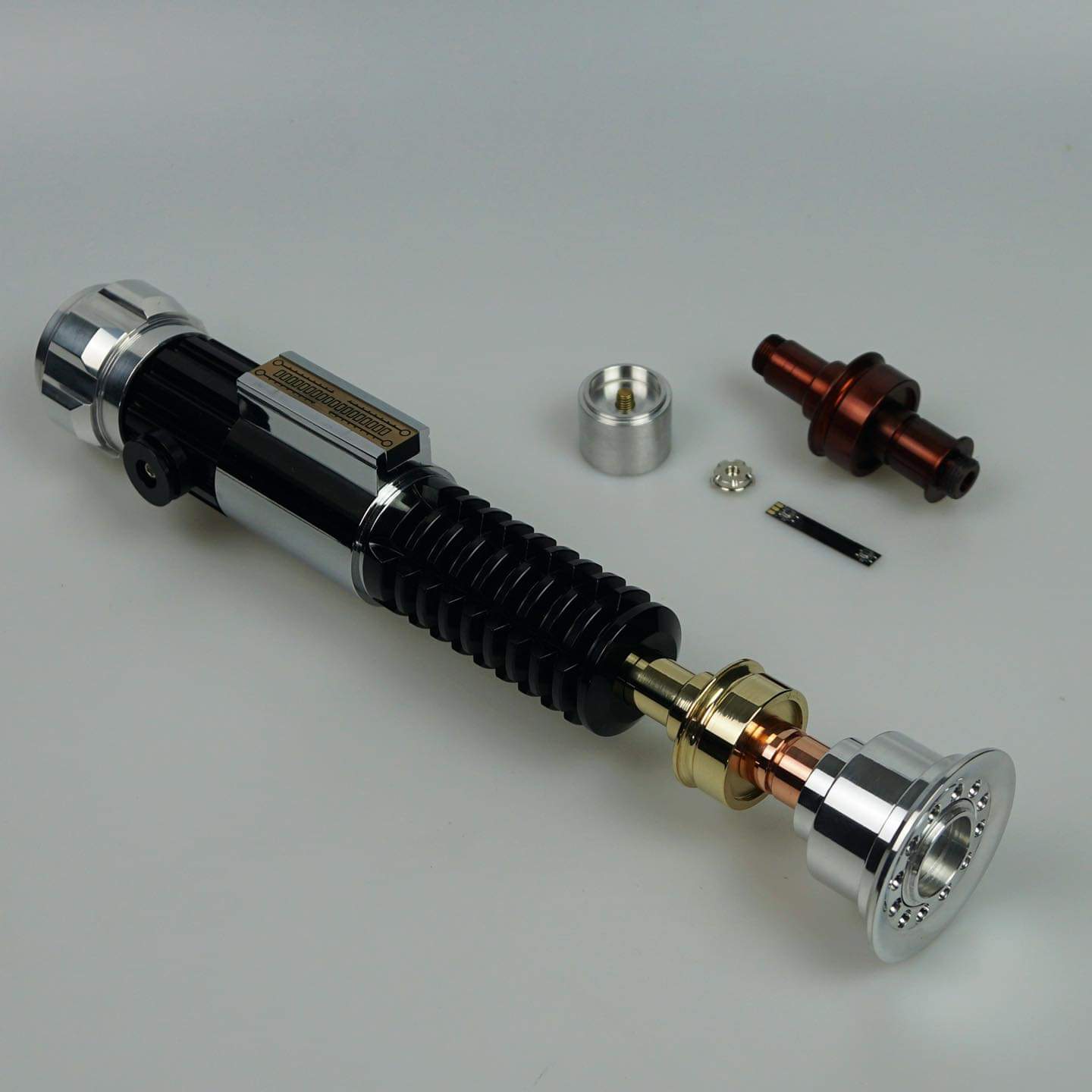

I don't have a reference pic for the KR Eco OWK3 (store is closed rn due to Celebration) but it seems that he was able to match the all-brass top face of the wind vane section (originally an "eco" design choice I would assume) before this prop was ever available haha:

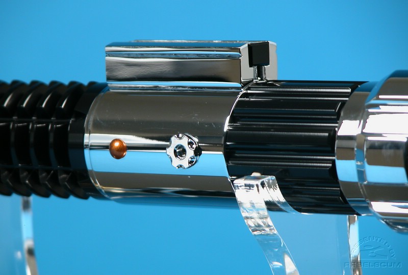

Looks like the control box is flipped on this auction hilt as well, the cylindrical groove under the black endcap on the box is on the booster end on the MR LE:
