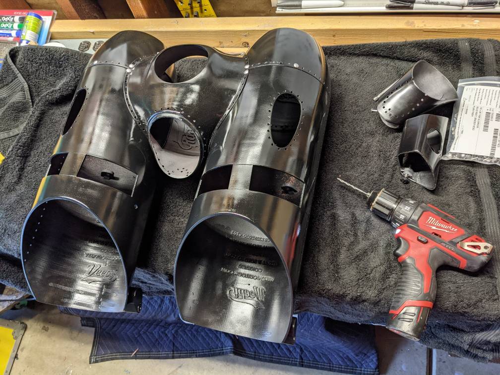

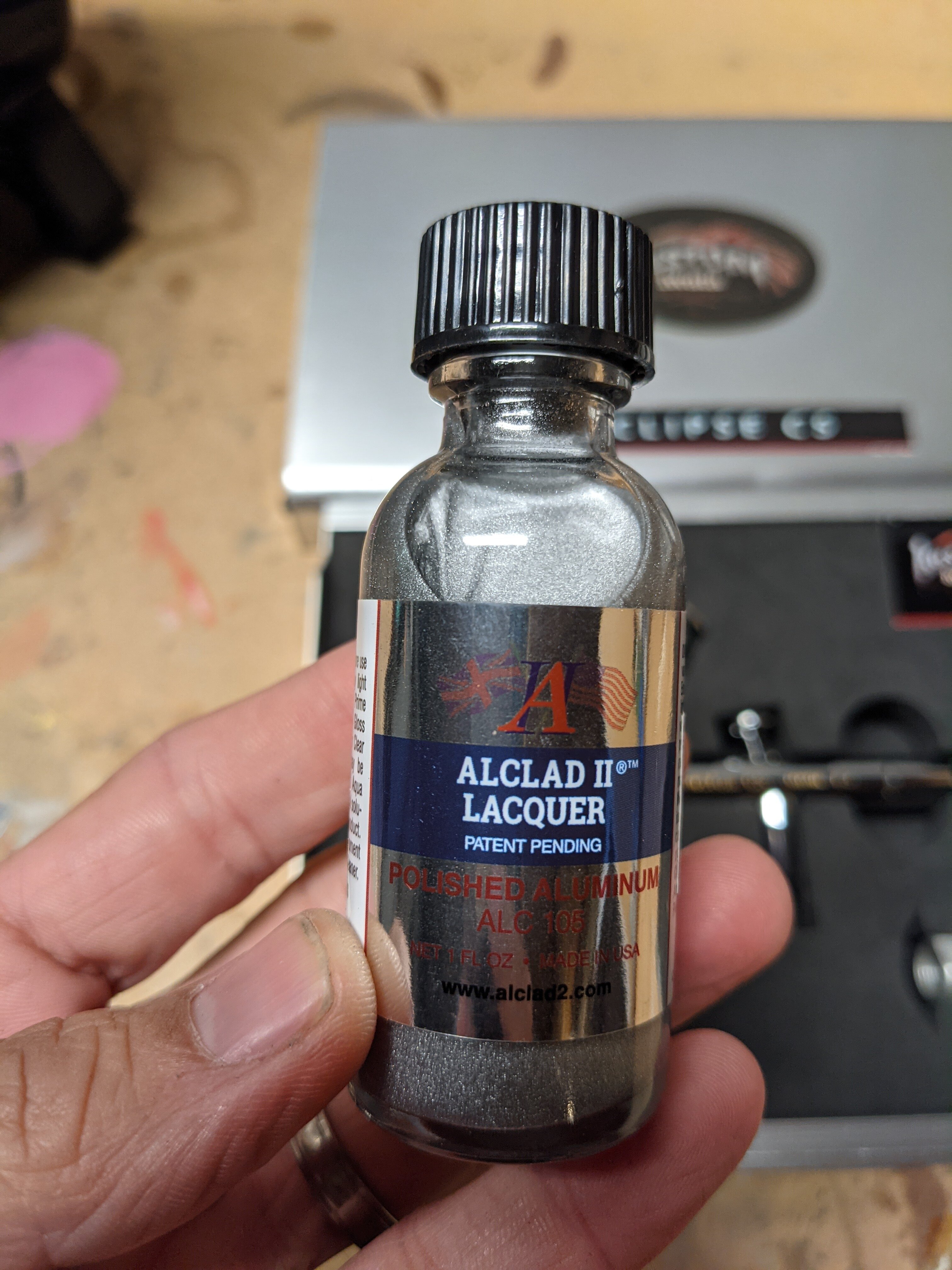

Also I'm back to square one with painting. I did not like the the way the alclad came out on the tanks. It was hard to get an even coat and one bottle didn't finish one tank!

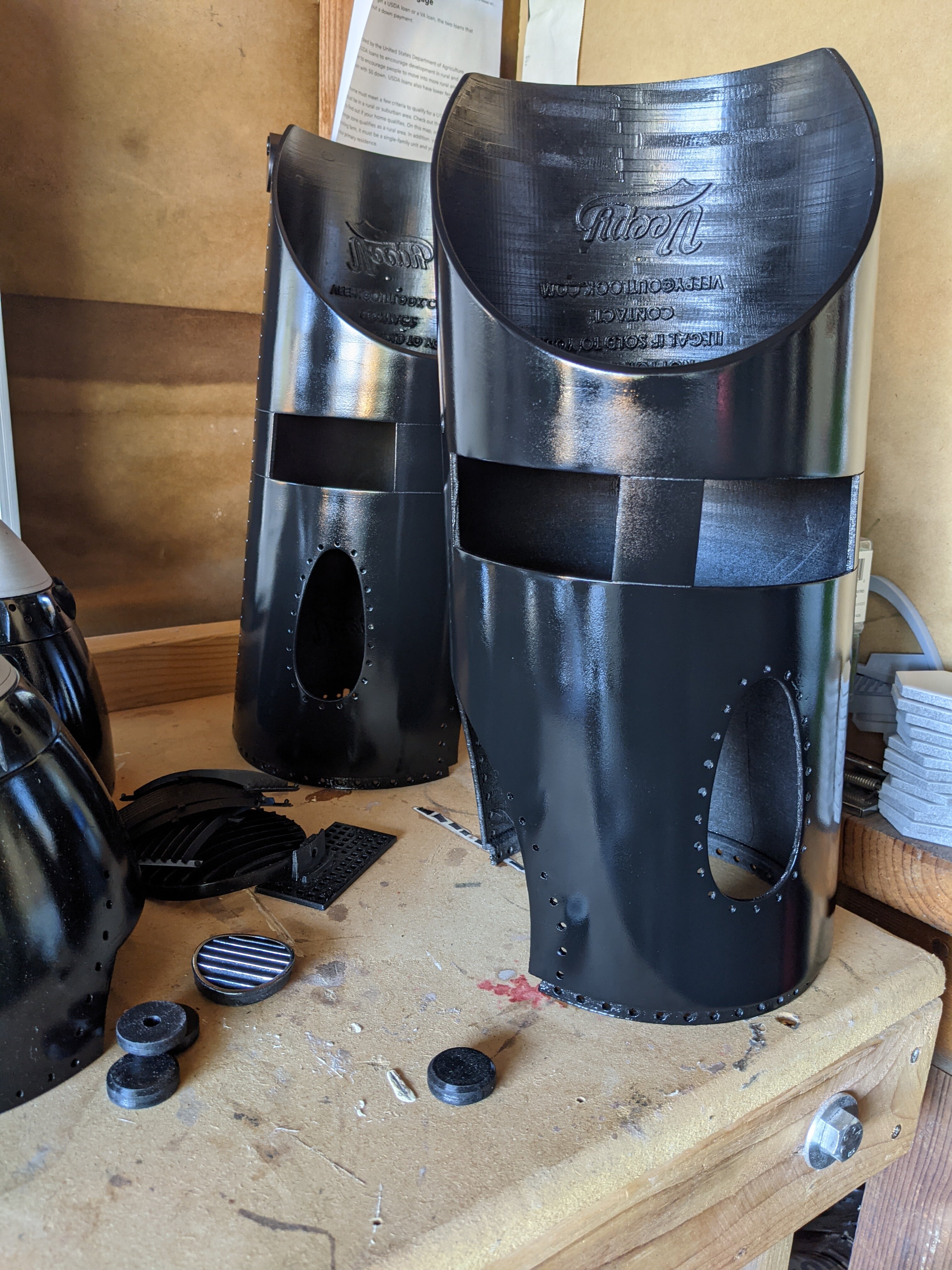

I've moved on to another process so had to sand everything down and repaint black.
This looks so nice black! Hmmm black rocket??? Nah! Has to be movie accurate, but I bet it would look clean all in back.
Well I'm waiting on new paint to arrive and then I try the new method. This has to be perfect, I can't settle for second rate.

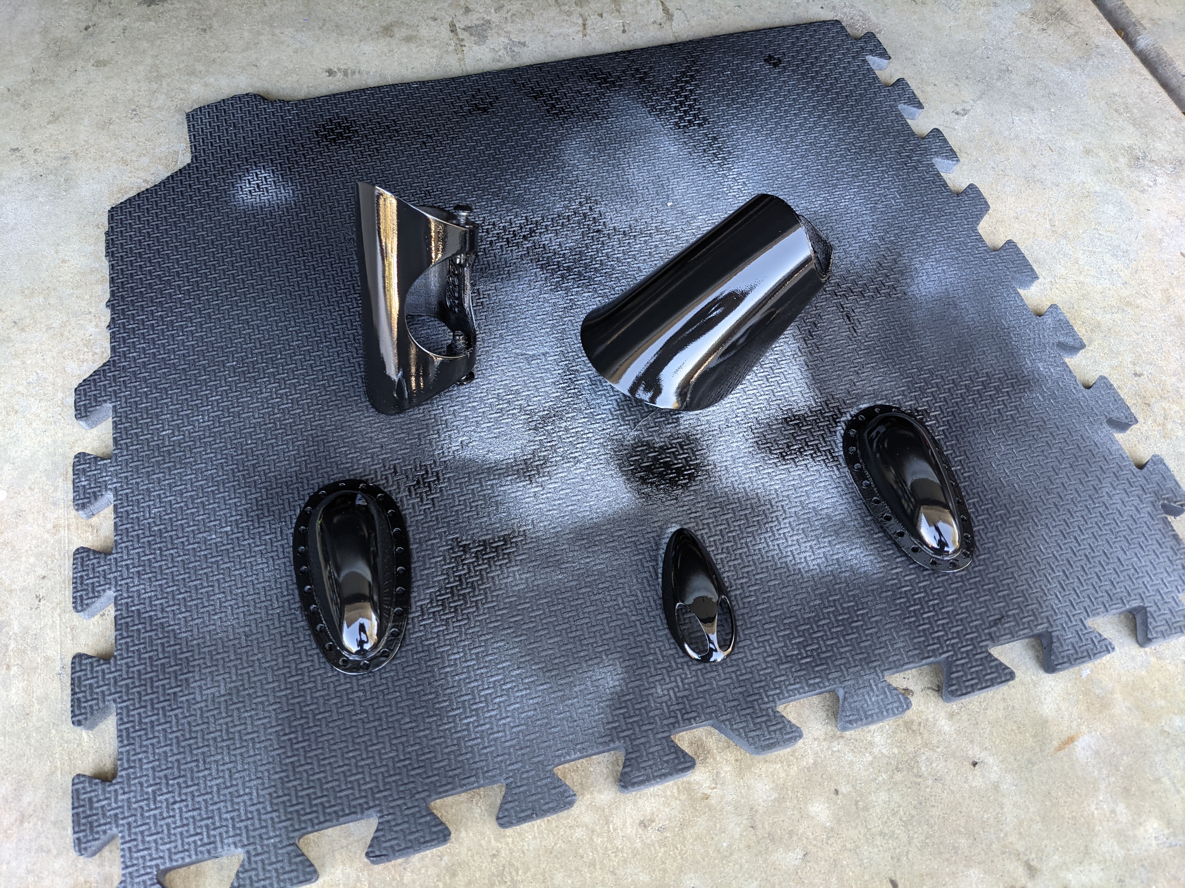

All but the tanks have 3 coats of black gloss. I'll have the 3rd on the tanks before the chrome arrives. I'll probably message you once the start to make sure its right.

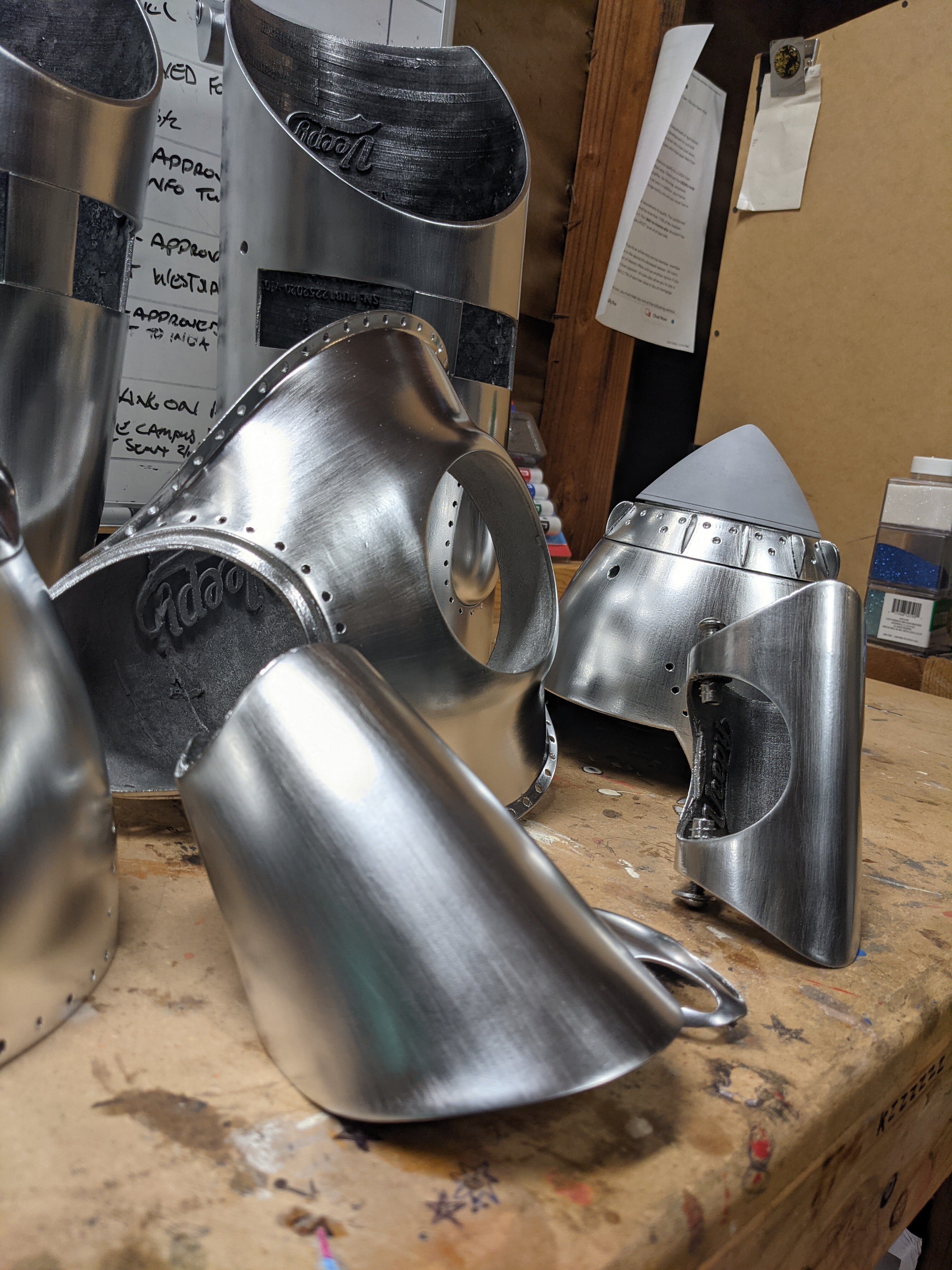

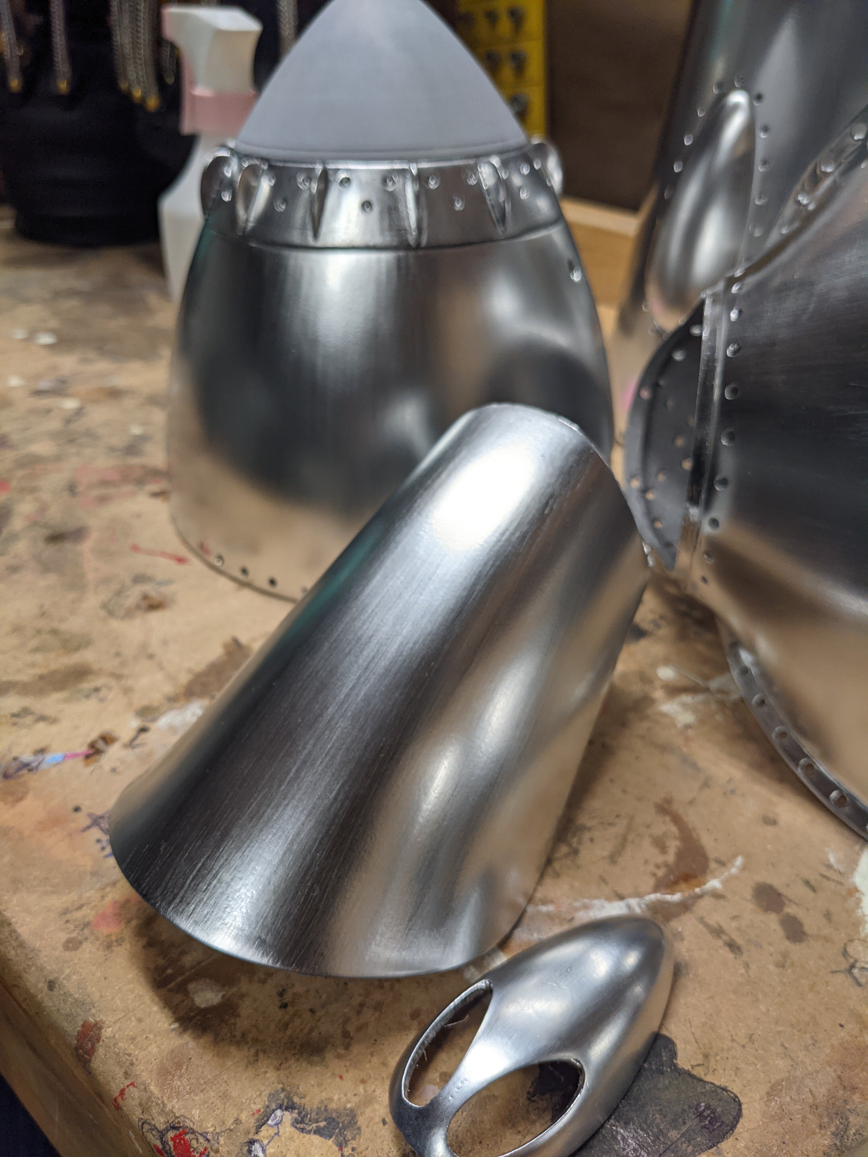

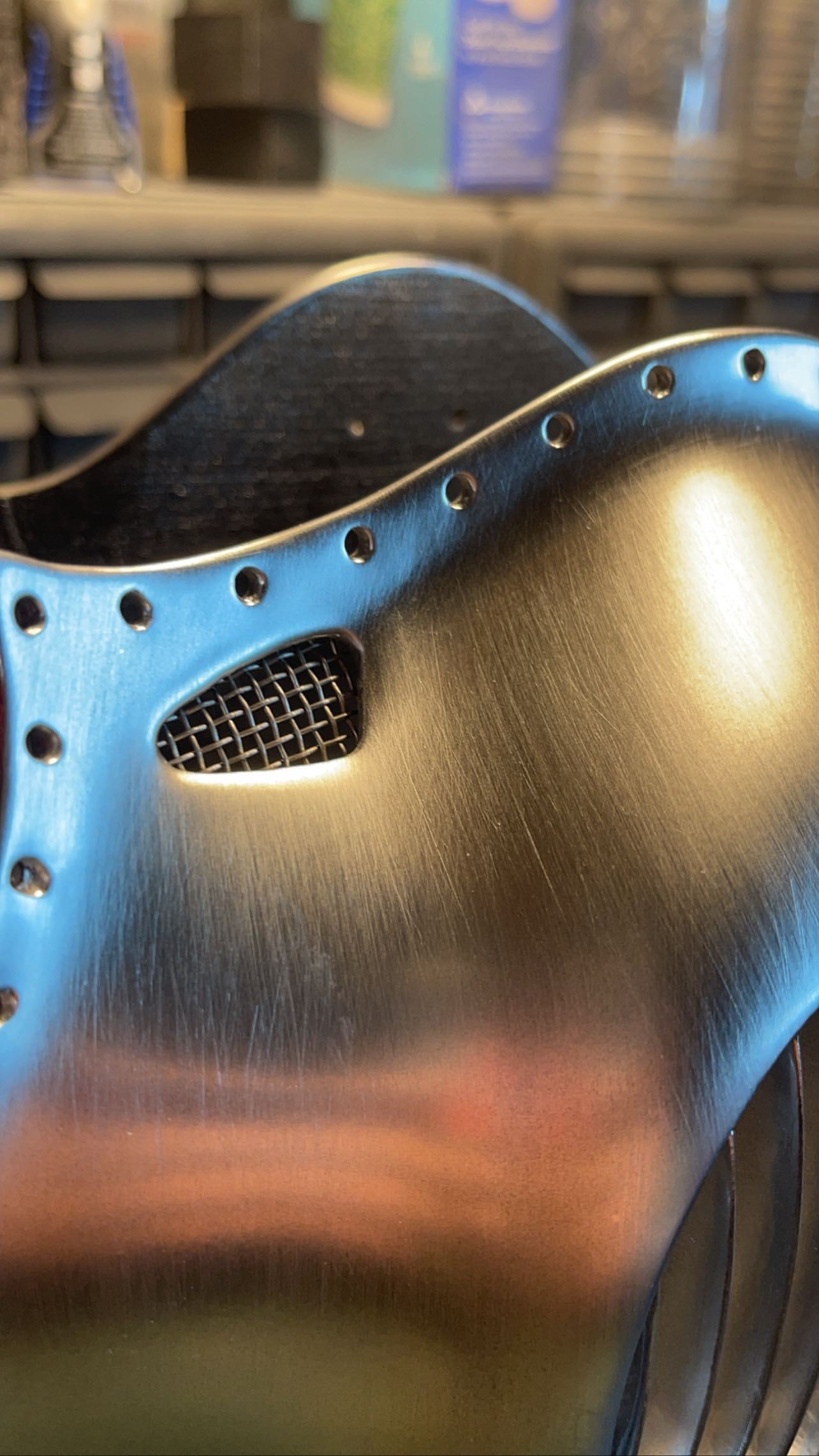

Huge success today, thanks to Hurd Drafting L for explaining how to get this awesome paint job!!
Here's how it's done:
High gloss black

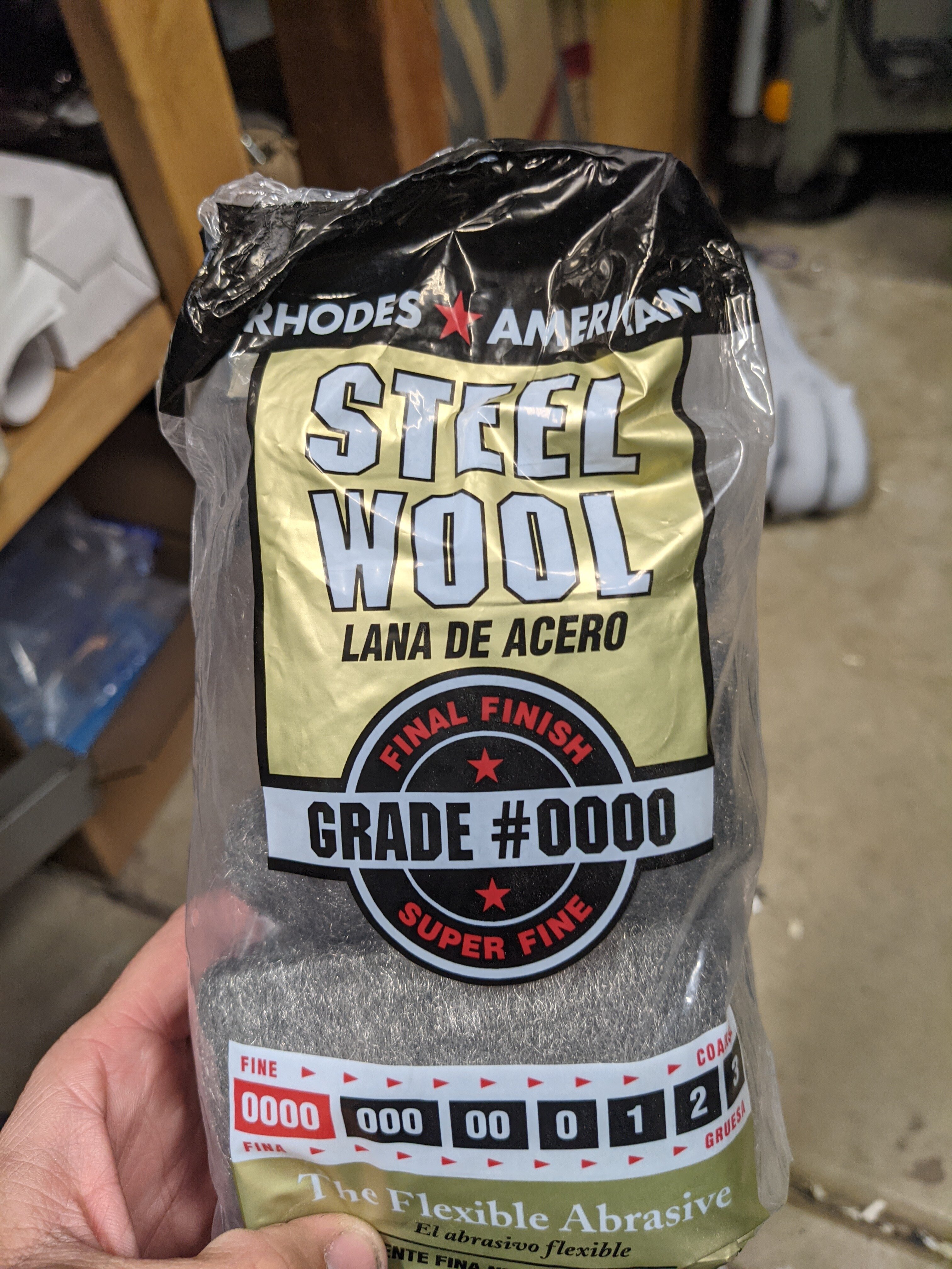

Scuff evenly and all in the same direction with 0000 steel wool
2 light coats of Spaz Stix ultimate chrome
Buff with a t-shirt.

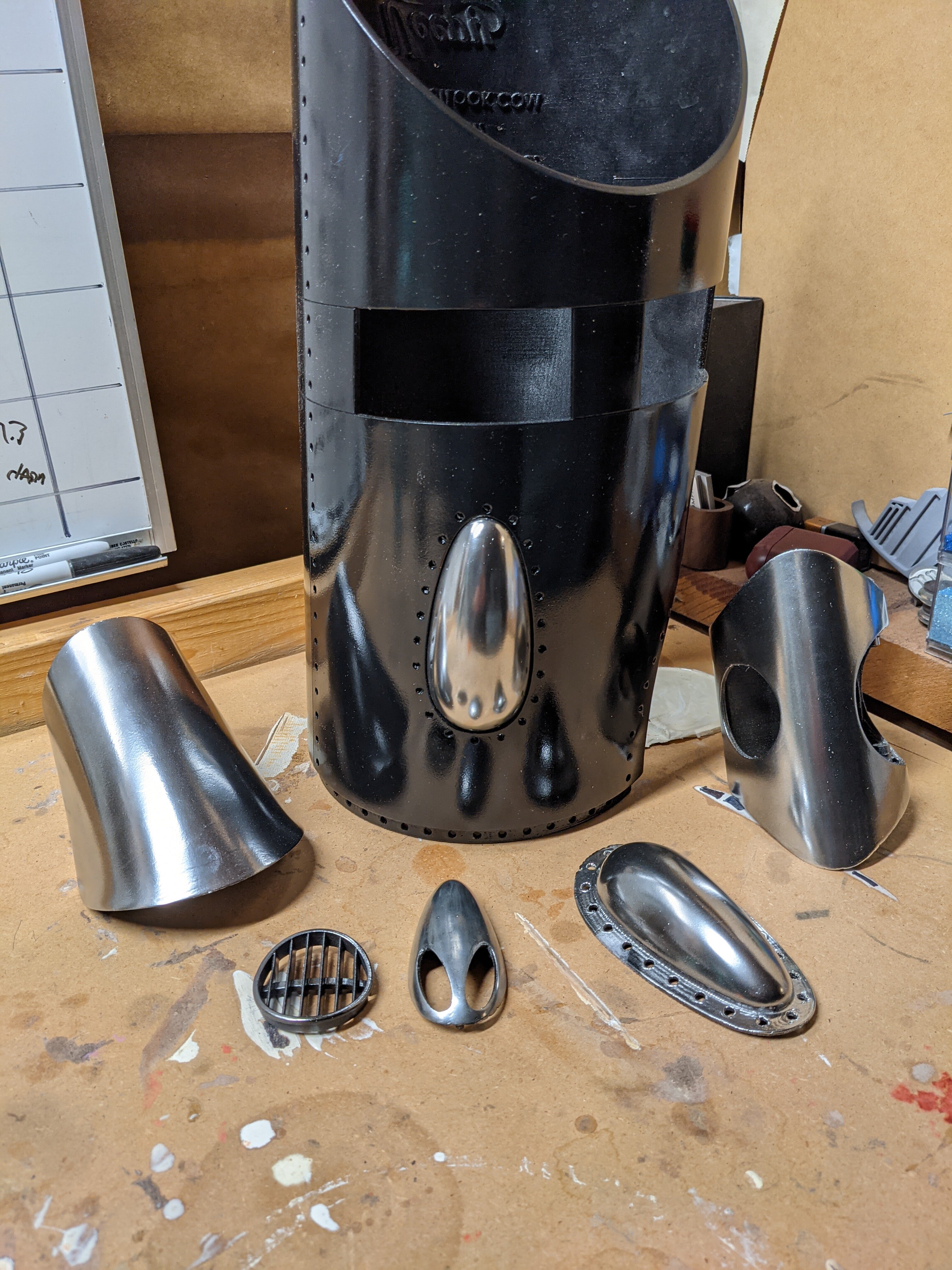

And poof! A fantastic paint job! I will be adding a clear coat next. There is a specific clear coat for spaz stix that I will be ordering. I went through 3 cans of the chrome and didn't have enough for everything. Just have the small vents, flaps, and radiator left. So 4 cans should do the trick to get 2 coats on everything.
I will update when I get more paint and the clear coat on.
gnolivos
Look fantastic. !!
Do NOT clear coat it!!! I heard even with the specific clear coat from spaz stix it can ruin the finish
Or test on a scrap piece first!!!!
