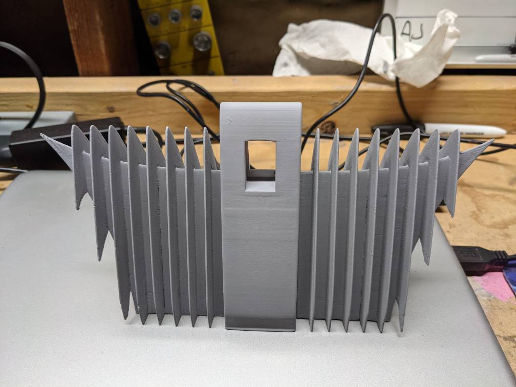

I've made some progress. I sanded, puttied, and primed the hull. It will need a little more work as I still see some print lines. I was able to get the radiator sanded, puttied, and primed as well. But it still need slot of work. I see far too many lines. I finished all the small parts they are ready for paint. I've worked on tht cones a little, I made the edge a little more square so the top cone fits better and the gap is more even (this was due to printing not the model).

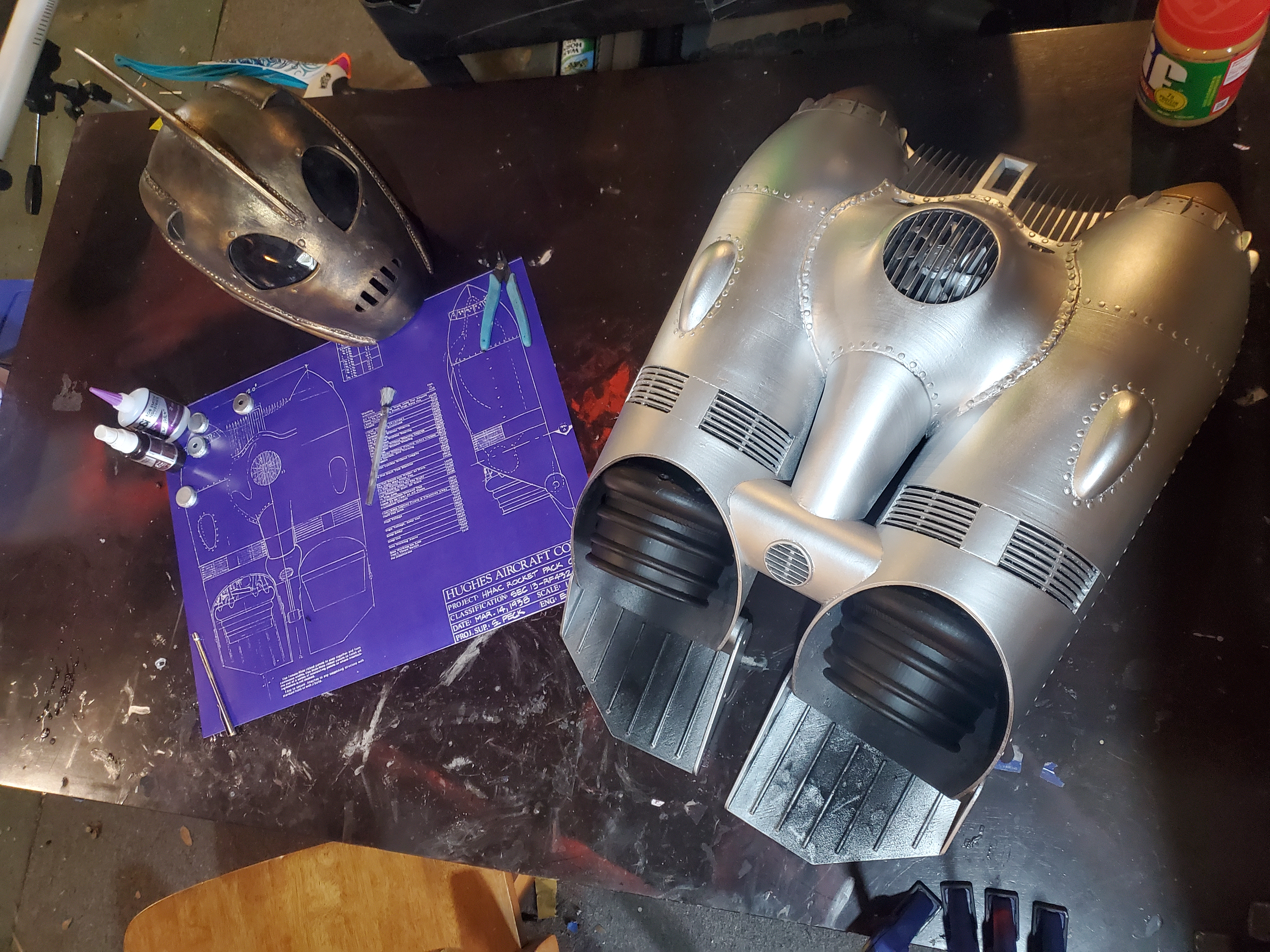

I was really impressed with how the rust-oleum aluminum enamel paint laid down. It came out very clean with excellent paint coverage and close to screen accurate color without dropping 100 dollars on paint. Also your finishing work is much better than mine so it should be even better for you. I still need to add the wires and drop the exhaust. Also the attached blue print is an exact copy of the screen used and prints great at 16x20 as you can see from the pic.

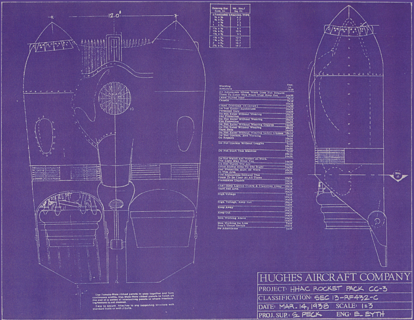

I'll have to get a can and do come test samples. Also where did you get the blueprint? Is the one you linked printable at that size?
Madness
It will print 16x20 and still looks pretty damn good with minimal loss. It's a copy of the orignal I found a poor photo online then I took a photo with my digital camera and cleaned it up a bit to make it printable at what appears to be the size from the film..

Yep! I was waiting for the engine parts to come in. I installed all the lines, nuts, and rings. I ran out of braided line so I only did the fronts for now. I also got the hull 98% done, still has a few imperfections Im going to fix. The radiator has been taking some time, its about 80% done. I need to give it one more round of spot putty and sanding then is should be done. The cones are 99% done, taking these pictures I just saw a few more spots that need to be fixed.
