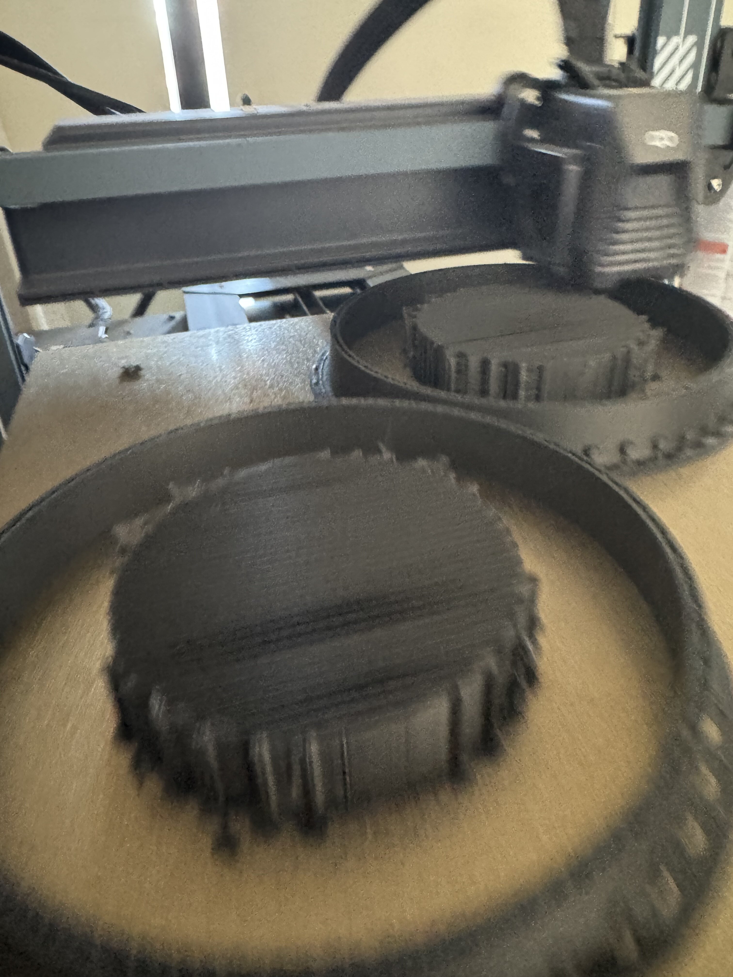

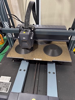

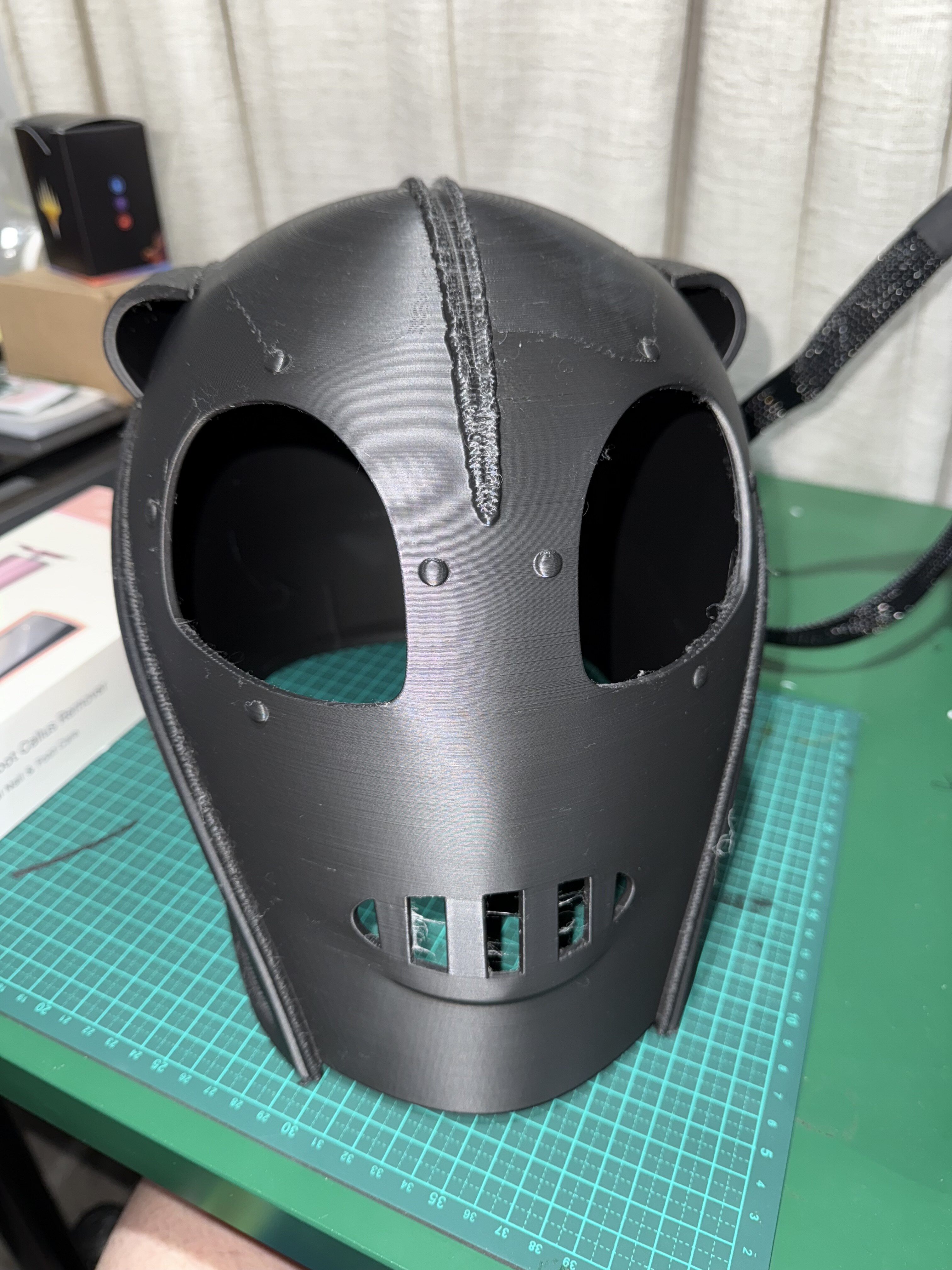

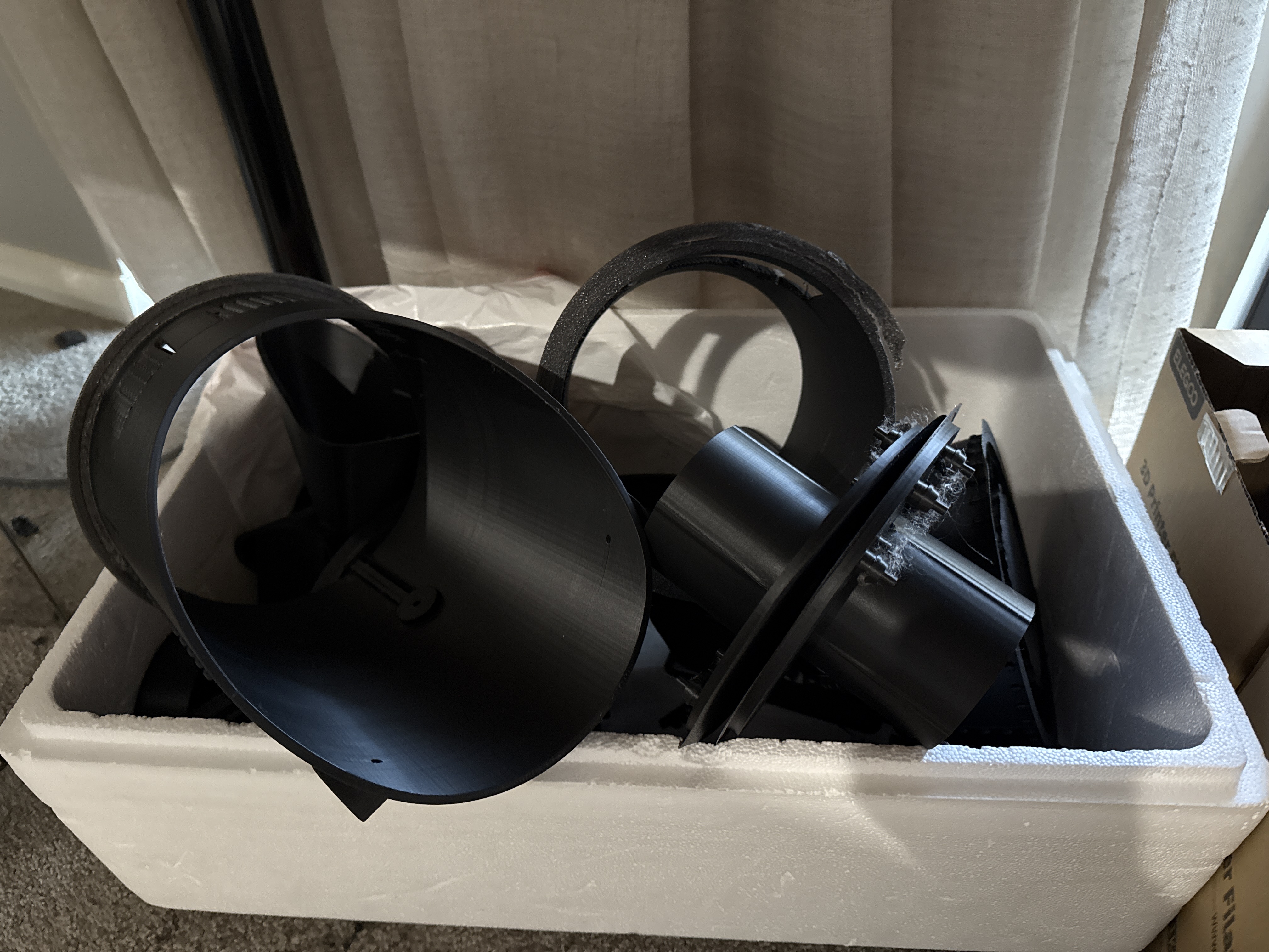

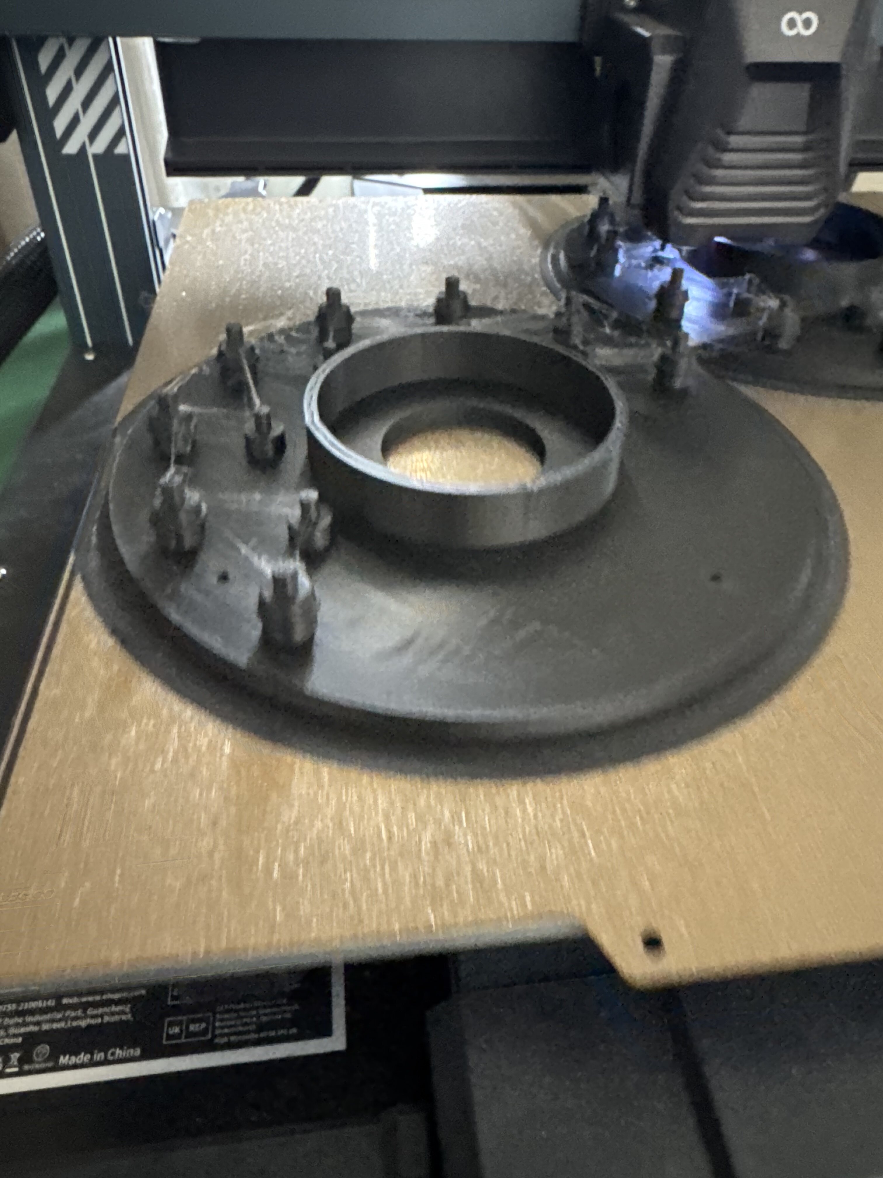

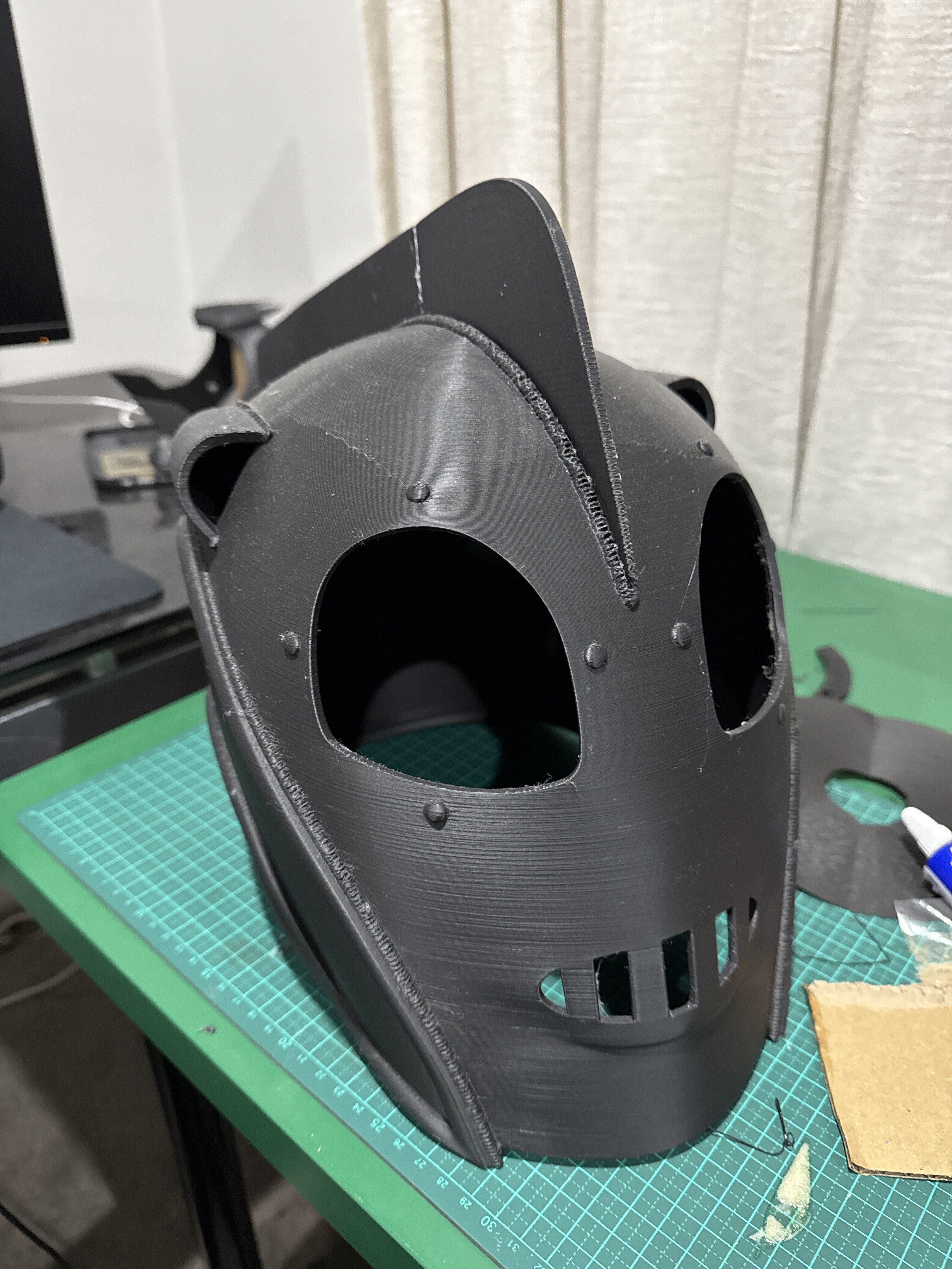

So for my first real self made cosplay outside of a vault suit I’ve decided to do a Rocketeer. Helmet and rocket pack are going to be printed, have spent the last week and a bit printing parts for the rocket on an off.
The jacket is going to be the South Beach Leather one and I’m racking my brain trying to figure out how the hell im gonna mount the rocket, any harness recommendations?
Or any advice on painting one of these?
I very much unederestimated the amount of parts this thing would be. Still got 3 build plates to go. Thankfully the Drokle files on thingiverse are made well

Since you printed in black, coat with black pigment in XTC 3D, then sand it down super smooth and spray it with a chrome spray pantt to get that metal, slightly reflective look.
