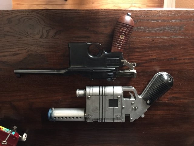

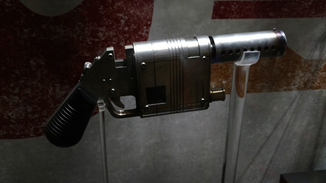

I took this pic last weekend at Hollywood Studios. I agree the grips look backwards, especially next to my toy Mauser from the 70's. The top of the grip on that gun is horizontal. It looks like the action figure Rey gun above and the model in California are the same,as this model so the real prop must be that way.
https://www.instagram.com/p/BAaK_70mAuQ/?taken-by=zxkuqyb
Here is the same pic without the Instagram filter and my 3-D print.

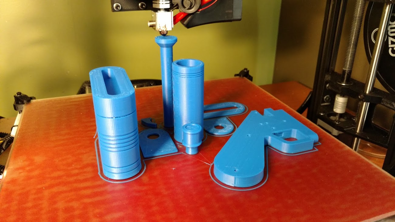

Just finished my Rey Blaster. It is 3d printed on my Robo3d R1. I started with what I thought were the best parts of each of Lilykill and Greggo's models (available on thingiverse.com). Mixed, Matched, Remixed, and added some parts of my own. The main frame is three parts with a working trigger. I used 6-32 and 8-32 button head tamper proof torx machine screws as well as a couple of 3mm cap screws. I still think that it is a little too big and I really want to remodel the grips to be more broomhandle accurate. Let me know what you think. Here are a couple of dimension:
1. Diameter of Barrel - 33mm
2. Total Length - 310mm
3. Frame Width - 13mm (Center 7m, each side 3mm)
4. Body Width - 35mm

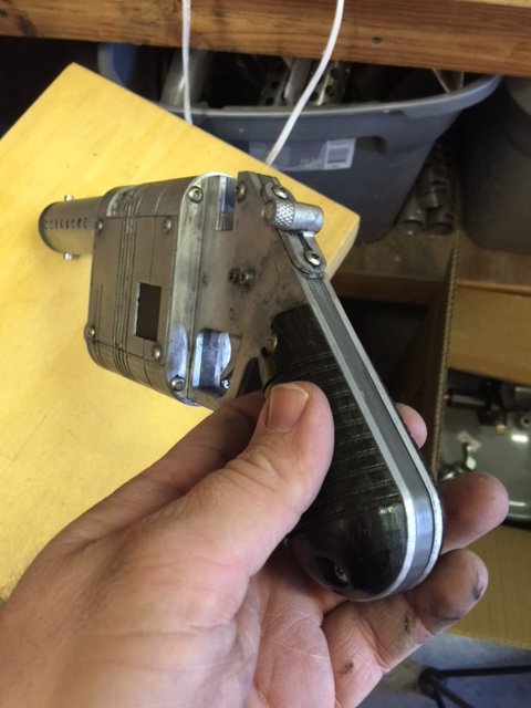

Alright, here's my print in Proto Pasta Stainless Steel PLA. Printed on a Taz 5 at .1mm
The main body has been sanded a little to bring out some shine, and all the other pieces are straight from the printer. This stuff looks fantastic right off the bed as far as print lines go. Once I get everything sanded and polished I'll report back on how well it takes to shining.
Denix grips just for the look. I'll be printing the actual grips in some wood filament
You can see a slight shine on the body just from sanding, so I'm hoping steel wool and polishing compound will bring out the rest
