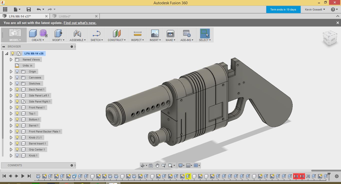

So, I downloaded both models (Lilykill and Greggo) from thingiverse. Both models are very well done in my opinion and a super big thanks goes out to both of them for sharing!
I don't suppose your finished adaptation of these two is available to download ?

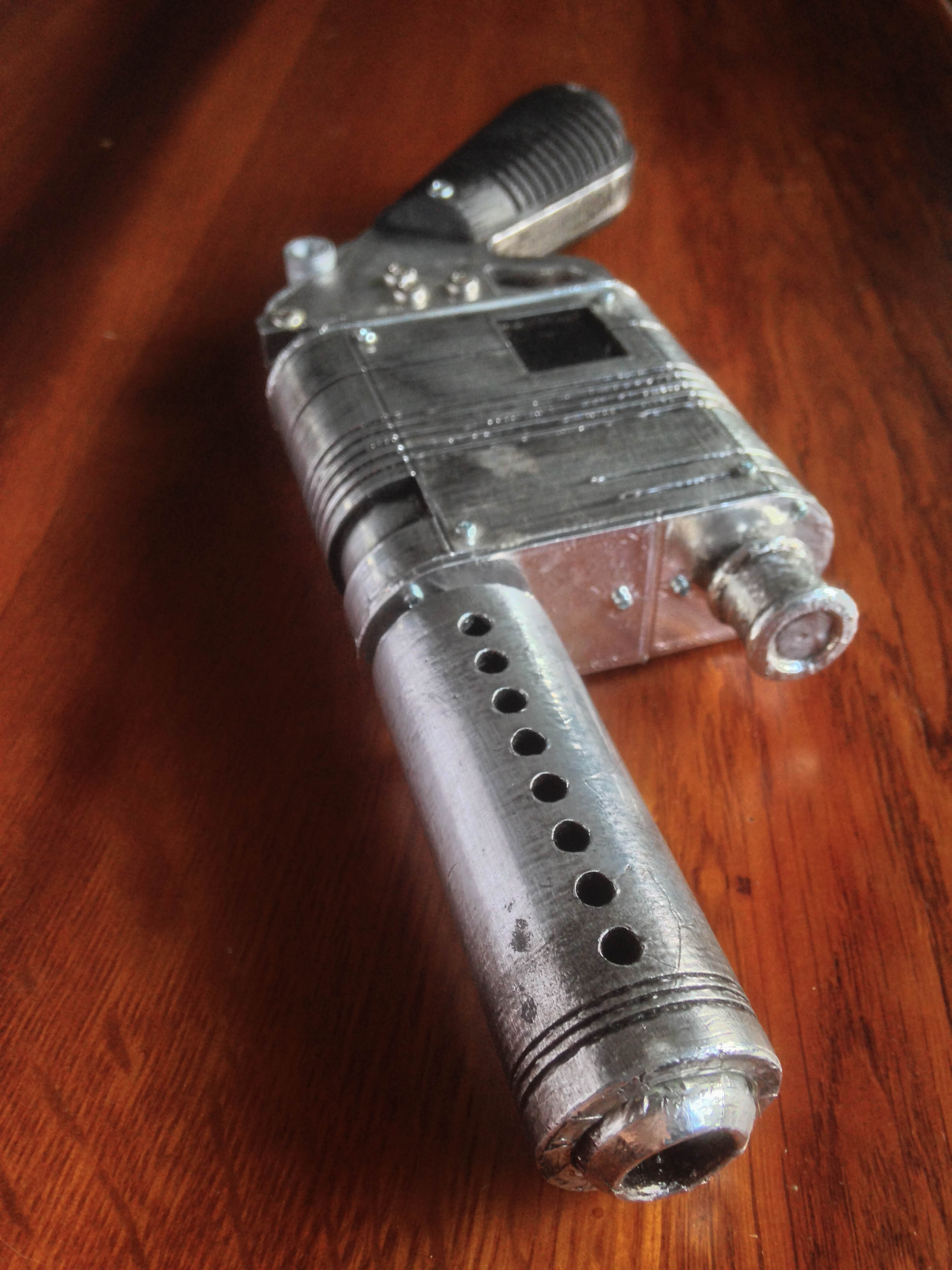

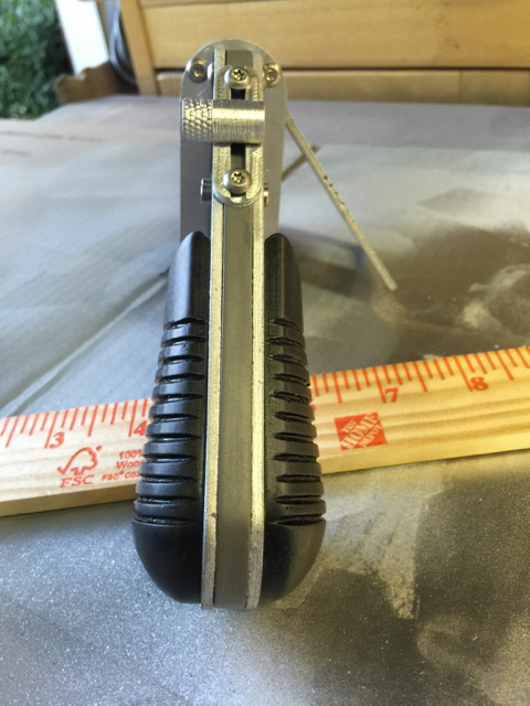

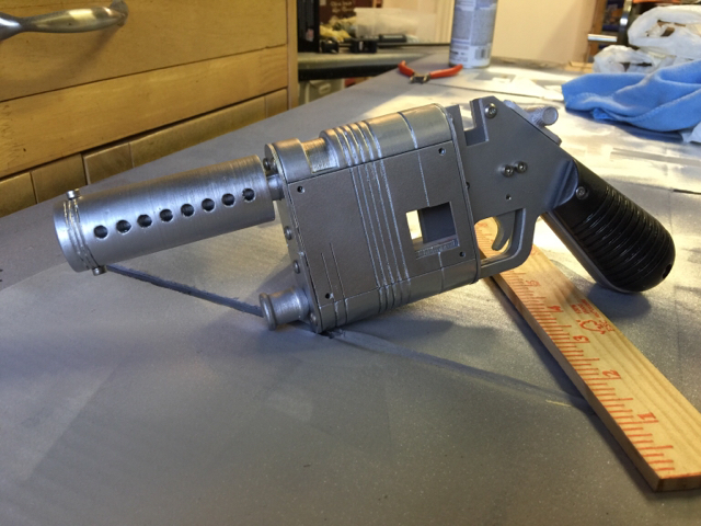

I am still tinkering with the files, but i will put them on thingiverse when i am done. I am almost happy with my new grips. ImageUploadedByTapatalk1454341966.972855.jpg

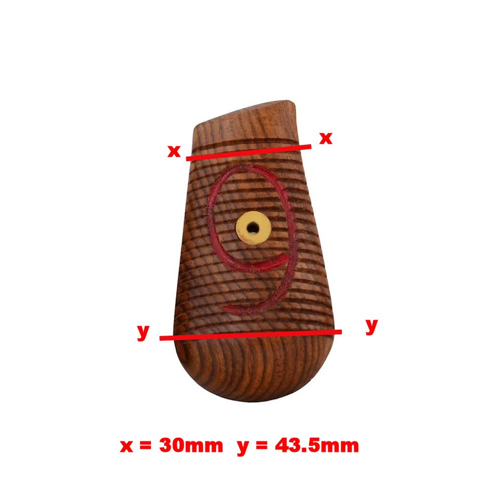

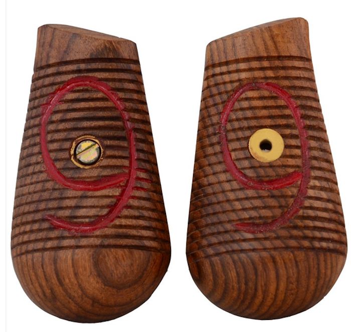

NIce. I've got real wood grips to use . I've looked at 3 sets of files and all have size issues. Looking forward to yours. Thanks

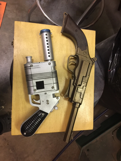

No I'm going to use them as a size gauge really. I might use them. Just to be different and put a twist on it. I have the 9mm ones.

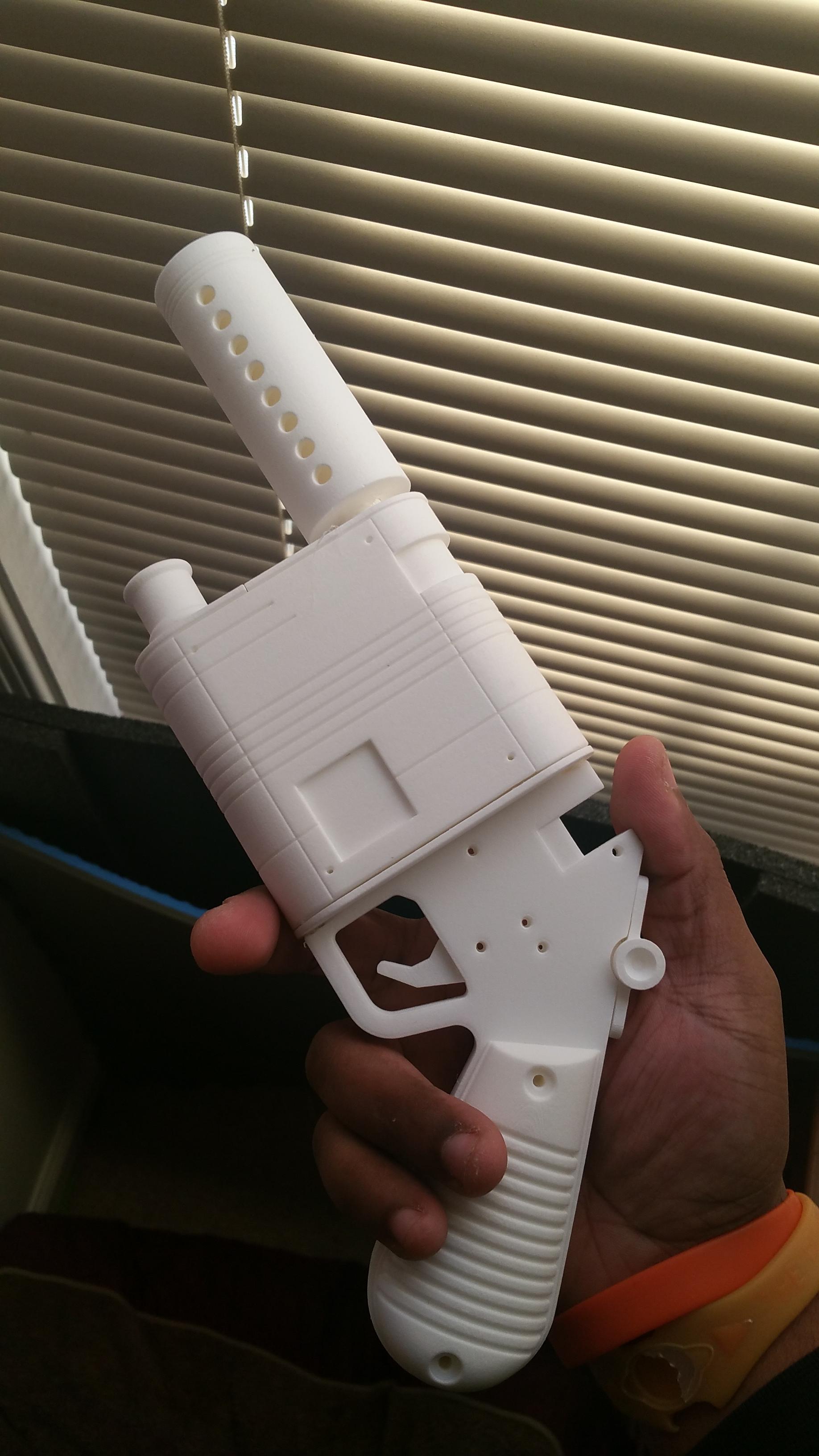

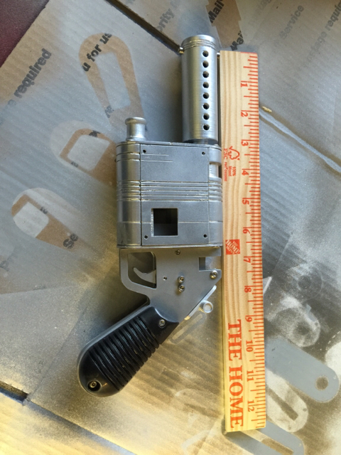

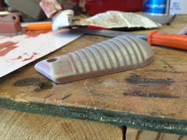

Version 2.0 (90% of previous version) prior to black wash, muzzle blue, and weathering. This one has a fixed trigger, since my pivot design sucked. I am almost happy with the grips. They may be to tall or just the bottom is too tall.
Pardon the sloppiness, I realized that it is a tad small so that has been reflected in my prep work.

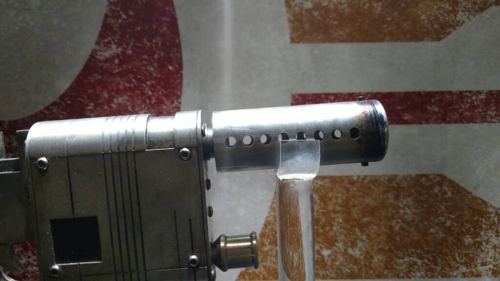

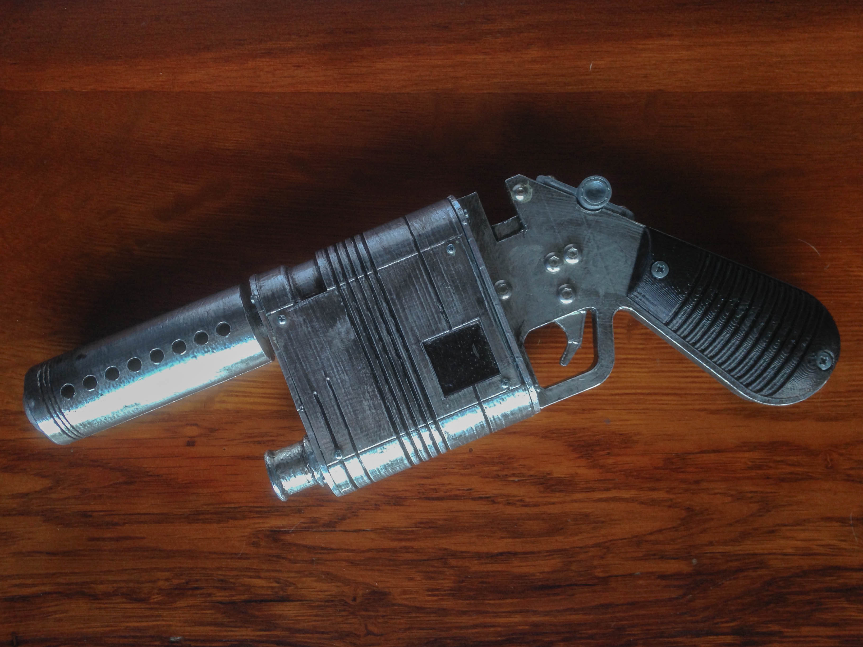

Thanks for all your work everyone! This is great. I plan on making one out of aluminum, stainless, and wood, but as a quick fix I purchased a rough 3D printed kit from Filament to Fantasy on Etsy (Not sure if they have an RPF presence?). I finally got around to finishing it, I did some light sanding but out of impatience, covered each part in aluminum tape, then used some dark grey hammer textured paint to hit the dark spots and rubbed it back. Still have some more finishing work to do on it, but I'm pretty pleased, for something that took me an afternoon's work anyway. The main body is 2 15/16" long, and I'm thinking if I made a metal one for myself, it would be about 3 1/8" long. Anyway, just thought I'd share...
-Christof
The print job looks really clean. I'd hit it with filler primer and see if that helps take care of the print lines.
