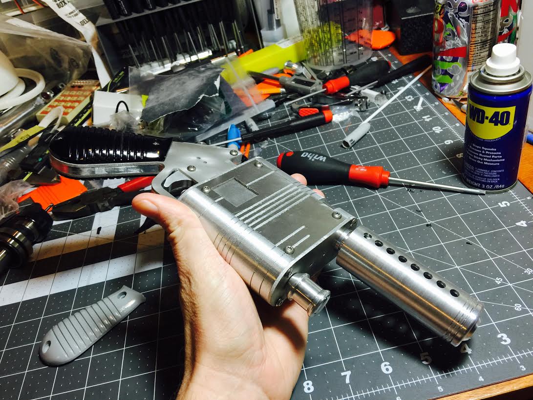

Did some weathering today. My torx security screws came in today as well, just need a proper driver before I can install them. All I need now is to finish the grips!

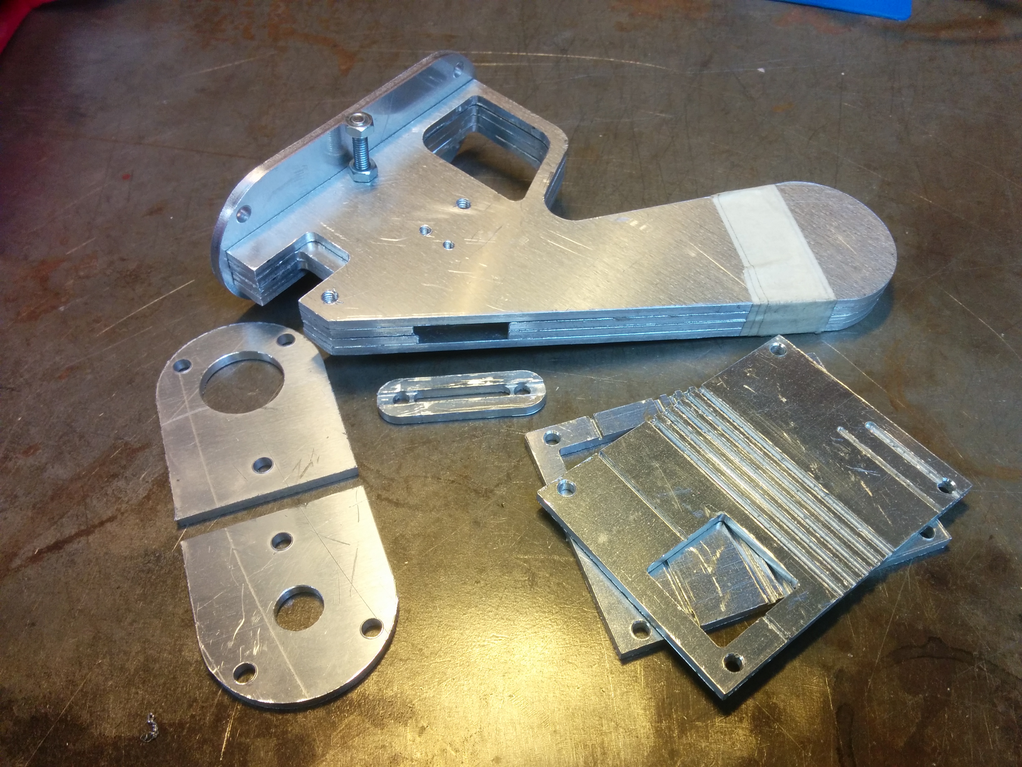

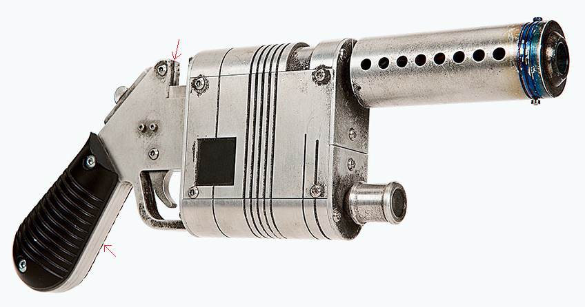

There's one detail that has yet been overlooked that makes me think the Launch Bay pistols were not a part of the movie but built specifically for display.
If you look at the areas in the receiver section pointed with the arrows, you'll notice that the version with the two-piece front panel has a receiver made of four equally thick pieces (you can see a slight variance in weathering and coloration) :
To my eye, that looks like 3mm alu plate. That would make the receiver 12mm thick, which looks and feels like a good number to me. It could be that the "production-used" prop was made in metric and the display pieces in imperial measures.
On the same note, if the torx heads are 7mm in diameter, the main body pretty much has to be around 38-40mm wide.

To be honest, I don't think ANY of the props present in the Launch Bay at Disneyland were EVER used on the actual production. IMO they are replicas (albeit high-quality replicas) produced specifically for display, which is why they differ in subtle ways from the ones we KNOW were screen-used. Just my two cents!

I'm guessing the same thing. I'm suspect they are just replicas built from good specs because at least they are very close. Do we know exactly what reference was screen used? For instance is the above picture verified as screen used?
Ps does seem like a 4 sandwich however to me the two middle layers look slightly thicker.

Not really. I tried looking, but there aren't really any good enough pics to screen match either version. Noway to know for sure before the blu-ray release I guess.
But. The one used for the visual dictionary has the "fishing line" detail on it, which means that they used this picture, just with the background cropped off:
Not 100% confirmation, but I'd reckon the photography for the visual dictionary would have been taken during the production. The split-front version was also the one used for the press releases, but that really confirms nothing. I am pretty convinced the split-front/four layer receiver version is the screen used.

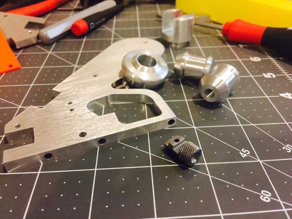

I plan to a short run of mine maybe 10 or so. A couple are already spoken for. They wont be too cheap tho..prob somewhere around 750-1250 in various forms.. still have to figure all the time and materials. You can make them much cheaper if you do it yourself and are willing to put in the time / effort etc.

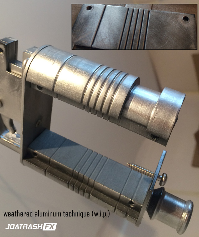

Not sure if this is of interest, but I'm currently doing a buildup of my kit for another RPFer and thought I'd show one way to paint printed kits to look like aluminum.
This project started as my own blaster, which was painted in Alclad Chrome, but I wasn't really happy with the look because it was a little too "plastic chrome", so decided to redo it using a technique I came up with while doing my Hellboy Room Keys a few years ago. It's still Alclad Chrome applied with an airbrush, but the initial layer is wet-sanded down with 400 grit, slightly unevenly, and then rubbed with steel wool. After that a new layer of Chrome is misted on. This created an unevenness in the surface and makes it look very much like aluminum that has been subjected to the elements a bit, because it catches the light at different angles. Leaving the occasional "ding" in the surface adds to the idea that it's been handled a bit as well. It's a little hard to photograph, but this might give you an idea.
