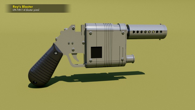

BTW, JediCharles has produced an excellent (and free!) 3D file on Sketchup's 3D Warehouse. It has amazing presentation and great detail, ready to pop in to Layout and 2D print. The only downside is that the author has made the muzzle/barrel out of position, at least relative to the official encyclopaedia picture. (The image probably wasn't available when he made the model.)

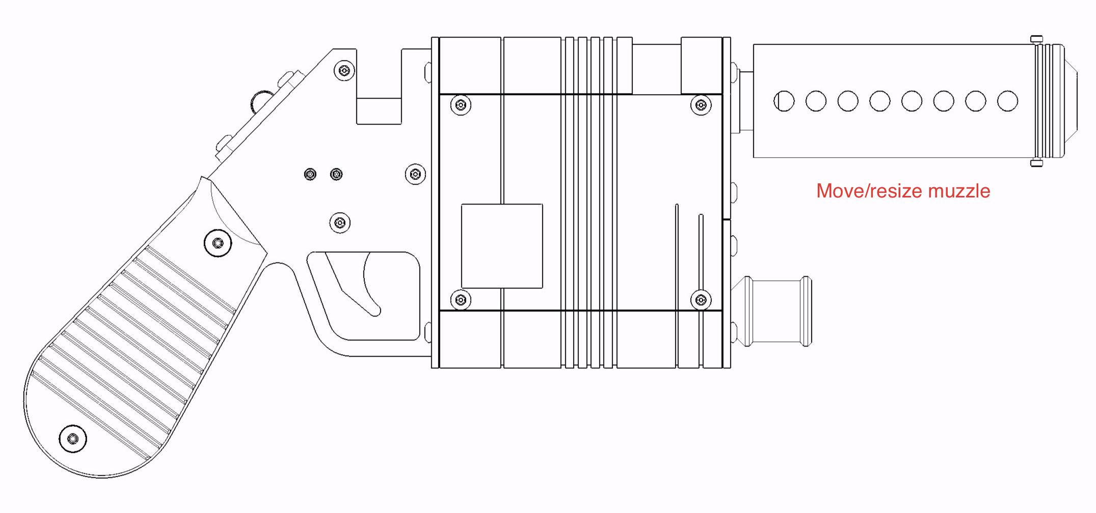

After much doodling around, I've abandoned plans to use Bill's plans for now. (Sorry Bill, hugs long time though!)
Here's a pic of JediCharles' model, done in 2D, using Sketchup Layout. Print size is about 285mm, from memory. That's about 11.25 inches for you non-metrique home gamers.
FWIW, this is quite small. I can just barely squeeze a finger between the trigger and the trigger guard. (And despite what all the ladies say, my hands aren't very large.)
[yet another edit]
Ignore the red text about the muzzle needing repositioning. After more study, I think JediCharles has it right.

The grips are indeed tricky. I have made one from sheet pvc and cardboard, but it's a LOT of work to get right. (It doesn't help that they're not symmetrical.)
So I decided to print them up instead. I'm using an excellent model made by JediCharles. It's freely available on Sketchup's 3D Warehouse.
http://jedicharles.com/2016/04/reys-lpa-nn-14-blaster-pistol/
To print them, you just install the free STL Export plugin in Sketchup 3D. This takes a few seconds.
Then select each grip (they are separate objects, beautifully designed), and export them as STL. Voila, no modifications or cleanup required. They print very well, as is.

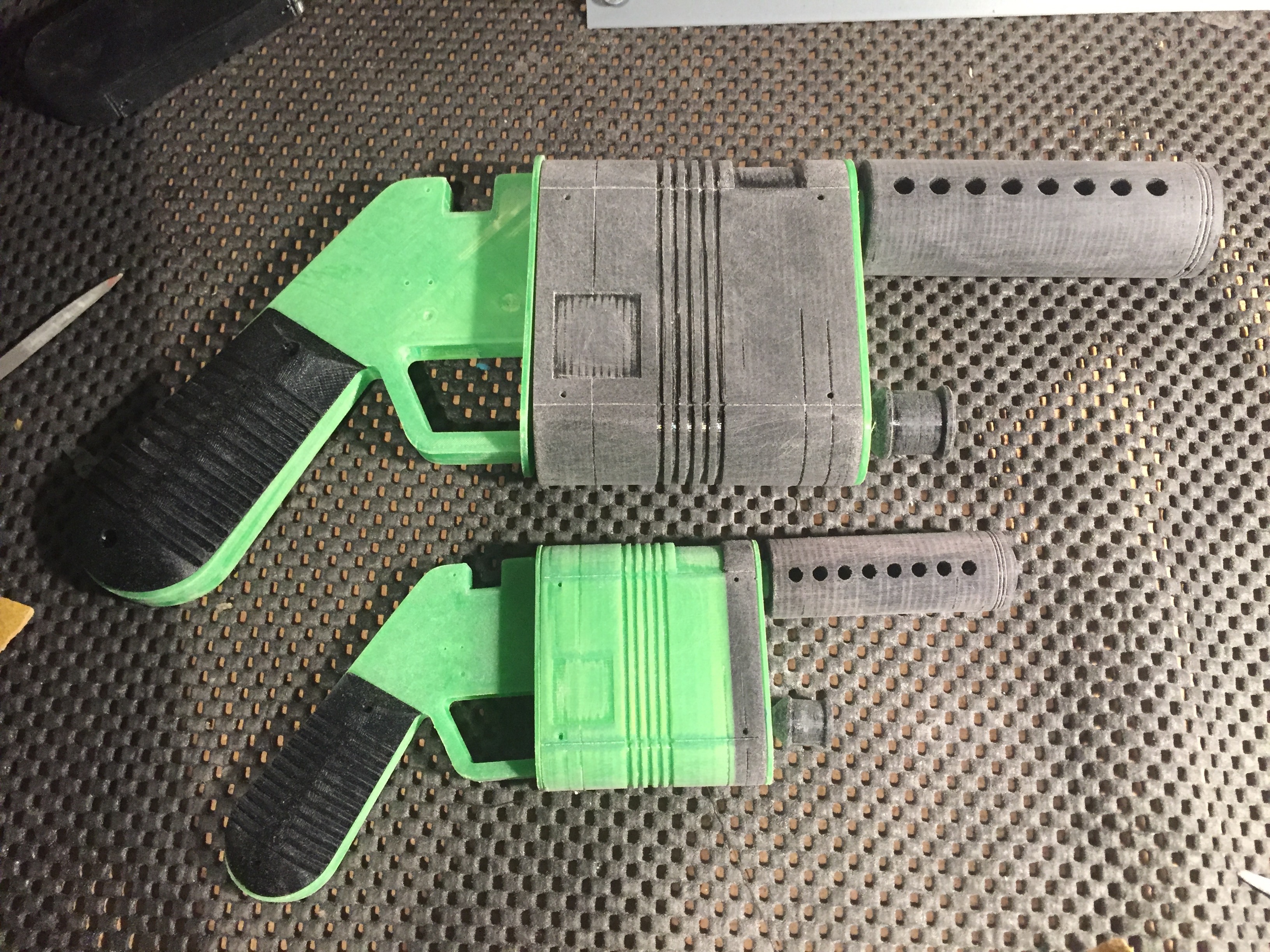

Hey all!
I decided to teach myself Fusion 360/CAD because what good is having a printer if you can't create files!?
I haven't yet been able to model my own grips and wasn't looking to use someone else's as I'd lie to have my own set of files created by me and also would love the knowledge that comes with the process. So any tips would be greatly appreciated.
Another issue i was having was whenever I clear coat over the silver spray paint it turns grey and almost loses it's metallic qualities. Any tips?
Below is my Rey blaster compared to the lillykill files. (Which were fantastic but a bit on the smaller side for me.)
My blaster measures out to 11 inches.
(Lillykill version has the grips)
Please note that my blaster is not finished as it was a test print/paint so there are noticeable marks etc.
Let me know what you think! Any tips would be appreciated!

I didn't do any scaling. For the grips, I just selected the two objects, exported them as STL, printed at 100%.
For the rest, I just created orthographic views, exported to PDF. Then used Adobe Reader's Poster mode to print at 100% over several sheets of paper. The printed grips matched up perfectly with this 2D blueprint.
Doing this, the overall width of the gun is 287mm.
(For reference, the model includes actual metric screw models.)
It should be noted that it's a pretty small gun, in the trigger area. Rey may have been able to fit her little fingers in there, but Han Solo wouldn't have been able to. (So why did he have the gun? :)
If you wanted to use it for cosplay or whatever, it might be worth scaling up the model by 10% or so.
