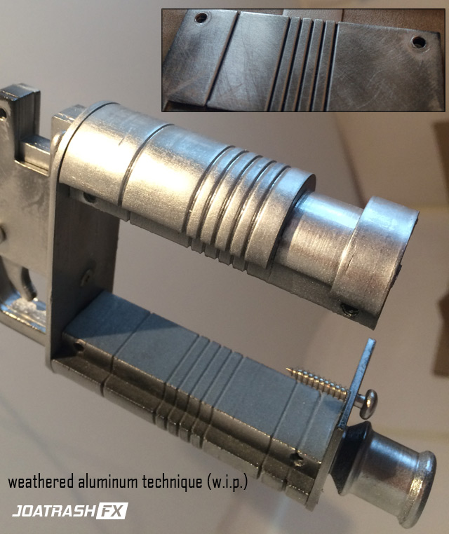

Not sure if this is of interest, but I'm currently doing a buildup of my kit for another RPFer and thought I'd show one way to paint printed kits to look like aluminum.
This project started as my own blaster, which was painted in Alclad Chrome, but I wasn't really happy with the look because it was a little too "plastic chrome", so decided to redo it using a technique I came up with while doing my Hellboy Room Keys a few years ago. It's still Alclad Chrome applied with an airbrush, but the initial layer is wet-sanded down with 400 grit, slightly unevenly, and then rubbed with steel wool. After that a new layer of Chrome is misted on. This created an unevenness in the surface and makes it look very much like aluminum that has been subjected to the elements a bit, because it catches the light at different angles. Leaving the occasional "ding" in the surface adds to the idea that it's been handled a bit as well. It's a little hard to photograph, but this might give you an idea.

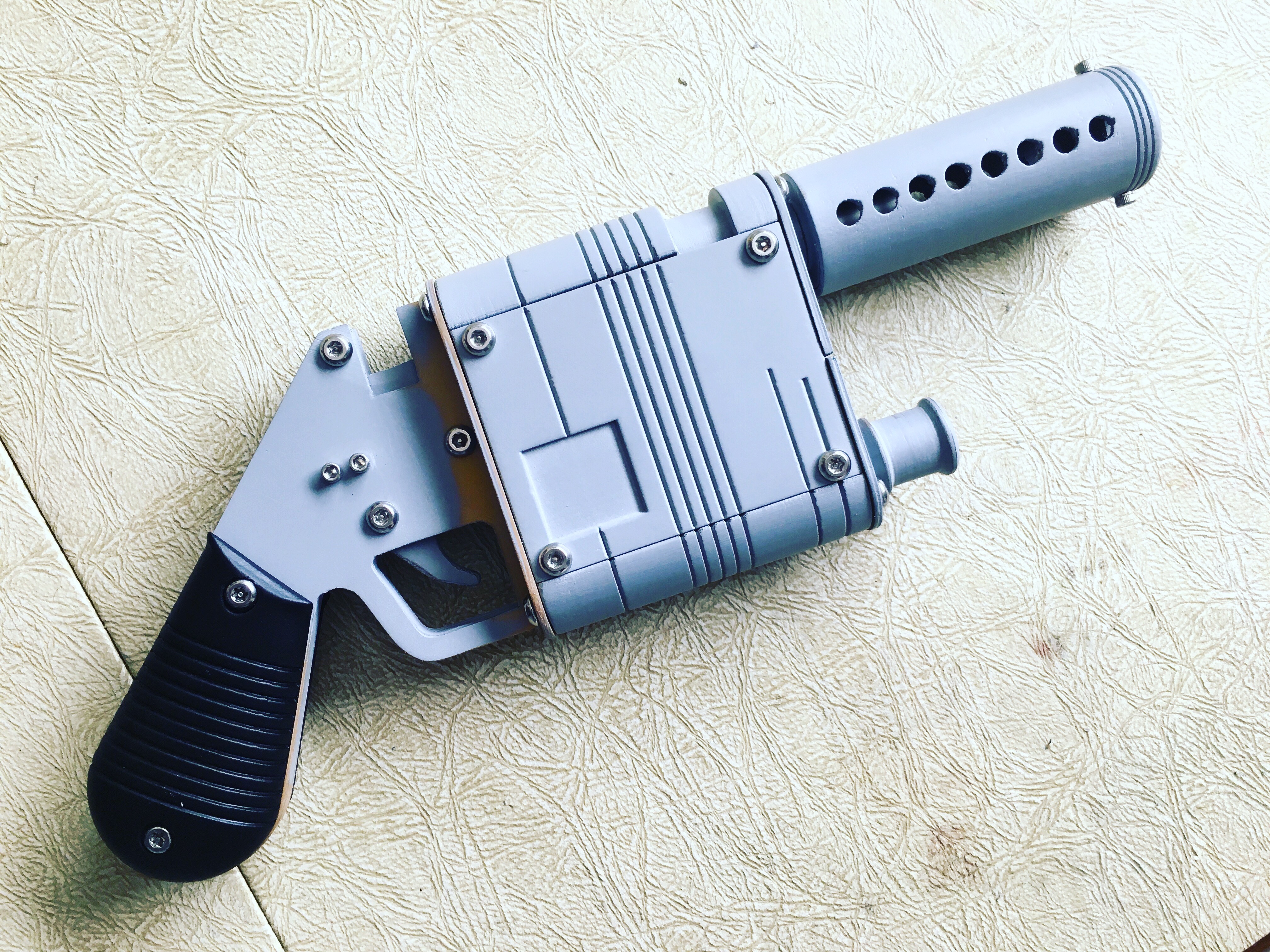

Here is mine - designed by @JOATRASHFX. I'm using m4 secu-torx screws for the larger screw heads and after seeing the Disneyland Launch Bay version, I'd say that it's extremely close in size, if not exactly the same.

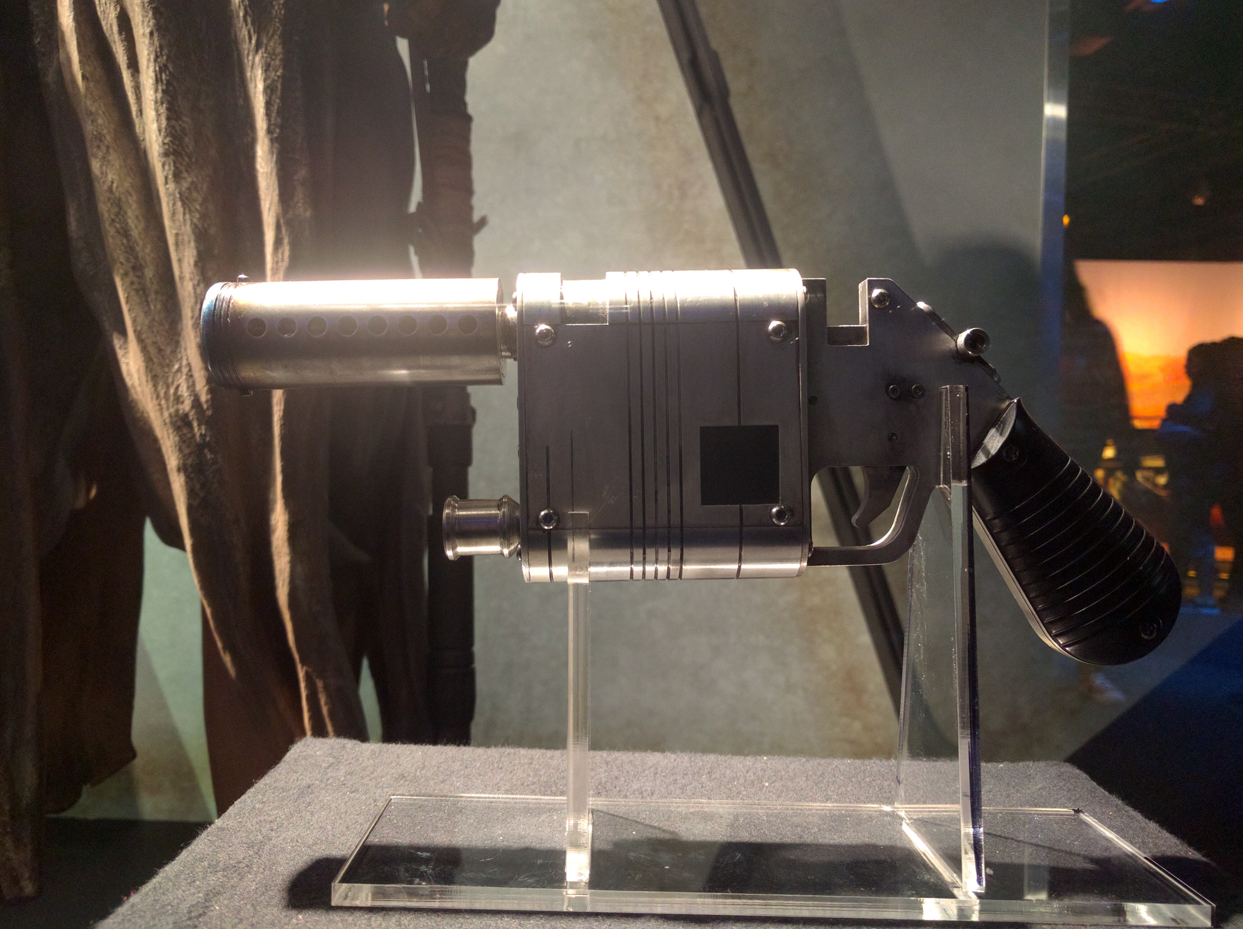

Based on this photo from Launch Bay (which I know isn't the hero prop, but it's the best we've got right now) and the M4 Torx head (8mm), it looks like the total length is around 14.5" - so Bill's design might actually be too small.

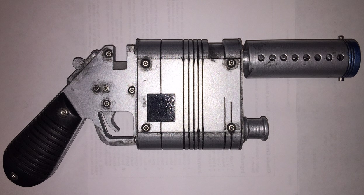

Here's the Greggo version, above, which measures a hair under 11" long. The lilykill is below, at just over 10" long (a bit too small). M3 and #8 (same size as M4) button head security Torx screws on both.
Apart from the shape of the upper edge of the grips I think Greggo's is the most accurate freely available version out there, but if you scale it up Lilykill's is great as well.

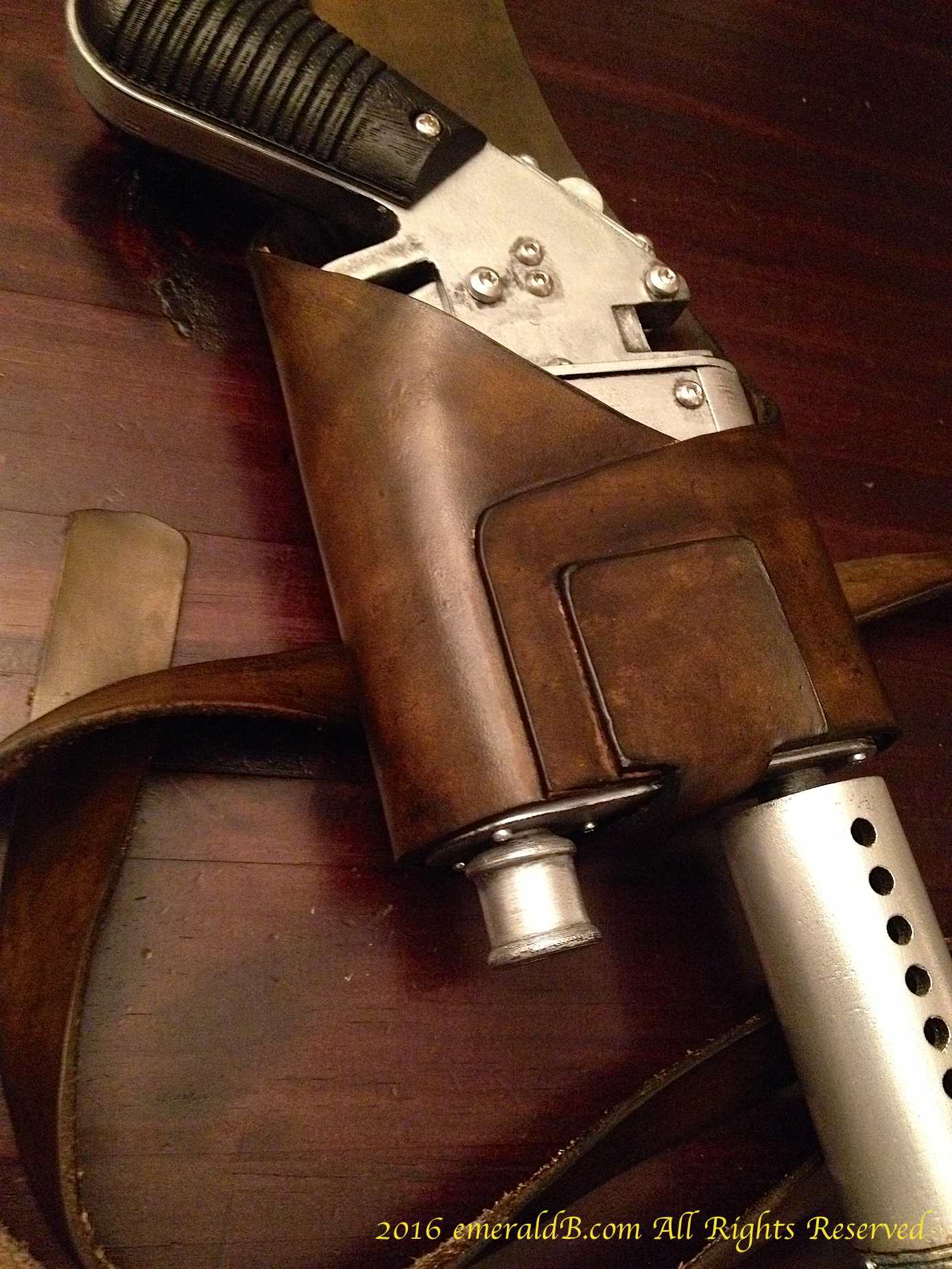

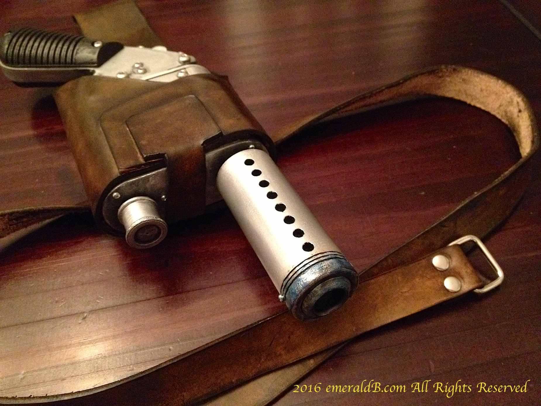

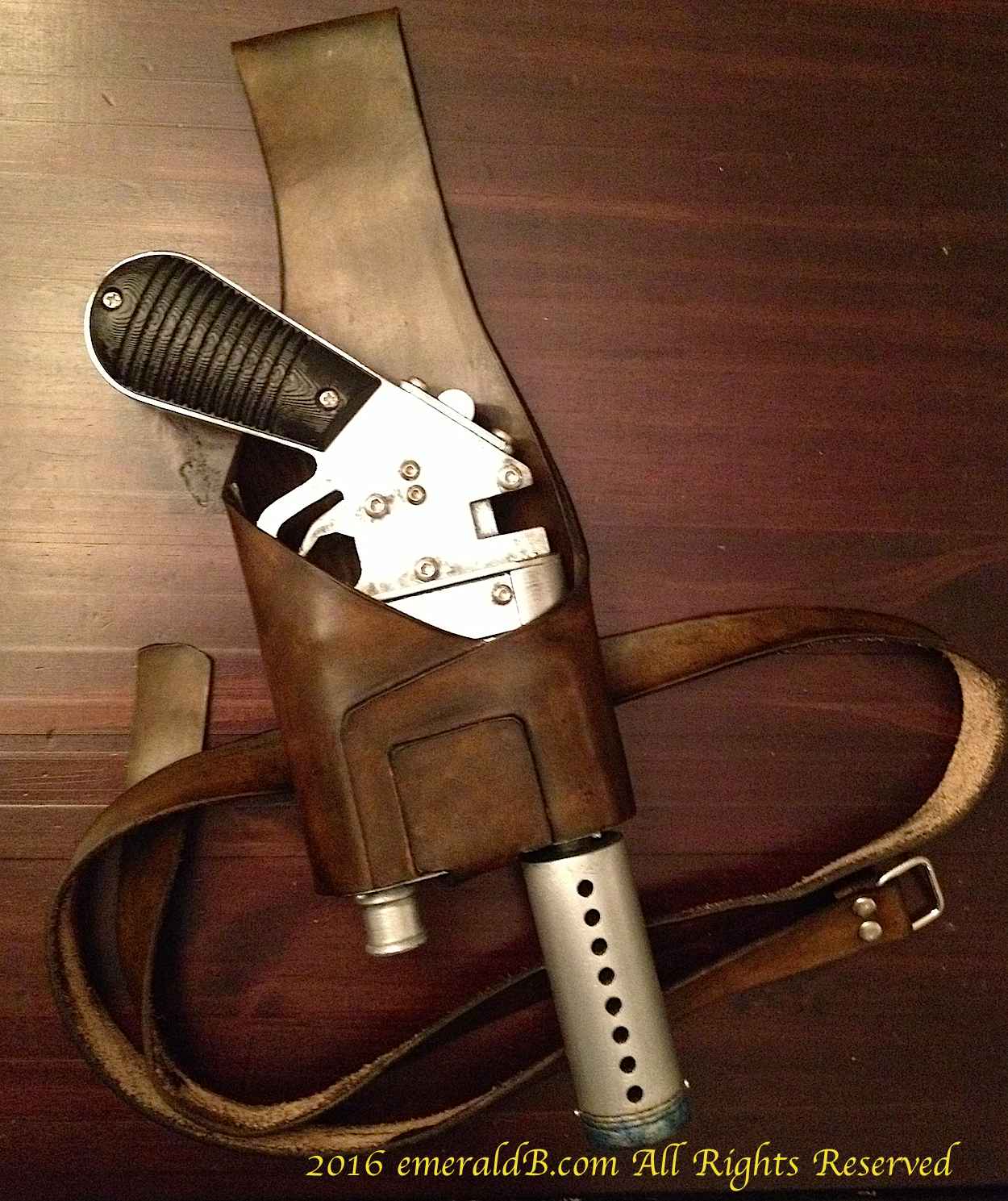

I am planning on putting up the pattern I made for this soon. Obviously I still need to size the thigh strap length, but the layout, shape and hardware to connect the strap is accurate, the best I can tell from the limited shots of it in the movie and the Rey action figure. The other end of the strap just gets a stud and hole(s) to fasten it through the ring. Something about having the blaster laying on my desk with no holster just felt wrong.
Yes, fantastic work on the holster, Redwillow!!! If you are still willing to share the pattern here, I'd love to use it as a guide to make one for my wife's Rey costume. I noticed you didn't stitch the holster...did you just glue it together with Barge or some other type of leather cement?
