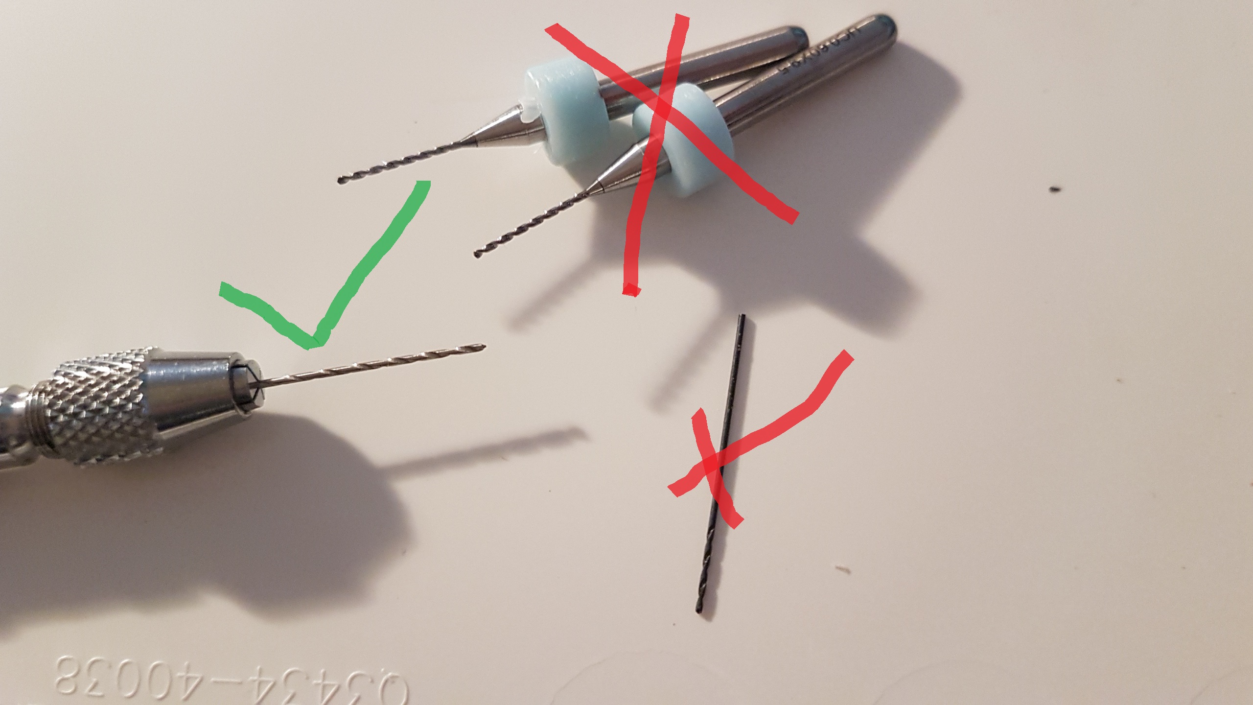

if you bought a normal cheap pin vise it is it is very likely that it is useless
because the cheap 3-jaw chucks can't hold and center these 0.6 mm drills properly... maybe you're lucky. if not order the "Tamiya 74051 Fine Pin Vise - (0.1-1.0mm)". the right drill bits are also tricky...don't buy this tungsten board drill bit with a thicker shank, which is completely unsuitable for the plastic and manual drilling and breaks like pretzel sticks. the drill must be flexible but not too much like the normal dark/black hss drills, they are about 0.6 mm too soft and also break quickly. these bare hssg drill bits are best. They are made of heavy-duty high-speed steel and last the longest. Actually, when drilling, the rule of thumb is the smaller the drill, the higher the speed, but unfortunately not applicable here because we drill by hand, and the plastic would melt immediately anyway
