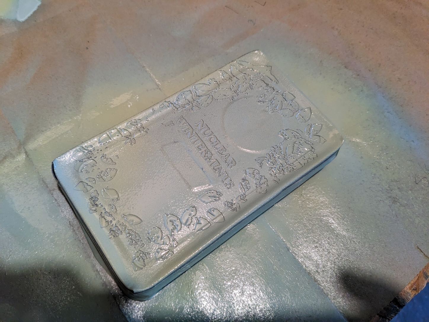

Stencil -
The first thing I had to do was use the leaves outline to make a stencil to spray white behind my vinyl on the tin. I opened up YouTube, found some tutorials, went into GIMP, then duplicated the layer (never work on your only copy!) and shrunk the outline of the leaves and simplified it. Cleaned it up a bit and got this.
I had to go back and fix some "islands" that wouldn't work on a stencil, but that was easy.
Next, I exported that layer into an SVG file so my stencil cutting device (whatever one I chose in the moment) could make the stencil. I then took the SVG file on a thumb drive back up to my new favorite place, the Maker Space, to decide which machine I would use to make the stencil. After chatting with people more experienced than myself, we decided to try the laser cutter. Worst that could happen is...I use the machine wrong and set the entire Maker Space on fire......
xHs-O22yh7J4-8GsUfKju1JXh0i54loHzmbc3K0fWmaAWx8ecz3pNO_VLwRF5W-M0oFabIodwgjSDxio-f_aaNTC1d1uOo4ZT1JrAUS0j5s1ItSDLpD3GFnoMVMH5y-nOaDSqqR0BdVB7r_fTuJLEUpdSoW0IBQuw8gvCkbJnDvjpCsJ2_9PTJytzGP7V6O9ztUn0WdWGPD6O6i9mLsmzMkW1JpDpLegjL6BF8G8TllYugmCryP5wrhNUekS7gi4CrBU39nHrFeBQMehEHef_UCQxp_o3a2LYmou_U3dyWATt7pJQoPf3ddkfaSJp9kT2u-x6tuwRgeGXwtOM4Egp6TEO7wxMaAGJmLSXiIsLRUlBvdJbqS2XJANksvSrcL8i9nQT9k-7w8eGZnb6O7xB_d2J3iOjcvTg1Bdu-5PvV8gaEt16RkXXrStCFFBay3PQ77ASdUxH4JR4Oz10wgtVizczK9pjFuplWddD2MjymvXBTzUuwfl6hO_hrVa4u59ATJPmd3T86eeB92Udej0rGf-vDTuj3oIZDS9uxMPJc_vM4tF9M--VNgnSvF4enaB8l8AFE1KKi5kQKfn7y3saq4q_nBmH44zKd0TulHstkhvTbi2hlMmANxhWw2689WcQj3_mMdMbay3xEjeMghKSxLjKfI1ScGYYA77BnoAx7e0gSZTgDGPFXtItNcM7rF93MjpOeIXGbqZpAO0zDi1-8V_7LlYkZBG6MpV5CkTNKLKMYM2gL04-d2AlADFuVOMkuccMbRDUsqGTBFyQ0qfOgOHt3Bp7jPYOcdI5wASyG3659ncSbkUIfQCLwIL8DwVQXSNeOJ9t51dTvi5vn-q8NdA_TBztioBx6ejC-mezntJ1sV7GA5Nm8-h-4QlyzYLFbIS6lo_2c3qjyyXHN_ds7kB80_8PhrgaqZXuNeLmMmEoMfNOSi_CFApGHKO_TxDpVIsg0yRDWOcCBzklCE=w1139-h854-no
This thing was AWESOME!!! The first thing we tried turned out to be perfect!
h0TwJljmI_PMgb7SUJNYtjPf4W52jGSCRV6XnwnXmKQls9LnYOEsTwATVKJLsHxSuF00Z_mQcUQTvffeYz5DegJvGCRCVfRFJcaQkwAlF84pRigmEKtIeGJojURgFA7gZm3jsBXvRFKpIp8CS4d55O7bywCaClD-Q_KhLeV761gsYmcOb8esbcl60ota2QDcDVb9i1m-2YuV0OfpW89btxVo70D8ZyAxCW8yhR_Mu4QTTK6tKCYhgncJ8dcZShjffKnp4gqDhnWbbiAoPJ_s1JetmUCiCGWFHP8Hj12w--NkuGwxwfQkuK8bqyEKPDGOSwwqan4AqkYx4upHUolGHuIoWyVhH6T3znsg7ov0lF1QPeLcMxqTup3h_mBXgge_yk7p6mTPHb4Khqxhg5gnMzDWEiW7tVqvvz-_Zex1HGbfRk4baQ80i8MKZBWoYNlcSfF6mcdJx5fcMeCFFwPzJpO82OcwkhDmRC6VhtZ585QKIn_wlttIn_A8rc7pqmlgobuT9qazkjQ6FU6dDNacCVfVRt_Zjj5fqYXJ0y3-Zt4aY6_RE7DbSukeBaFbodotK5sizjAoNcYr04DSGEVWizQTXaJi3W8_Qn19tB5srsOyeixKVBw4Aj60z956bKyy--0H1FcJUjL12y2LKTy3Z2q3aJ5RobOq2Jl_FQSxSTvqcHQOpT4dz2GYmyw3weJi7E5msuEUUEDJaeRXh848MuHD1vD8TyEBurnWmHgSWRpWX1HOnrsg2VP1pyzScbAC6QFlI1tbh_eElG5XePPUiu4nUFGaz7TS8fWx_E8BnvWyToU9Km2uooRemr9NVS-wQVUNEinlsUhhbRC5C9MKY0n1Y90NLFvZaX-8wTpzVaFgDymapeHAOME5cX586n9zT-kruLd0kEvIqMJM71c-IIBM29C_Gv-fRHWeyoKAePEwm1U_iiVrlyjlCOpM7JmJrhV--P9cXqTn52bbseI=w641-h854-no
woa7gD-jMqyEKw4QShROIxQTozWsG5cfr8jbPowX8qJ4_WNdEIpSDTcRefEDi_L2Vjy7zQ3UtXDp0gQFQSRyoO-XWhbgXxFuHKiONvAn-sdwLNYPwZO7hniZUZJlPBPsbKZnaVbUWiTD-4pbKkoA7kbx8v4XzVu9fhWVGJCHmDnjuvIzcwxbv9YgyxERh193FOasVNM06DlpMngEguZutJCSXeOkLmZ6HNqExyy2TOTEBowNSdWPBsFaeWlN2ZMCLzLQiLsOWbWd-A8lpCR2BKdcv9a7wP4mPHkgF6lqt0eys_gTXbL7mzHoUkalvbB66Mqih0TpMHP8YPCa90V6RQ3pK8i8VxelGCinmTdN-H5AM7VOHFseygVWUJTSf-EuI40NfOAc20O3rFF68PLVhh9QV4AvivEbDAXQrQc0LCqKCp2B7IBjQnlMOIizQeJY_dqC5PcprfwHijU-79lG_-2SzHGBWN-k7CEnNHB499EgaLNdjl5obRheOO5vchaqqrvyjybn7SBOuQErVqJXUuSqkb3ZO_pN4kmzZhFhZP3g3e9MHsG_21FngxmTDlxqq9QAWirP2pE2ZNSga9Pp-FLUPeNsEiZt8ZohBM1F4lEJGkuvxMSqxlsUHKbZ3ue-JG2F2LITW5boQoopjF4eJ8HxkXy41ukVnzMs9stTxh_edLRebQD9cZbLYLxCCXQxI7ZCh8RH8JuVGNWmxgOe5p2t7_m-tiq6GiHVQ2aGgkssRpUxwV5V4sl0llmesVt2towUK2MYtBZPL6azmxiBftZZxdHHxtDQc5J6RRy3otKsqG-vmaSpoH0H06drf4-Sv44RHB_TjvZaajc2IjoW-3FgnivOI22aCeLqEHSwlk80EUGMozCiJMLpV_y9maTpsxdiLNr2ds_n0K-kkWuoH-tOOaVlcH746gKdvvbe7kcT7twYS4vJoBFO2xhM9IaVz_iIpnuO9lQVqp-CtdQ=w641-h854-no
I even cut holes around the outside to make sure the stencil cant move when I'm painting it.
Next thing I had to do was paint. I got to try my hand at airbrushing. Not to brag, but I've been doing some sort of art for almost 35 years, so I'm pretty confident in my artistic abilities. I like to think I can do basically anything artistic without much trouble. So I decided not to really look up any tutorials on how to use an airbrush before just jumping right into it. And....turns out I DEFINITELY should have looked up some tutorials on how to use an airbrush before just jumping right into it. I was humbled to say the least. If you're good at airbrushing...mad props to you! My results...weren't great.
7_fkM19oC_JLPXEAKleDNP23gQdUrFwTBWd-jck6p1BcsYRTLNtVZyV2rTSP28Yma-Dxi0YkP8NttvudgDP2kdeVttxVAvxj5KzOsHN-zcBGT0psbVzPCjoaTDxJqtJgm_xUeW3-HQl2bsFoaeyK7pOdt45yMfXVLj-ZvaRI4YW4_cEjByBHKGbBTWzCfhyzLoe2Pptq7GfKUEDet60QrjXO7UG5fx0xsWAeFgSNxKZragADcdZuM4yNQn7sp2P5BCPy3jnDeiX_vH0u7lAWFn8rtcvcqjVt4O95gerkko6OSAOUYEtLff_dJ4JxsnN4nE81L427frxkAk83S-Ch7UoMQMvChEkV5jnx6CdASGU0xhTlbbEwaRd6fcqcbf-JWWzeyVyAgPmrKSEawTjXETjIn4oRAA6VWsgCU6nQ52C2EGmeYbrP7p0Z-geLQ7-Y8C-7YHI794ypjON9ZOcvdAhdRspYjAizRxROOHekDSvvGYFxdeoP4lJWC5R96XuG0vk1WLTCfayDHrIGMU-n-6fPQxk1ODzYBsyYmkl7Pk2R_XVUgSlK7JuwjCadLF3UwQCAHz9uKPz5QnD40VMgBC8rngalFhQmCB85IS2M-dbjjbkLW-e8CyCyYfXHjWOwN1jqbS8Lf4GYLF9GTSMf8ia_vv92tTsSK8ILqUd1pzd3URU8DF4CW08ivyAX-j_ocB9y9tb4sHT5uclWKCxgbUHrJTRFFd4LKCsLrPfR6OZiNbKZ912o34eL6_cot9BizMTN7FwOT0qCJC0OPGfGAb2-PJyUPgE1_o0fe81w41fE3Vda7ybxI68ypR-yjuB6qZPDgJtgU7810PRR5vU0DqVc3y-9Ui64lRGQ4gm3ZjpgzLvkz5ipQmfxMPF2FCTGg_RywyqSdQfLthuc_mY8_0dtKlzKGm3gcYAfU7fj66nYLmif85fVqtj4DObFI81mAm82-AmG_gWQQQT--Hg=w641-h854-no
They were decent enough to be able to see how it would look, but not much past that. I had lots of overspray, inconsistent color, pooling up where I put too much on, etc. I also ran into the (non user-error) issue my embossing around the outer edge wasn't getting a clear edge because the stencil wasn't in contact with that part of the tin.

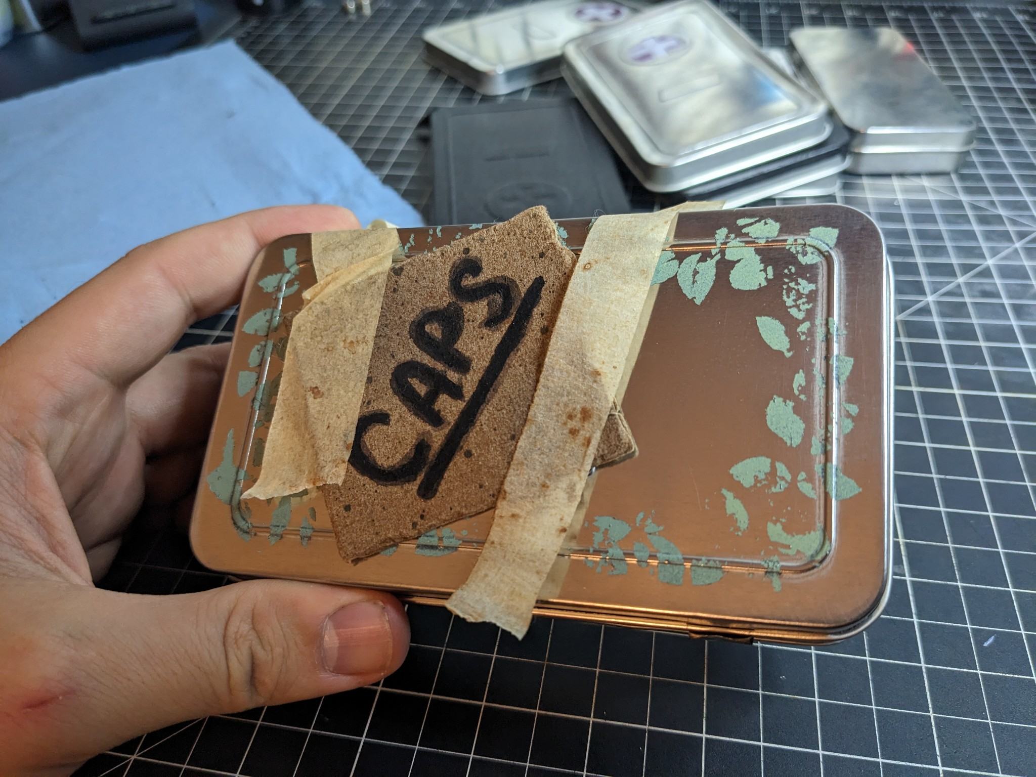

The only issue I noticed was there was a slight tackiness to where the laser burned out the leaves. I hoped it wasn't enough to matter and the paint would stick.
I sprayed again, waited for the paint to dry. I peeled off the mask and immediately noticed that this was the correct stuff to use. The mask came off all in one piece and looked really good.
This process really seems to have fixed the opacity issue from before. The leaves are super bright and match the circle/cross well. The only issue I have is the paint never really dried. Even after 24 hours it's still sticky.

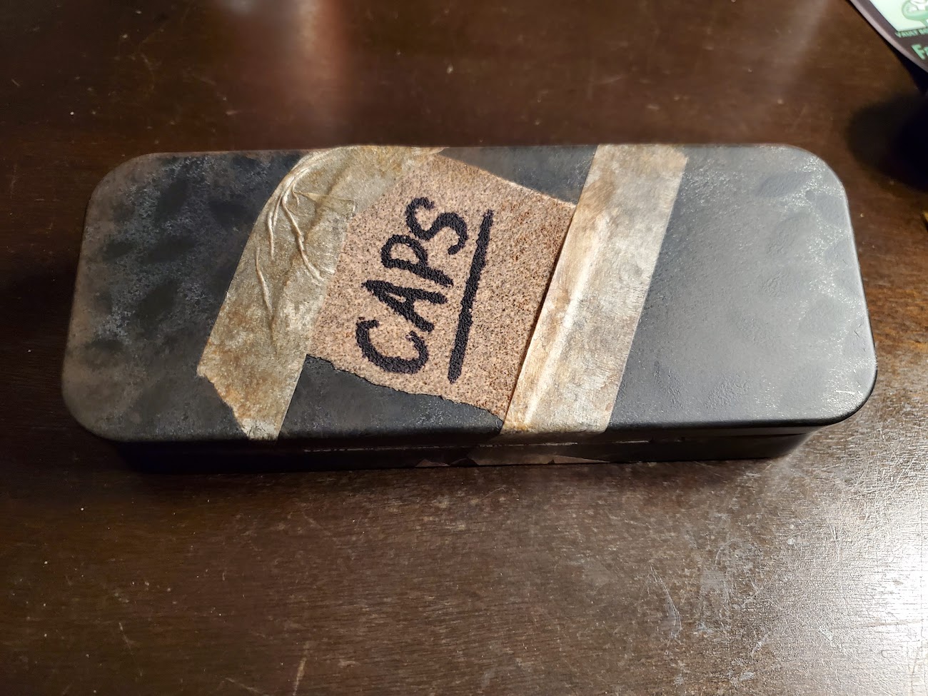

I put the CAPS label on just to see how it looks and it looks amazing!!
Unsticky-ifying -
I got the 2nd tin I lasered and pulled out the acetone and some Q-Tips to try and remove the thin tacky layer where the leaves were.
TabhL5CS1p3OPsN3friS9fTLd5sBDObbU78r-PqnK2JSmuQkAgveo5MdAvjpDzCGl-ruk5eLLI1tCTQBS_2a1KQqMO3KKP8bPGi-SBTAYAHOl0L_-WAwwSck7GKWRi9u3fxhZ8cdOWeHBbtFmbdMnbxC1z-l7swRc0Qia6SmUwTRIIlV75tu76saygf5344yLvWvShq0LYbkk7fgA9MP4Vn7Sru2dCbgA5OthiUf8b3dE2cPVEMEc44HU9r9tOGXMVXaSBlX0-LWnanalSJm7VAG-IzBar2vEInNMylJ5vQZYjv70AIPhjdg0w7PE123NvBxAigTX-xIkyBKcblpq9YrdtWLk-GeUSLUzCFX2zJlPkCQbDgCQOr7js4pRQmrZutQ6eKSABOfIRW-XOI-6iyumfdI4olGh1nDrOPDSYtNZing_gWEZfNmDV4foIYX95DDYT_Nbb_zrHthdJ88S5t0js4xeWo1N22KUKu-Clu-3yOT9jVxR4_wLsHQ4G50MTWEhK6xOaNc4ZMCklq1oFai8aw4S_r5NlcLni1lWW2oHbb8_tEt7bfPPSQ9NrlO6YuEOPCV2PUO1kqdUybmlxOqjzEigbtwiPJdgJ2KjYxX7gAMrG9n7Fj2mdcrSzZ19C8aItJPkk315tdvUl6hnOivpeorpJdz254PPy4ZQt3FZgRJcQGISnePWDzZk1IR_I4AIOLQXBK1VhbzXuFW7KjuJcszBsZyqQRHYO6cmIV_iT3CgPvFXMFiXkxGLiniVUeIvjfzXkgPD7KnnA-NFJ-NEfGi37WI6_yzelUoNiigZdo0jY3AopbYJ06IK6lIptcayybWAzV1AvSL2pv3jNXzSrwongHKXygWQmyjEJezLgjnW5mU7xgWluHnKL9K6yV2-LAH94BtV2M1hfoj0rUhaYI1-FaHgdqnDpu6myoTaP2vZ-v2syw3Ck9obir0YI9z2uDcc1rmF78rw-w=w641-h854-no
The adhesive layer came right off. Only a little bit of the small pieces of tape came off. Nothing too serious.
Where I'm at now -
I just sprayed the other tin with 2 spray paints. I'm letting it dry now and am going to see how it looks when the mask comes off. I'm hoping that this paint doesn't have the sticky layer the other one did.
I am trying to decide if doing another layer of masking with black paint on top of the green is what I need to do for the outline and text, or if I should do a layer of vinyl on top of the green paint.

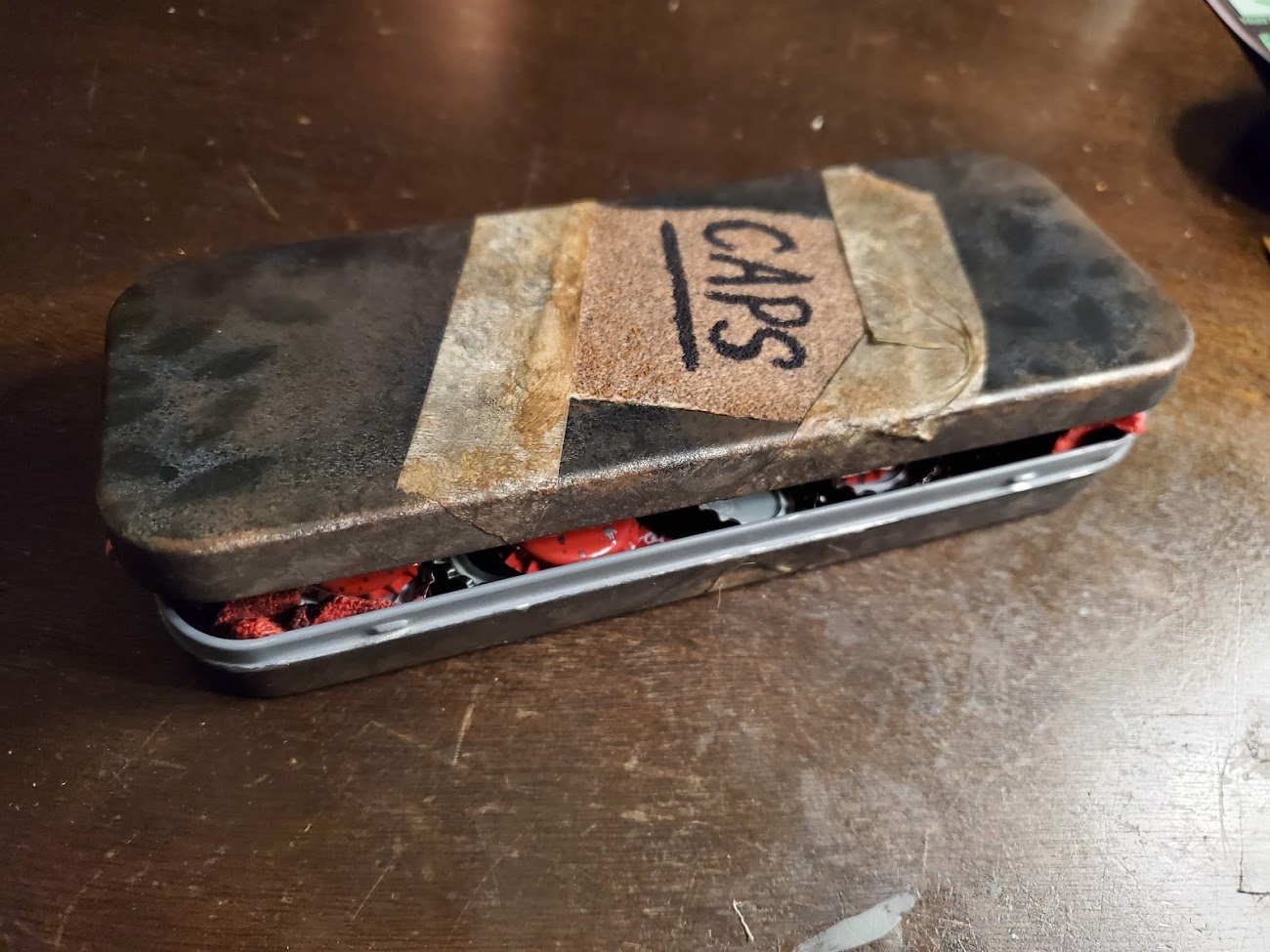

That looks really good! I like the aging on your tape especially!! What was your process? If you don't mind going into it? I always love hearing other people's process to see how different people execute the same type prop.
Thanks! Typically on my props I use a lot of acrylic washes in various colors, this one was done the same way. For the "leaves" I hand cut my own stencils. I do wish the tin was a different size but it was executed in a couple days as an impromptu gift for my wife who is also a huge Fallout fan.
I need to get better at washes. Those look good!

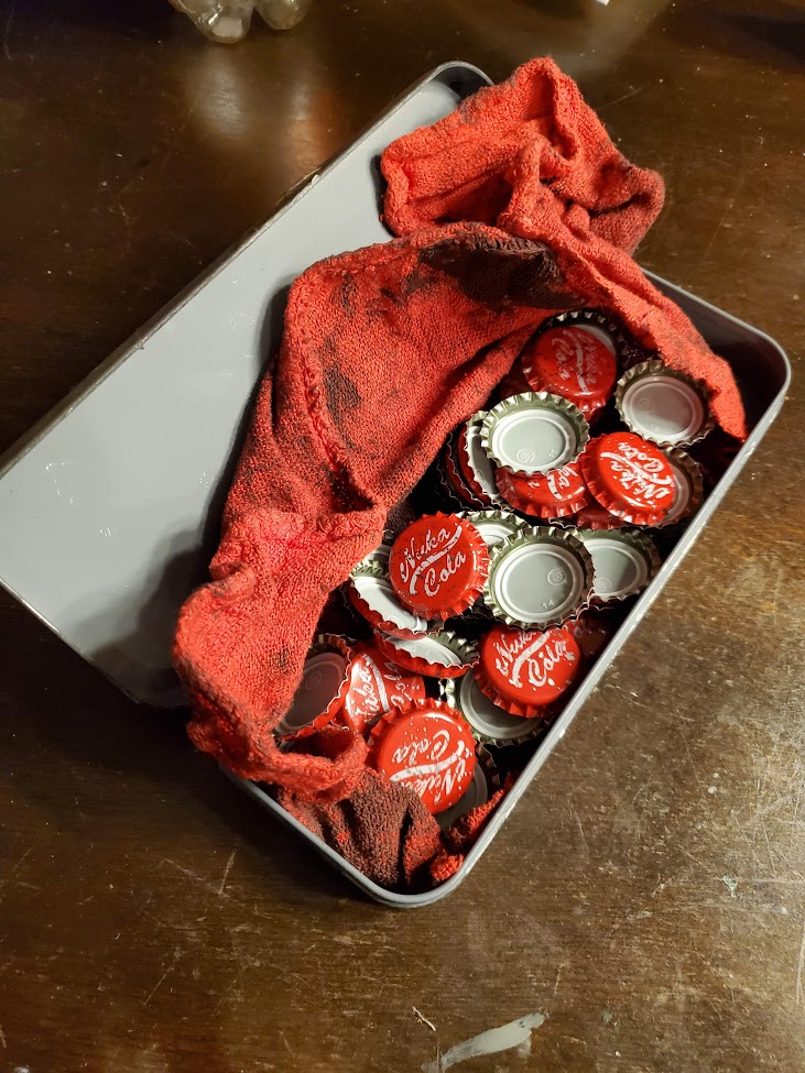

This is the backup tin I am using for the Cap Stash. Its not perfect, but its as close as I've found on the internet for the Cap Stash.

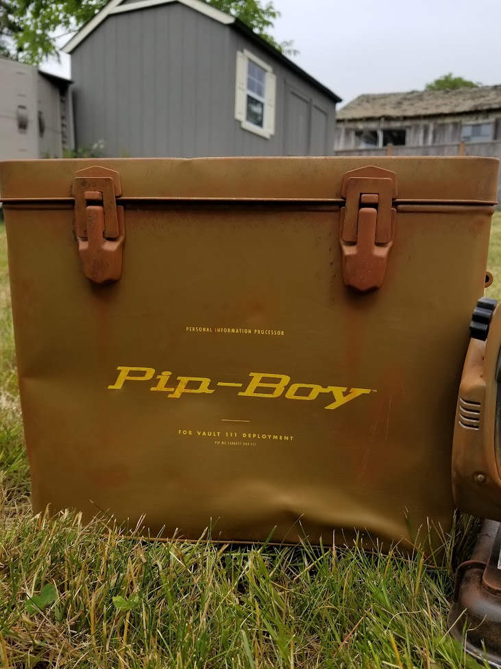

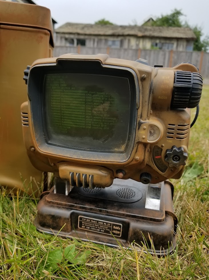

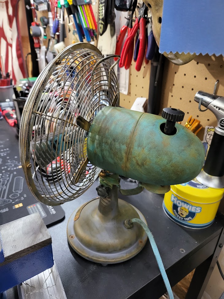

Here are a few of my other Fallout projects/paints and repaints for reference. I adore the Fallout universe, especially the weathered, broken-down appearances of things. These are all done with very basic, cheap acrylics/washes as well.
Whoooooaaa - i love the Pipboy. Thats not the one from Wand, which one is it? Bethesda?
Thanks! It was a ThinkGeek model Bluetooth version that bricked and they refused to warranty, so I decided to make it look worn out and busted, along with the case. Here's a picture of a stock piece.
Yes, Bethesda essentially.
