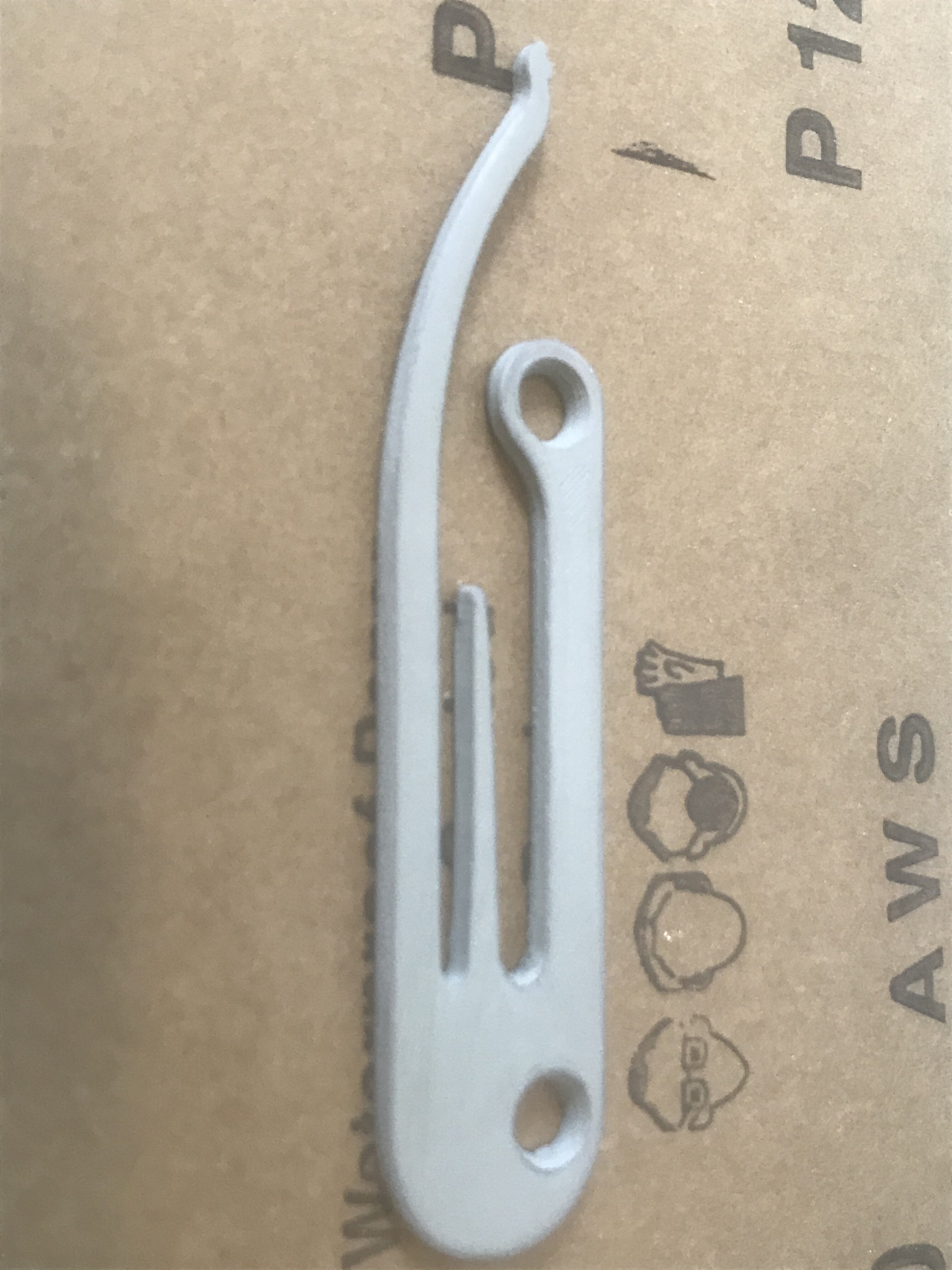

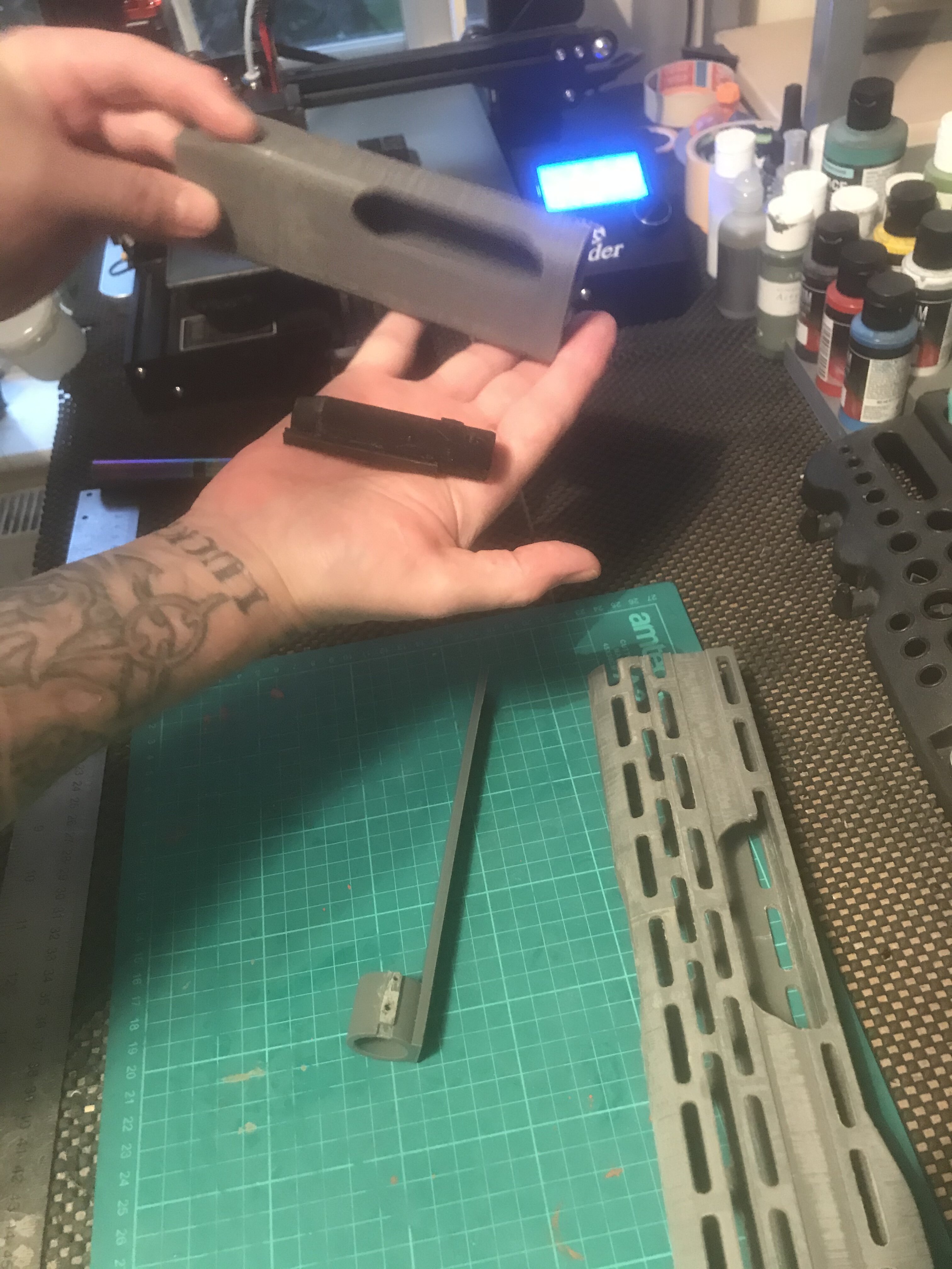

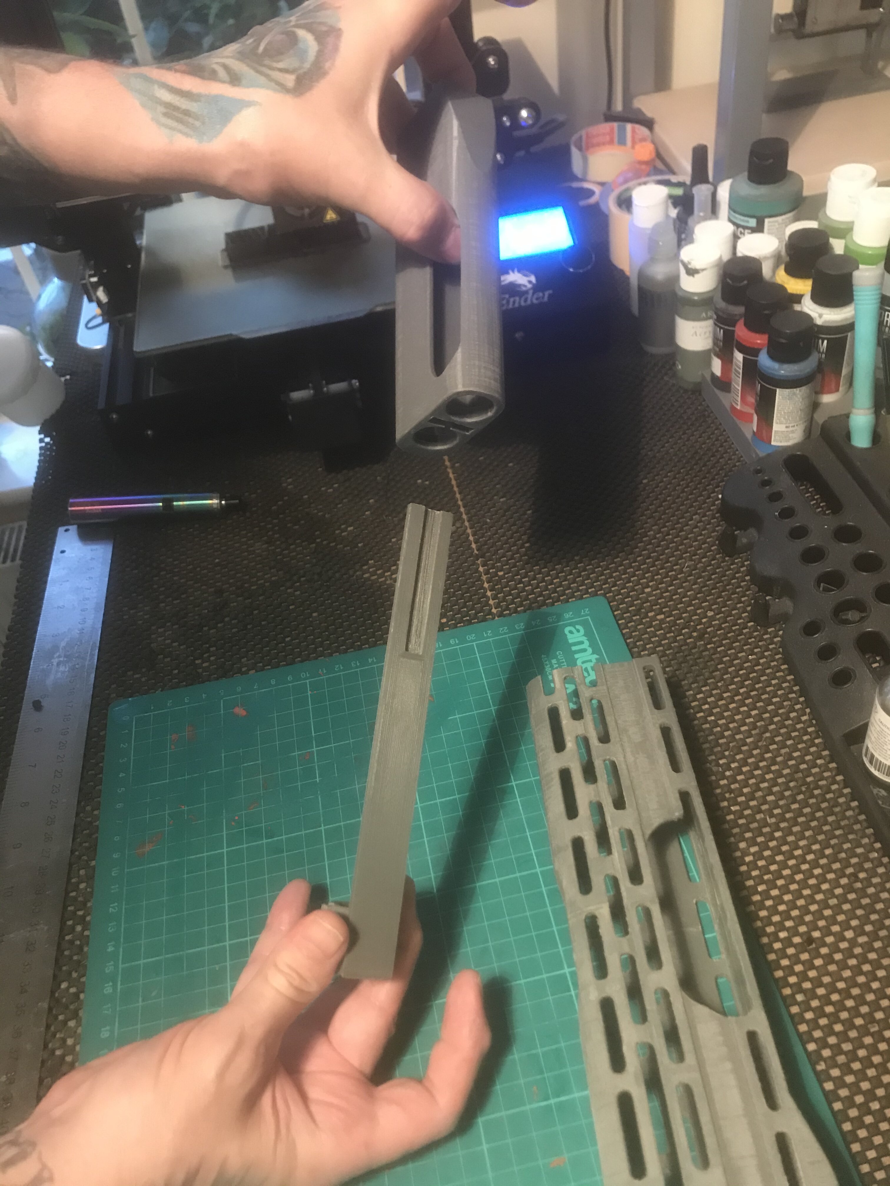

Some pics showing how to remove/replace the Remington bolt on the slide

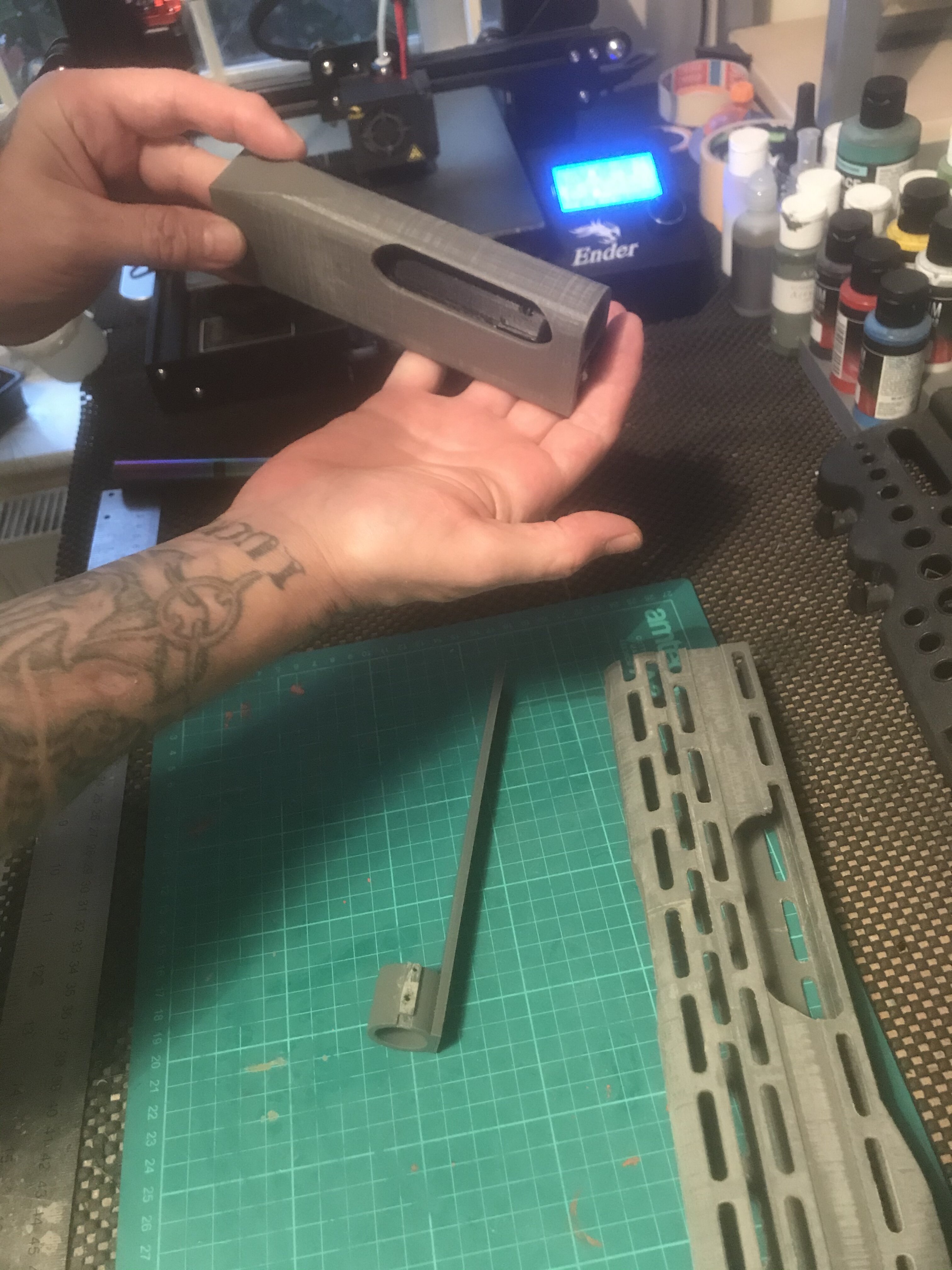

Printer already back to work on the front section of the left hand shroud.

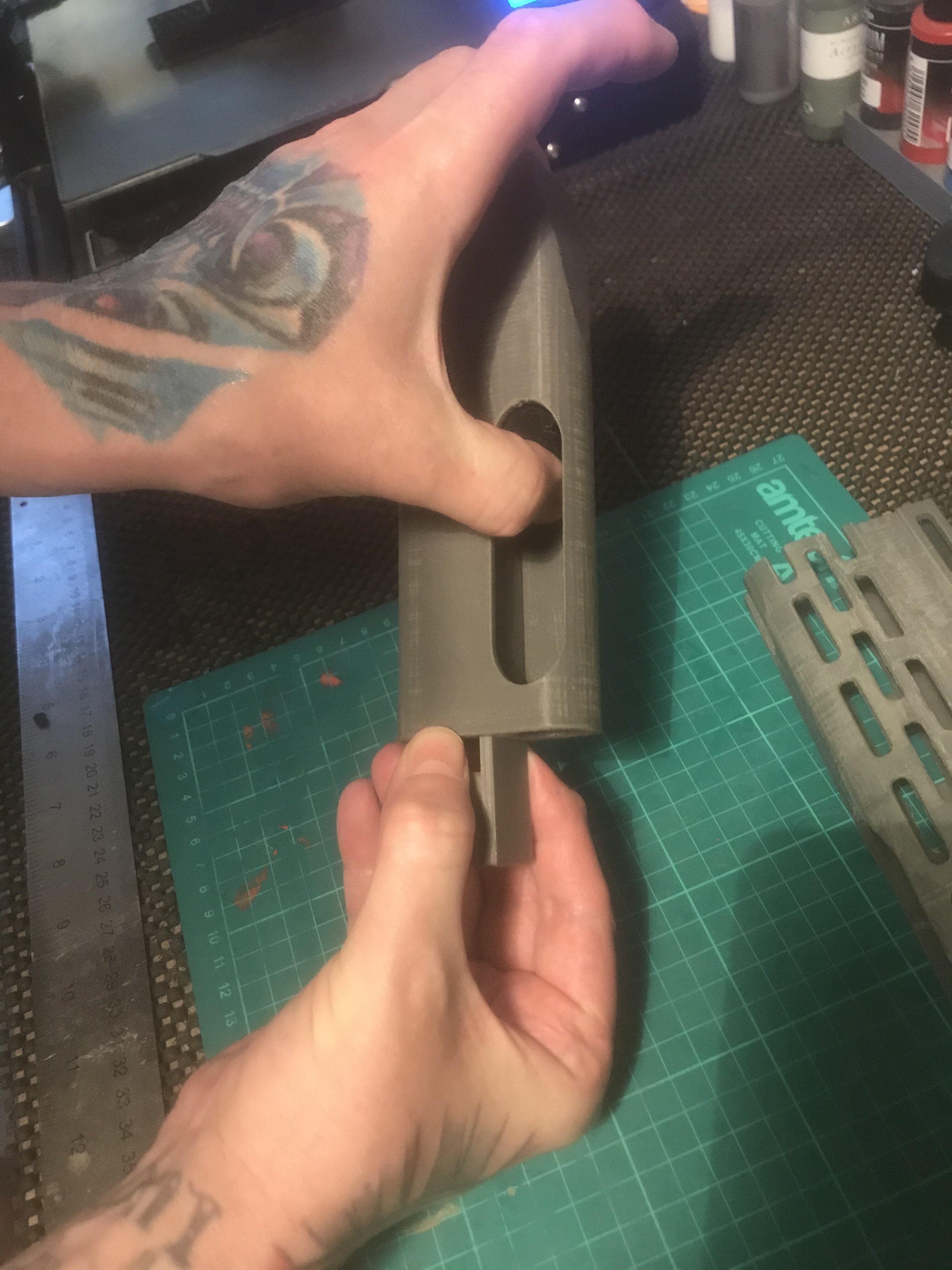

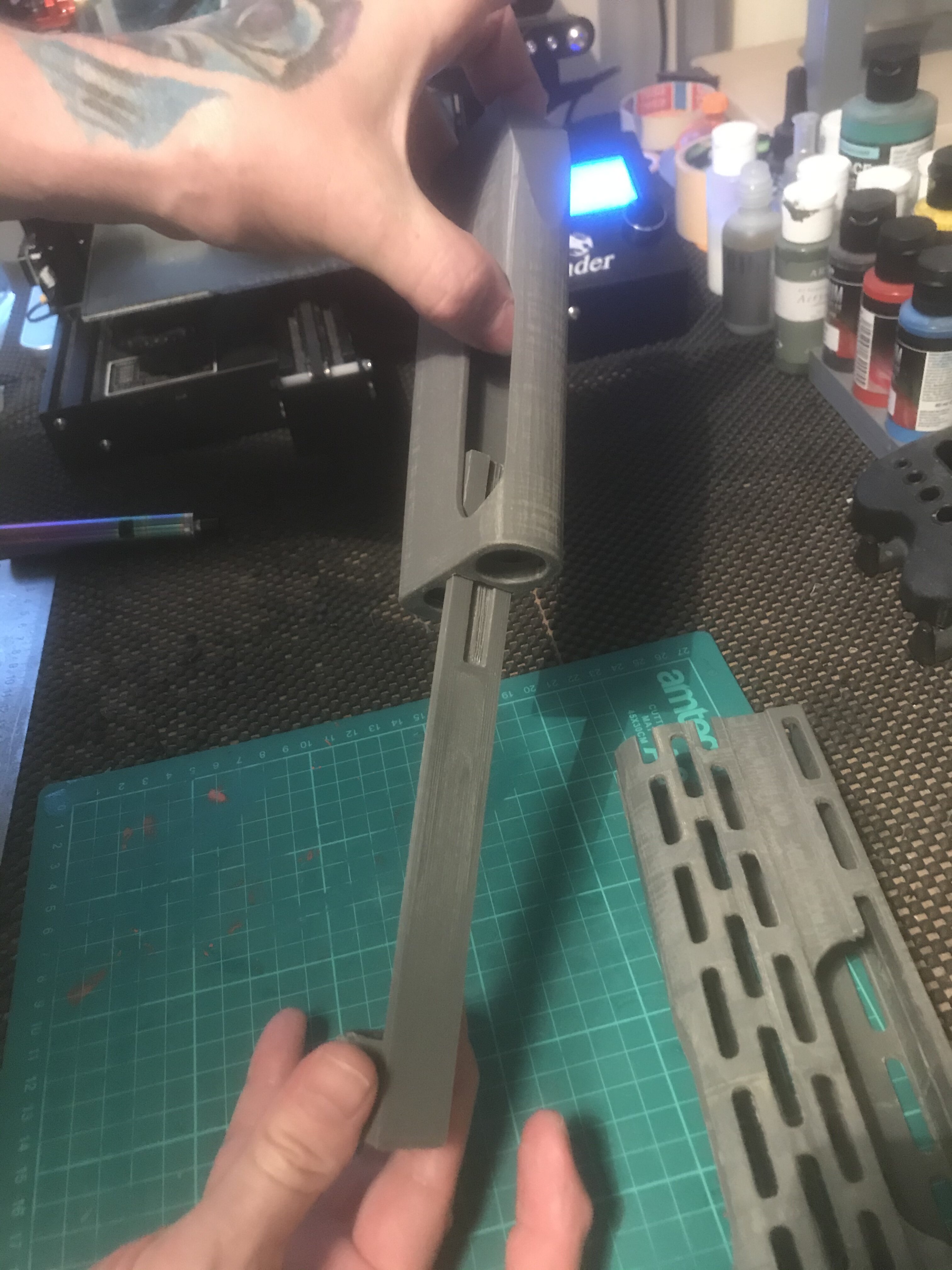

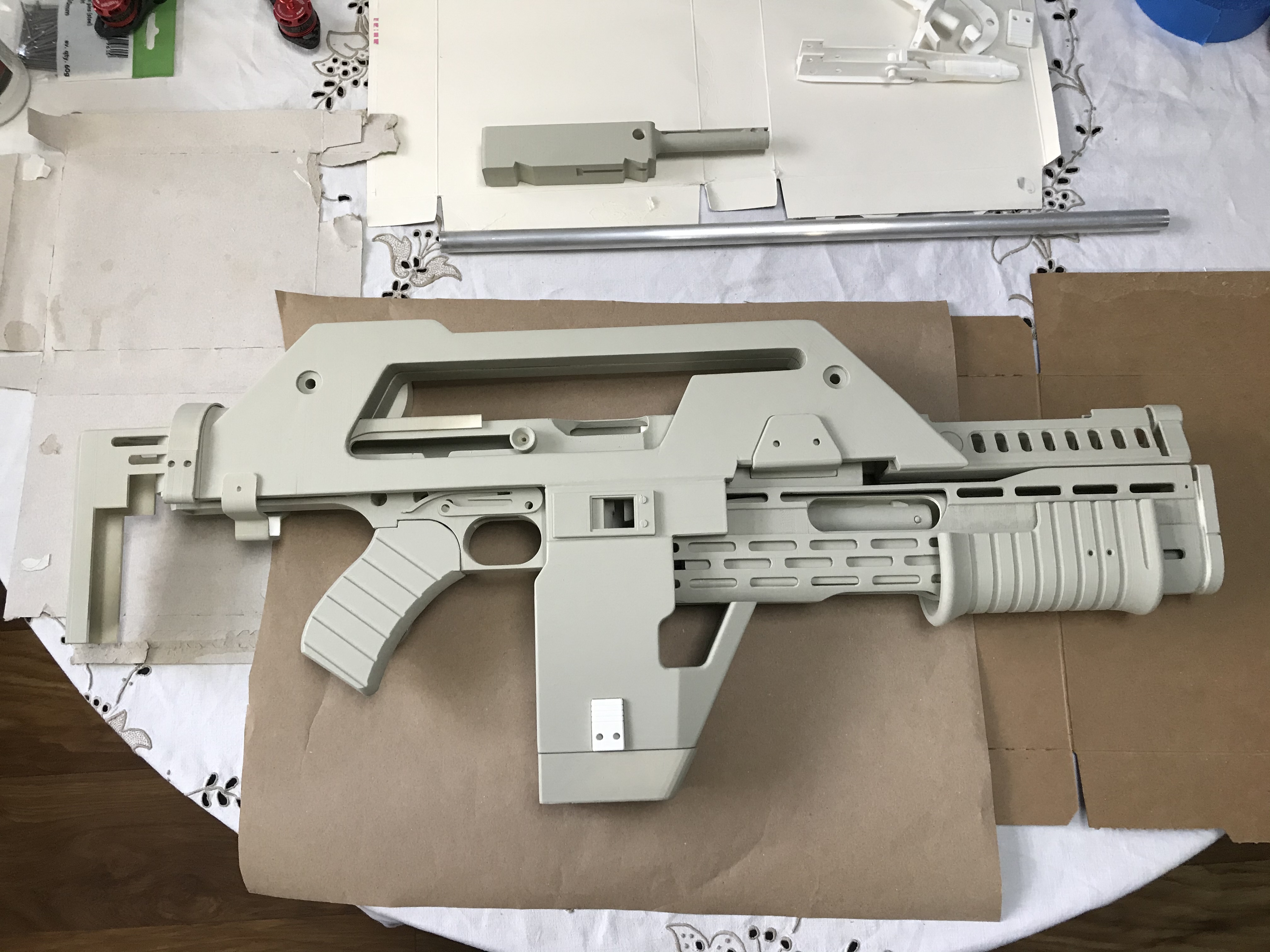

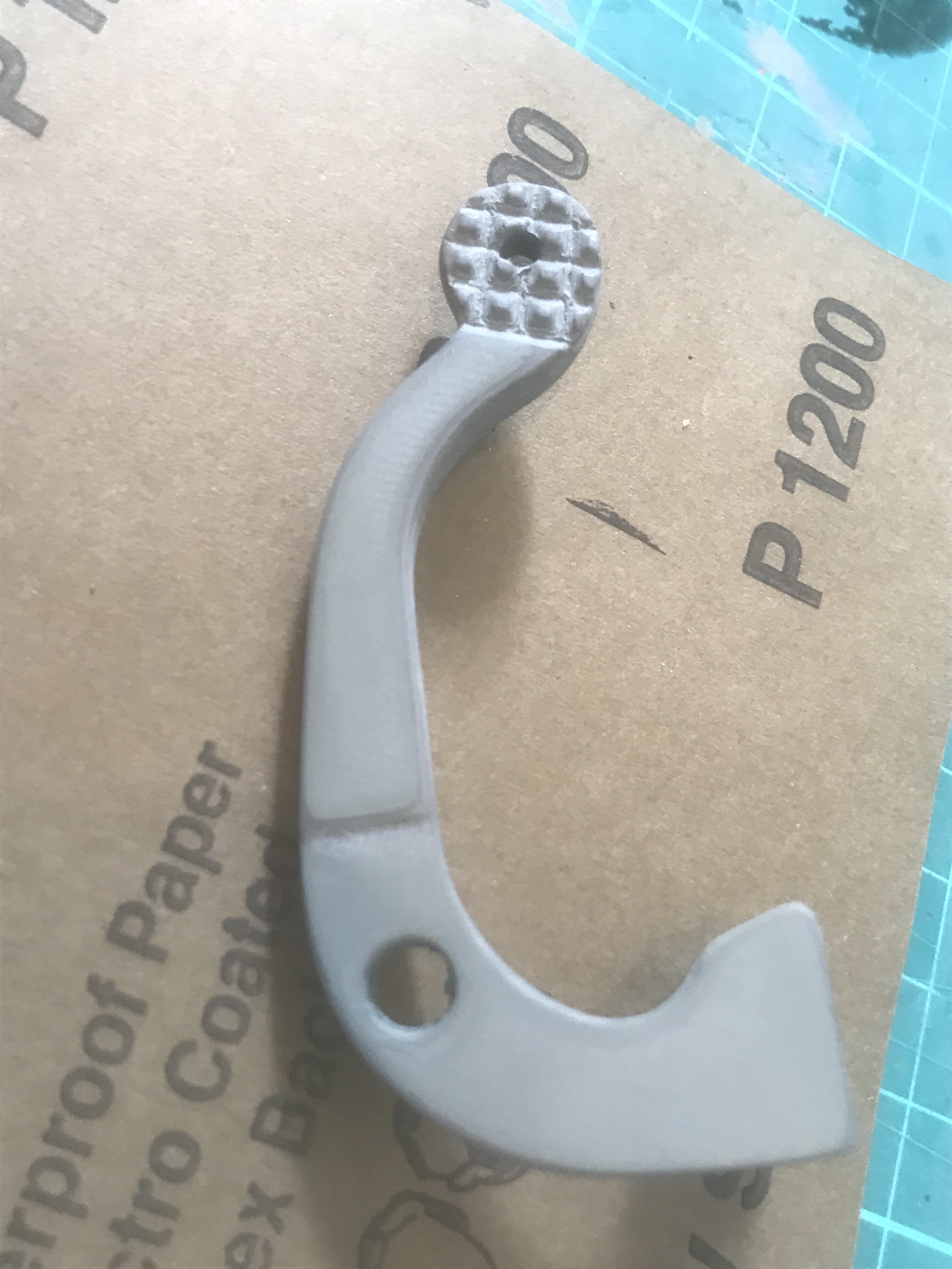

Have been sanding and filing for a while.
Couldn’t resist a progress test fit.

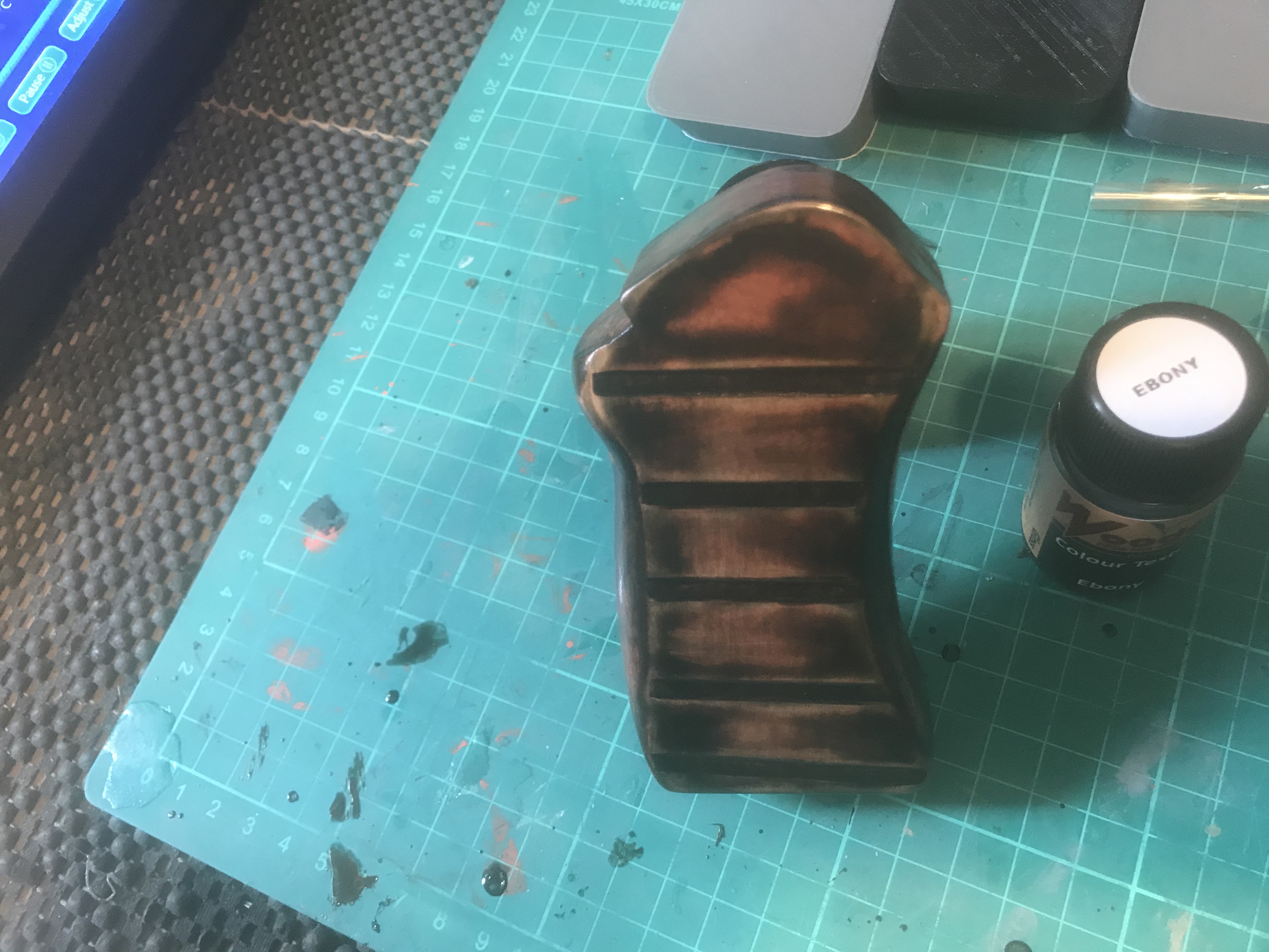

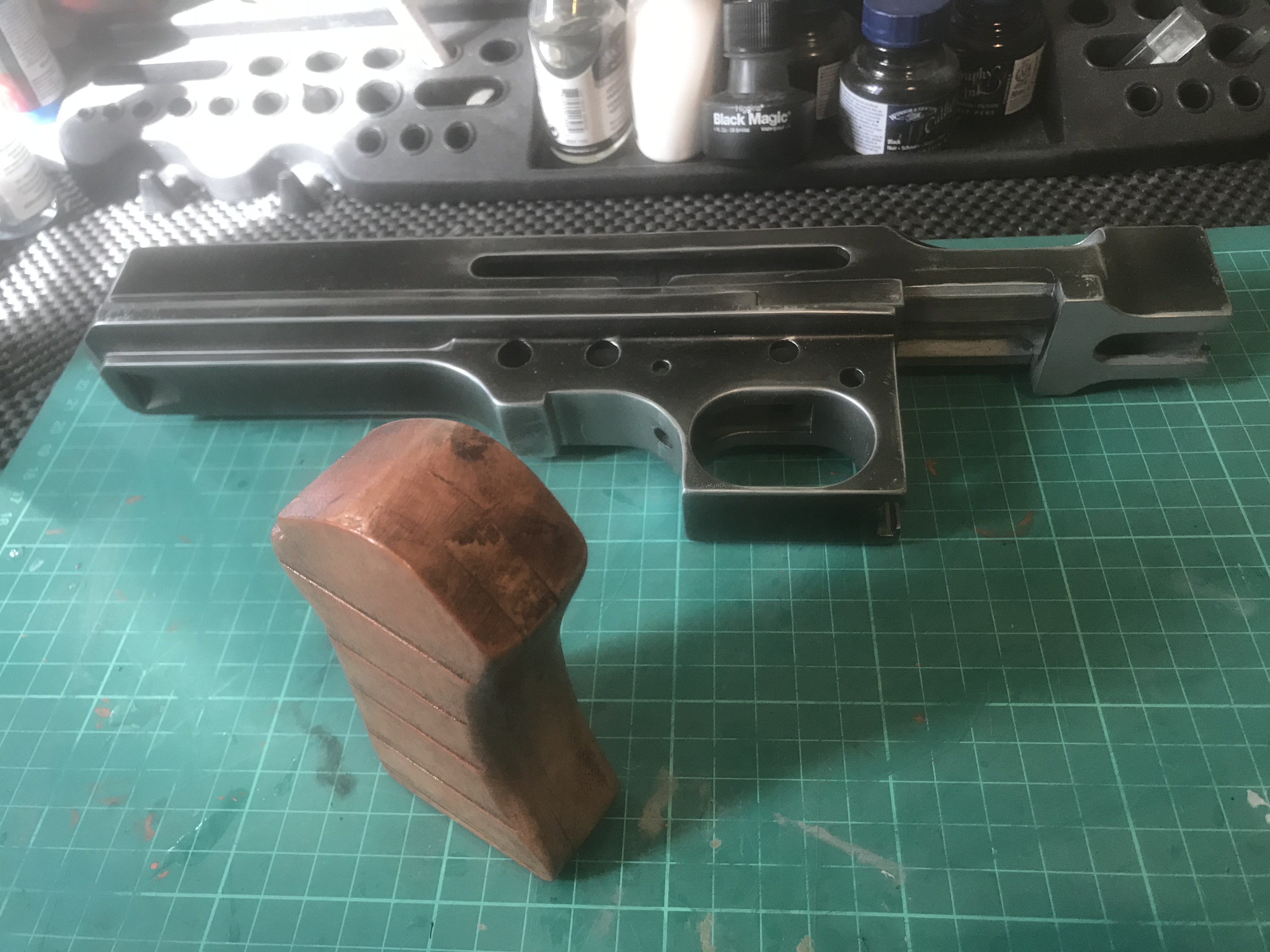

crazy good finish dude. I must be doing something wrong as i never get anywhere near that

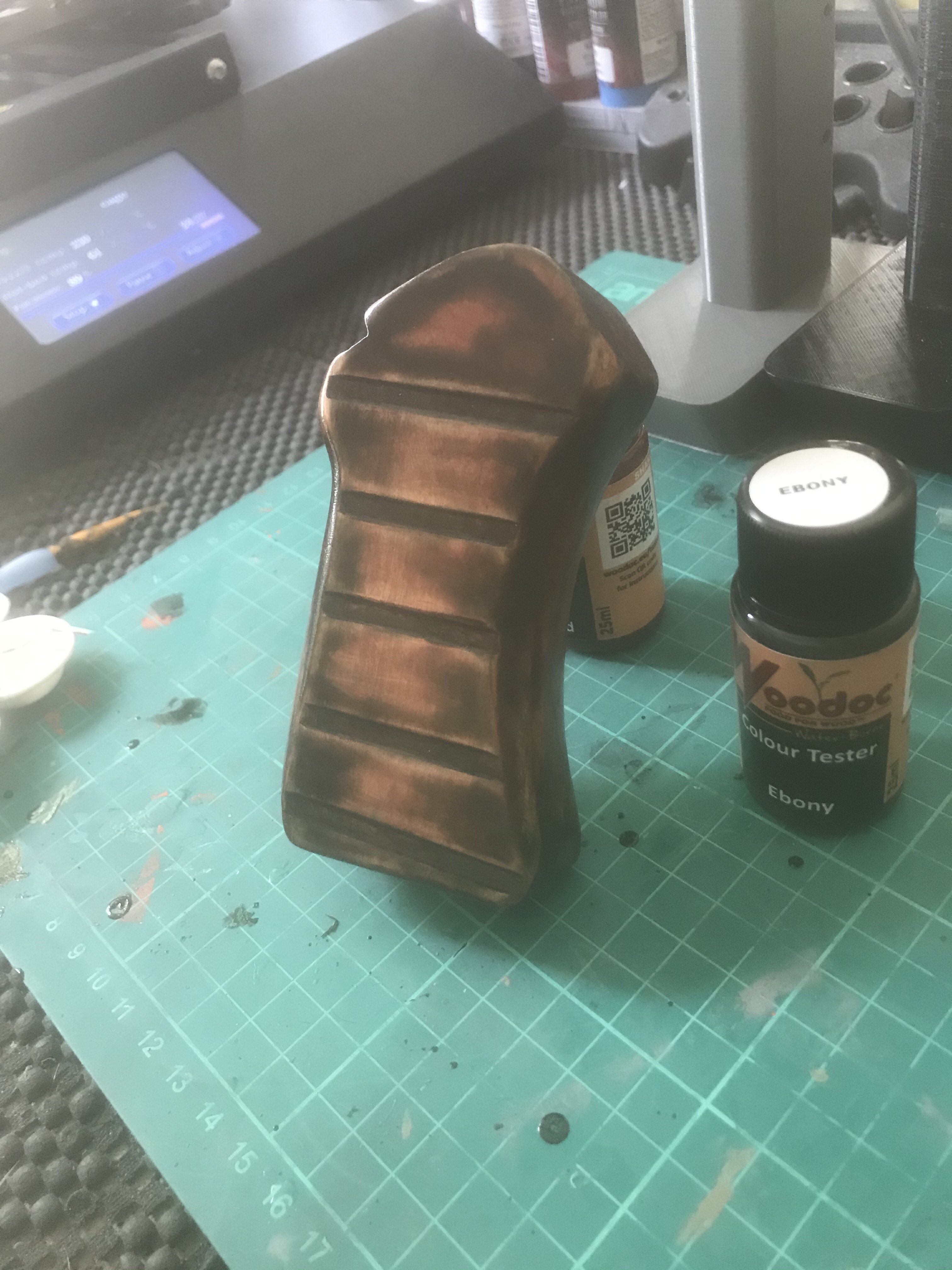

Thanks fella, it’s just done by using a tough base coat, I use Krink Graffiti ink which more or less stains the primer silver it’s that potent..it can even be buffed up without fear of wearing it away, you can then put whatever paint on top and and then expose the Krink silver by light sanding/small wire brush/ alcohol dipped rag to get a weathered effect..seal it with a clear coat and the jobs a good’un...
so do you do all of the multiple coats of filler primer and sanding stuff before your base coat?
cheers
Yes mate, you want a silky smooth finish on the primed surface before you apply the Krink, for the Thompson I then diluted Higgins black magic ink with alcohol 30/70 and kept wiping the areas I wanted the Krink to show through, I kept diluting less and less up to black with each coat until I got the desired effect..

Have been sanding a filing for a while.

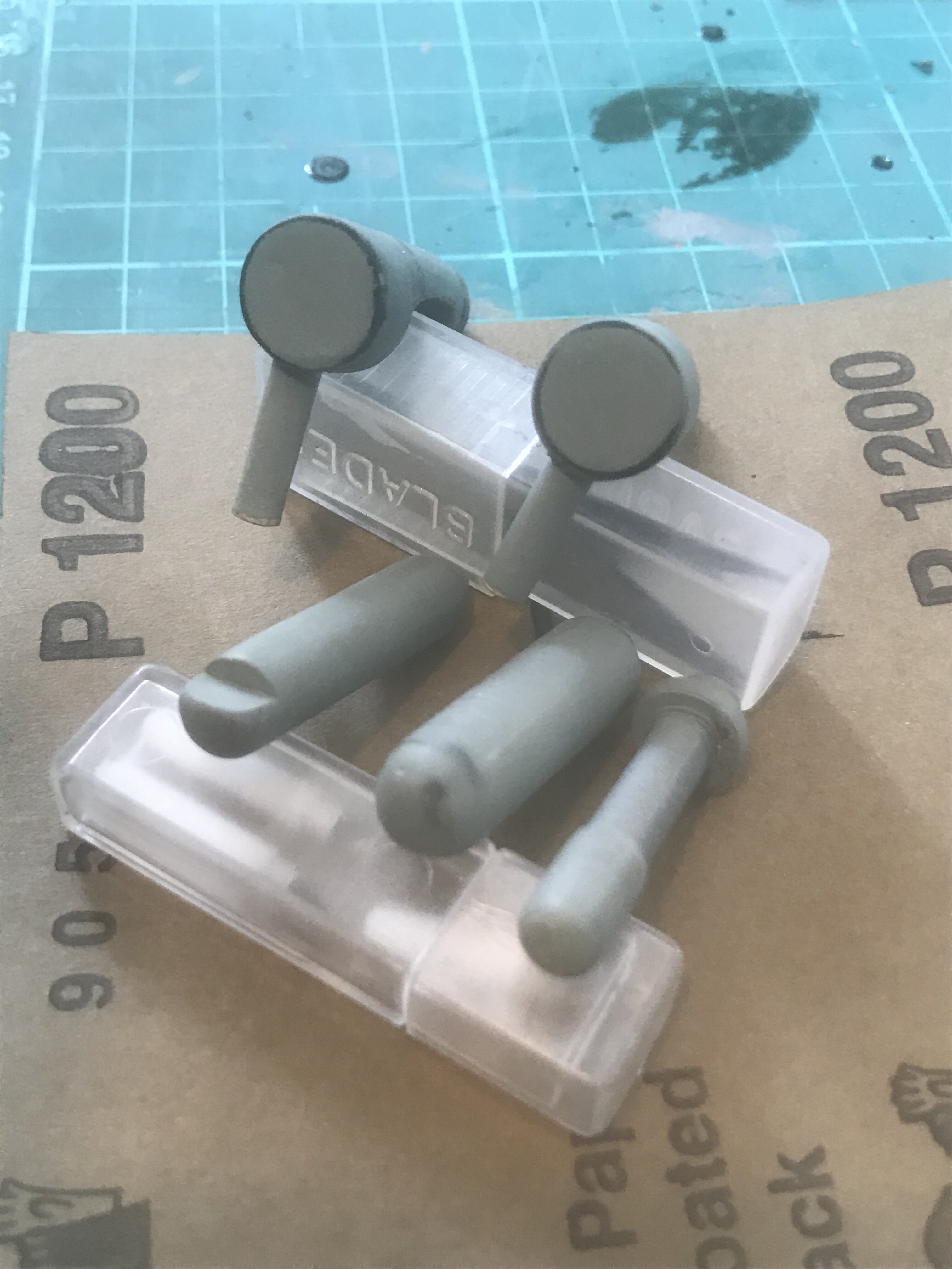

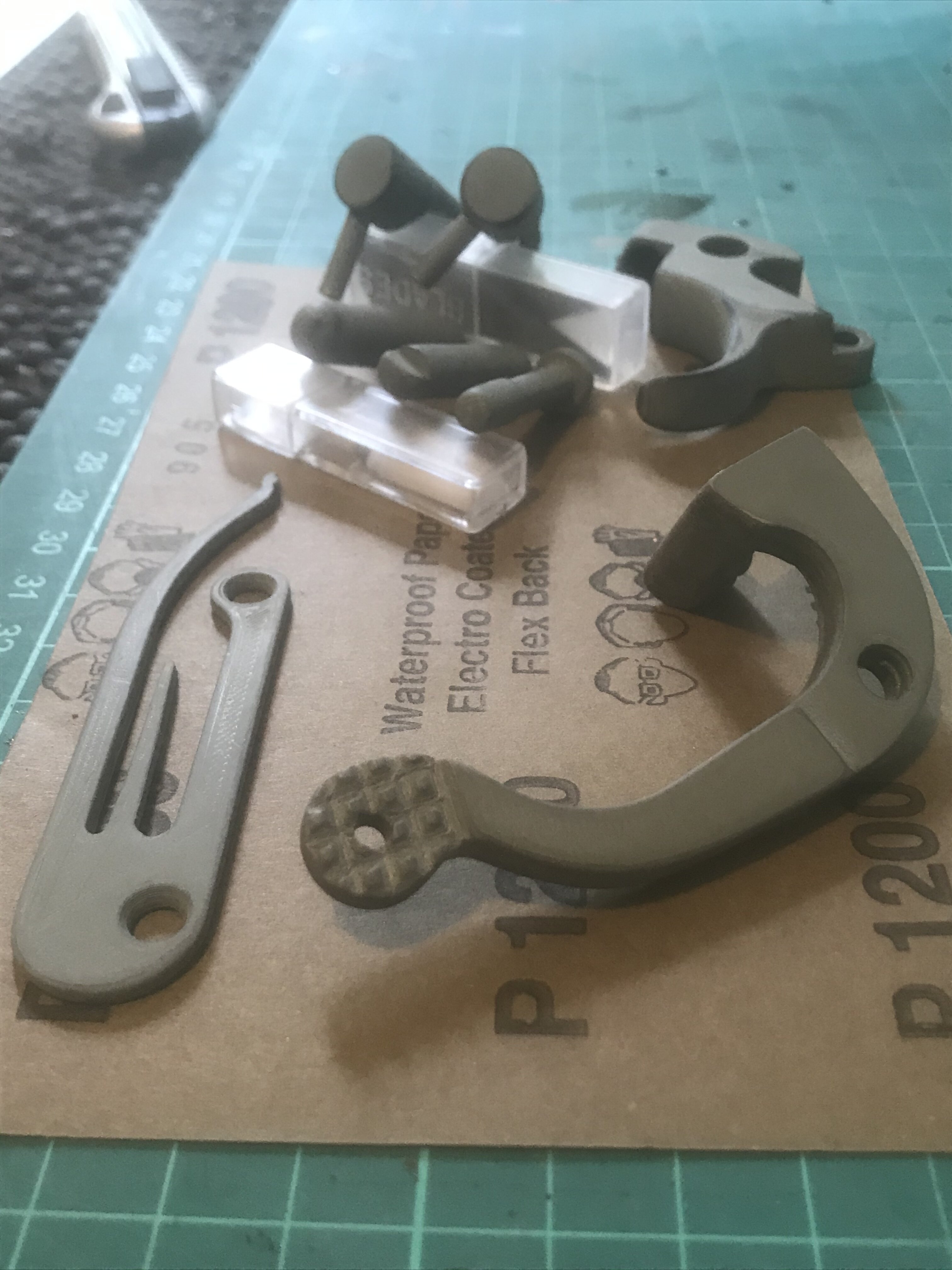

Currently printing the Thompson Bolt then it’s just some of the smaller internal parts left to print.

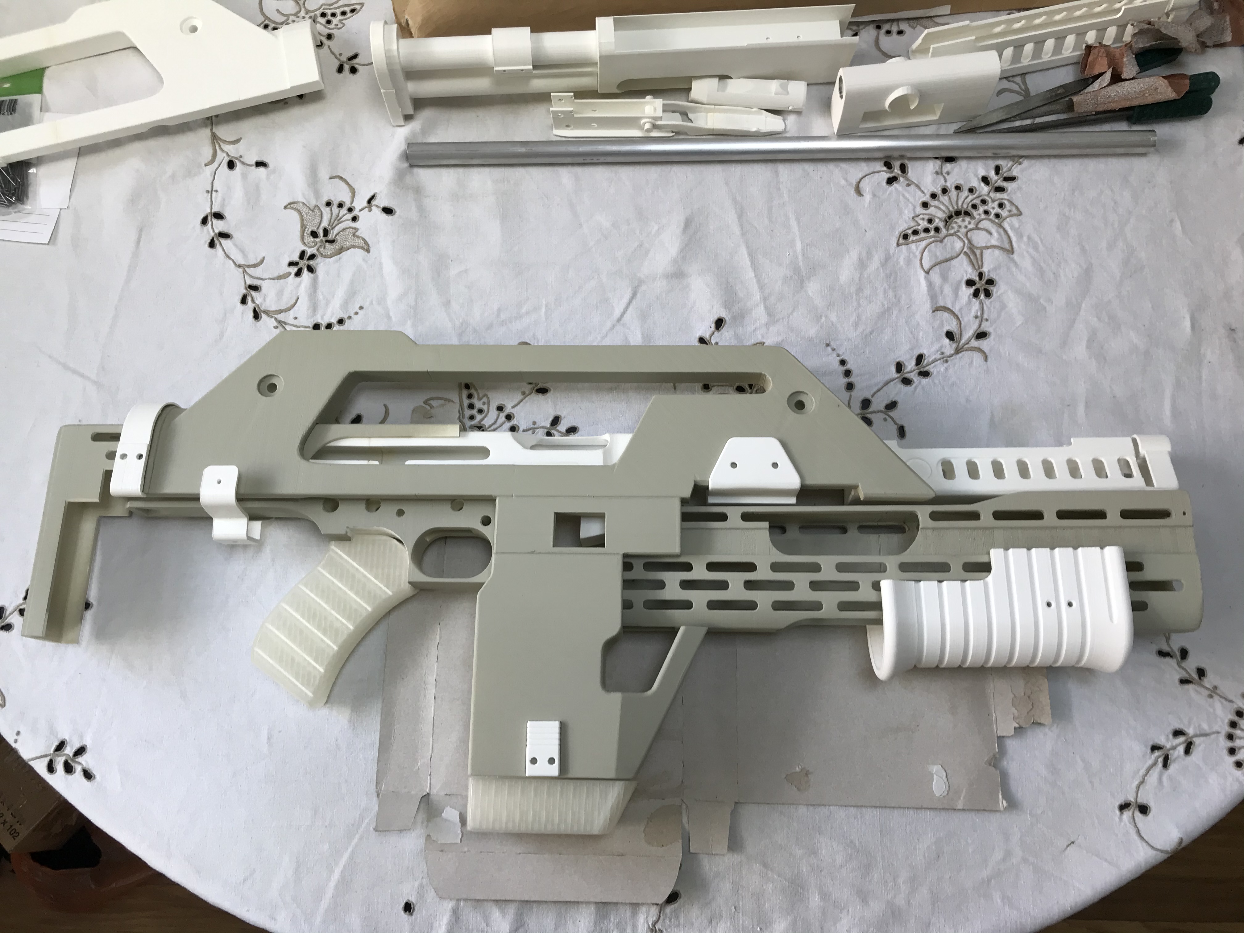

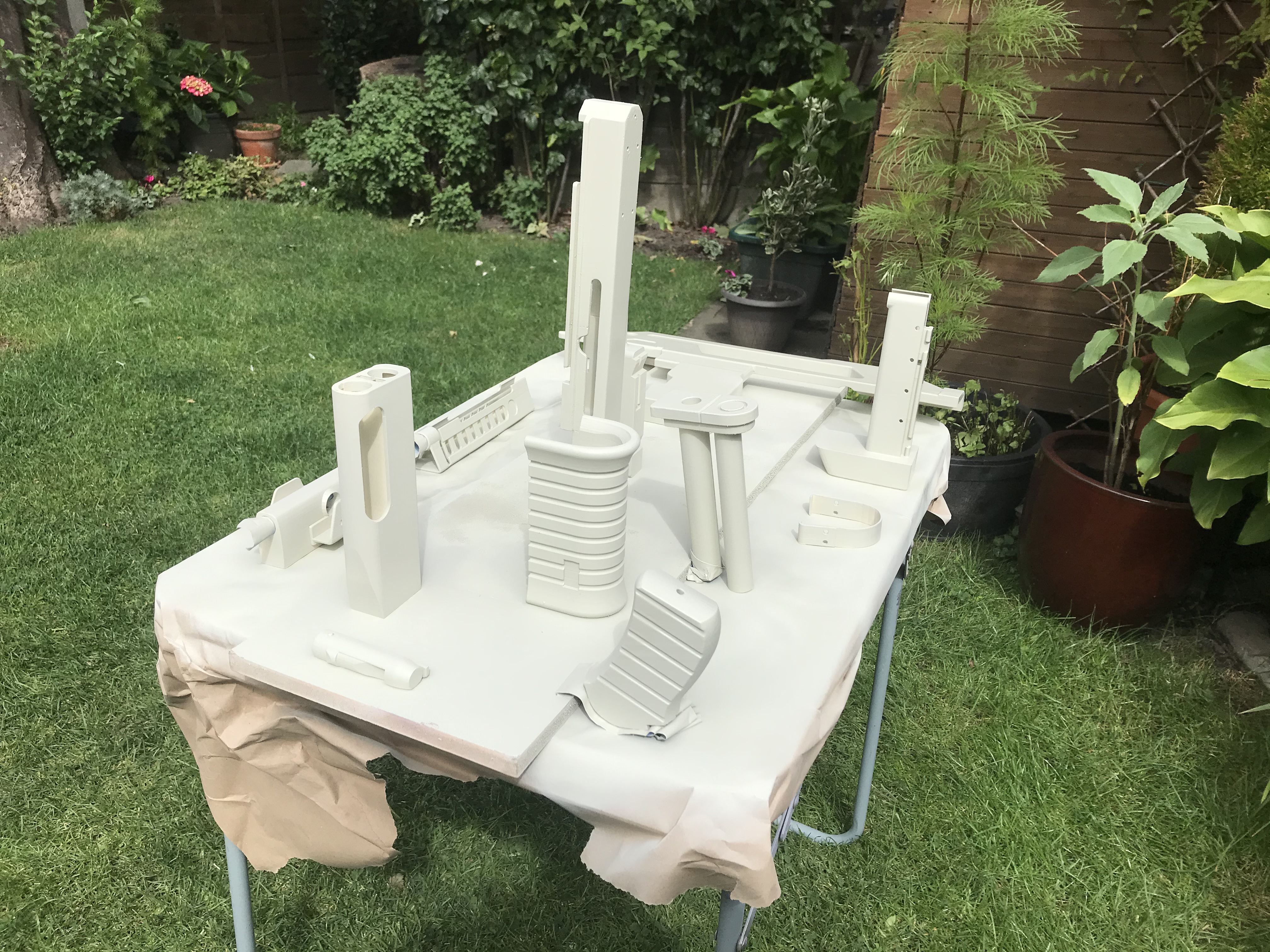

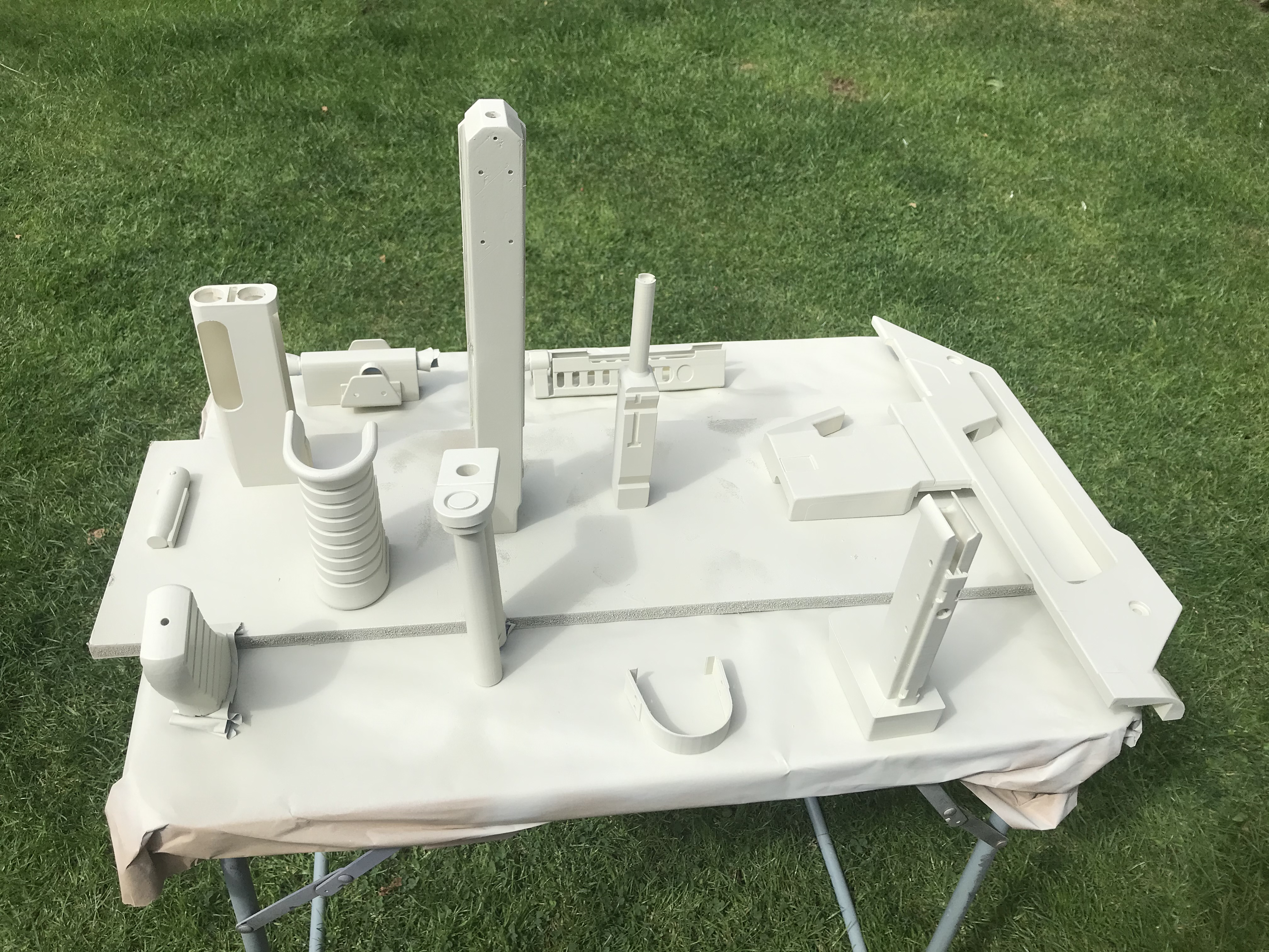

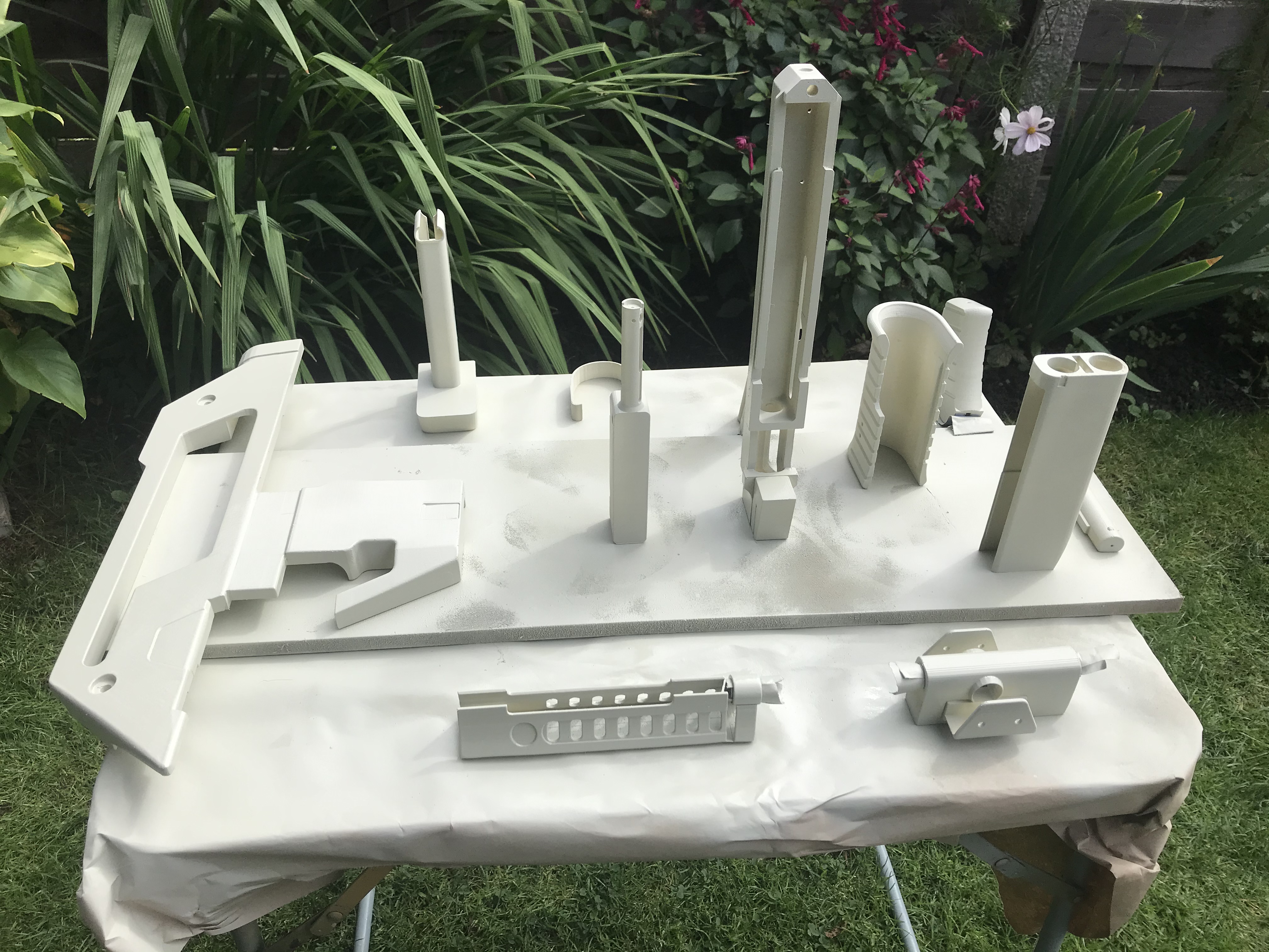

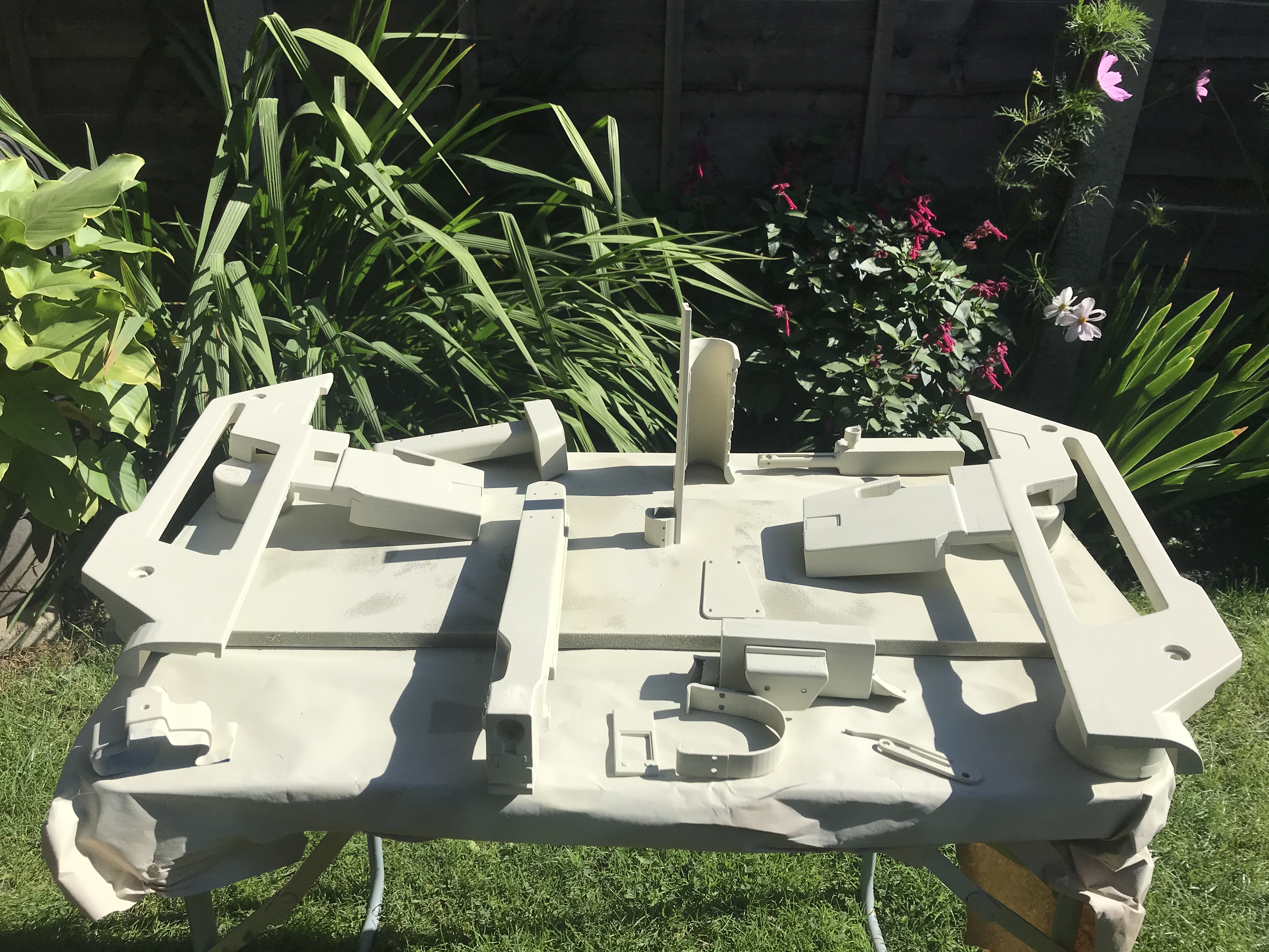

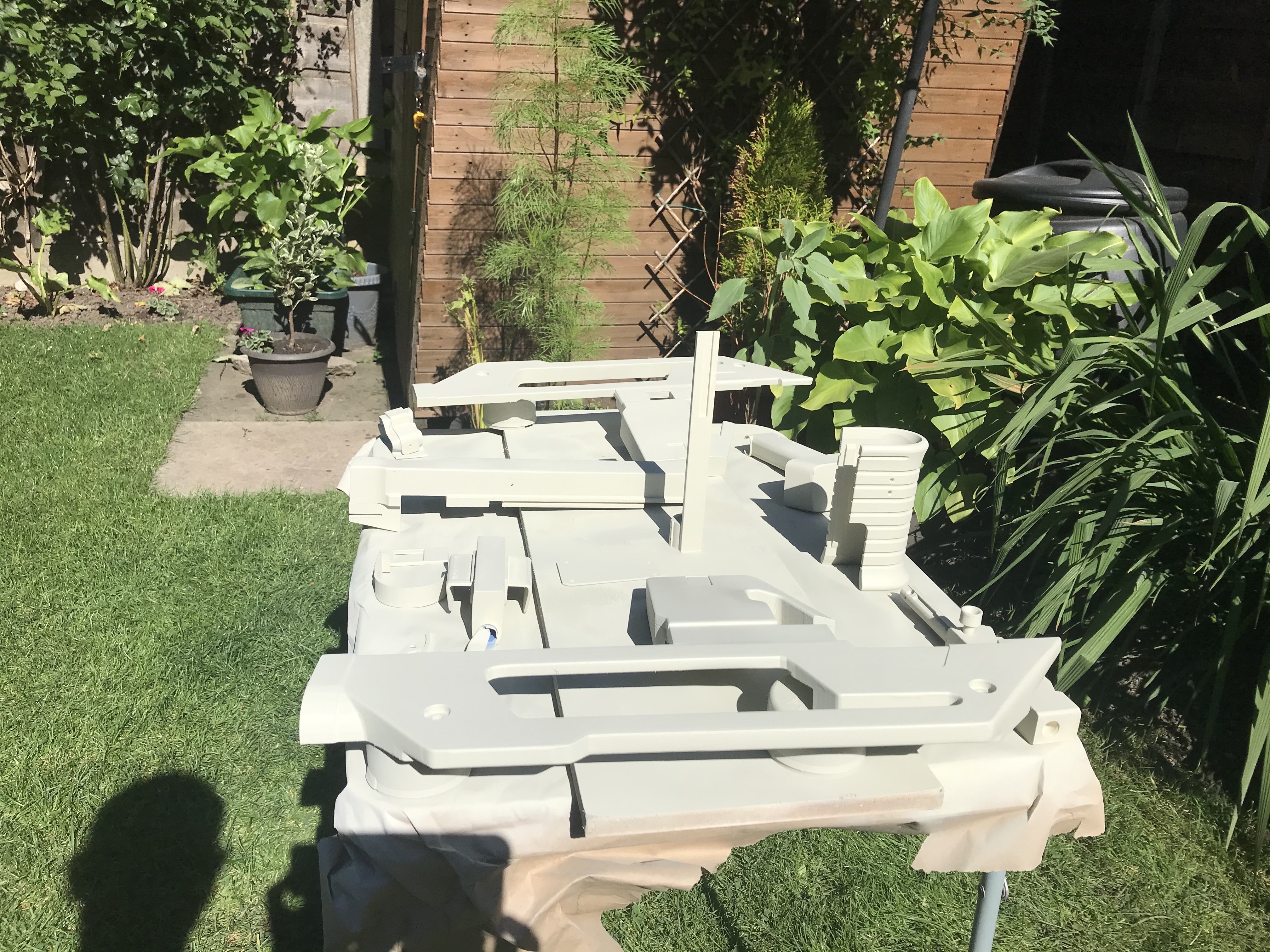

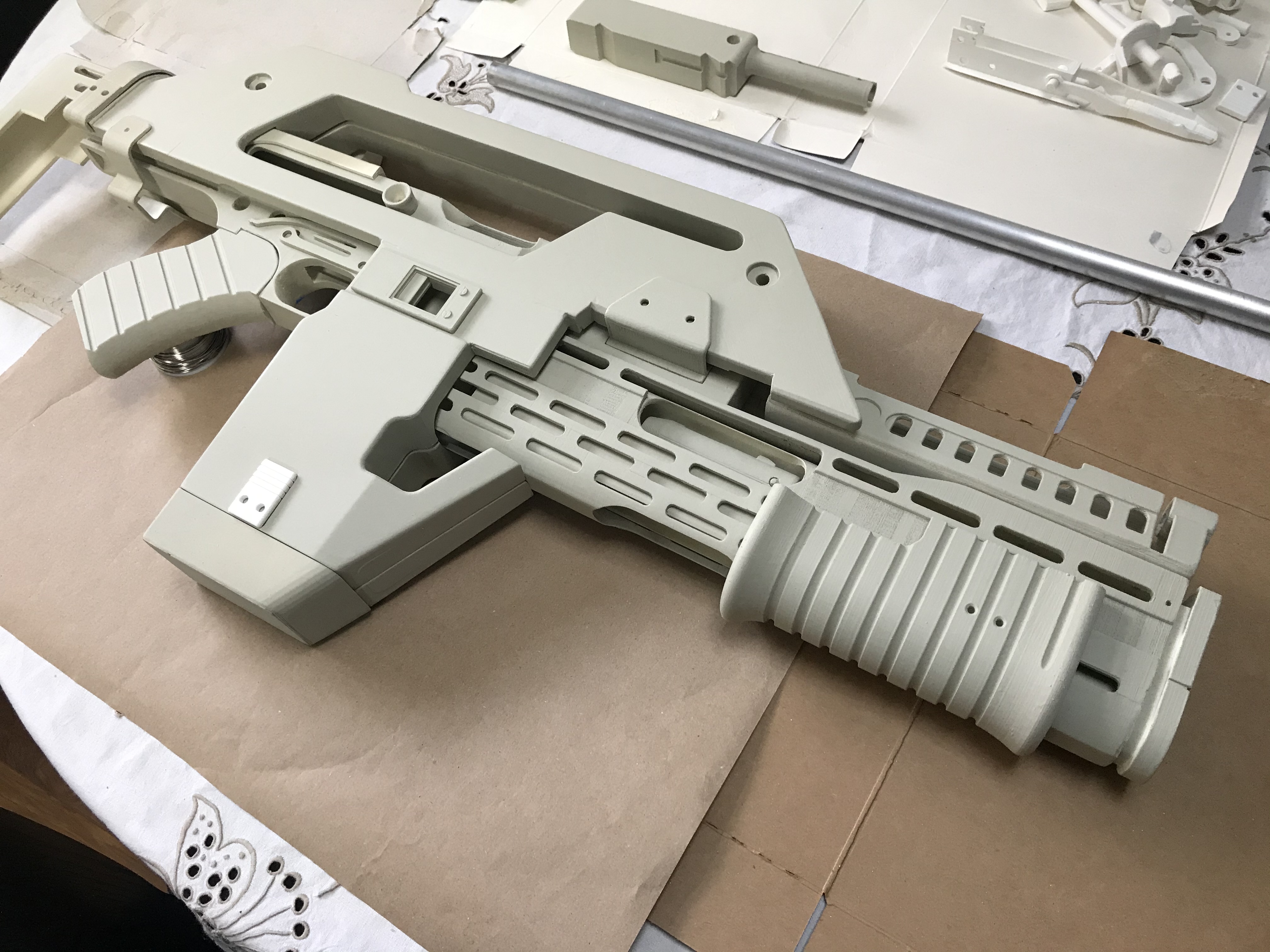

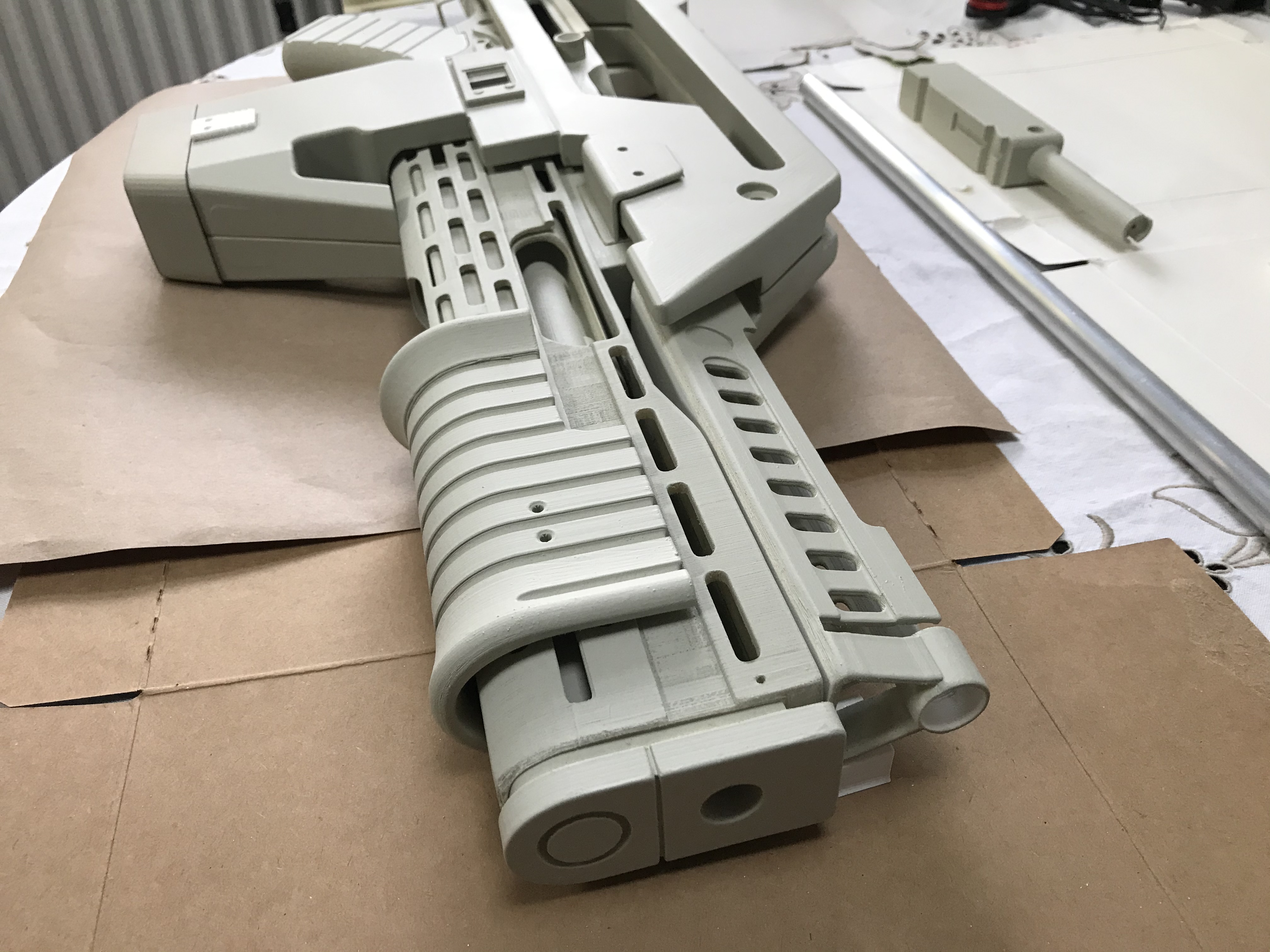

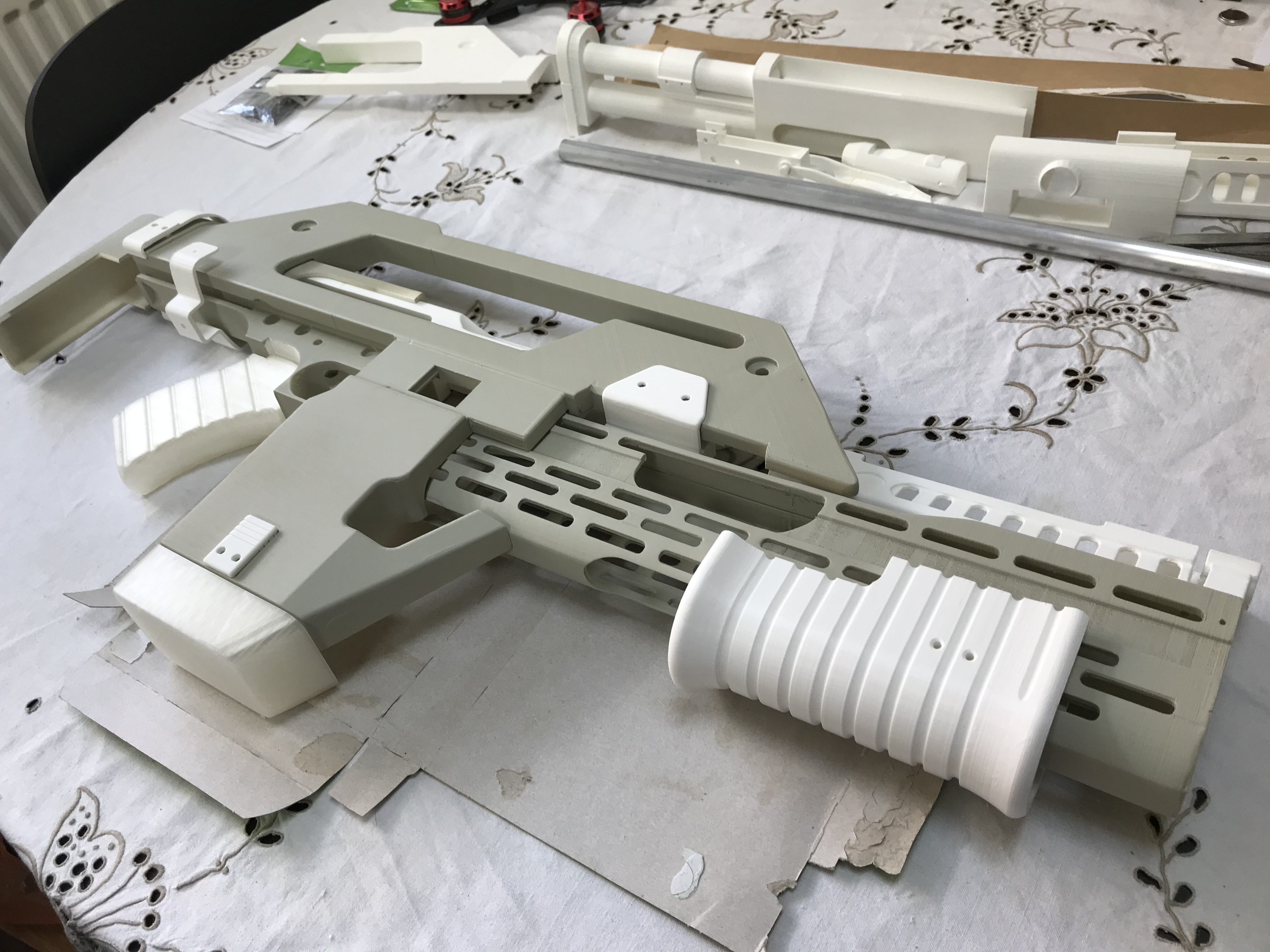

Made the most of the good weather today and got busy with the spray putty.
Yet again, I couldn’t resist a dry fit, definitely taking shape now.
The weather is looking a bit rough tomorrow, so it’ll be plenty of sanding parts, working on internals and cutting the barrel to size.
