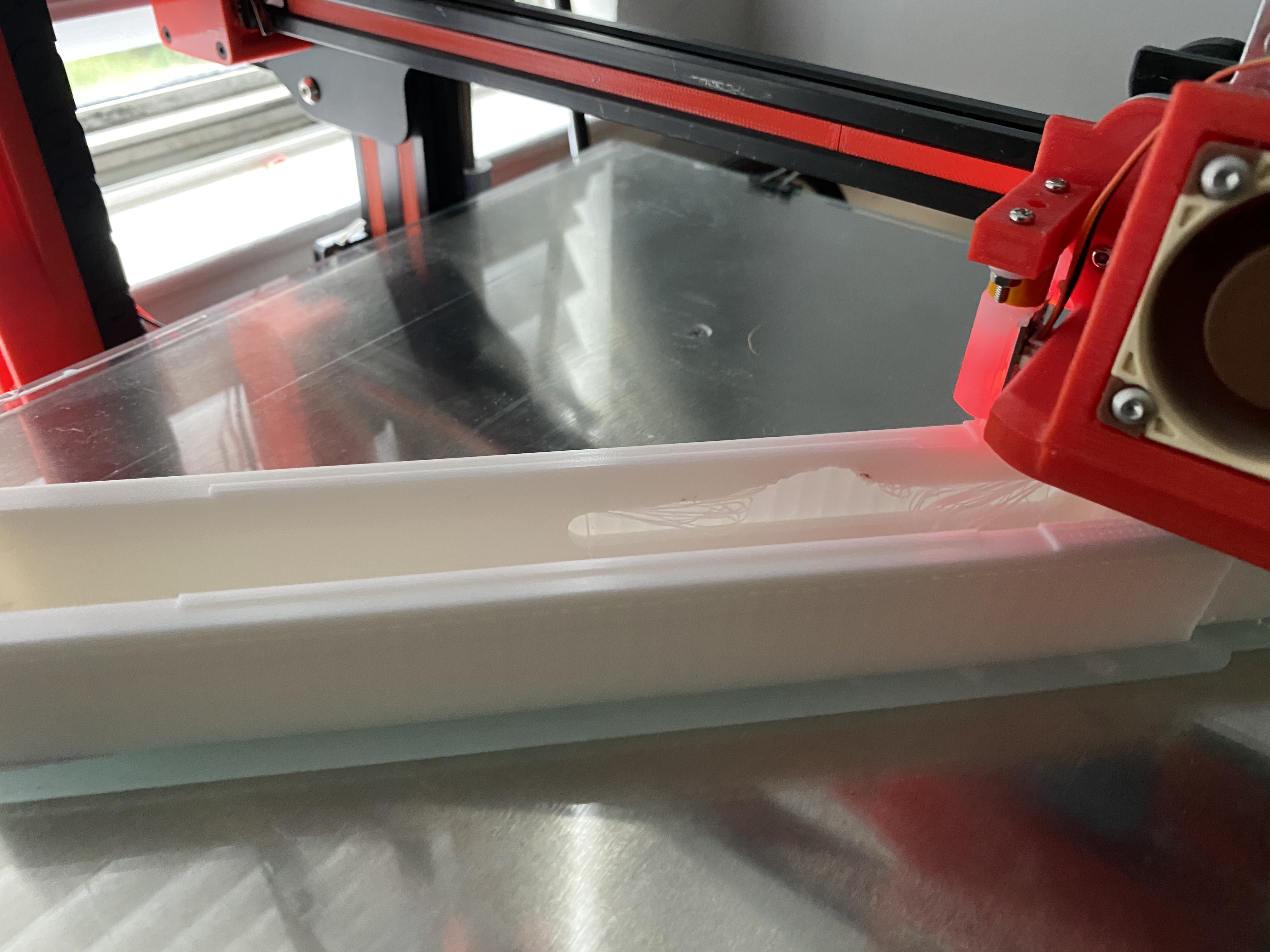

SO I have run into a little issue - 100% my fault, but In printing the upper receiver, the slot for the bolt handle got screwed up in printing. I printed the receiver with the top laying on the print bed and supports for only what touches the build plate (using cura). Just curious on what your settings are and/or how you print the receiver.

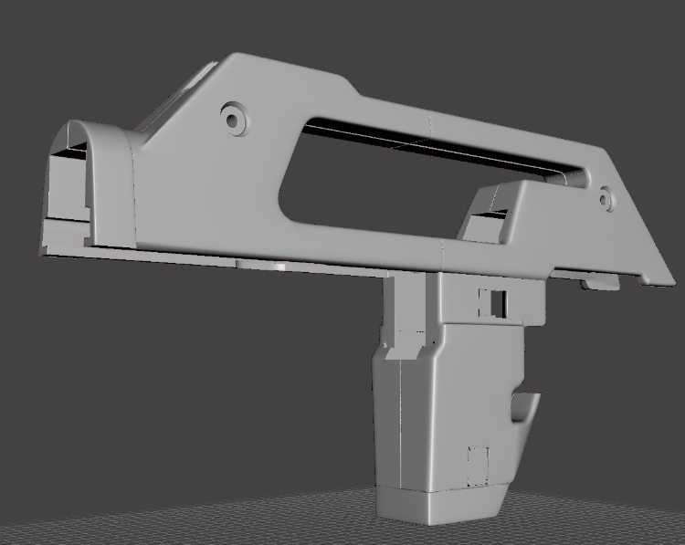

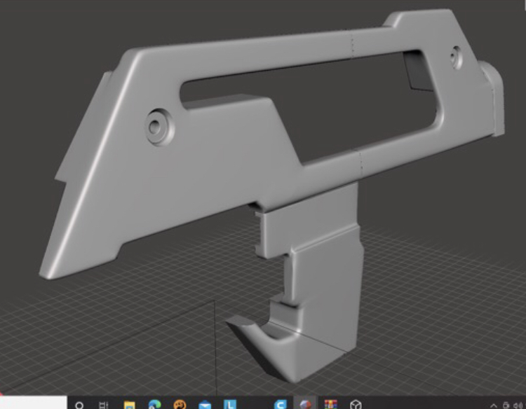

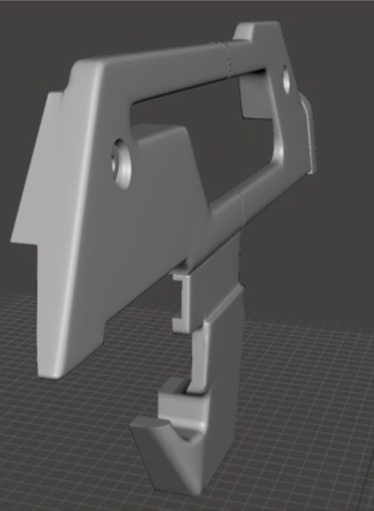

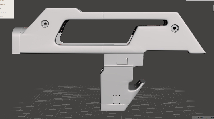

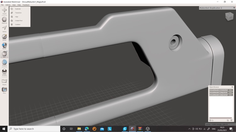

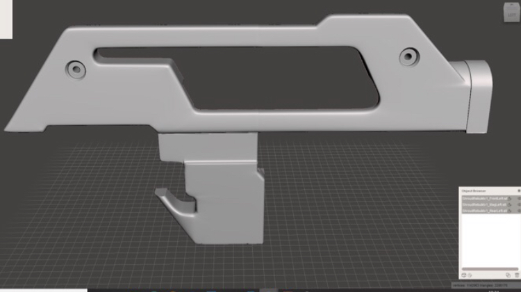

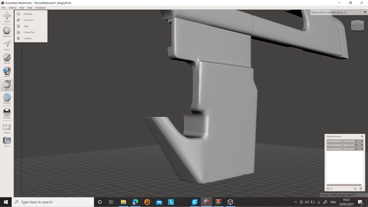

New Mk3 shroud nearly ready for resin printing then mould making, it’s going to be cast in tough urethane resin, will come in both Aliens and Alien3 commando versions. Accepts a real spas12 heat shield and a real or Airsoft Thompson and my printed variants.
Recess for a metal plate(s) in the mag well for that metal on metal sound when the magazine is inserted.
Support set at 80, pla+ nozzle temperature 235, bed 60, same orientation in your pic with a brim.
