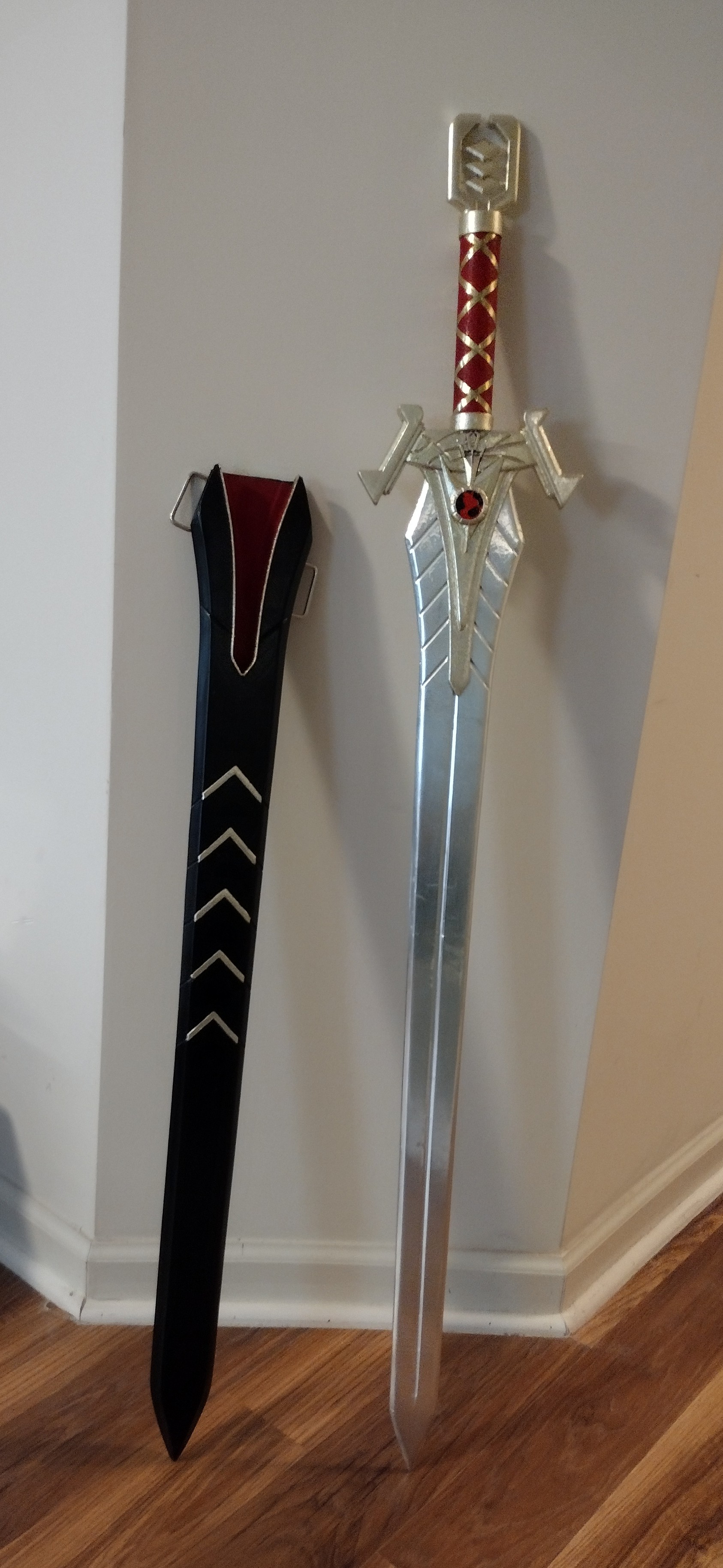

Hi, I am currently making a sword prop from a videogame and I'm trying to use a Silver Dupli-Color Chrome Effect Spray Paint for the blade.
The color is perfect for what I'm making, but the paint itself is pretty weak, it can leave fingerprints and dents really easily.
I wanted to ask if there was a way to proctect the paint since I'm planning to bring the prop outside. (I heard that clear coat does not like chrome paint, but I still have to test it).

I was newver happy withany of the clear coat options for blades. When I did my Emperor Georgio sword from ST: Discovery, I ended up using adhesive backed metal foil used in AC duct work. Fingerprints wipe off and it can even be polished to some extent.
