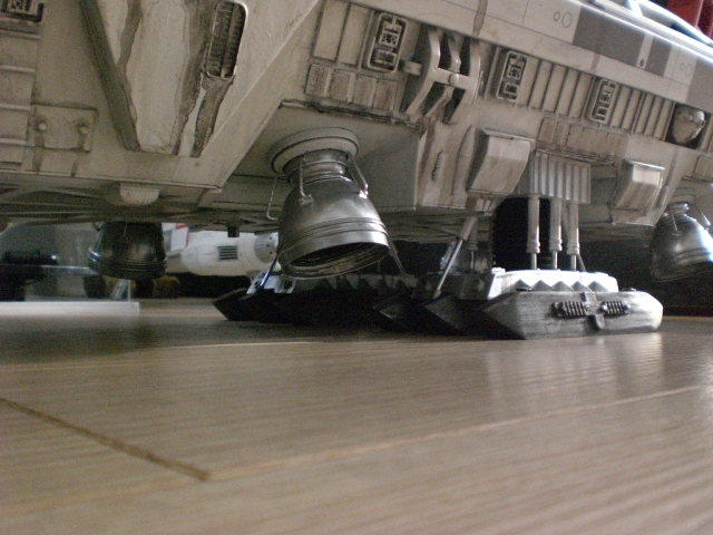

I did my 2OO1 Moonbus' bells with Molotow chrome pens (quite a few years ago) and I didn't have a problem with fingerprints or any other issues.
I didn't spray a clear coat of anything on them (mat, satin, gloss or high gloss). It was first sprayed with a mat black (Rustoleum) and dabbed with Molotow chrome pen after 48 hours.

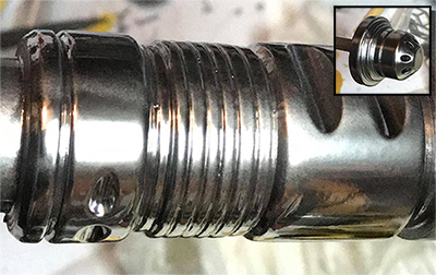

Orville blaster "emitter":

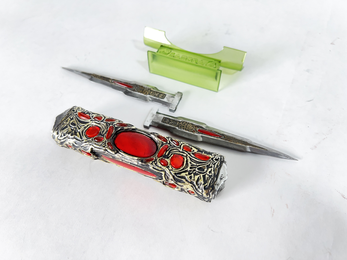

Grip of Gamora's knife (the gold part is a candy coat and the blades are alumaluster):

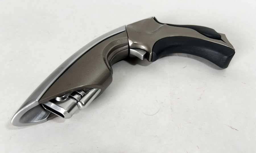

Star Lord blaster parts:
Don't get me wrong, I love the Alumalusters and Alclads too... I just tend to use them more for aluminum-look parts, or parts that need to look weathered and scratched.
