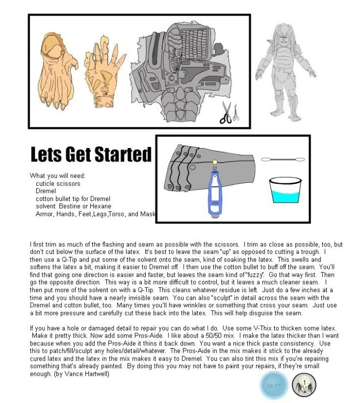

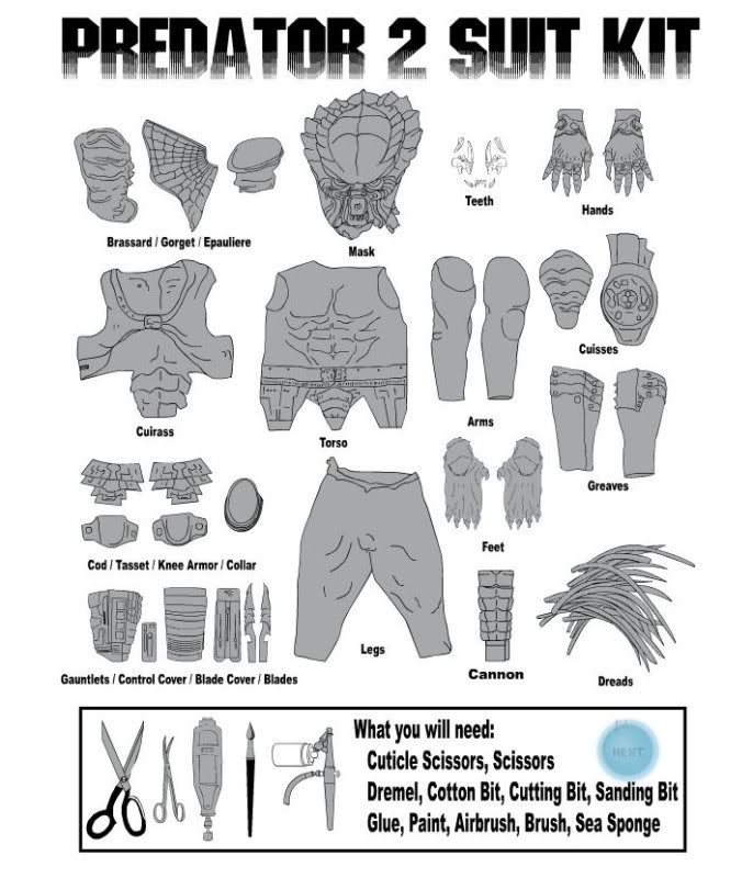

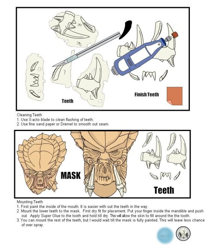

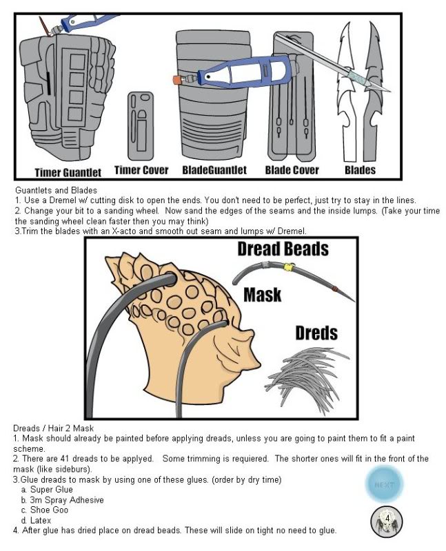

Back in the day when I was getting my suit and assembling it, I got the template of instructions from TMI. It shows how you can customize the suit to meet your own needs and how there are different ways of putting stuff together. This shows just how much work goes into a Pred suit and its really just basic info...tip of the iceberg...

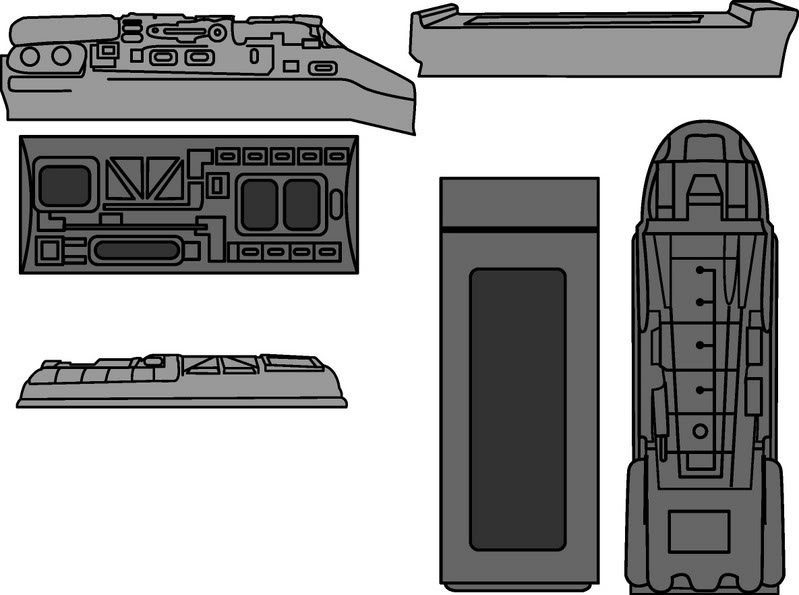

Gauntlets:

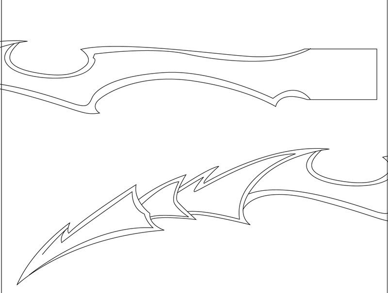

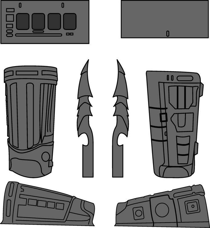

Don't know who did the blade designs, but here they are:

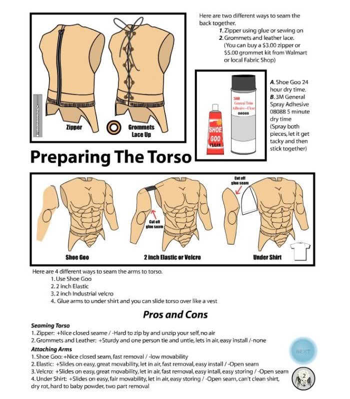

Some extra ways to make the torso fit
*Press fasteners (sport+camping) which are hammered in a 2 leather strips which you glue and/or sew into the back. Give enough air and is easy to fastnen you need only one person to fast them.
Preparing the torso
* a mix of 2 inch elastic + velcro and a very thin bikeshirt (the black ones which are used by pro tour the France athletes. They are thin and they give loads of fresh air). Just glue and sew the elastic for the grip and use the velcro to thigten up further.
