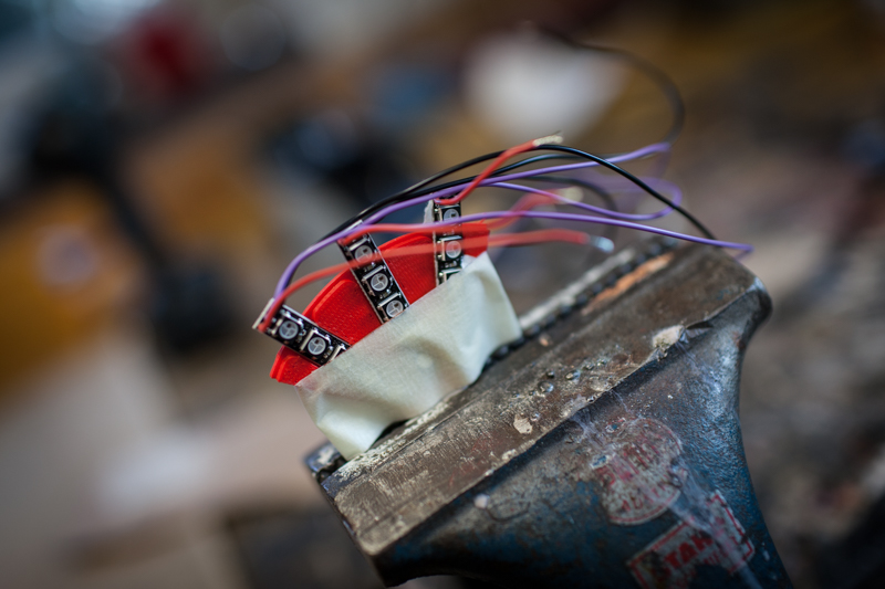

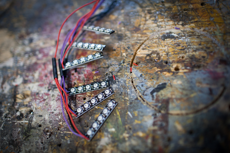

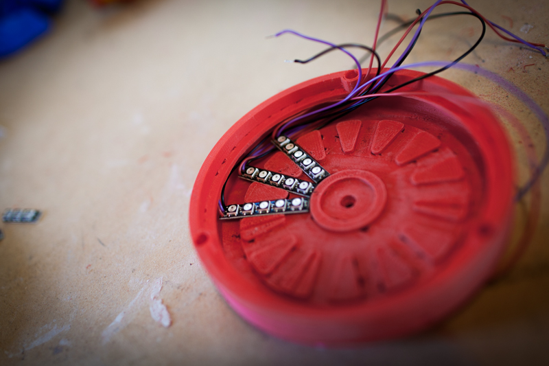

The star shaped indents are for putting NeoPixel sticks in there (which you already saw in action in the video in the post before). And the middle round slot is for having a round PCB with also RGB LEDS stuffed in there to illuminate the center of Wheatley’s eye.
After soldering cables to the NeoPixel sticks I printed a little helper to be mounted in my vise to easily align the LEDs and combine them to pairs of three.
And having them all stuffed inside the pupil and connected up the whole thing looked like this. A mess!

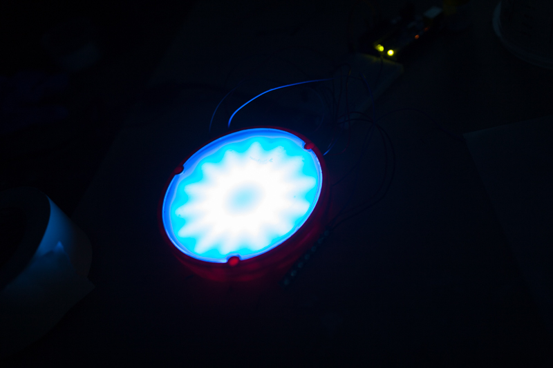

Of course there had to be something to cover up the LEDs and diffuse them in order to get a nicely lit eye. And at the best avoid any sorts of hot spots.
This was done using some smoked 3mm acrylic which was perfect for the job. I had to cut it first though to fit the eye. A quick sketch in AutoCAD did the job and the print was glued onto the acrylic ready to get cut.
Now… diffusing the LEDs is next. I was lucky to get my hands on some industrial used diffusion film which is AMAZING! Only 5mm above the light sources it removes and hot spots and spreads the light evenly.
The photo is horrible, I know.
Here's a video :) It looks kind of stuttery but the motion is quite fluid (damn you 30fps!!).
