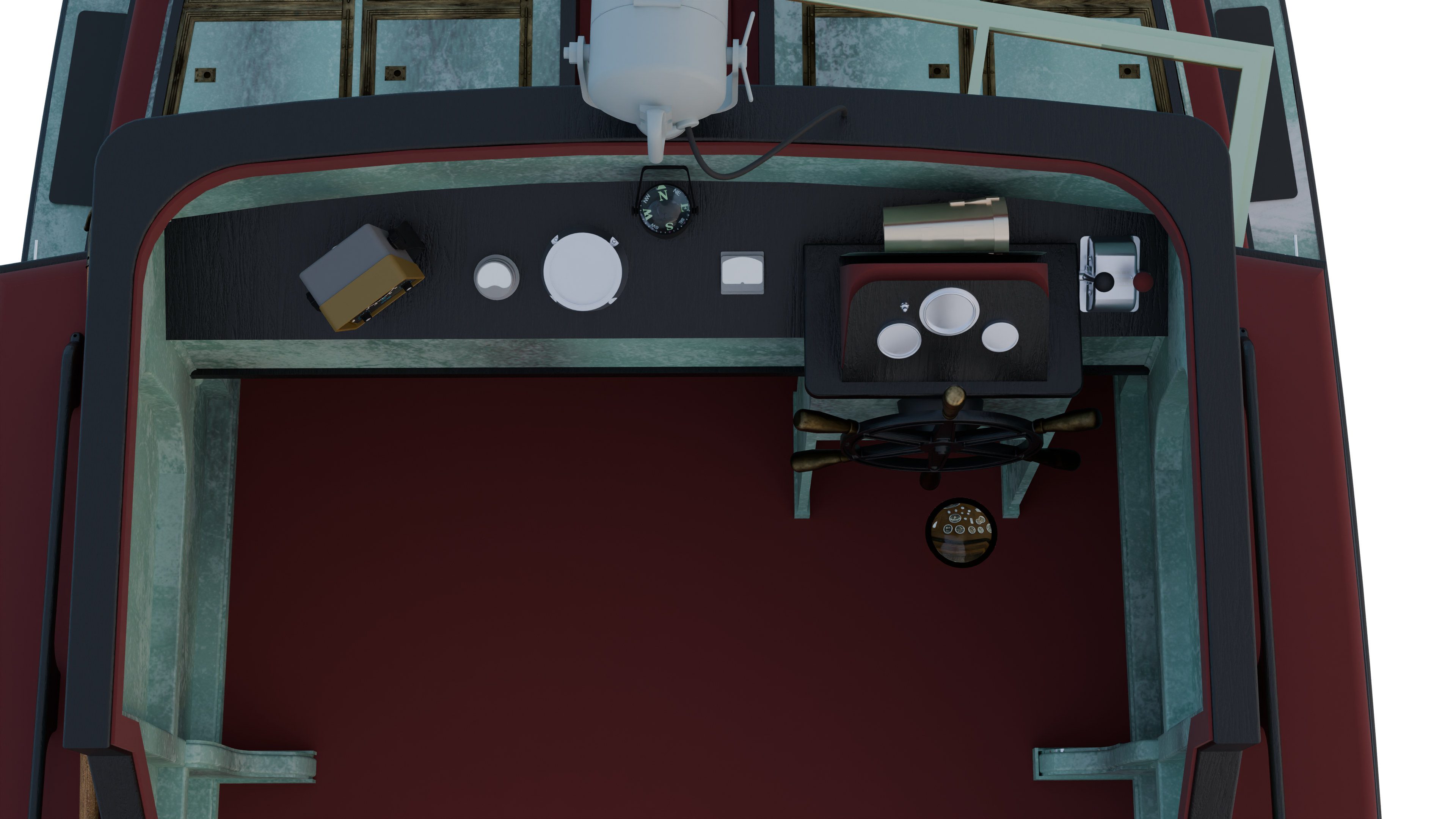

well now we know what the bulls eye is for. Some one said it was for keeping mould down with UV light but that never made sense to me as the windows are so big. but if your at the wheel up top it give a perfect reflection of the lower dials.
That's what the See Through does. Remember when you were building orca V1 and I said don't forget the see Through? In reality it's a magnifying glass. This part really needs to be in the correct location to do it's job. Pretty cool eh?

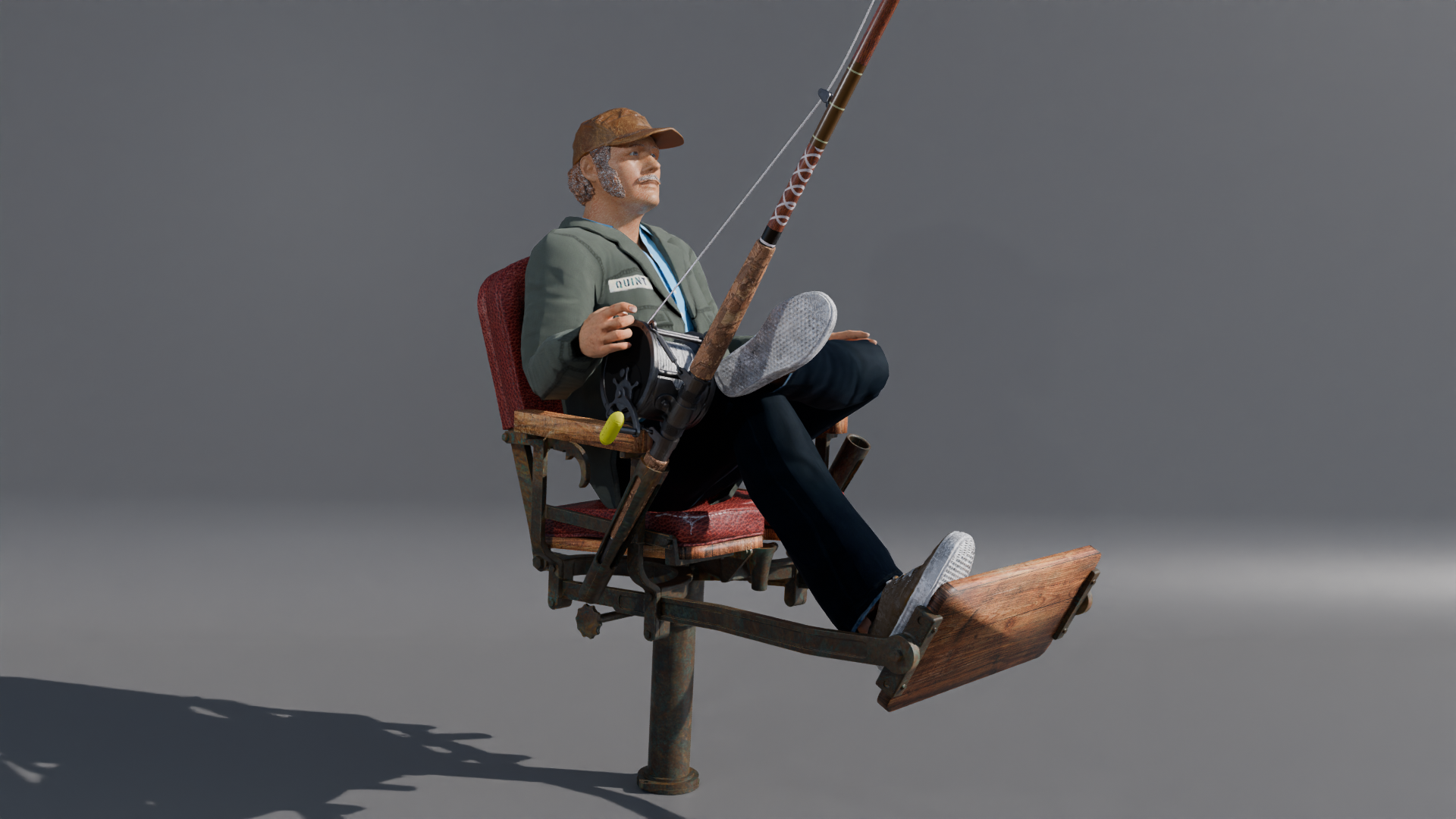

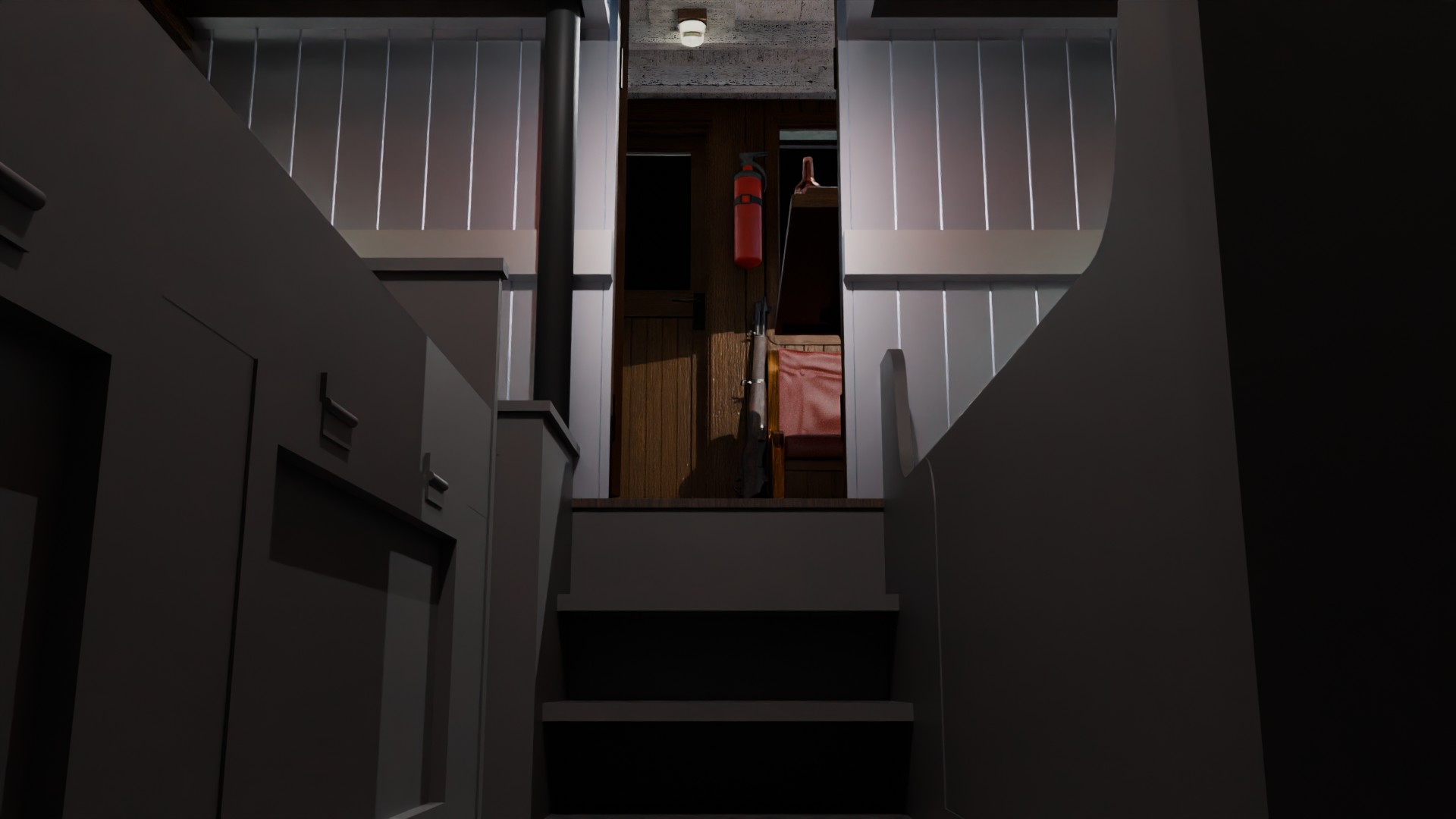

99% finished the ORCA render so need a crew. I'm getting better at Texture painting but it is a bitch.
well the weather is getting better, so its time to start thinking of the actual build.
I've taken the 3d model as far as I think I want to go at the moment, as am not good enough at texture painting yet.
so here is the video,it took 2 days to render because we had 2 power cuts and my PC was plugged into my UPS.

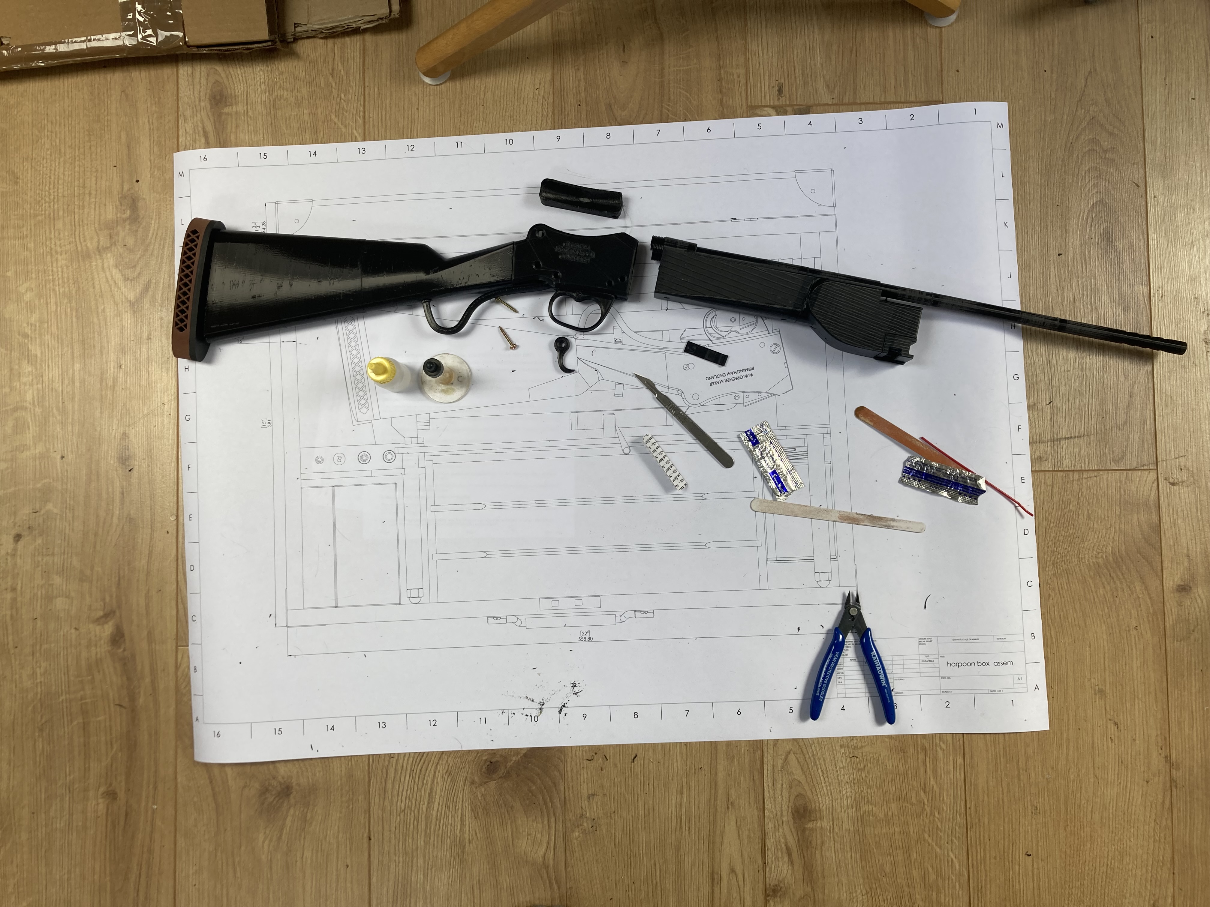

I 3D printed a mockup of the Harpoon gun. ordered the wood and aluminum. I'm thinking of making 10 but they might be expensive so might but feelers out first. when I start this I'll post it on the Prop forum.

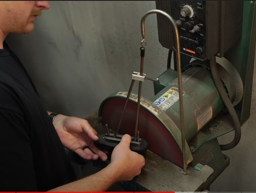

Just curious on the way you grind the recoil pad to fit the stock. I have watched my gunsmith do this for 40 years and I am interested in how you do it.
I’ve seen the jig they use. It hangs down over the sander, I might make one of those ,
Right project concerning the harpoon rifle.(y)(y) Too bad about the gig for the F4:unsure::( As for the pricing, it'll be a collector's item in no time!
Flimzy, My gunsmith does not use a jig. He tapes the stock off at the end where the pad meets the stock. First layer is scotch tape then masking tap in two layers. This acts as a stop gap so you do not sand into the stock. He uses a side mounted disc sander and works toward the tape. When he gets close he hand sands to final fit. This can be intimidating, but with your skills, I think you could pull it off. Yea, Columbus took a chance.;)
If I'm doing 10 I'll need anything to help speed it up. this was the jig I found and its quite easy to make. Your right I'll still need to hand finish at the end.https://www.youtube.com/watch?v=ivl5HvA7CV4

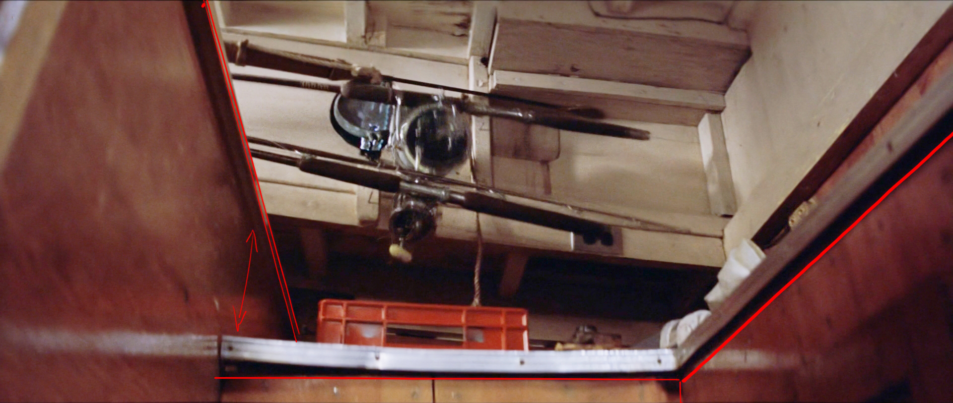

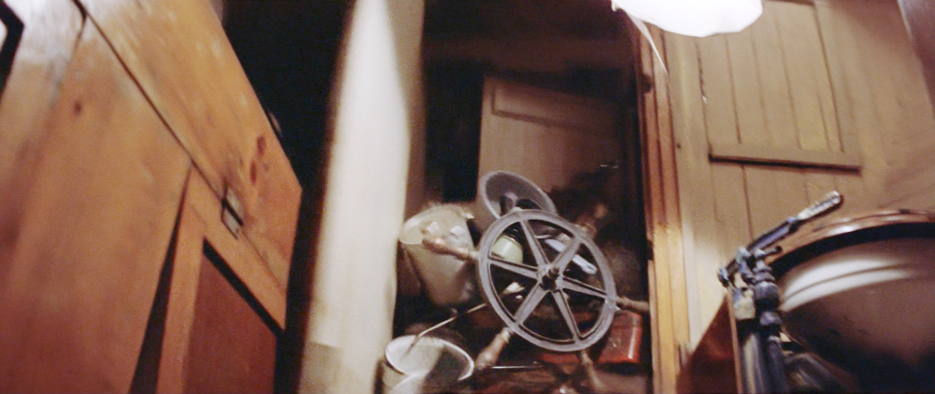

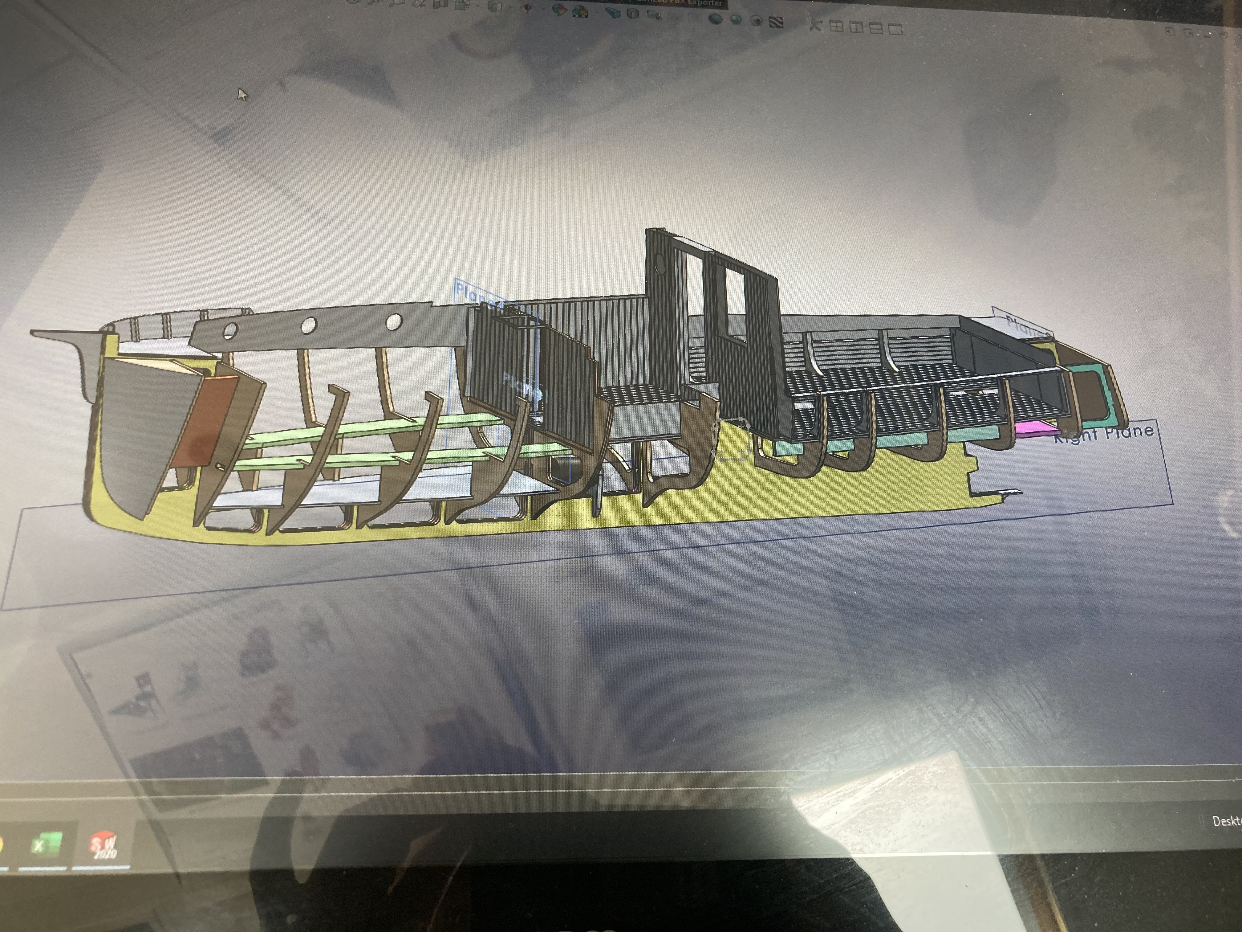

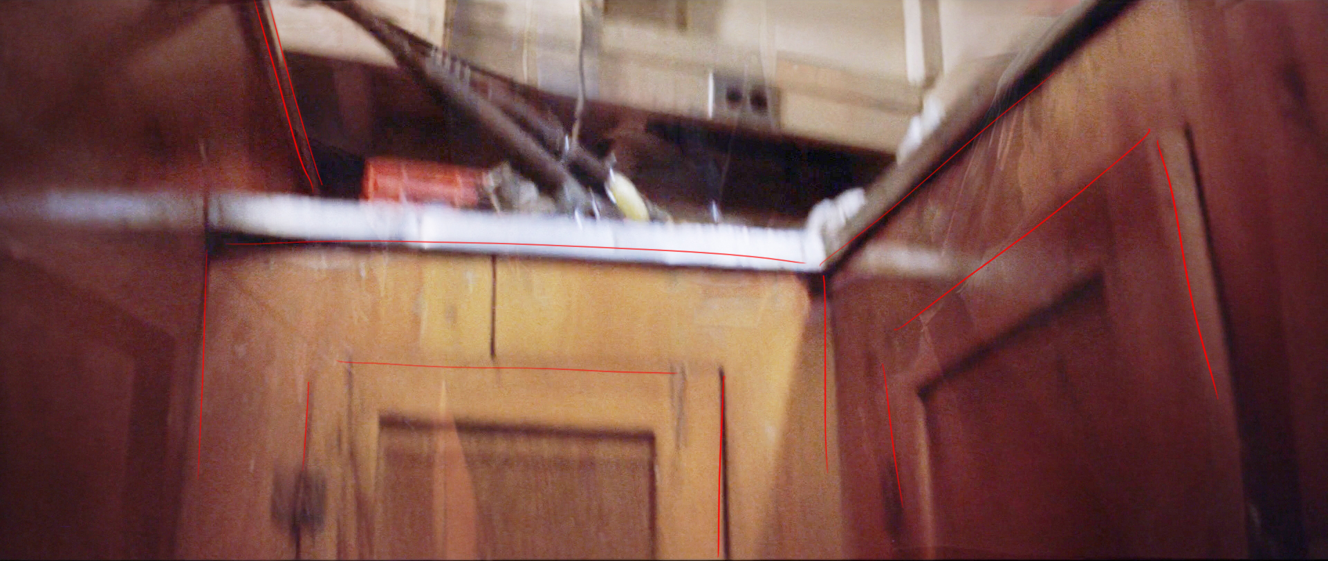

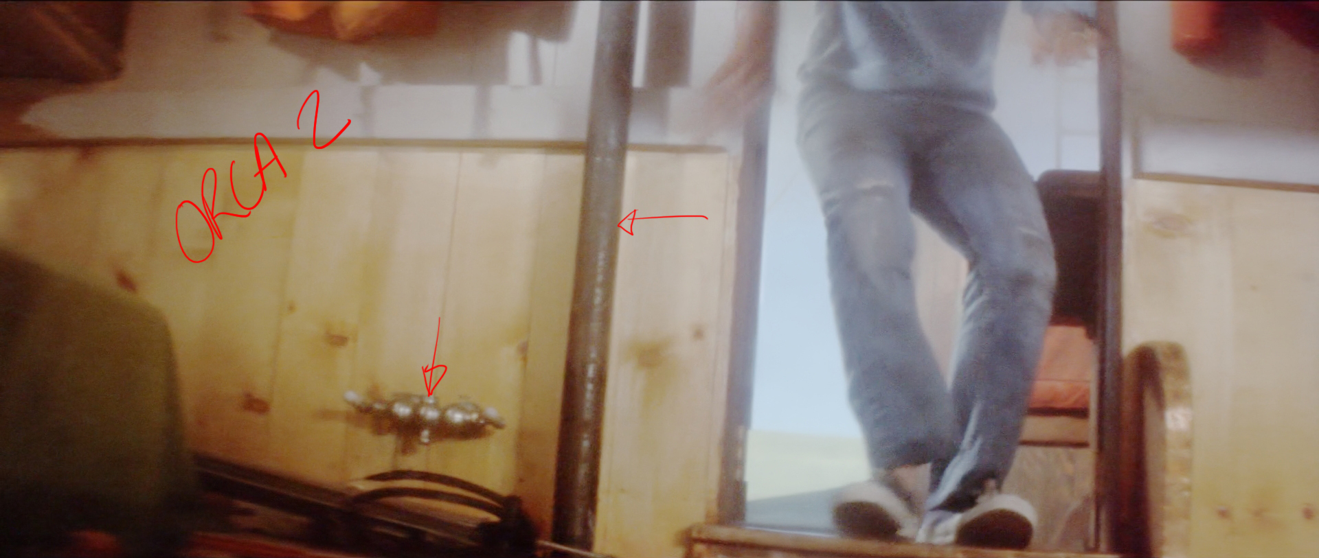

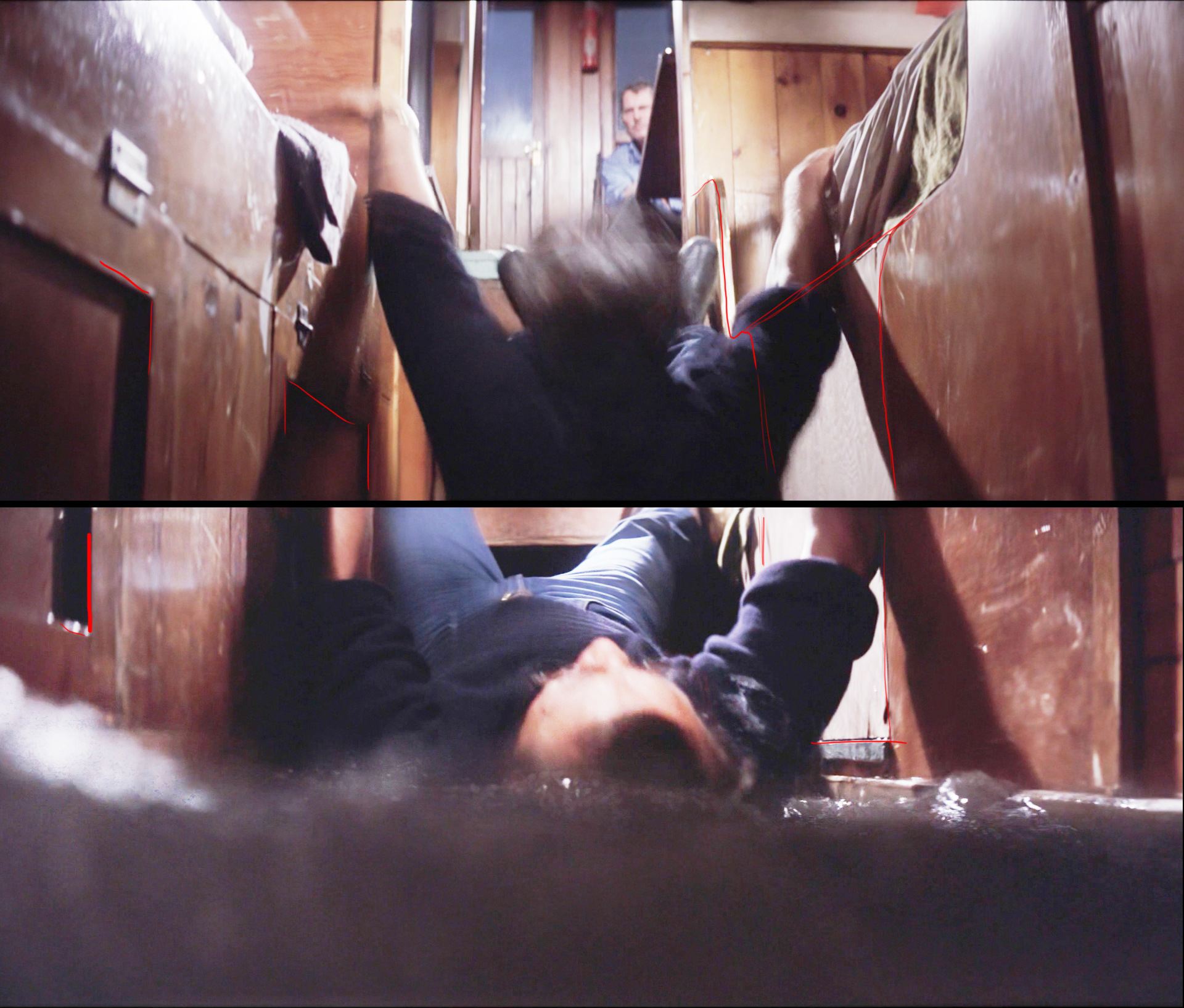

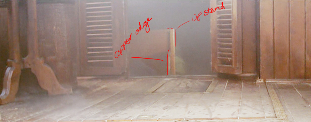

So I'm nearly finished breaking out the laser cut profiles when I came to the conclusion that even though I'm not building the lower deck I'm going to have to at least put something down there like my first build. So this meant looking over the footage,
even though there is barely anything to see.

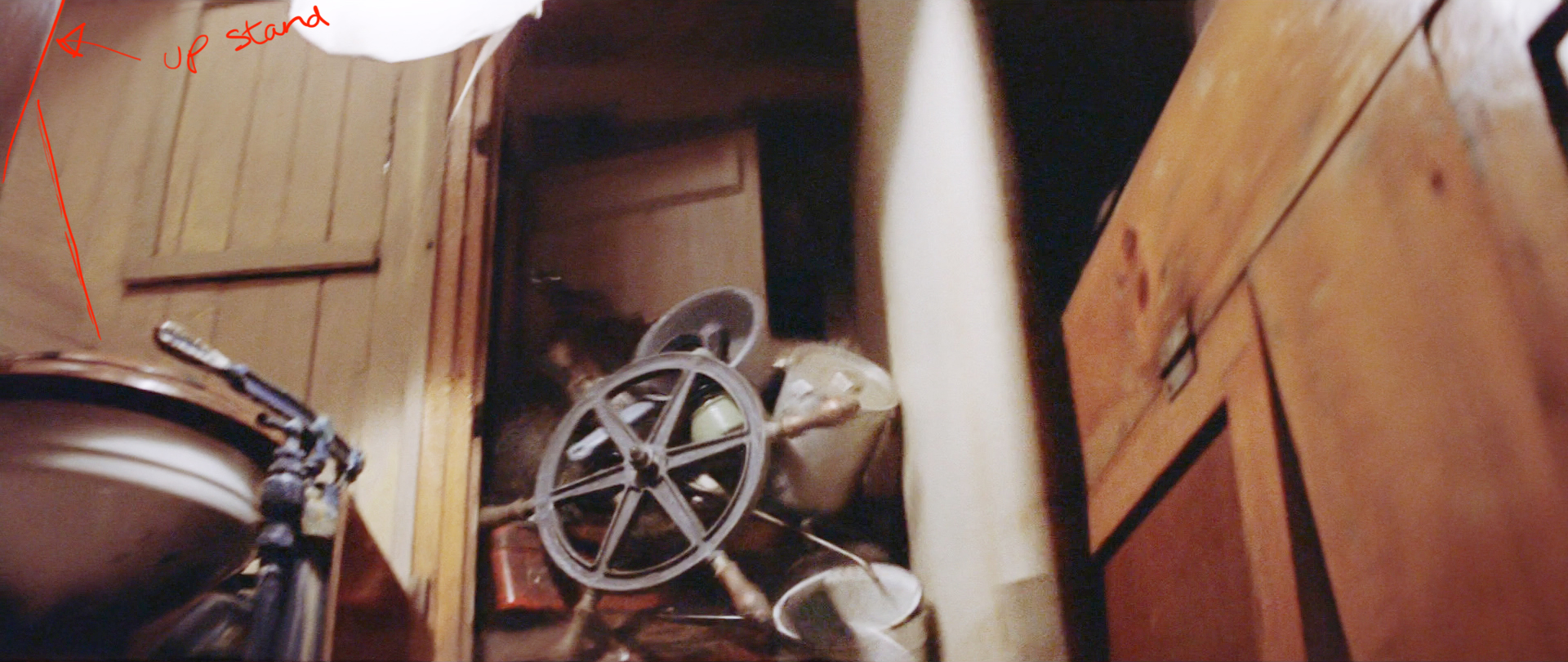

trying to make sence of this with the model I have, I came to a strange assumption that would make it work, only if your think out of the box.
I think the in editing this shot of the toilet all 32 frame, just over a foot. ( 35mm anamophic open gate ) was flipped.
this puts the stand up back on the left side.
which would make this work. as I'm not to bothered if this is truly right I just need shapes and shadows in my model this is what I'm going with.

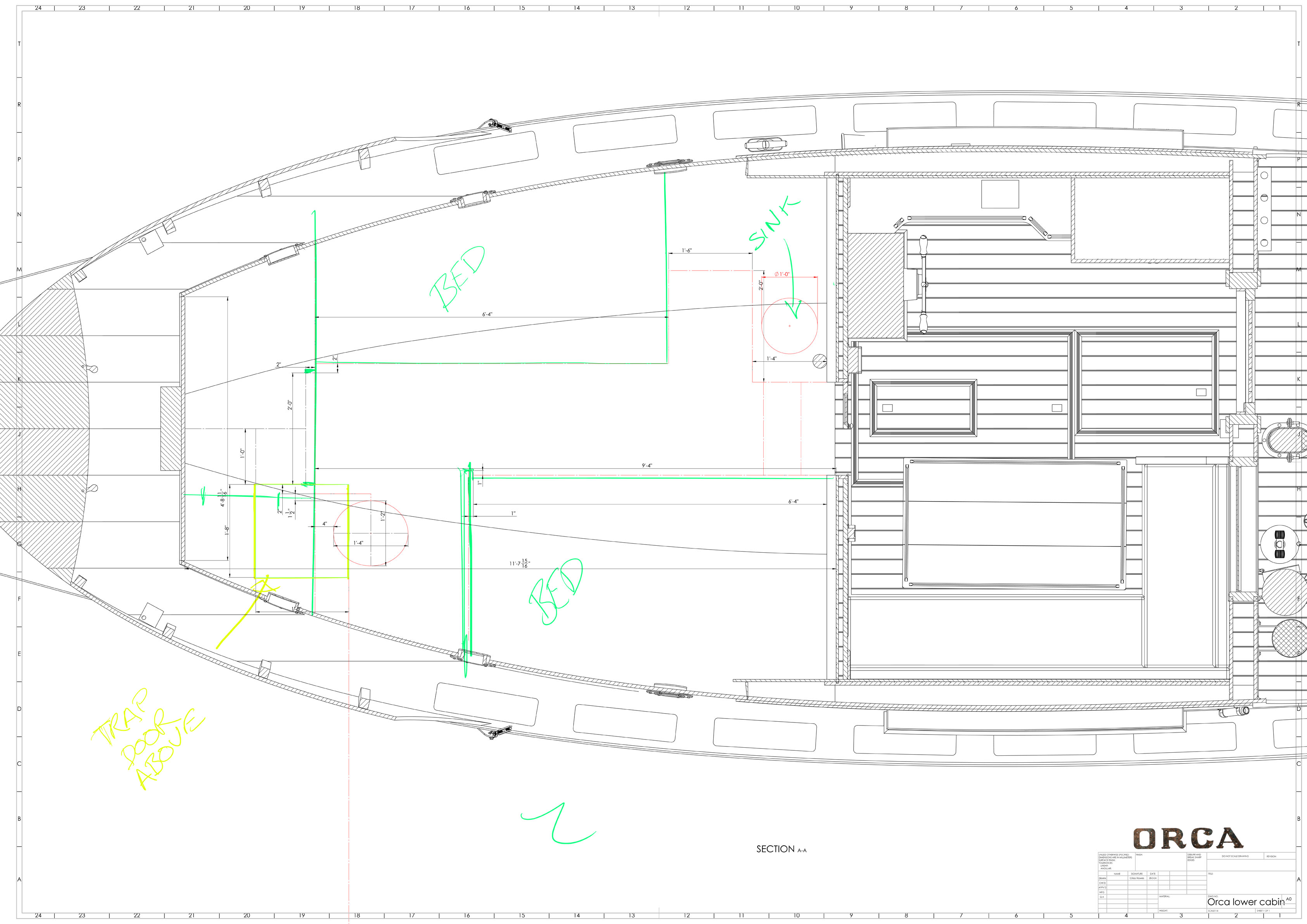

So I'm nearly finished breaking out the laser cut profiles when I came to the conclusion that even though I'm not building the lower deck I'm going to have to at least put something down there like my first build. So this meant looking over the footage,View attachment 1807647 even though there is barely anything to see.
View attachment 1807648View attachment 1807649View attachment 1807650View attachment 1807651View attachment 1807652View attachment 1807653
this puts the stand up back on the left side.View attachment 1807655
which would make this work. as I'm not to bothered if this is truly right I just need shapes and shadows in my model this is what I'm going with.View attachment 1807656

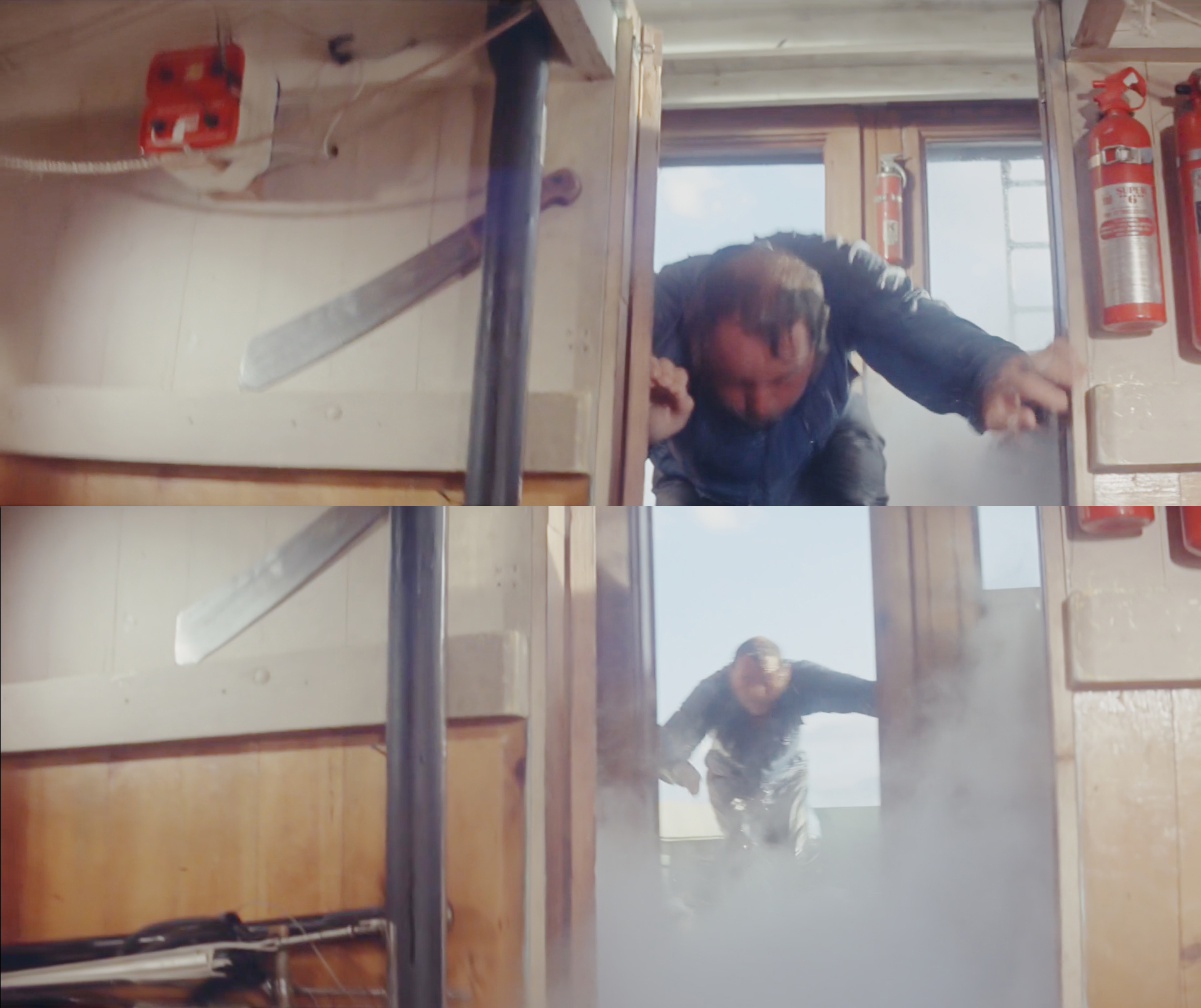

You Have my mind working in overtime. You are on a Roll with the Lower Cabin. Get rid of the sink and look at the scene of Hooper grabbing his equipment after the engine blows up. That scene has a good view of the top of that cabinet, of what might be Orca 2 like you said.

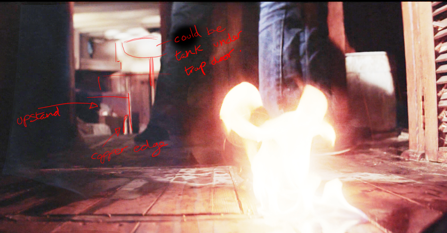

The picture of the lantern fire you outlined the molding brace on the back wall. It's a half ark similar to the arch on the back deck bulkheads. With your outline, guess what? The Cabin roof is arched like the main cabin. There's another Monkey thrown into the Socket Wrench.
I'm liking the Bathroom on the Left side (port) of the boat. That's what Marty Milner told me too. If That's true, YOU ARE SO RIGHT that the film was probably flipped in editing. You brightened up (THANK YOU) the picture of Brody in the water. The port side bed goes right up to the main cabin bulkhead wall, which means, the life jackets are getting the bed soaked,......lmao.
The only thing that stumps me now is the back cabin wall. Are all 3 portholes in one room? It's Rabbit Season, No, it's Duck Season, "Get behind Me, We're Swinging Again".

My roof already has an arch so no problem there. I didn't see a sink I just put one in because both ORCA 1 and 2 have taps there, I think there are only 2 port hole it would make the door in the end wall too short and the floor would be too narrow. in my mock up you can see my beds are still a little too far apart. I'll have another go tomorrow.
A short door might be right though.
